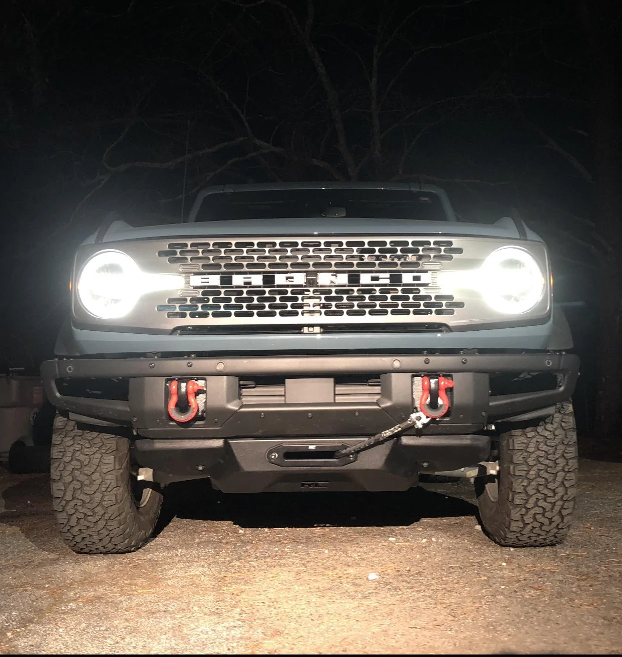

I installed the RC hidden winch on Saturday on my 2.3 Badlands with mod bumper. Basically merged the stock skid and RC skid. Will be doing a write up later today.

They have posted the dimensions of their hole pattern - pretty standard. I used a Warn VR Evo on it. But I did re-locate the control unit to my engine bay (I wanted it there, and even if not I think it may have been too tall for the space anyway). I’ll have to see if I can measure how much room remains above the winch and post that.

HI all, I installed the RC hidden winch on my First Edition (2.7L, Mod Bumper). You can see the full write up in the link below (not putting it all here again).
https://www.bronco6g.com/forum/threads/winch-on-modular-bumper-badlands.31551/post-1214344
Before you all message me asking for installation photos and if I can make you brackets, no, sorry, we didn't take photos of the install, we were focused on getting it done and the brackets were custom made/welded, no off the shelf link I can provide here.
What I can tell you to answer some of the questions in this string are, we only moved the heat exchanger/trans cooler up some and did NOT remake any of the lines, we kept the factory line. We used the RC Winch as you can separate the top control panel from the actual winch assembly and mounted the entire control box remotely, thus allowing room for the cooler to sit on top of the winch. We did abandon the RC skid plate and just use the factory one.
I hope at least this provides some insight and proof of concept, finished photos and other info available through the link above in the other string.
