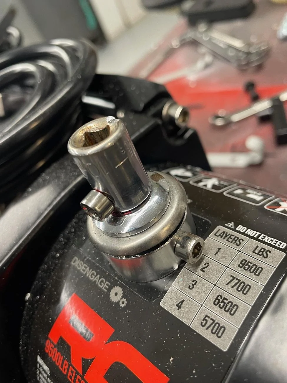

If you currently own a Rough Country hidden winch for the Bronco, you know that turning the lever to allow for free-spooling is a pain.
I’m just curious if anyones found a simple tool or modification to make it easier to engage/disengage this?

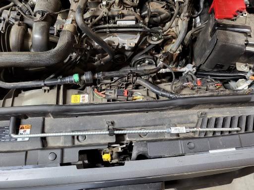

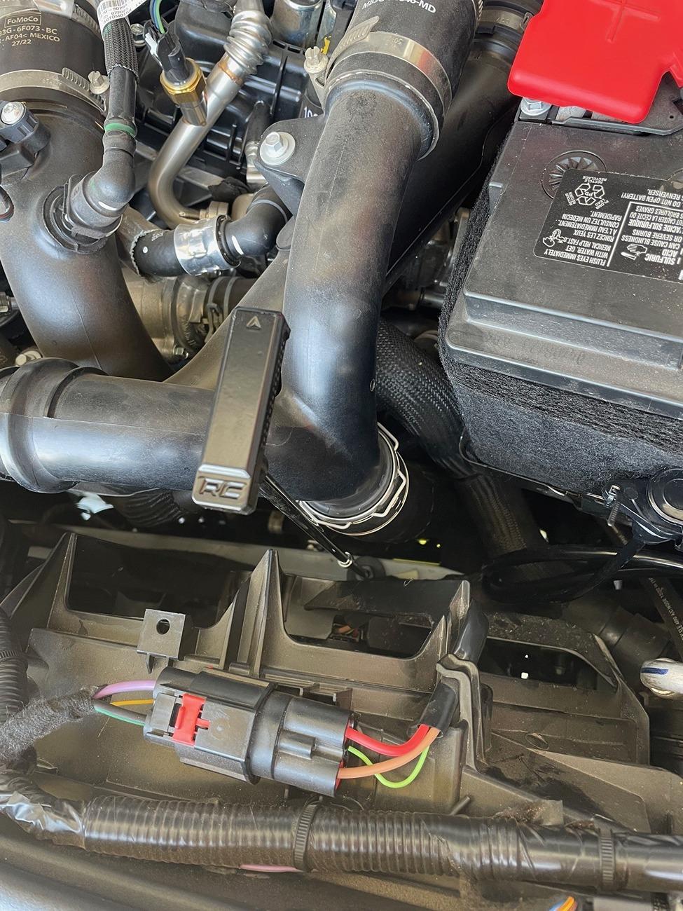

I built this removable handle and store on the radiator support. It works with my Rugged Ridge which has a T handle clutch that is lifted and rotated 90 degrees to engage may not work with all.
Ford Bronco Rough Country Hidden Winch - Free Spooling 1577
Ford Bronco Rough Country Hidden Winch - Free Spooling 1578

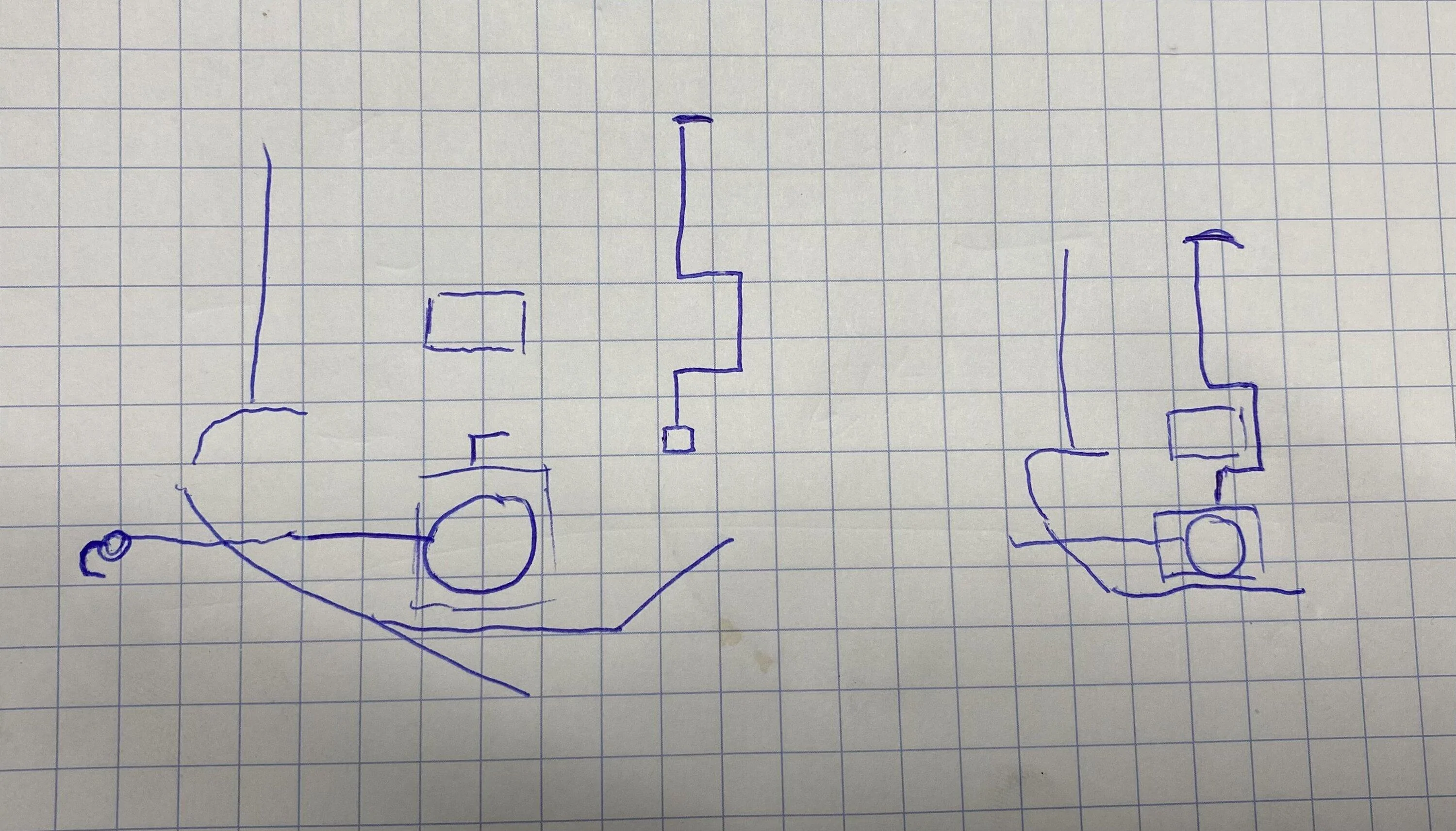

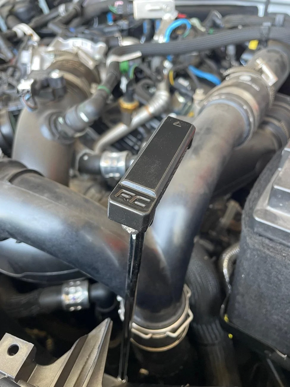

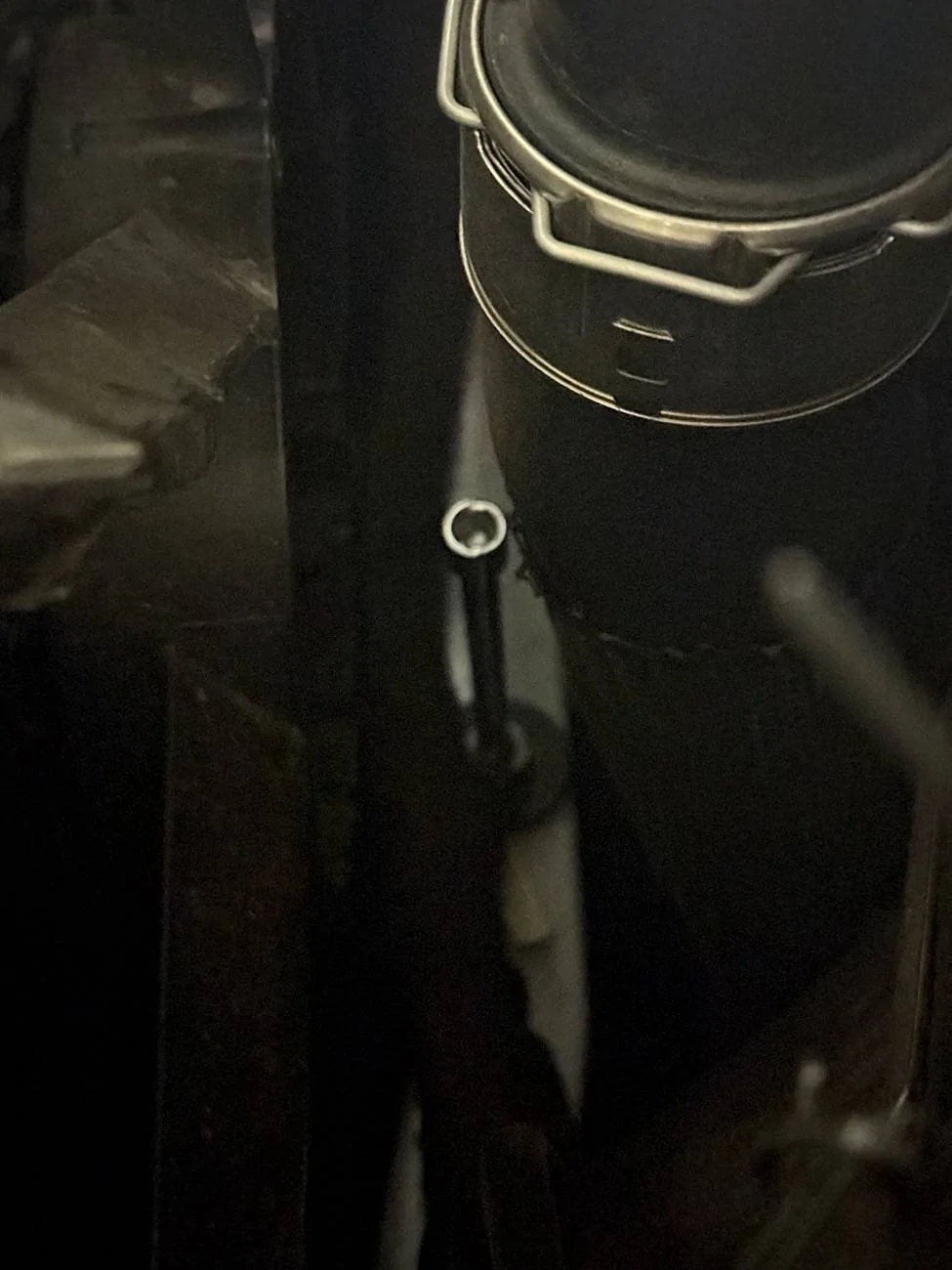

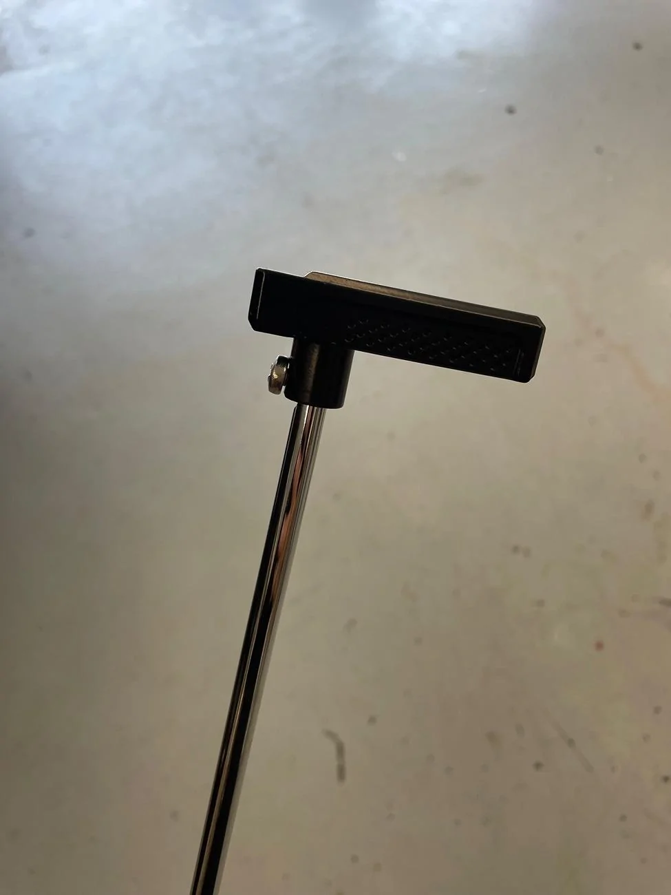

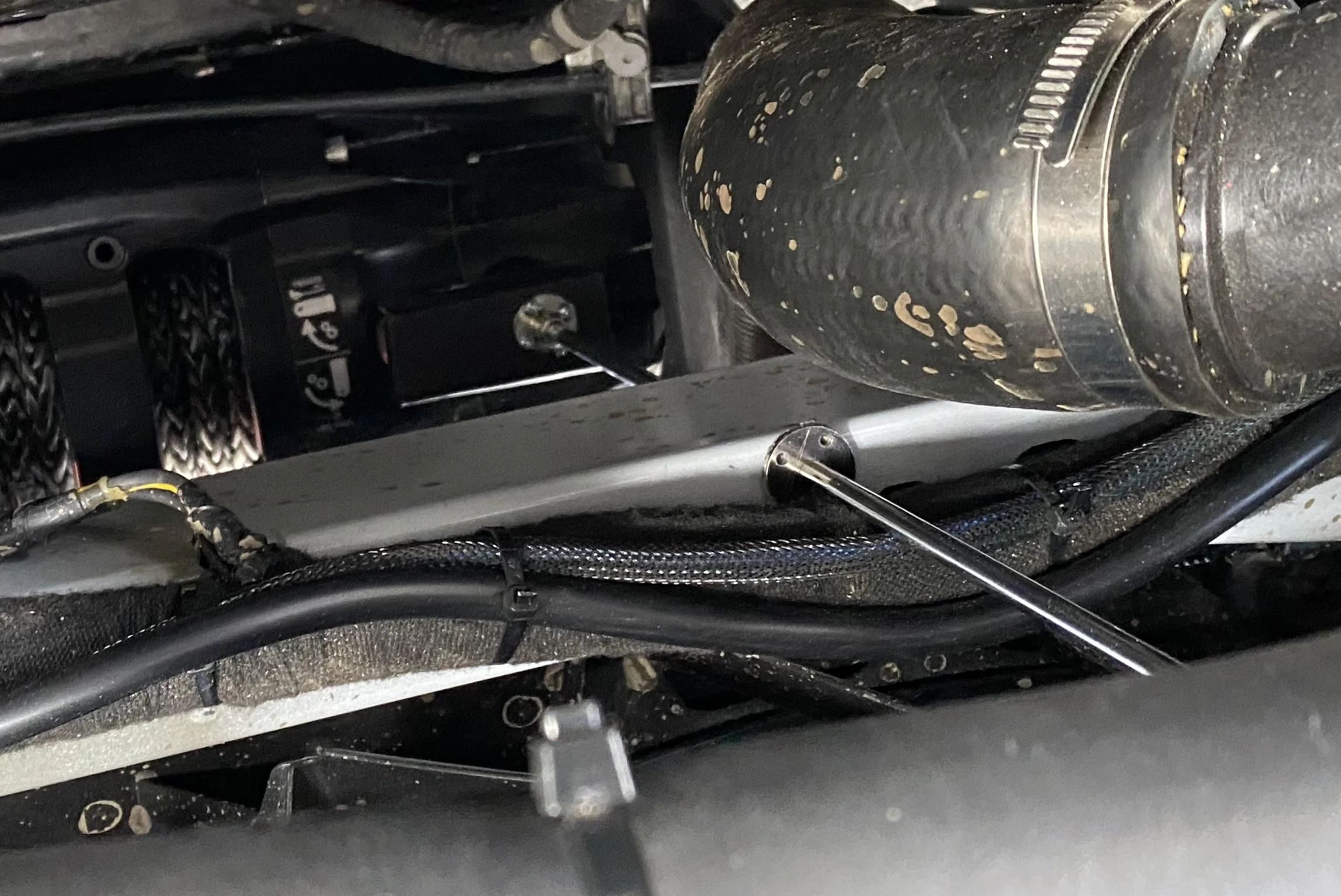

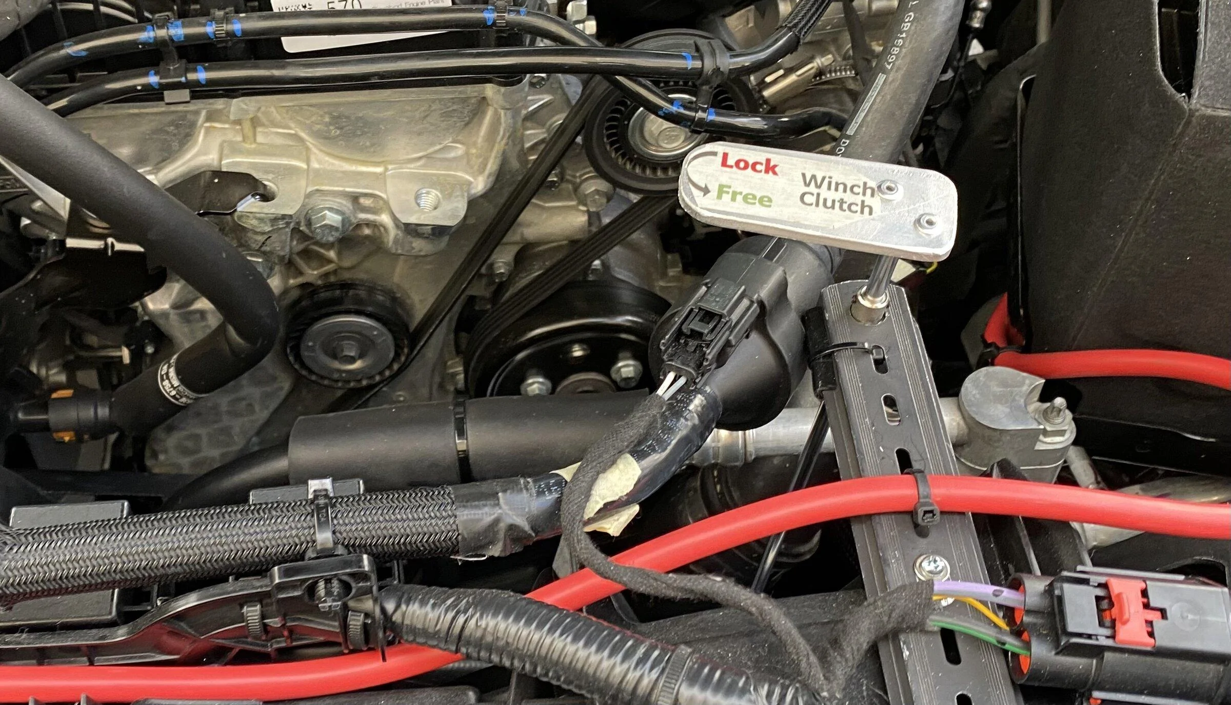

I have a thread/post of a DIY solution for remoting the engage/disengage lever. You don’t need to raise the hood.

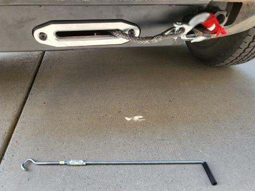

Heres a Demo
Is that a golf putter? :ROFLMAO:
Love it - Looks like a good home-made solution! Thanks for sharing the video.
