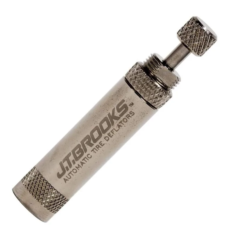

Calibrated my new J.T. Brooks automatic tire deflator. The things works great!

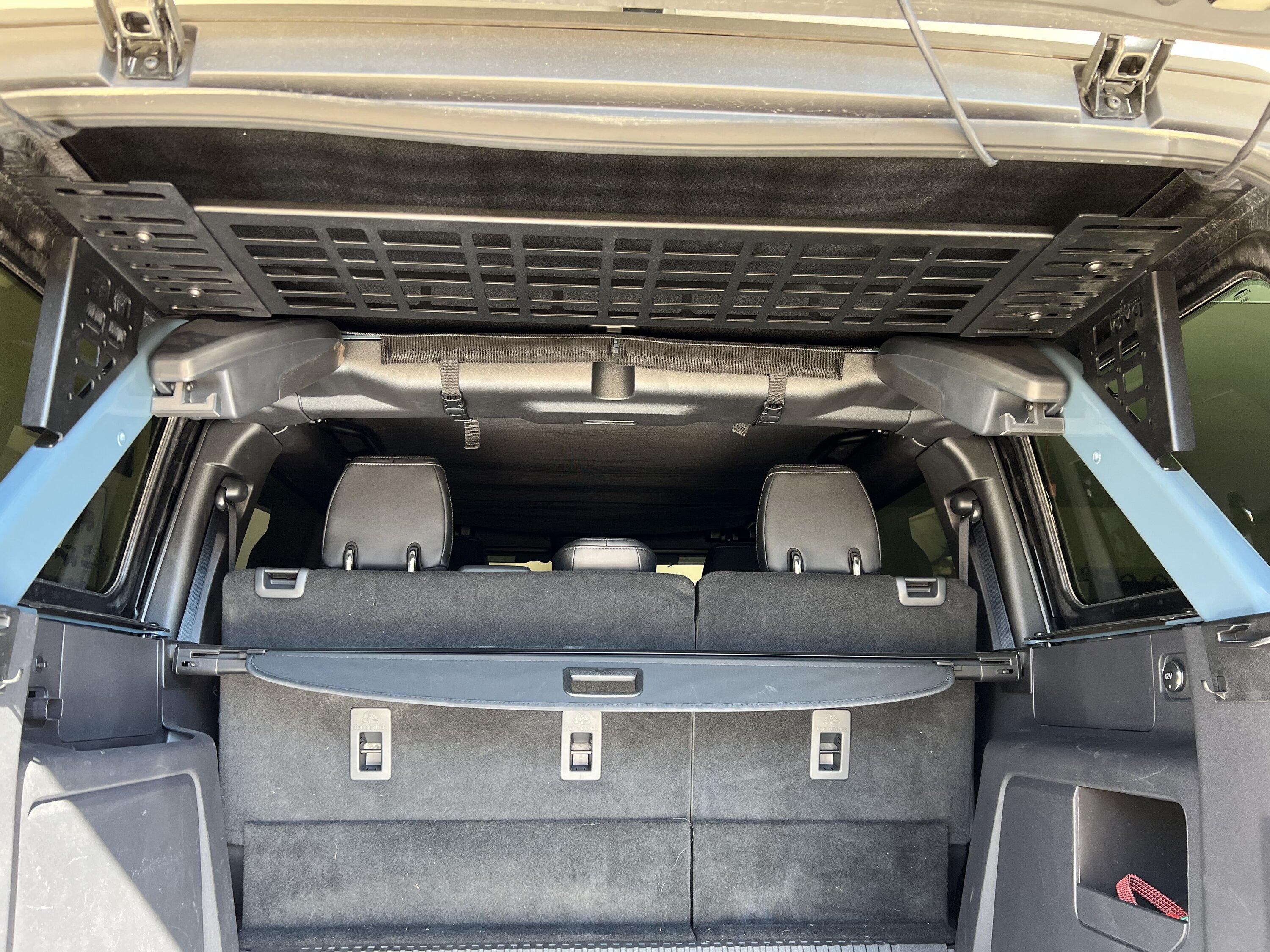

Added the Pura Vida Attic Tray:
https://puravidaoffroad.com/shop/ols/products/ford-bronco-attic-tray
Exactly what I wanted to keep recovery gear off the floor but still accessible.

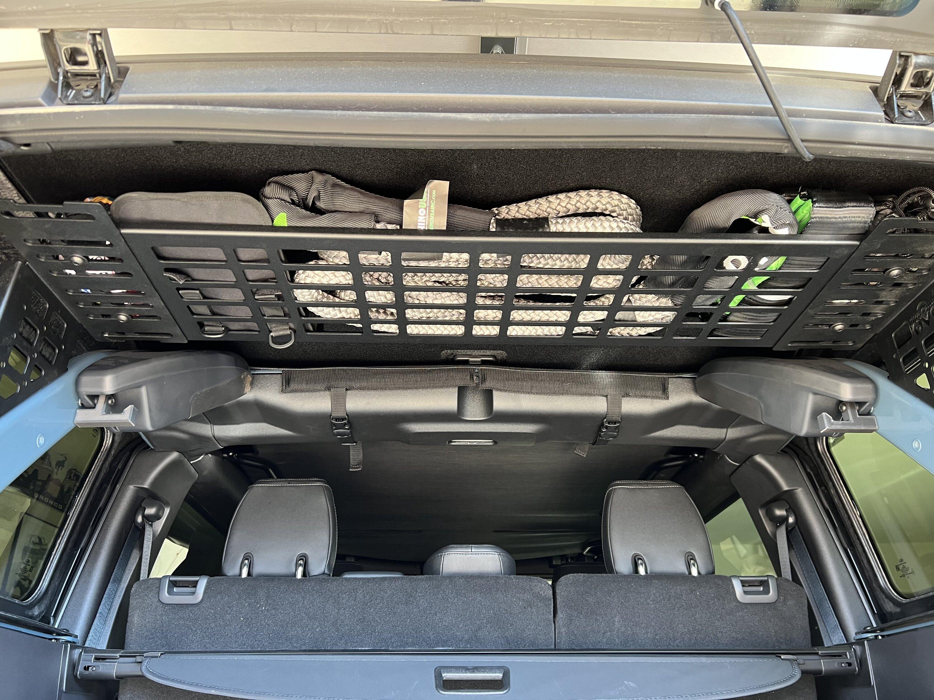

It can easily hold Bronco hammock, shovel, kinetic rope, tree saver, and 2 soft shackles. Does not interfere with rear view at all.

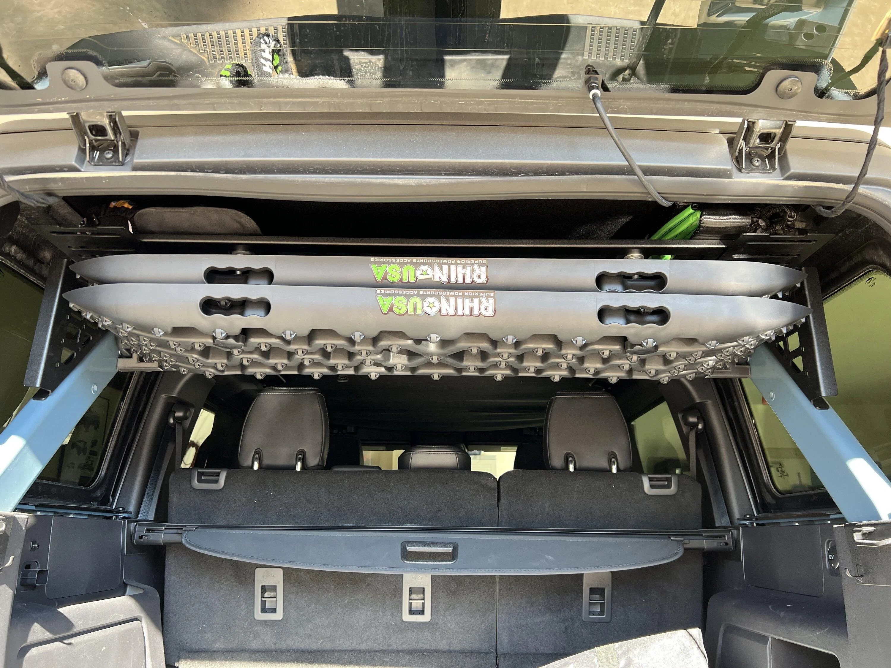

When I need to carry recovery boards, they hang nicely underneath. (I can still bring these up another inch or so). Cuts some of the rear view but still easy to see what is behind me.
Ford Bronco What did you do TO / WITH your Bronco today? πŸ‘¨πŸ»β€πŸ”§πŸ§°πŸšΏπŸ›  IMG_6314

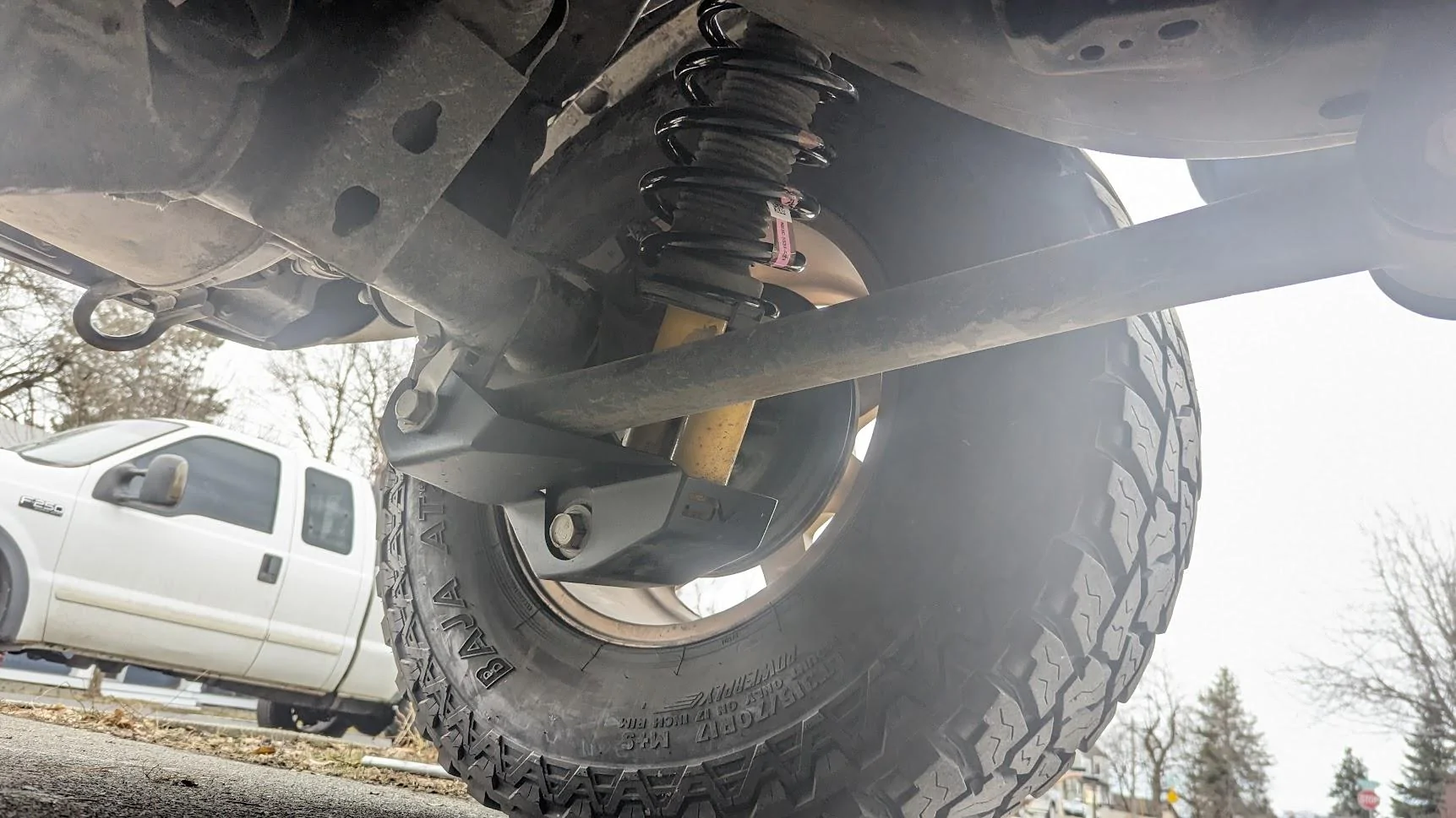

Intriguing. I have knock off Stauns and they're kind of finicky.
I got the DV8 shock skids on. I noticed a few dings on my reservoirs already, and they're getting sandblasted and rusting already too.
Ford Bronco What did you do TO / WITH your Bronco today? πŸ‘¨πŸ»β€πŸ”§πŸ§°πŸšΏπŸ›  PXL_20230212_230317099
Still have those stock trailing arms with the hard rubber bushings?
I do. It was hilarious watching the axle just hang in midair suspended by only the links when I took the shocks out. Used to it dropping to the ground on anything else I've built. Maybe after summer when things settle down I'll build some new lowers with johnny joints.
I really do think replacing the rear links and track bar with real, moveable joints increased my articulation enough to rarely lift a rear tire on the same trails that the stock suspension was always losing contact. I think one of the best changes I've made.
Do you still have the old links around? Would be nice to know the bolt size and bushing width without dropping mine first.
I can check. We have a metal scrap pile they went into on the farm. Don't know if it's been hauled off yet or not. The one on the non gas tank side is real easy to get off though.
