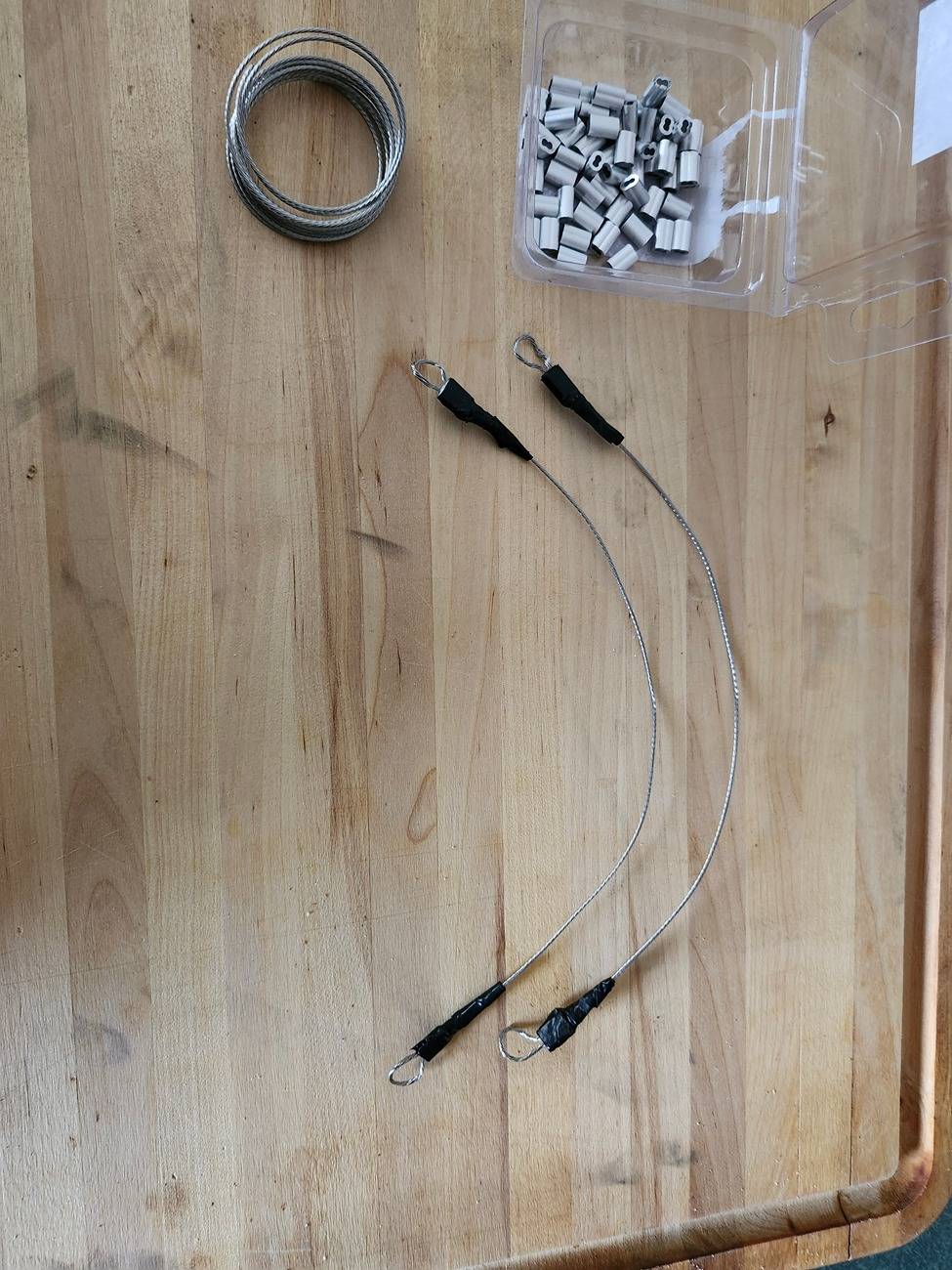

I plan to upgrade the cable limit straps soon, which should allow me to increase the weight limit to around 50 lbs. I suspect the thin cable and pin are the weak points. I may also relocate the cable attachment point to the door or higher up on the frame to improve durability.
After breaking and repairing the cable limit straps that came with the unit, I manufactured a couple of back-ups. I used 100 lb strength stainless steel picture hanging cable with aluminum crimps. The weak point of the OEM cables is at the crimp where the cable can slip out when too much weight is placed on the table. Love the table.
Ford Bronco Installed Ford's Tailgate Table yesterday 20240912_104348
