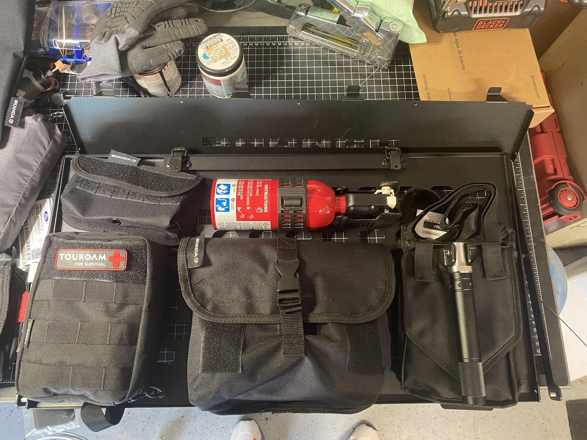

Nice set up. Where do you guys get your MOLLE pouches/bags?
Thanks! Let’s hope I don’t have to use what’s in some of them too often. Lol! I ordered mine from https://www.levittownfordparts.com They have all the OEM accessories from the Ford catalog @ a 20-30% discount. Just search for them there.

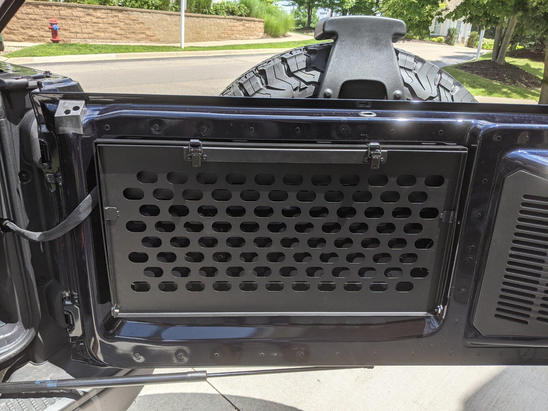

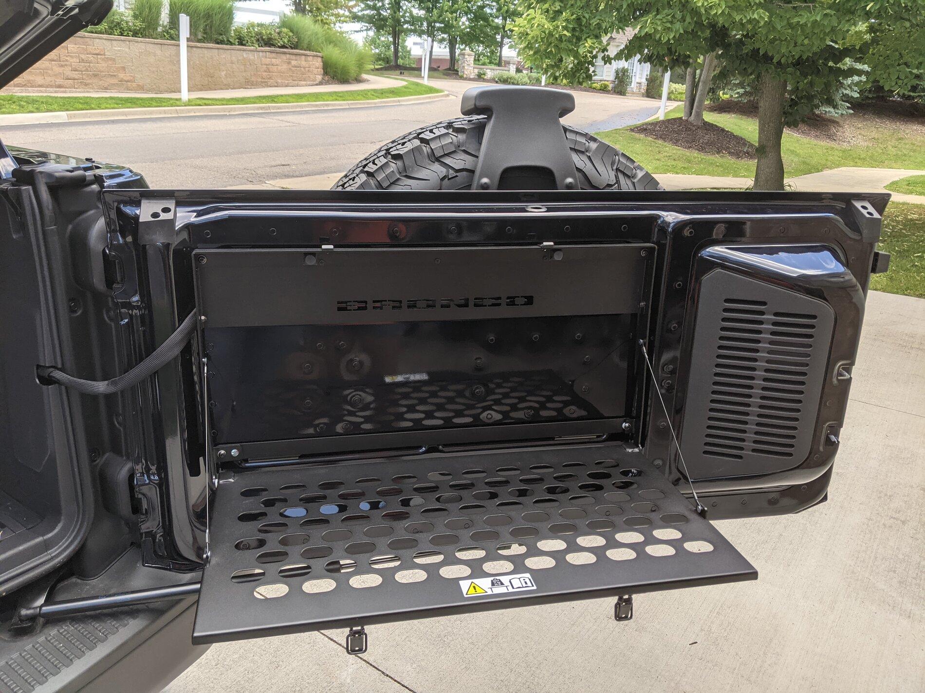

Got my Bronco last week and then ordered the tailgate table at that time, showed up today and installed it. So just a heads up it is a little tricky. I would recommend 2 people to assemble and 2 beers each. Installation is not for the squeamish, you have to drill 4 holes in your brand new bronco! There is some weird things like 11/32" nuts and you need a 7/16" drill bit. A 90 degree Phillips also helps for a couple small screws with nuts.
I took some pictures and plan on doing a write up on the install. Here is the finished product. I don't know where I went wrong but the table is not centered in the frame and I had to remove a plastic washer to make it close. It functions and on initial closing and opening no rattles.

Got mine as well, paid the same and am also liking the grid for the molle pouches. Got a similar setup to yours w/ extinguisher, first aid kit, air compressor & portable shovel ready to go. Now all I need is the Bronco which had a blend date for yesterday 6/30.
What is the best wat to attach the Molle bags directly to the grid/table bottom?

Thx, I ordered the same straps and bags but for the life of me can't figure out how to use the straps to secure the bags to the table grate and hold them tightly. Clearly, I must be doing something wrong.

Try weaving through the table, then the pouch, until the entire strap is tightly woven through everything. It’s a bit of a pain, but holds really solid.
