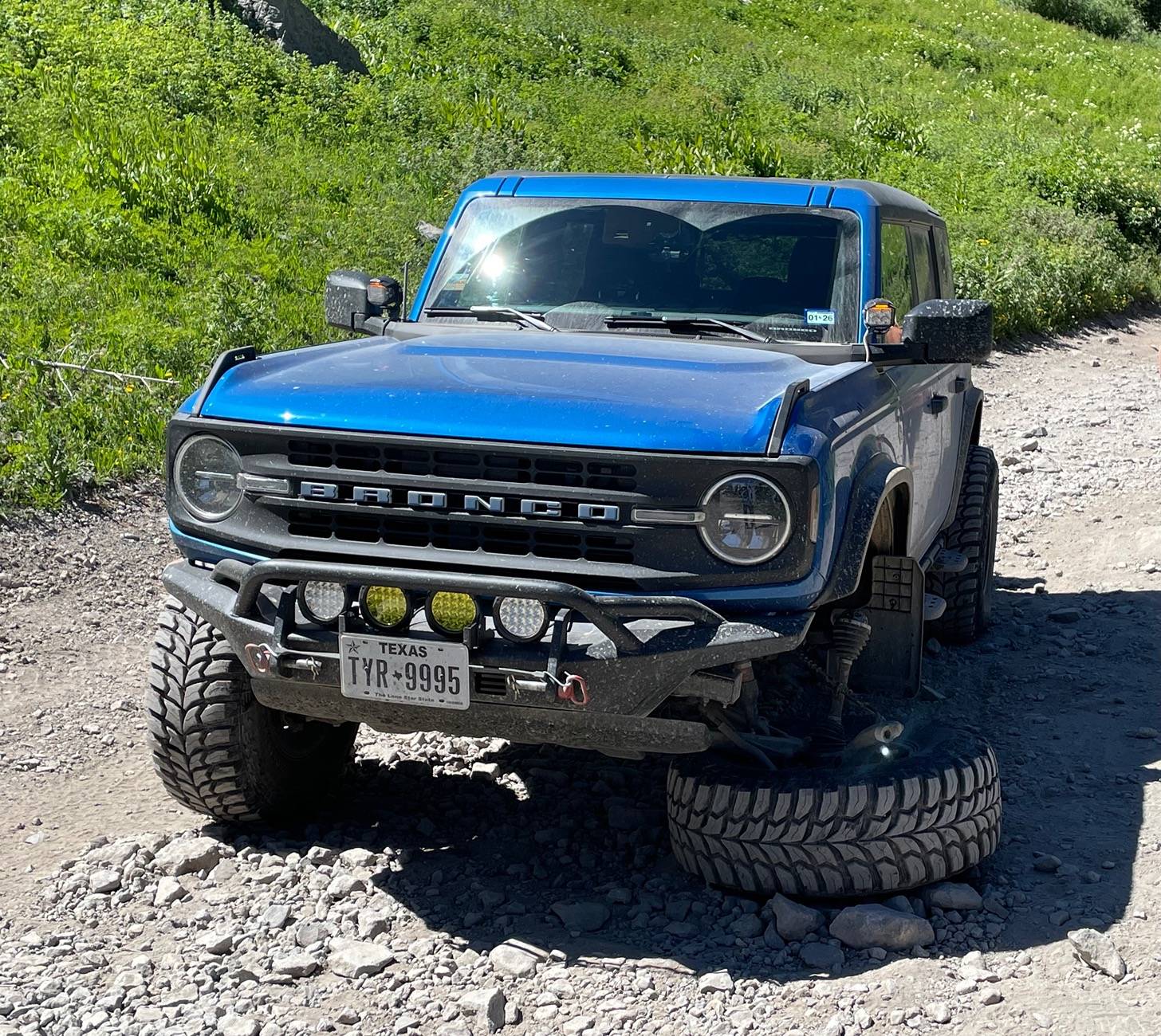

ā€œCAUSING A LOSS OF STEERINGā€. Is an understatement. It would be CATASTROPHIC at 70 mph. I encourage anyone who thinks their Bronco falls in that timeline to put an 18mm wrench on those nuts before going anywhere.
This is what can happen at less than 5mph. (caused by me not Ford) Imagine what would happen at higher speeds.
Ford Bronco 2,416 2024 Broncos and Rangers recalled over loose and missing nuts on front Upper Control Arm (UCA) IMG_1038
