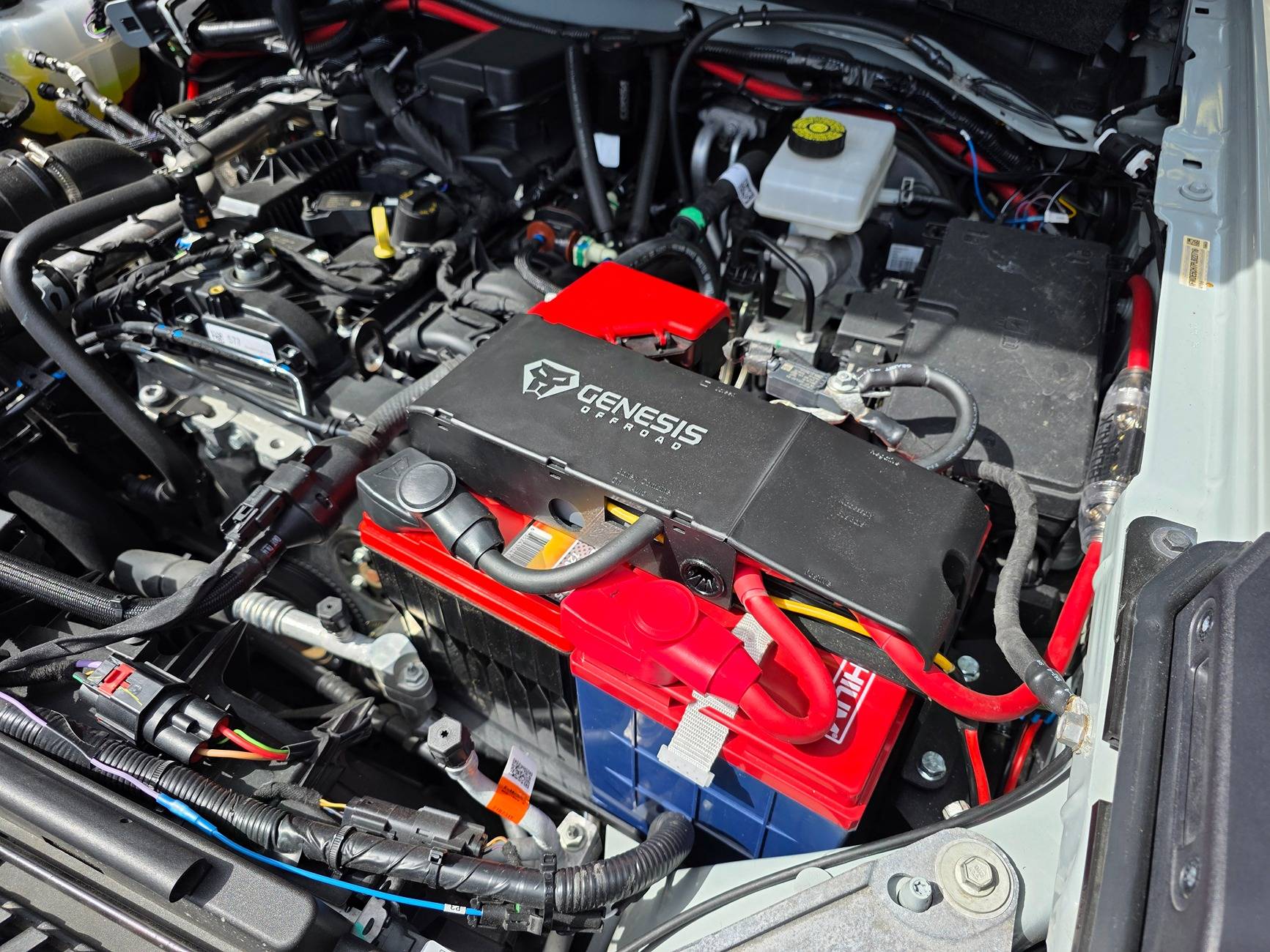

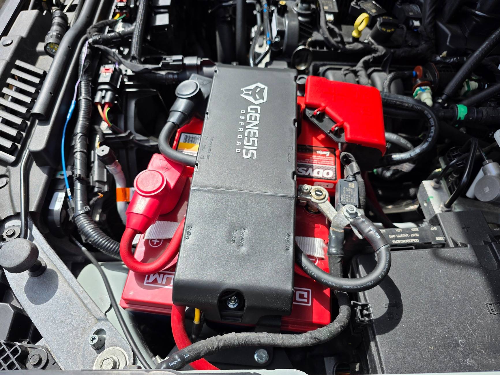

Just completed my custom dual battery setup using the @genesisoffroad Genesis off-road DIY kit. Funny enough they have just started selling something similar branded as their Omega system, but it is only available for Jeep right now. If you want simplicity, the full Genesis dual battery kit is probably the best way to go, but I wanted more capacity and flexibility to charge with a solar panel. So I went with an AGM Odyssey battery + Dakota Lithium 135ah (This is literally the only battery I could find with the right size to fit).

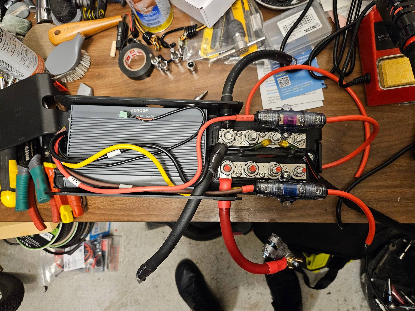

I found out that the Renogy DC-DC/MPPT 50A charger fit almost perfectly inside the Genesis battery tray lid. This allowed me to keep most of the electronics contained inside the Genesis tray. Note that you do need to buy the plastic lid cover separately for $20, and I had to trim the right side to clear part of the Renogy charger. The batteries were a very tight fit and I also had to trim some plastic on wire channeling to gain a little clearance.

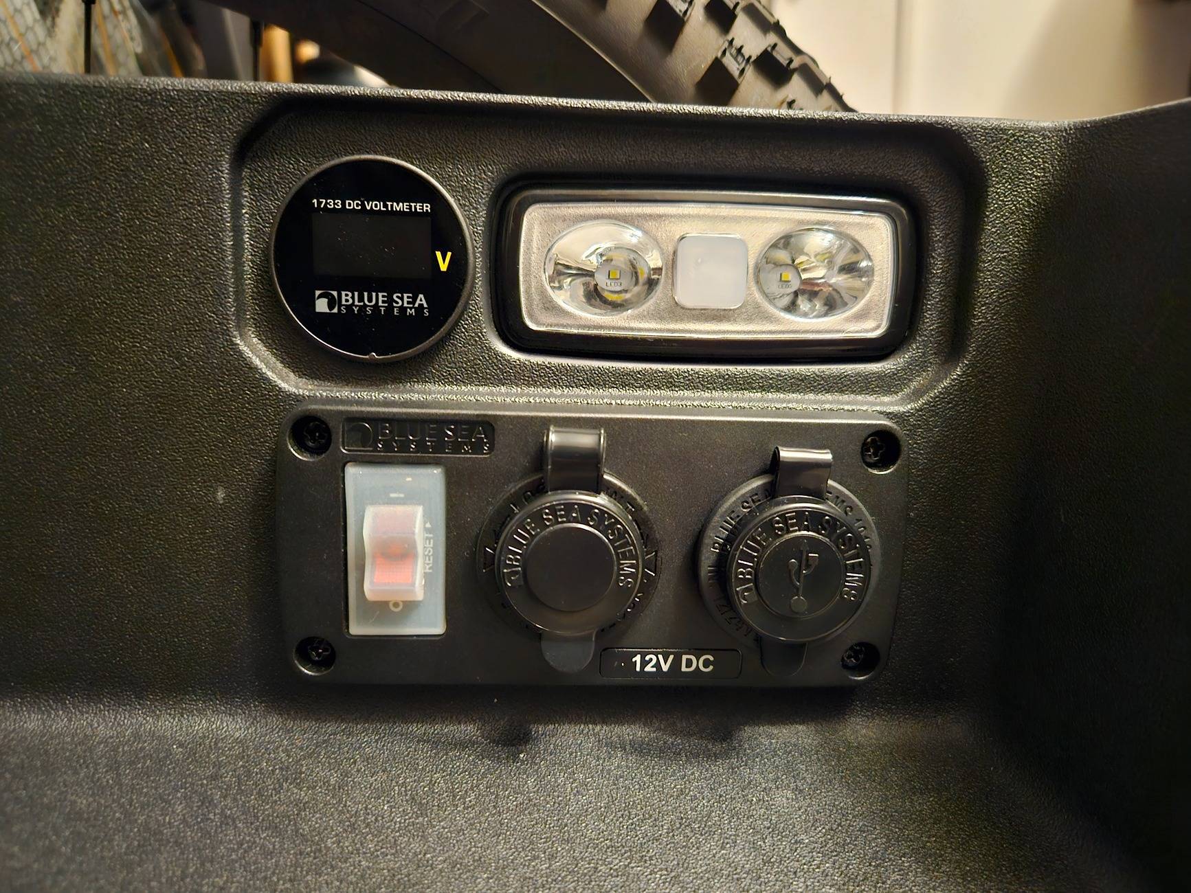

I decided to swap the 12v port in the cargo area with a Blue Sea Systems 12v panel and voltmeter running directly off the secondary battery. This gets around any timeouts with the factory ports and avoids draining the cranking battery. Next I plan to run a 1000 watt inverter to provide additional 120v power points.

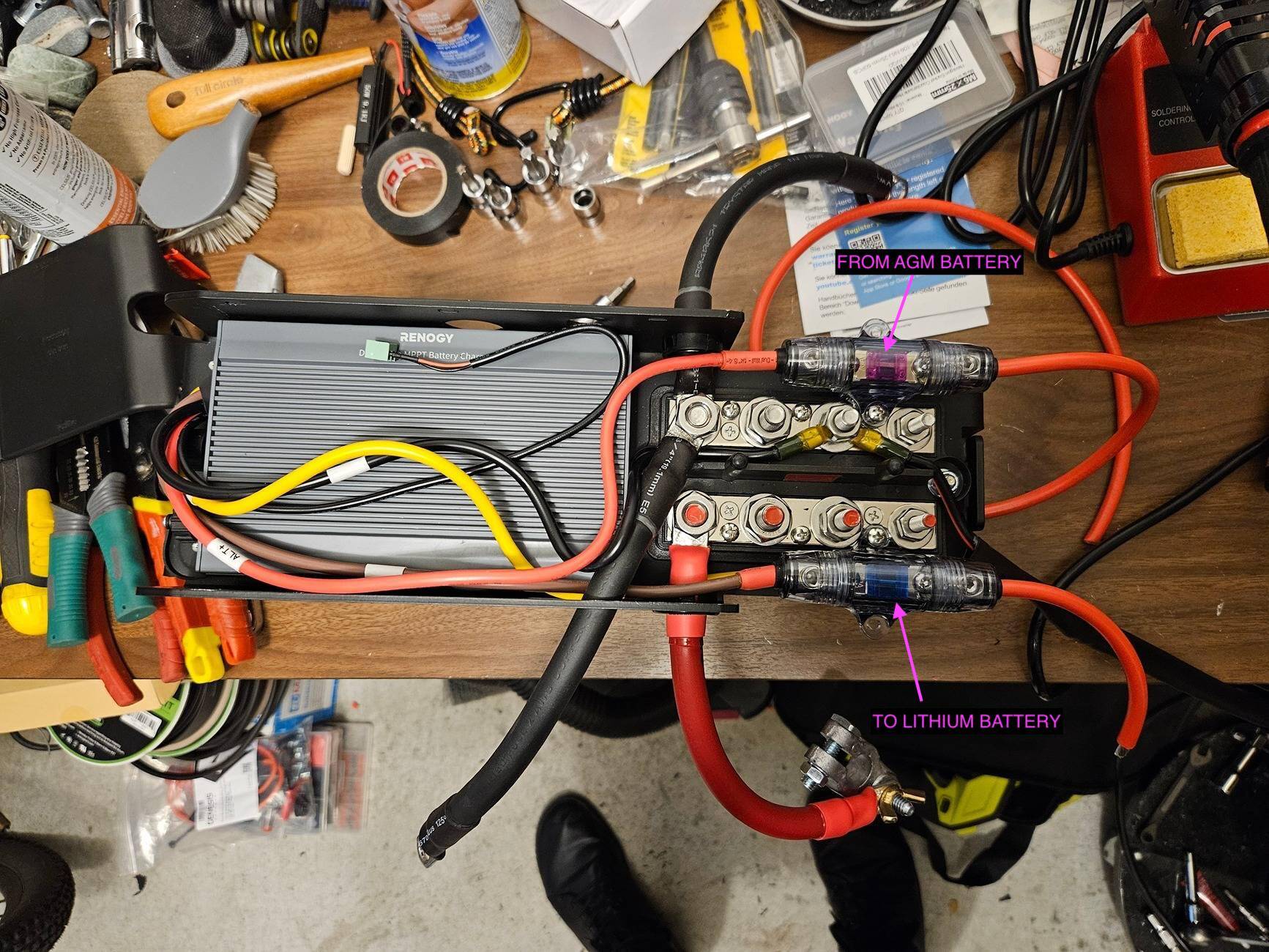

So where are you connecting the + lead from AGM battery to the DC-DC charger? I can't seem to find it in the pictures. I assume it is just wired in to one of the available bus points on the AGM + factory connector?
RagnarKon
Bryan
Aug 5, 2021
5,487
14,572
New England
Ford Bronco, Escape, Focus
It's not shown, but the red wire on the charger with the fuse in-line it would come from the AGM battery (effectively the alternator, which is probably why the cable is wired "Alt +").
The brown wire with the fuse on it would go to the lithium battery.
Yeah sorry for not posting more pics, a lot of stuff is hard to see or hidden. The charger connects to the positive bus bar.

Huh. I thought using a lithium with an AGM was a no go. :unsure:
Technically, they're not tied together I don't think... At least, that's how I have mine setup.
The charge management for the lithium battery is handled by the Renogy DC-DC controller (same one I use) and not directly from the Bronco's alternator.
I think he also has it wired directly to the Blue Sea cig lighter ports at the back.

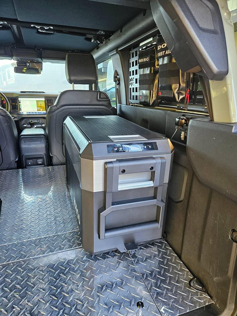

cool battery bits and bobbles. However, I LOVE the diamand plate in the cargo area. I kinda wanna do that now but use black. Thanks for the inspiration!
Thank you! That platform took a lot of work to build. It's multiple pieces that fit together so I can remove the front part to put the seats back in. I do plan to get the platform powder coated, I just haven't gotten around to it.
