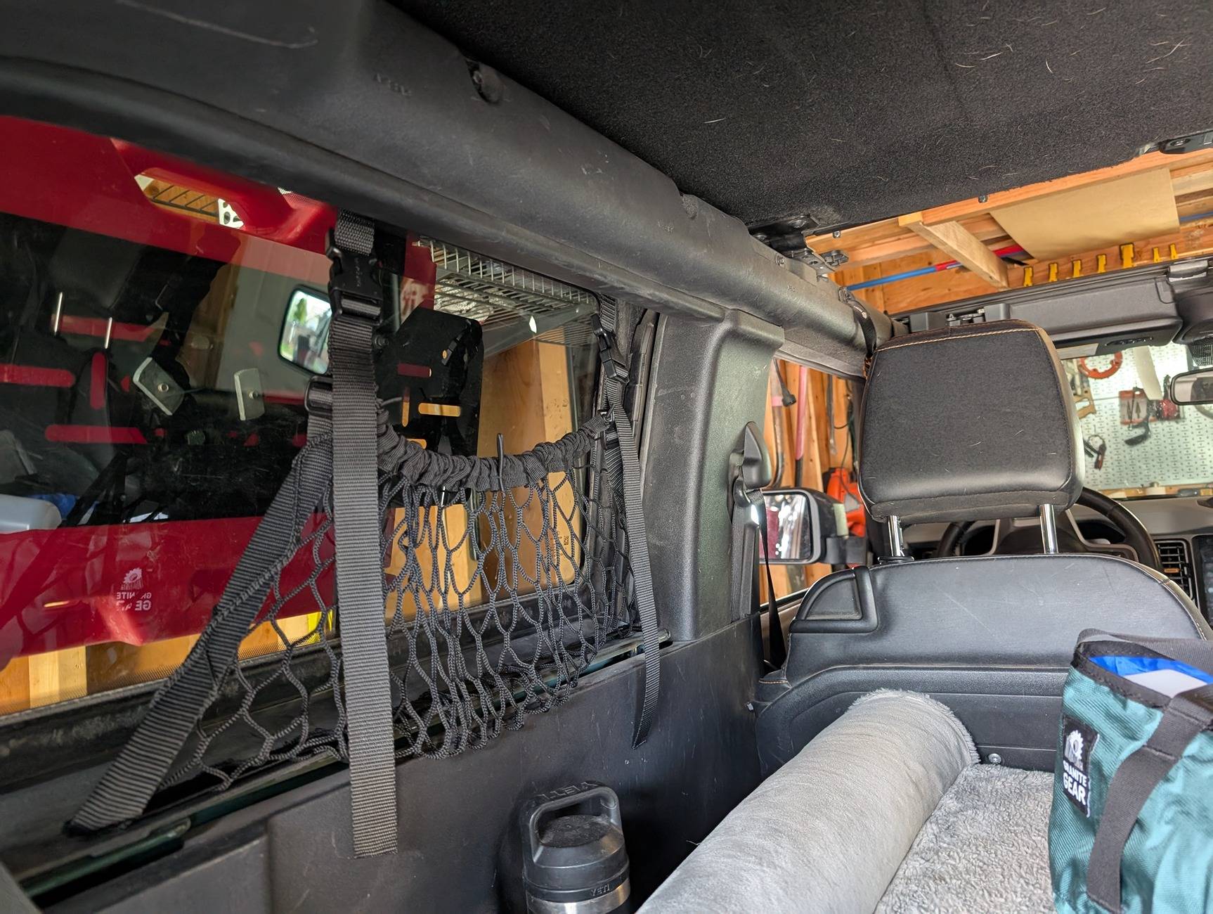

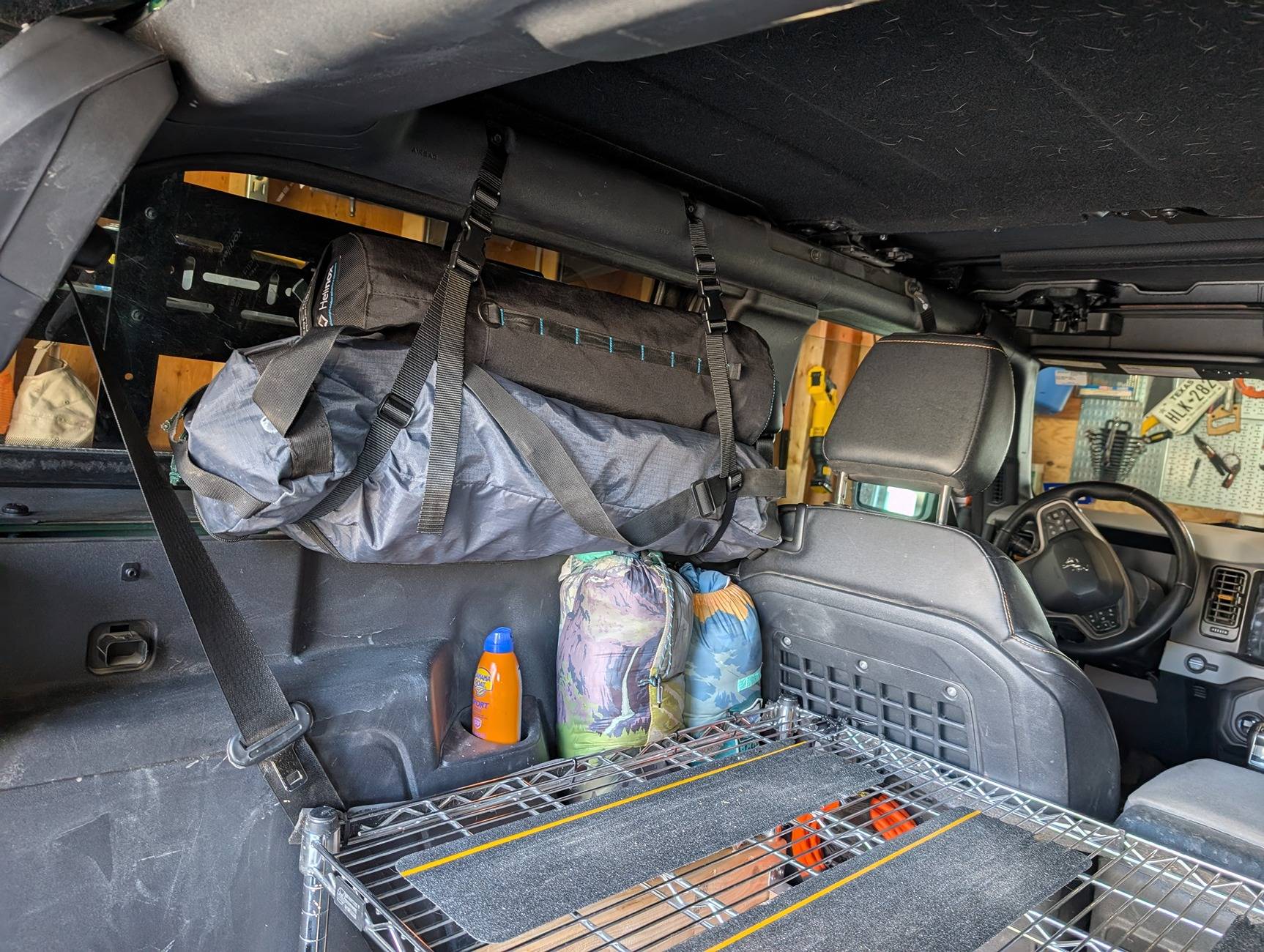

I'm always looking for ways to use space as efficiently as possible in my 2 door. There's a lot of vertical space in the rear I'm currently not using well. I need to leave most of the rear open for my pup, but I've been looking for a way to temporarily store lightweight things along the rear windows when loaded for camping. I know there are a ton of MOLLE panel options for the rear windows, but they're pricey and block views even when not being actively used.
I realized today that I could pretty easily rig up some straps to make a sling of sorts. Hopefully the idea is useful for folks.
Ford Bronco Easy DIY 2-Door rear window cargo sling PXL_20250405_221122606
Ford Bronco Easy DIY 2-Door rear window cargo sling PXL_20250405_220946810
I'm only going to use it for sleeping bags, etc. Things that are bulky and light.

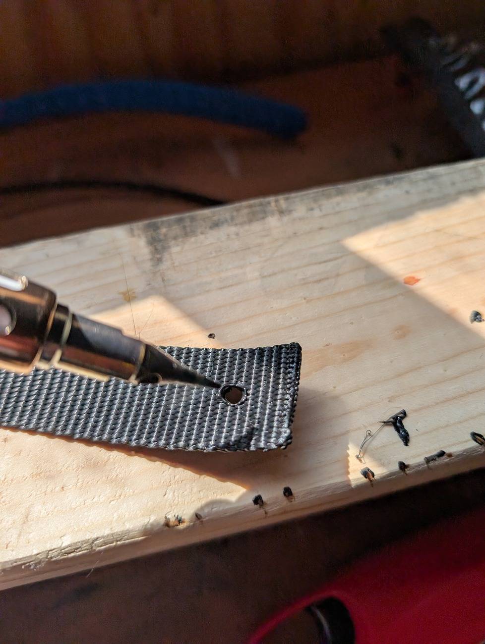

It's just made from standard 1" nylon straps. Melt a hole through with a soldering iron:
Ford Bronco Easy DIY 2-Door rear window cargo sling PXL_20250405_222502798

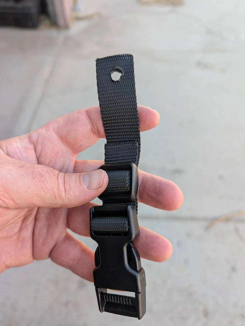

Then build a short strap and a long one, joined by a quick clip:
Ford Bronco Easy DIY 2-Door rear window cargo sling PXL_20250405_223130284
I know you're only using it for light stuff, but a grommet would reallyhelp strengthen your hole and prevent tearing more than just melting with the soldering iron, plus grommet pliers with grommets are like $5 or so. Just a thought maybe just in case it rips or tears in the future. I've had it happen with some of my strap projects and really don't have a set of circumstances where I could say when to use a grommet and when melting was good enough, tears were just random it seemed
I actually do have some grommet pliers, but the grommets I have are quite small and the bolts won't fit through them. They're also beveled and not flat. Melting seemed good enough for now, but yeah, if things tear, I'll get some larger grommets. I'm not too worried about these pulling out for my use case, but I may be being too optimistic.

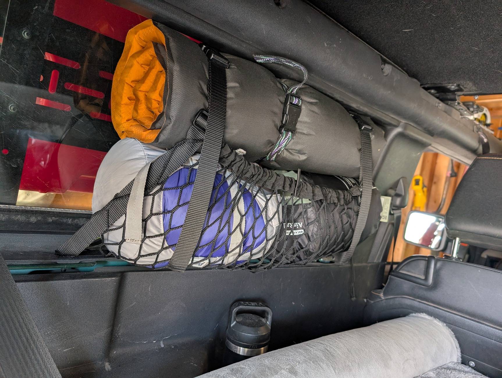

New design: Things now wrap around the outside of the roll bar and I salvaged some elastic netting from a dog barrier that didn't work well. The netting helps keep smaller items in place. No issues with things bouncing around so far, but again, everything there is very light.
Ford Bronco Easy DIY 2-Door rear window cargo sling PXL_20250412_191451983
Ford Bronco Easy DIY 2-Door rear window cargo sling PXL_20250412_191726799
