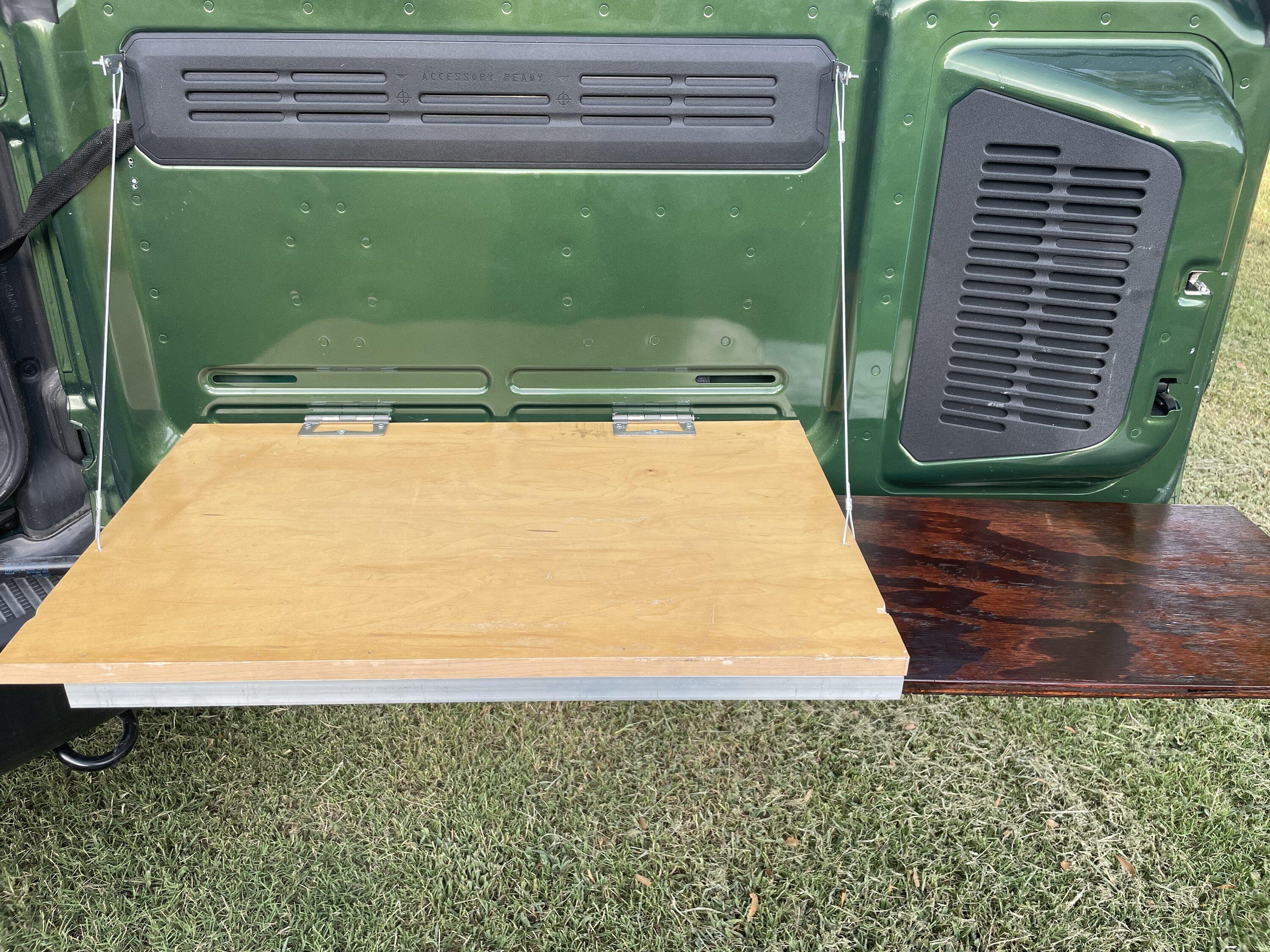

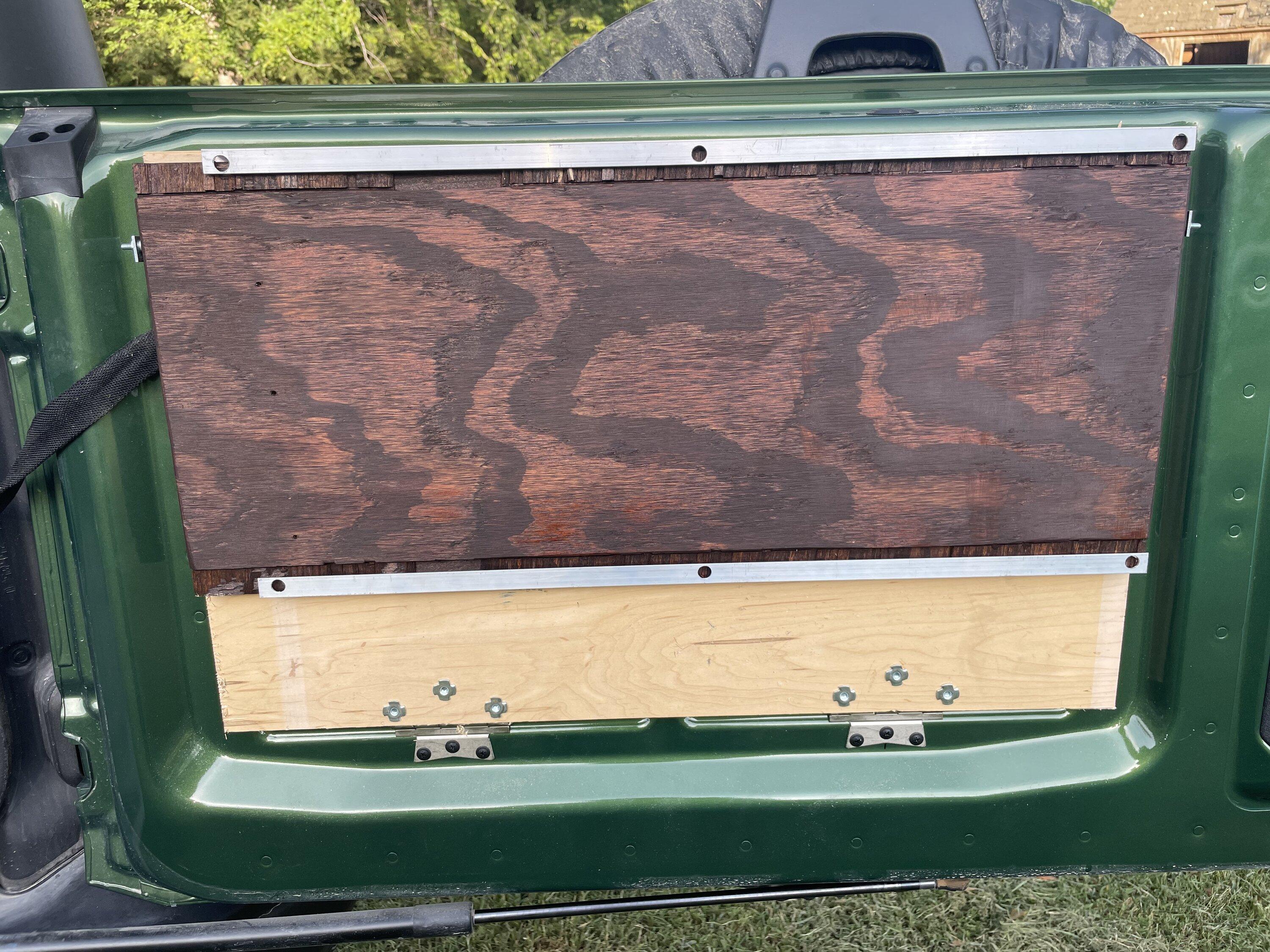

So we are leaving Sunday for a trip and I didn’t have time to buy a rear table. Plus I’m not a fan of most of them. Why would they have holes for drinks? 🤷‍♂️
So I built this table for about $25.
I cut to boards at the sizes I wanted.
Ford Bronco Cheap and easy DIY rear door table, $25. C83E7FD7-8285-478E-8A15-9AAD7513DFC0

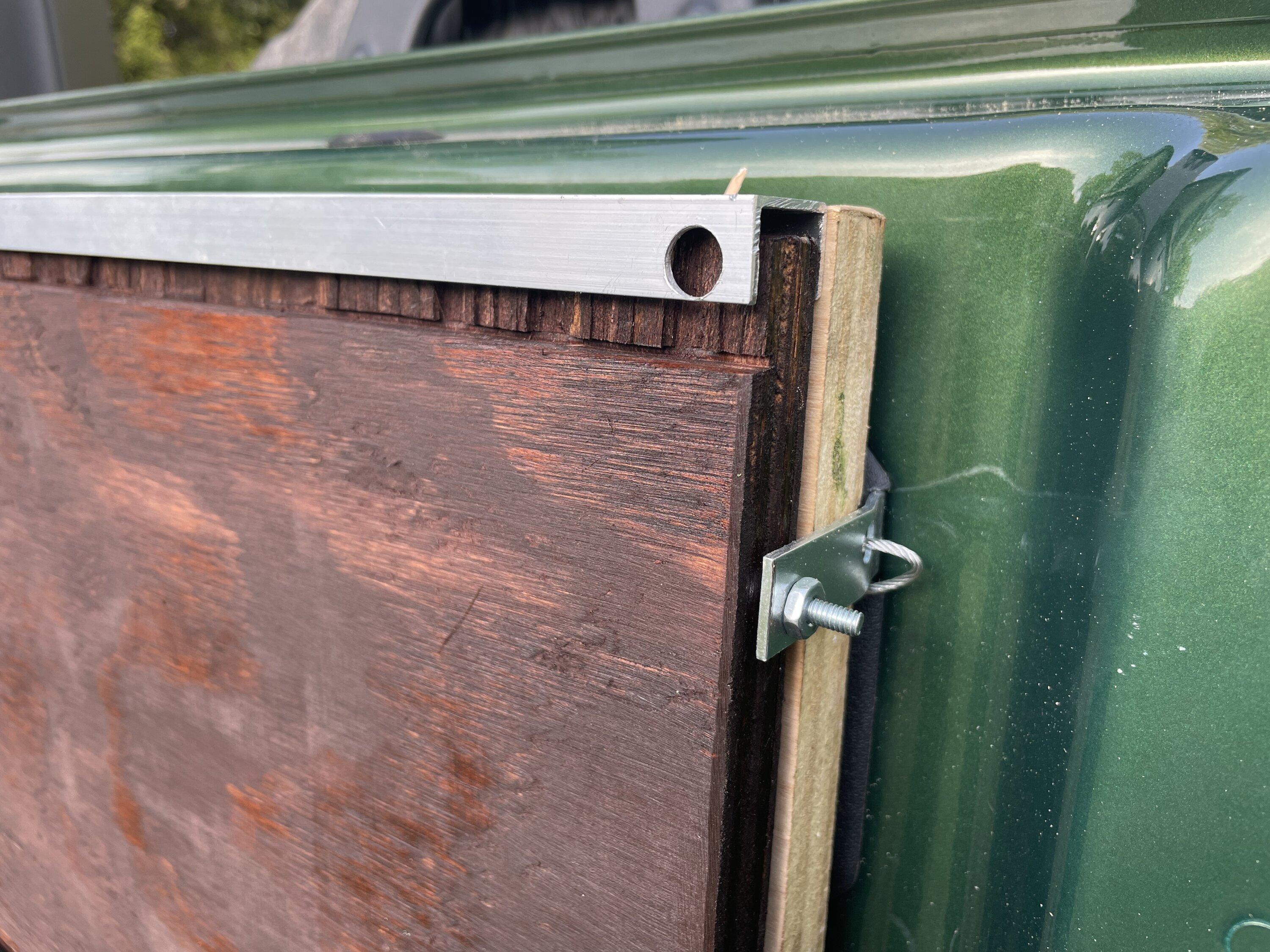

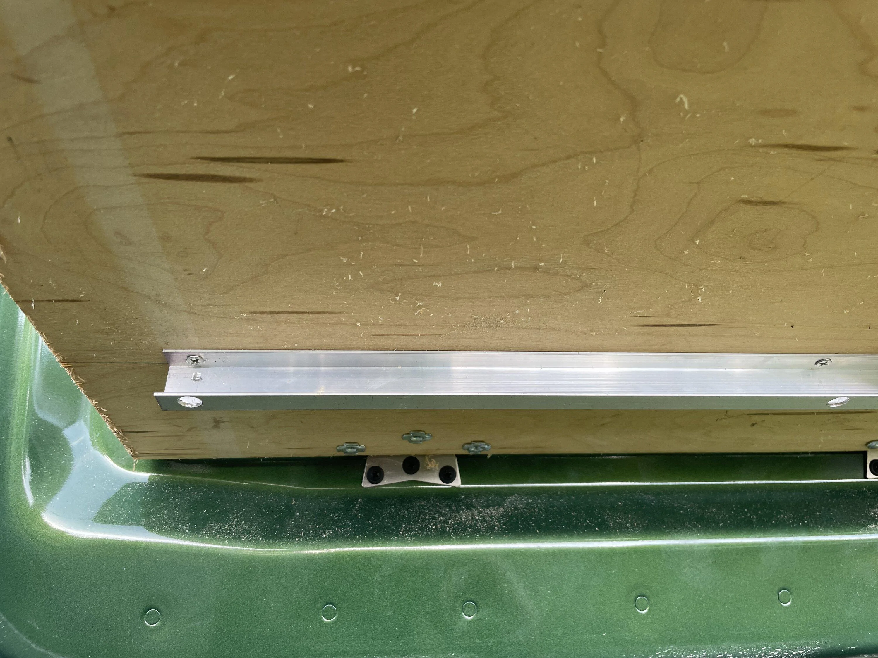

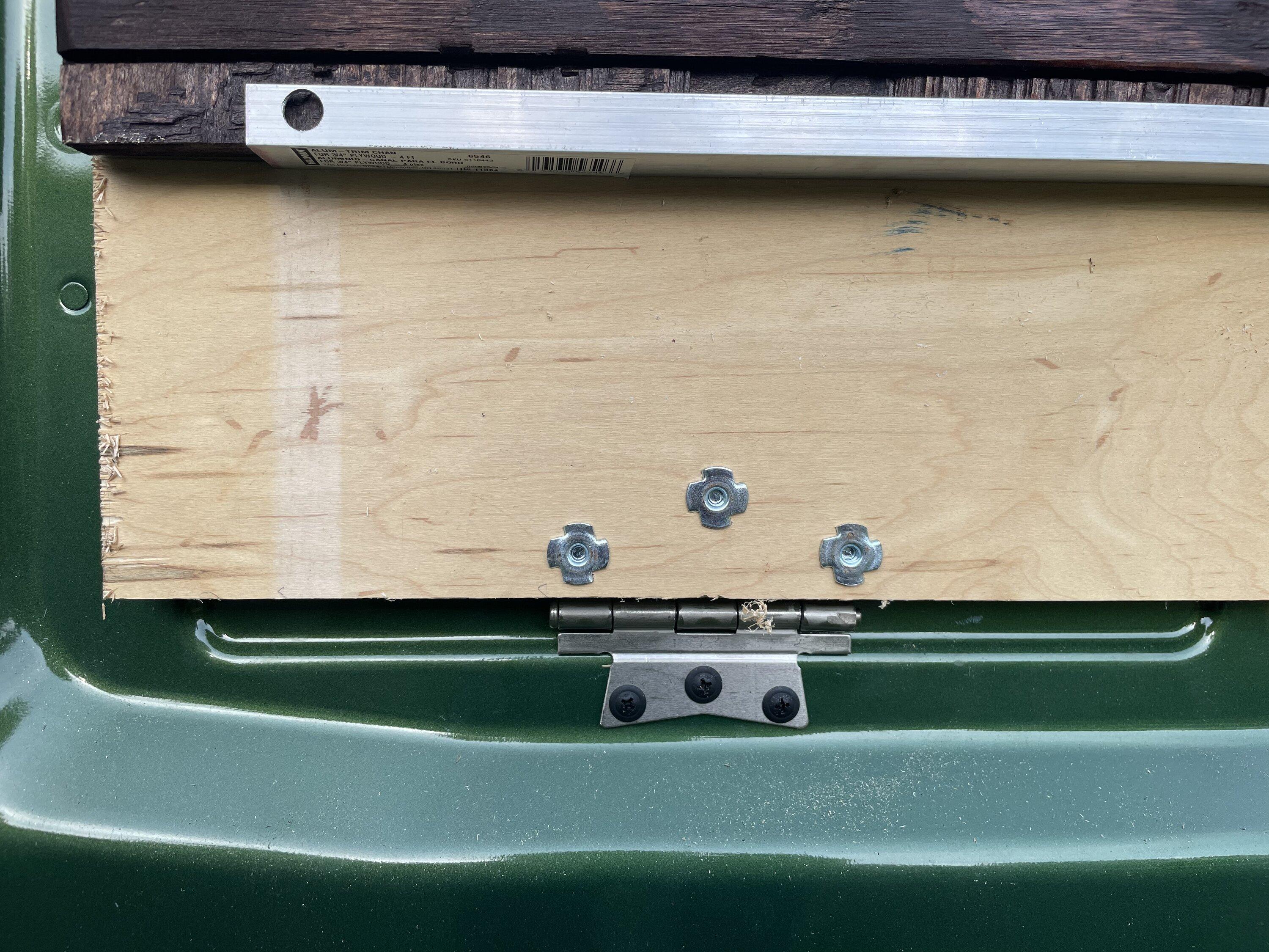

I picked up a 4’ stick of aluminum C channel and mounted underneath. Drilled holes for screws and one side bigger to get screwdriver through.
Ford Bronco Cheap and easy DIY rear door table, $25. B50C42F7-BF7A-43D1-A31D-F8B310A009FD
I had some stainless hinges in my shop. But they can be picked up for about $5 a set. I used some machine screws through the wood and self tapping screws in the door. If this table stays, I’ll replace the screws with RevNuts.

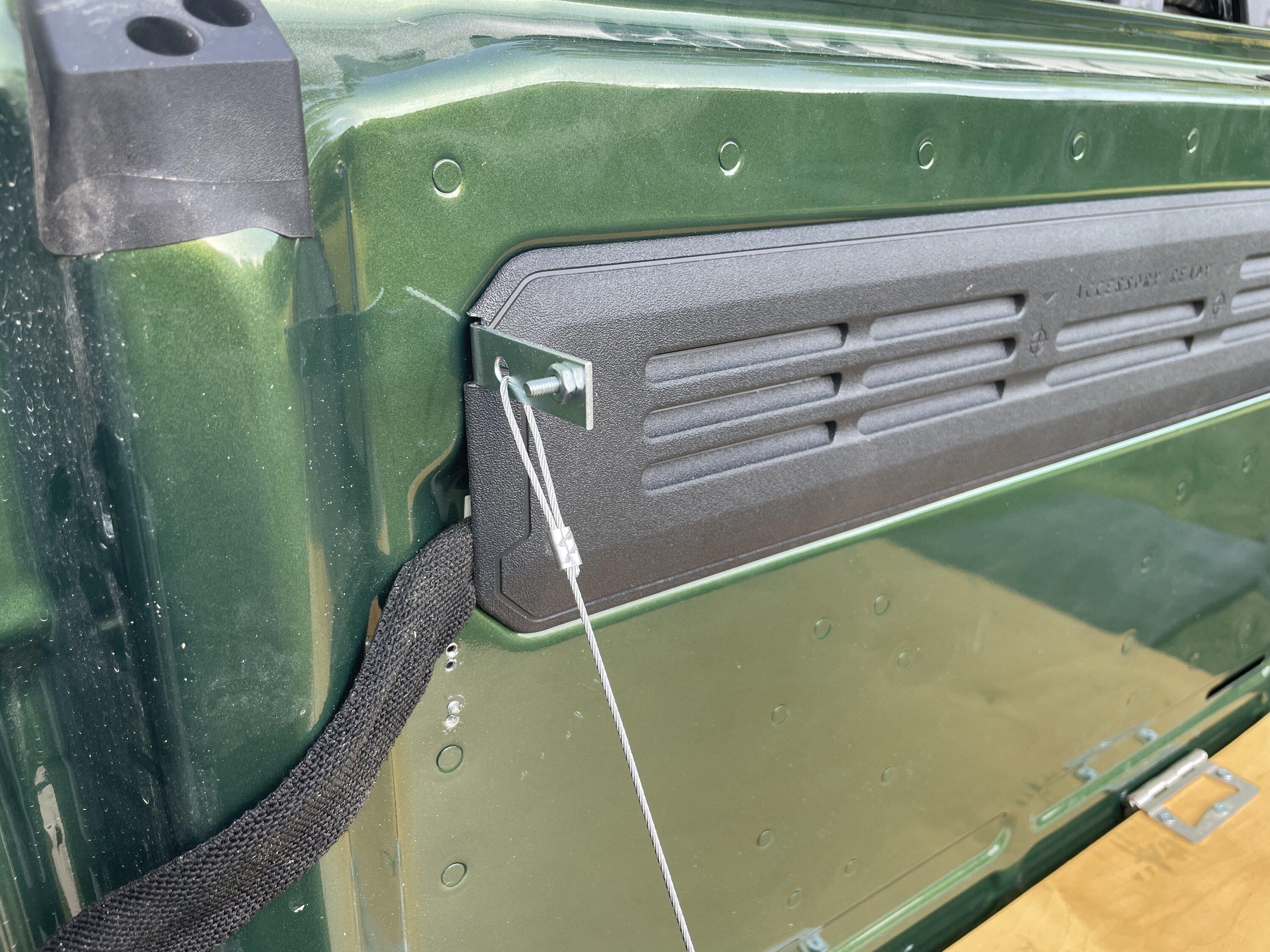

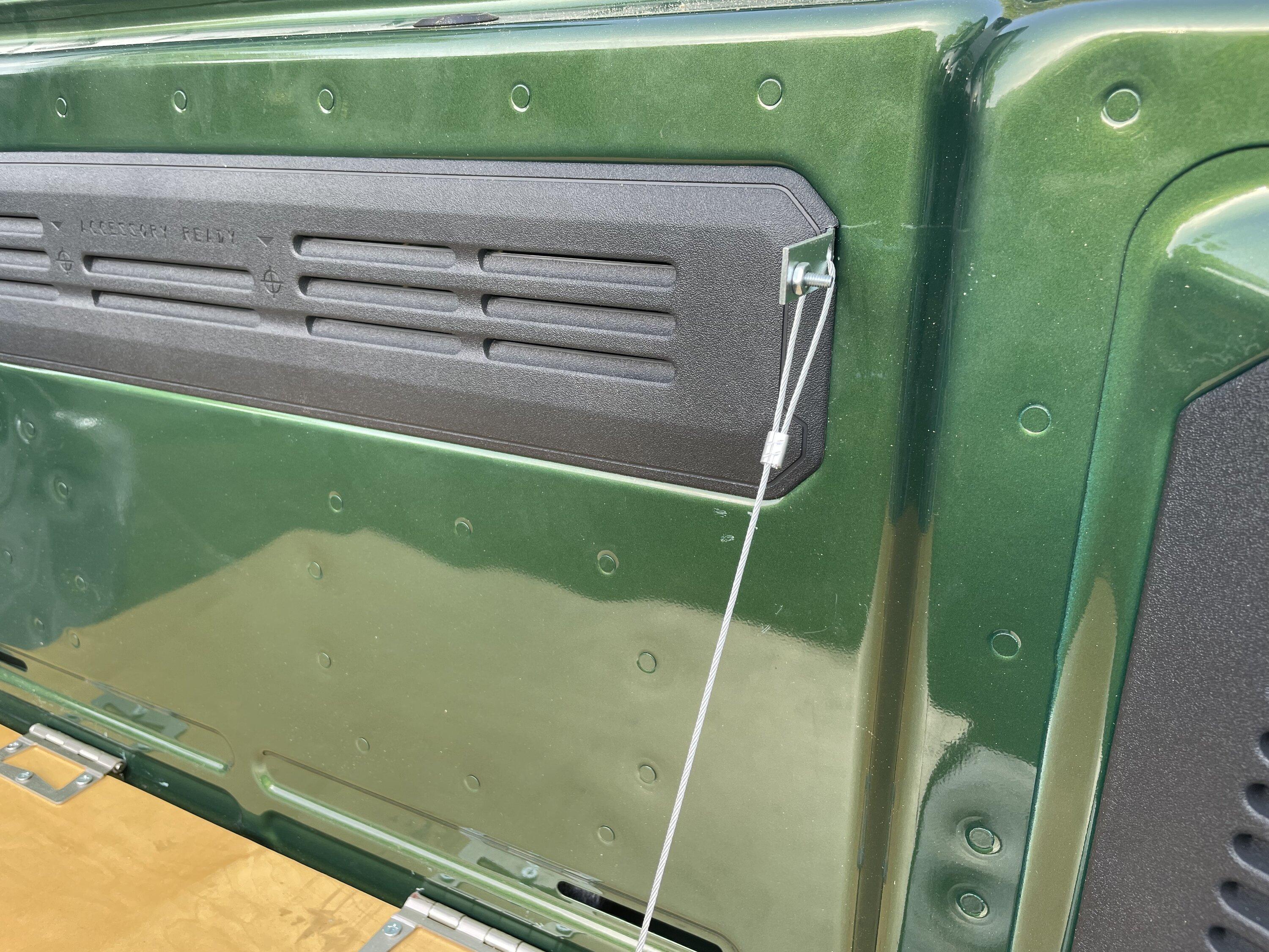

To hook up cables I took 2 L brackets and bolted them under the plastic cover. Then trimmed the cover. Drilled holes for cable in board and made cables. L bracket and stainless cables about $5.

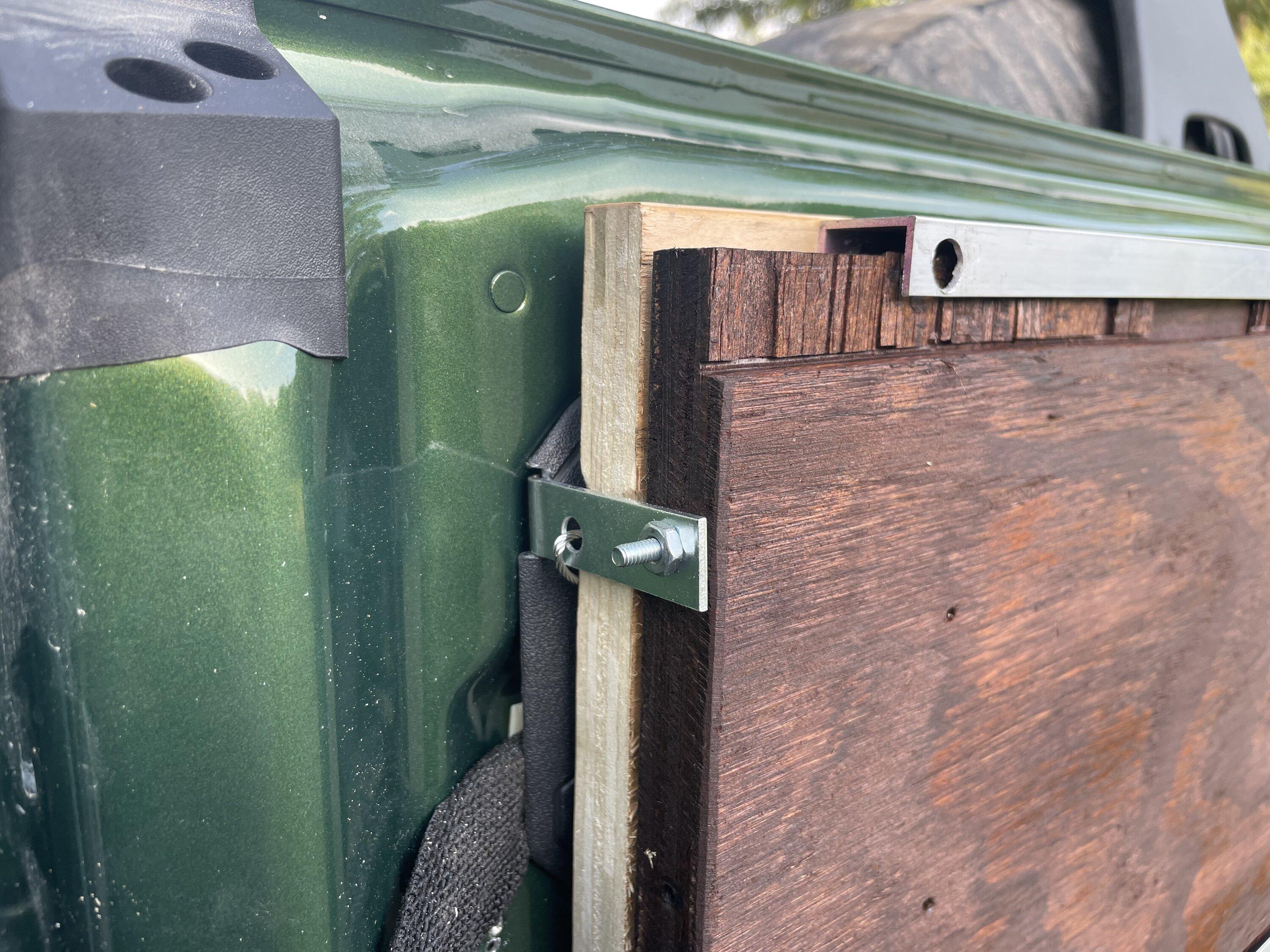

Plus I added the screw and nut to hold the table up when folded. Had plan to cut extra off but this just ended up being an easy way to hold table up.
Ford Bronco Cheap and easy DIY rear door table, $25. 0264497D-AEC4-4CB1-B7E1-41704D50BDDD

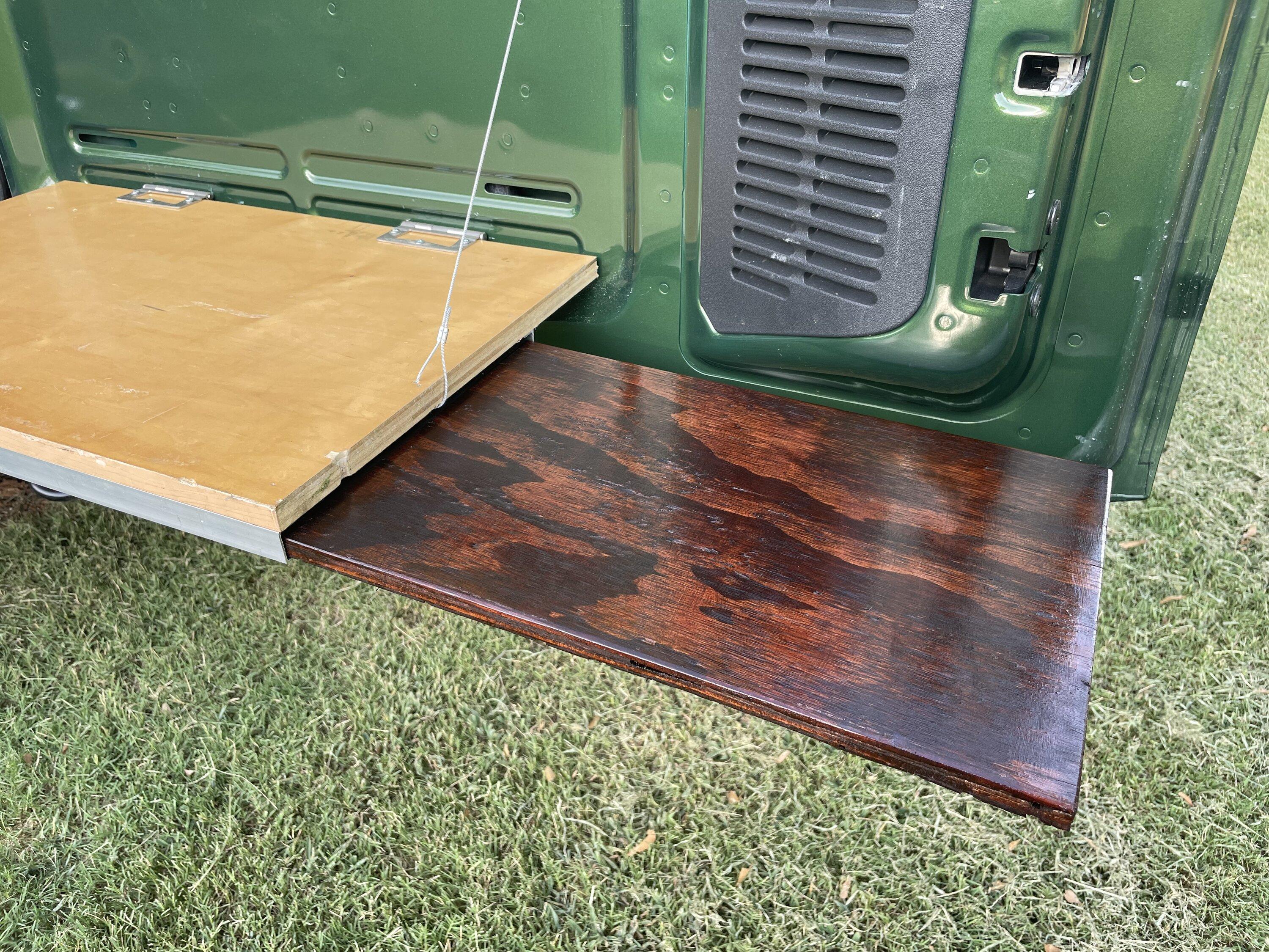

You can also see how I had to cut a layer off of the plywood. Ugly on bottom but top looks just fine.
Ford Bronco Cheap and easy DIY rear door table, $25. E340184D-C1B9-4EE7-BFB4-444DB5422C99
I used scrap wood. Lighter color is from a shelf and the darker is just plywood. I sanded a little, stained and then clear coated it.
Ford Bronco Cheap and easy DIY rear door table, $25. 7DB2505F-885A-4697-B03B-D9506B991D20
It’s far from perfect but for a few hours and $25, it’s going to work great for now.

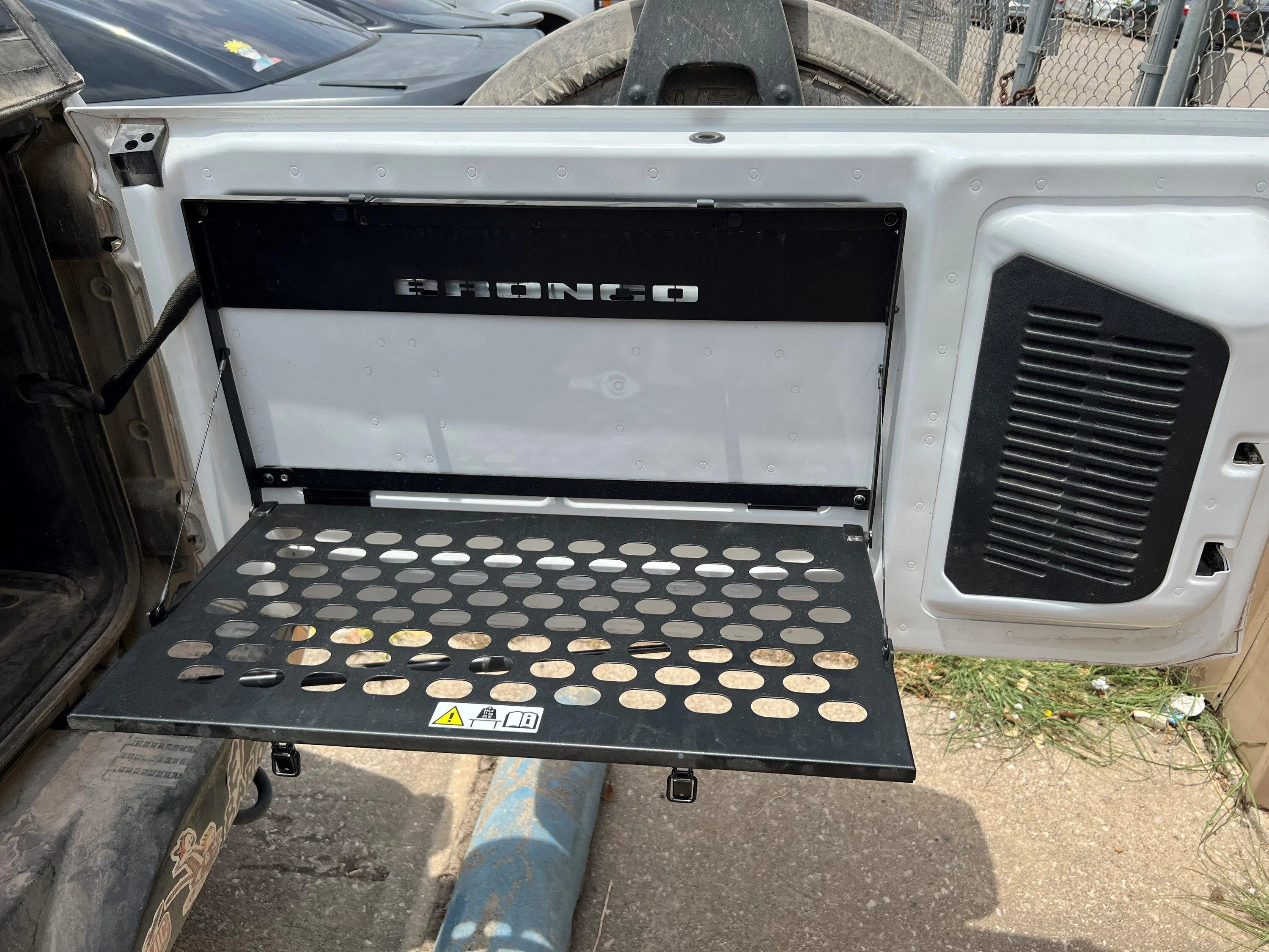

Doesn’t the Ford’s have holes for cups?
dadjoke
Aug 5, 2020
178
278
Southern California
'22 Bronco Big Bend 4-Door 2.7 MIC Auto Sasquatch
Mine does not. Although during research while trying to deal with the "factory nutserts suck" issue I noticed there are small differences in the Ford ones over time, like they switch designs in minor ways. Maybe one version does have them?

No idea why they need to put those holes when its main purpose is a table,bench etc. Not a mollie tool holder. A table with 40 holes in it. 🤦🏼‍♂️
