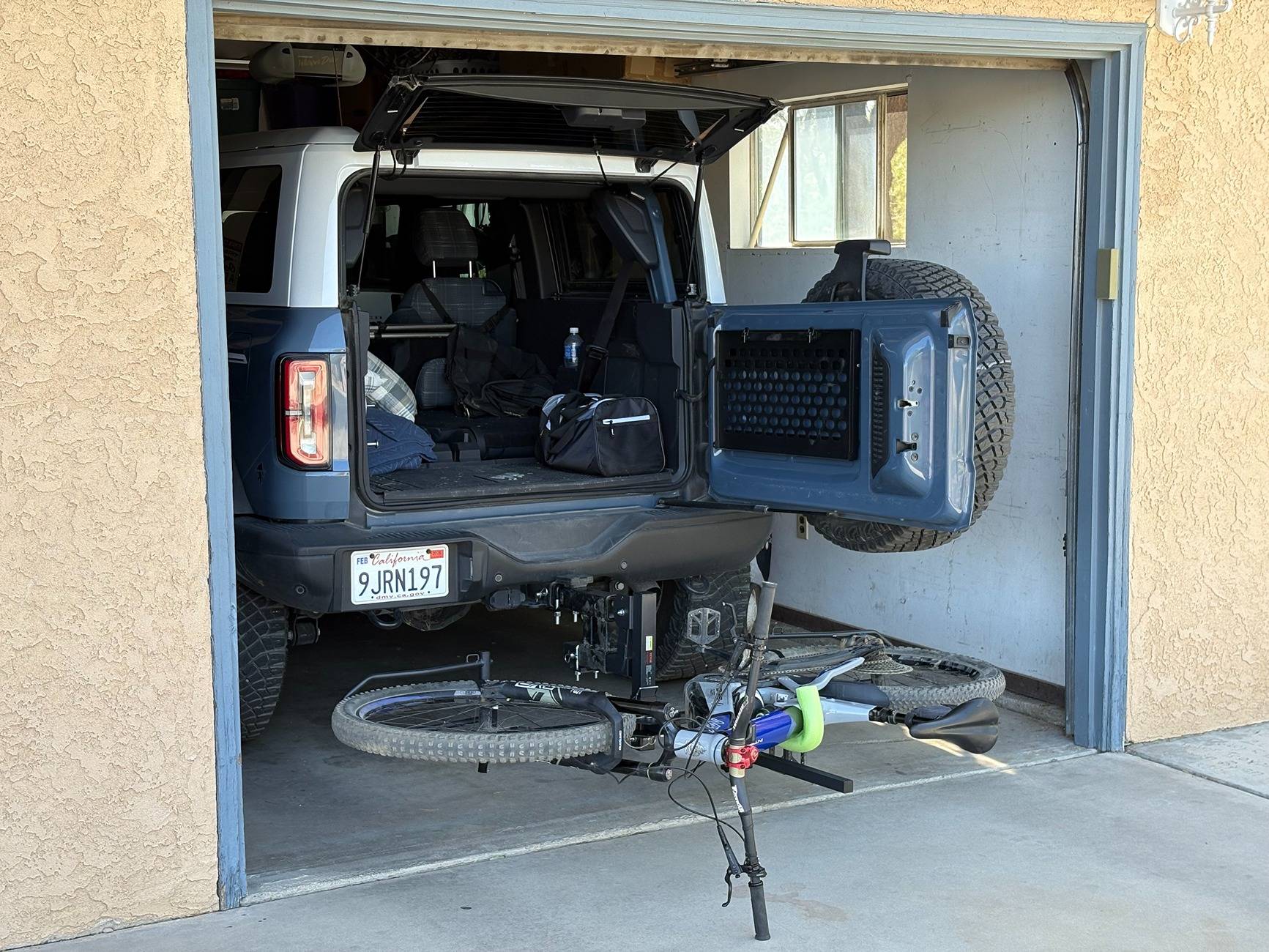

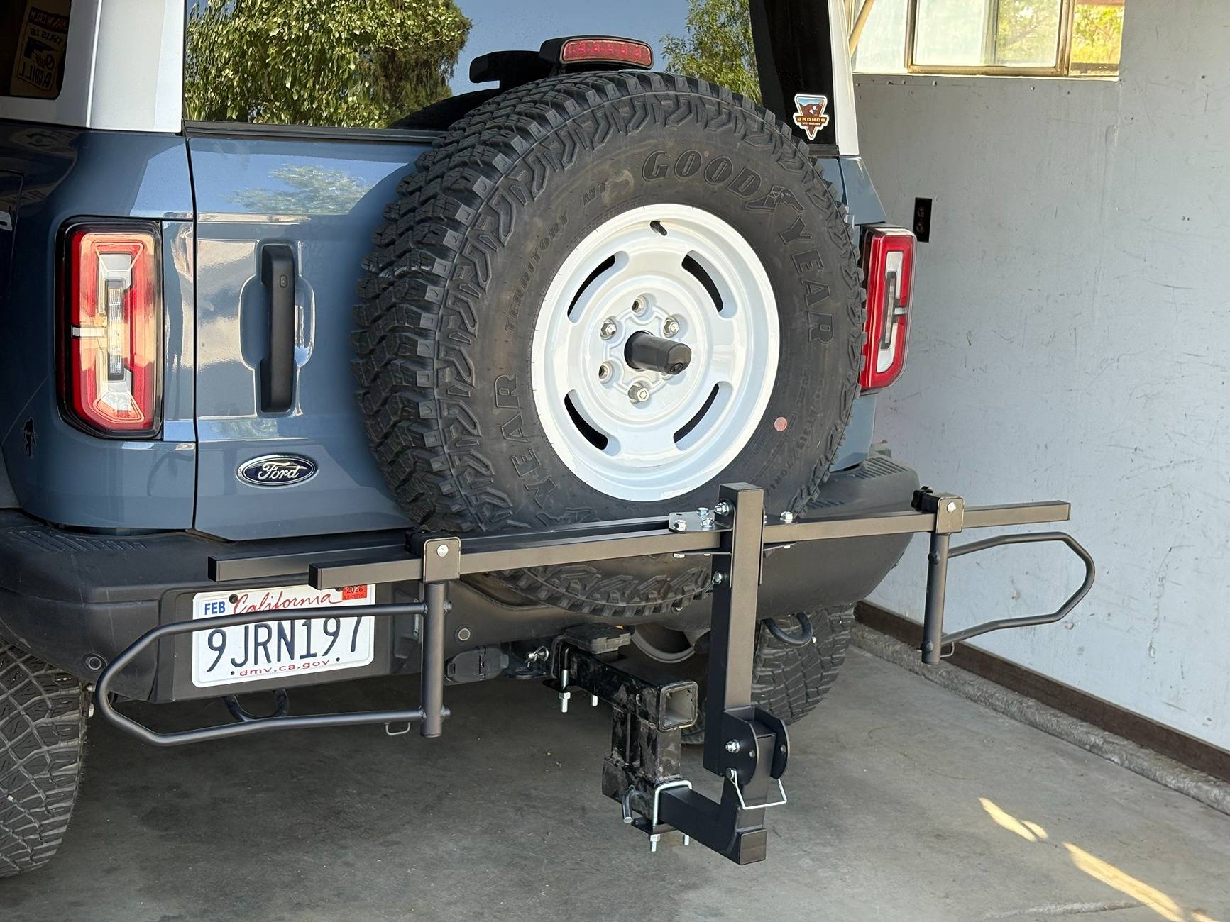

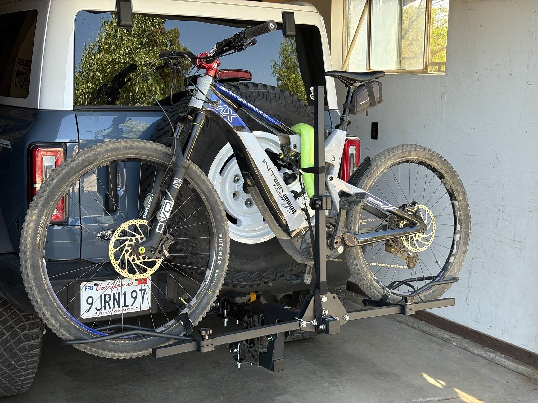

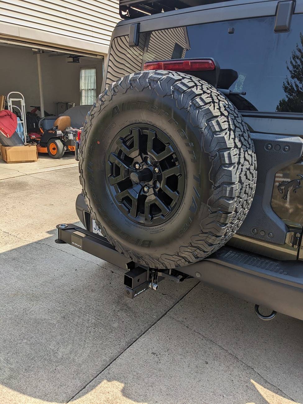

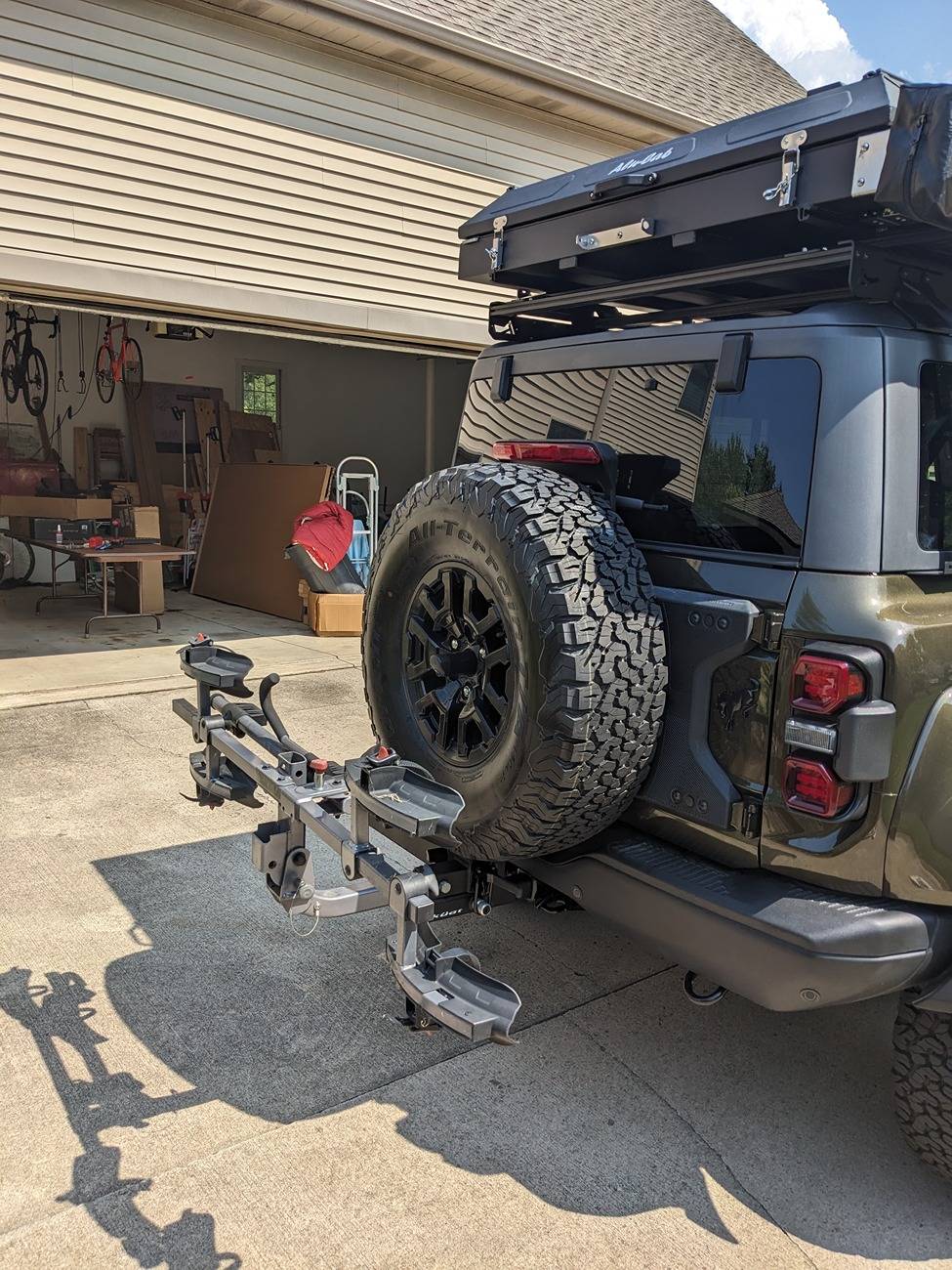

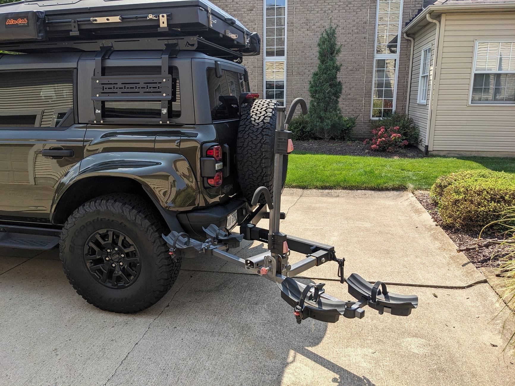

I got a bike rack and even when it is laid down it sticks up enough to block the tail gate from opening. I got a dual hitch extender from HF and used it upside down to lower the rack. The amount it lowers it is the same amount as the rise on the rack so now the tail gate clears. It also extends it out just far enough to allow the rack to fold up. I definitely lose some ground clearance so I won't take it off road, but so far it has been great.

Seems like an accident waiting to happen with opening the tailgate and having a bike right behind your legs. That said, it does do what it needs to do by giving you cargo access with a bike.
I agree it is not ideal. I have to step around the bike, but at least I can open the door and get to my stuff.

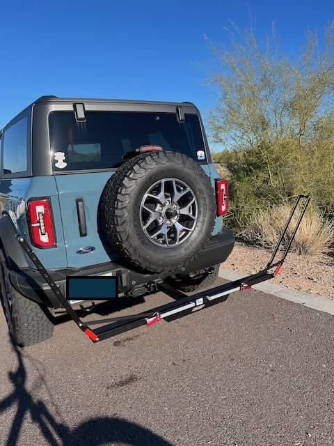

I built a simple custom rack that cleanly solves the problem:
Ford Bronco Hitch extender installed - allows opening tailgate with a bike rack on IMG_9956
It's a 1up roof rack bolted to some 2x2 bar stock welded into a T-shape. Works great.

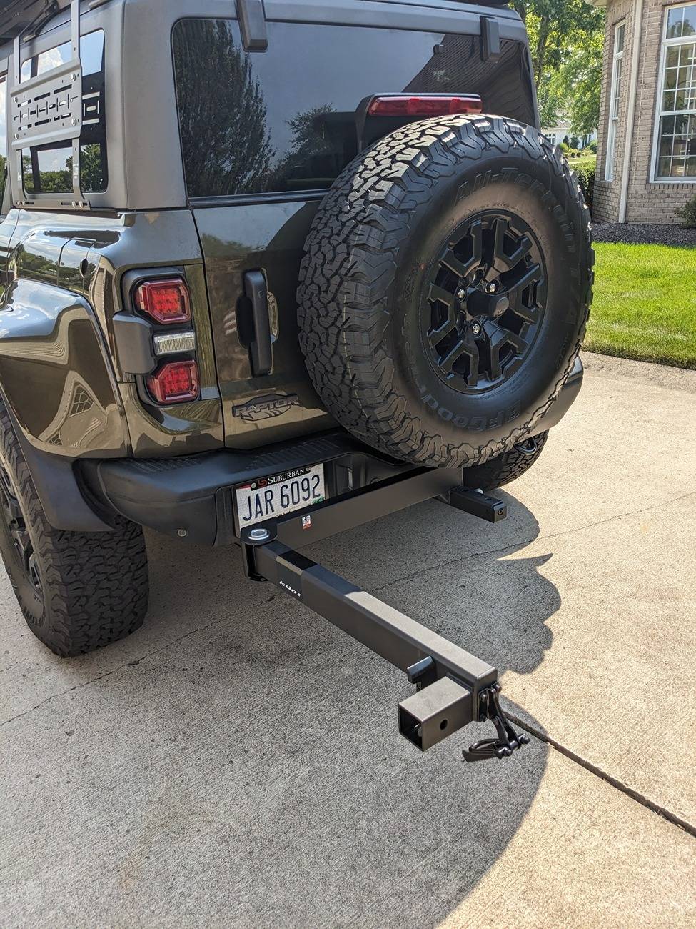

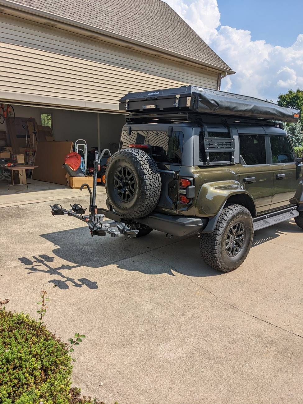

I have an extender + Kuat swing arm (which swings more than 90 degrees if needed) + 1UP, but i have the swing to the right (away from the road if you unload in traffic). This also allows wider access to the rear (I have a slide-out tray that wouldn't allow left-side access with a left swing). Long story short, it's not as simple as it appears.
