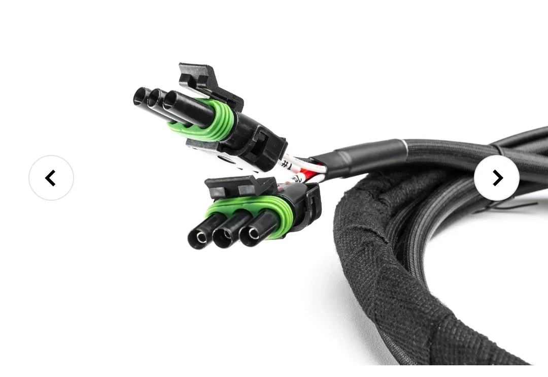

But we went a step further with our plug n play pieces. To allow you with BIG lights, to still use your tail lights to trigger them...
How? Well, we have an adapter that can plug in between them. It accepts the signal from the tail light to trigger reverse lights. It loops back up the white wire to the engine bay to connect to a relay and then send the power back down to the rear lights on the red wire.
Doing it this way, you can still maintain your backlights signal from the tail/running lights if your lights have them. This is because it breaks the connections between the white wire on the long extension and the one coming from the tail lights. So if you have a bumper with bigger light bars. This is your plug n play solution.

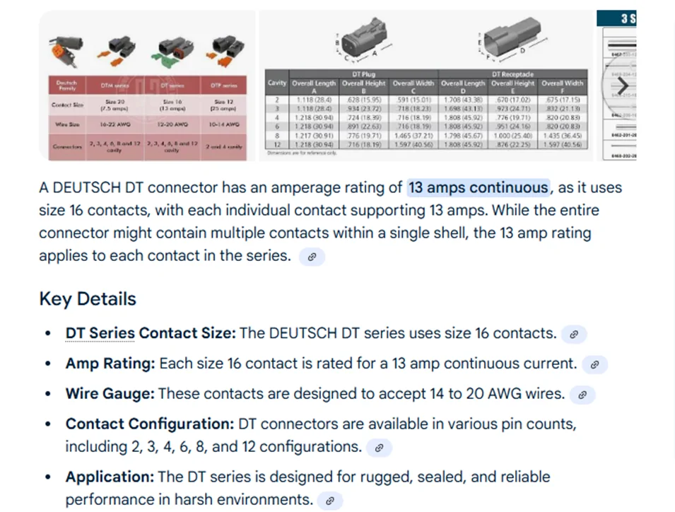

Aside from Baja Designs compatibility, any particular reason for using these awful connectors vs the IMO far nicer Deutsch connectors?
100% agree. After a few months of use, the plastic connectors/tabs become very brittle and just break off instead of coming “unclipped” like they should if/when you need to disconnect. Then you’re screwed once the release tab is broken off and you have to redo the entire connector.
I can’t be the only one who thinks this right? I bought a box of Chinese connectors (same ones) on Amazon to replace them as they break.

Yea they're awful. Harder to plug/unplug, bulky with lots of edges so harder to snake through tight places, and more fragile. I was actually shocked when I spent thousands of dollars on BD lights for them to arrive with those plugs. I keep a bunch of Deutsch connectors around for building harnesses and plan to eventually replace all the plugs on my BD lights.

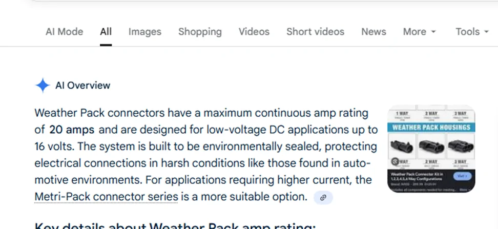

Absolutely there was a reason. (See 2 screen shots)
While DT connectors are convenient. They can only handle 13 max amps.
Weatherpack can handle 20 amps.
Thats why Rigid light bars are bare wires. So there is a balance between melting your wiring, using connectors, or straight but splices. While I would prefer to use simple DT connectors. look at a couple scenarios. To have a plug in to begin with vs butt splices, the pins and connectors have to handle the power load.
LP6 Lights - 7.5 amps each (2 combined melts the combining connector from the pins getting too hot)
30" ONX6 light bar -15 amps
40" ONX6 20 amps
ETC.
at just 13 amps, the DT connectors are way too restrictive. While several individual lights can plug into them. Often times you combine pairs or several together. Then they pass through single connectors. That's when heat happens and fires as you've probably seen or heard horror stories.
So the main reason isn't because they are cheaper, but because amp wise they can handle much more. 35% more power.
Hope this helps.
