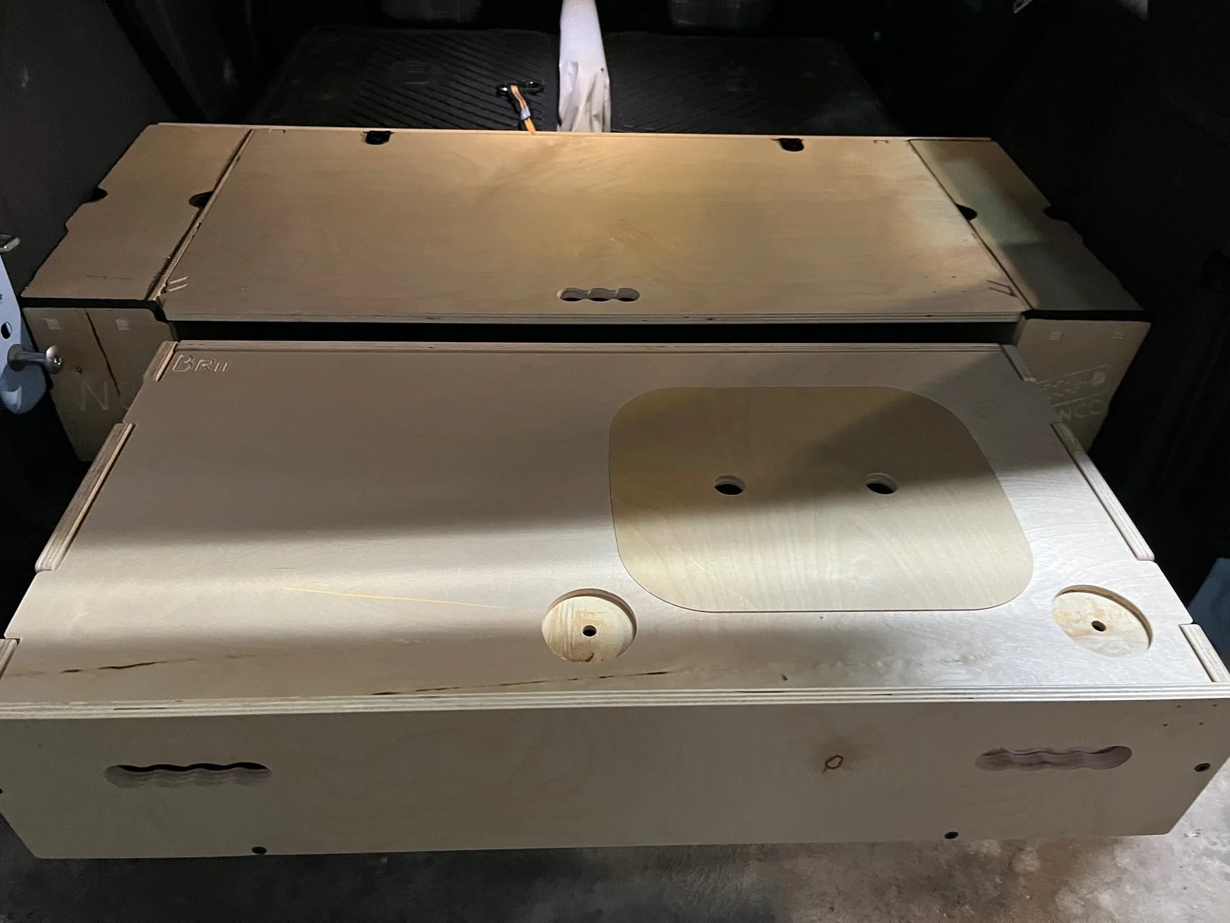

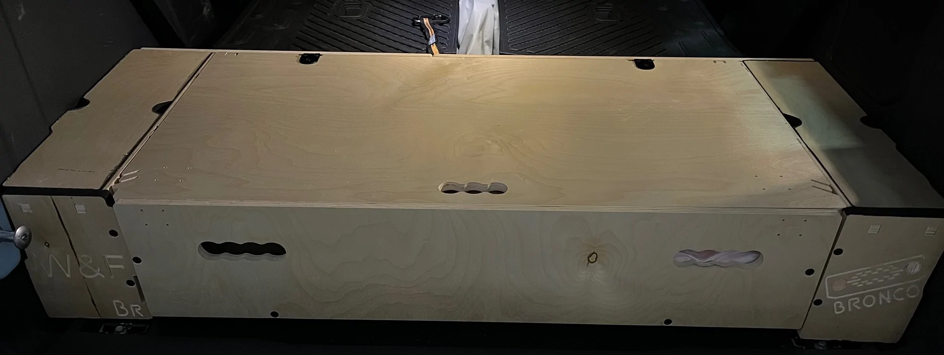

Here is the completed install with my back seats folded flat - their website says that they have a model for those that removed seats, but I wanted to keep my seats in place. Note that the left side is slightly different than the right to allow the tailgate indentation to fit properly. I have a tailgate mounted table that did not interfere with the drawer.

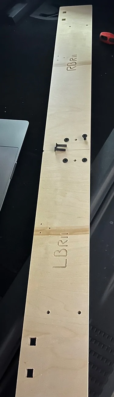

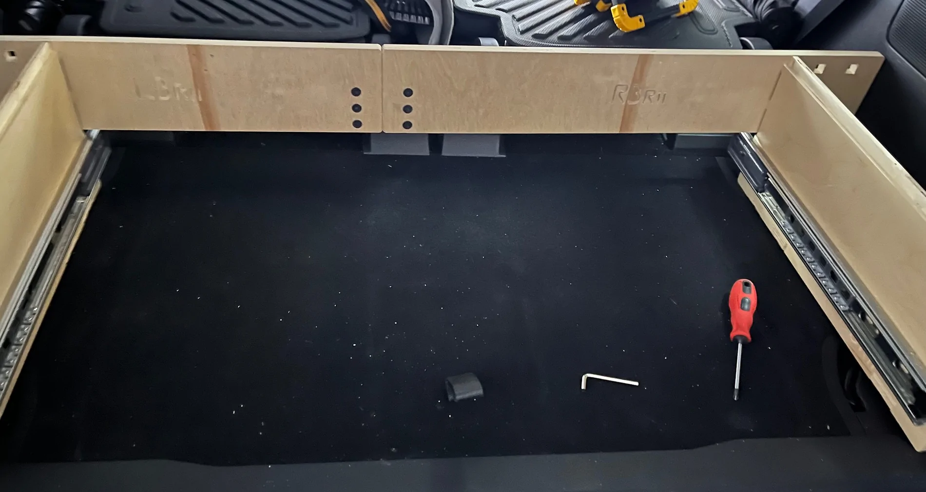

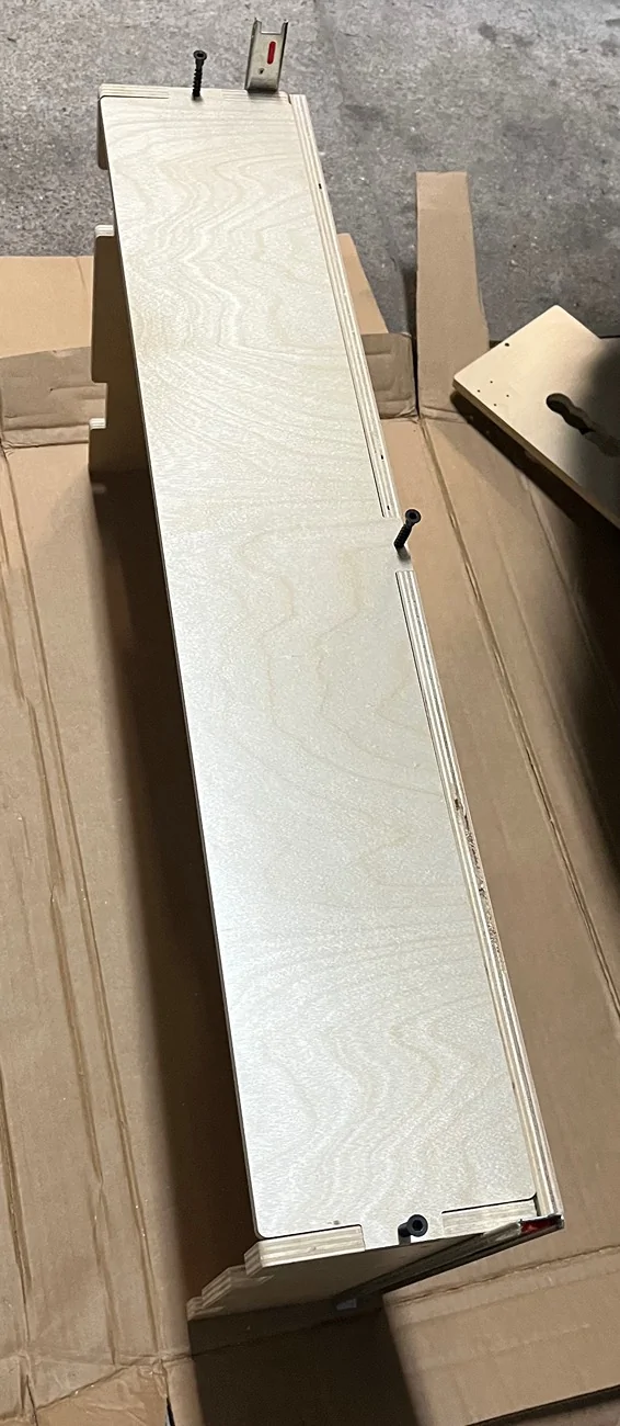

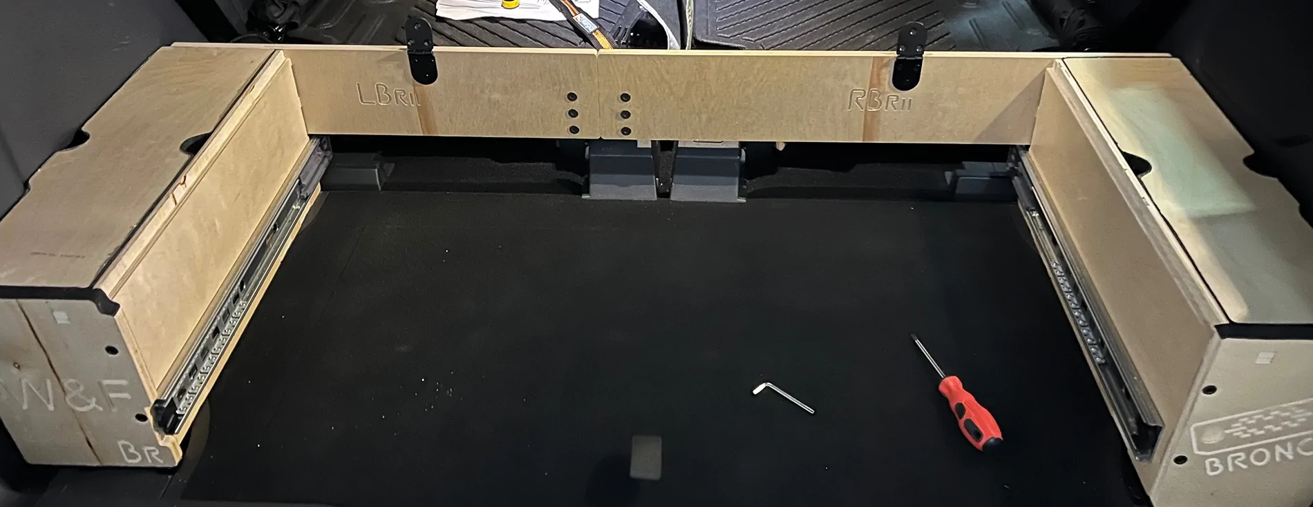

The first piece appears to be one piece in the instructions, but it is two pieces that are joined with 6 of the M6 x 25 screws.
Panels and pieces are marked "L" and "R" which reference the left or right of the drawer as viewed from the back of the truck looking forward.

The majority of the remaining screws are M6 x 40.

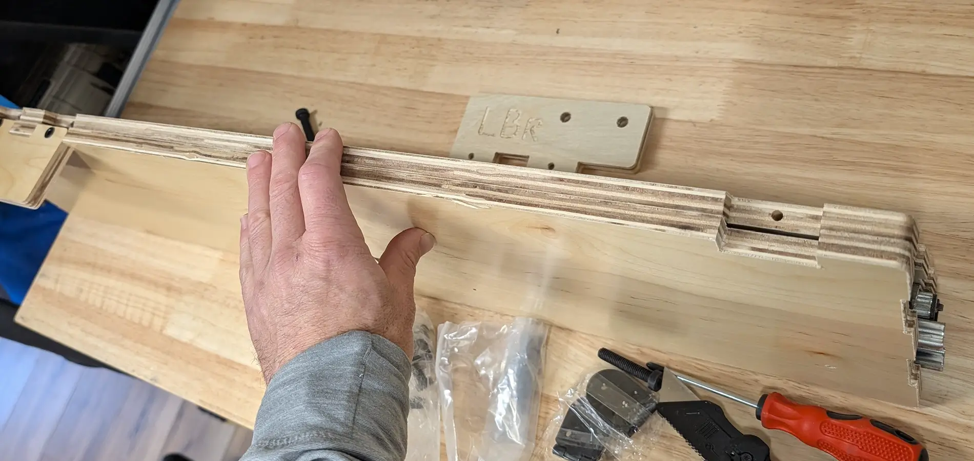

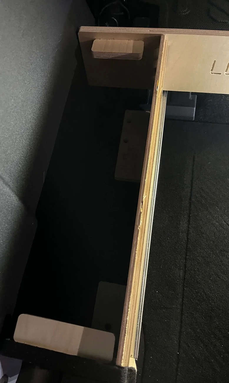

Next, both the left and right side of the base need to have the pieces that allow you to secure the system to the locations of the tie downs. They are secured on the bottom of the pieces that have the drawer slides - the larger of the two requires two screws while the smaller takes one. The drawer slides are on the interior of the piece for both the left and the right sides. Both of the smaller pieces are installed so that the writing Is facing up while the writing on the pieces that have the slides are facing the space where the drawer will be located.
Ford Bronco Wheels & Feels drawer storage system install on a 2024 2 Door IMG_4290
Once the two drawer sides are assembled attach the first piece to the two side pieces using two screws on each side - completed it looks like this. Note how the first, longer piece's joint is not centered with the left side being shorter.

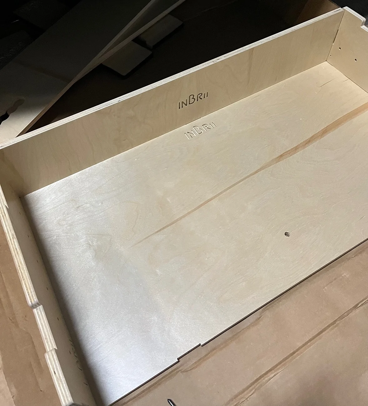

On the drawer, each side is secured to the base with two screws on each side which are located at the base of the side pieces, below the drawer guides. The guides extend beyond the surface of the drawer as shown on the side that has the notch in the base of the drawer bottom.
Ford Bronco Wheels & Feels drawer storage system install on a 2024 2 Door IMG_4293
The back of the drawer is installed with three screws, one on each side and one centered attaching to the bottom of the drawer.
Ford Bronco Wheels & Feels drawer storage system install on a 2024 2 Door IMG_4294
The front of the drawer is installed with four screws as shown. All writing faces the interior of the drawer.

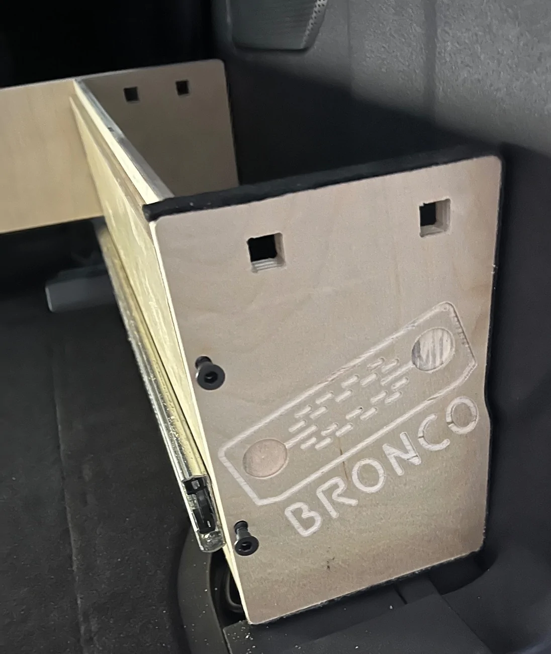

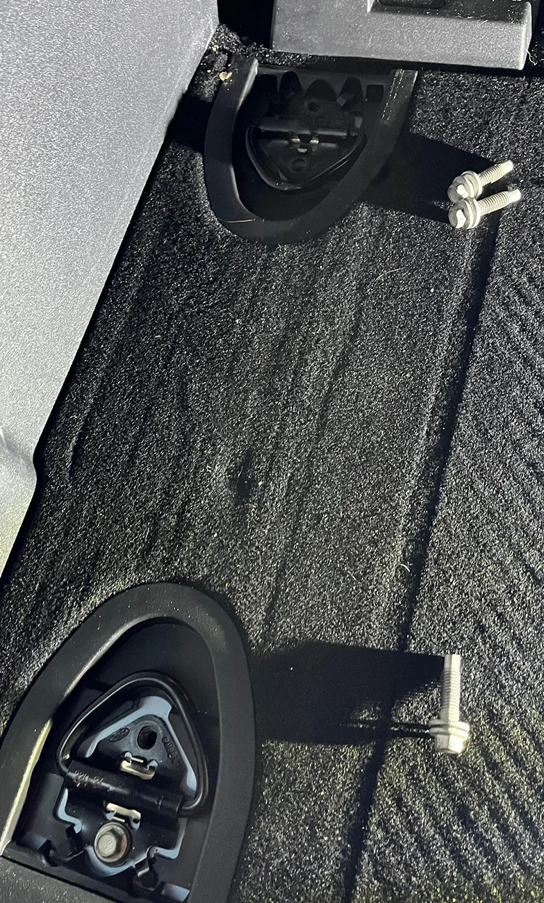

Using a 10mm socket, remove three M8 x 1.25 pitched bolts as shown - two forward and the forward most of the rear tie down point. The instructions show that you can re-use this hardware, but it is not possible as they are too short. I purchased 6 each M8 x 50mm 1.25 pitch bolts and washers that allowed enough thread to hold the drawer in place. Additionally, the plastic covers can not be reused when you install the drawer. The kit comes with 6 M6 x 40 bolts, but unfortunately on my 2024 they are not the correct size.
I do not have a picture of the bolts installed as I had to install them after a trip to the hardware store. I used a 16p nail to help align the holes and had no significant issues bolting the system in place.

On each side use two screws to attach the end pieces as shown.

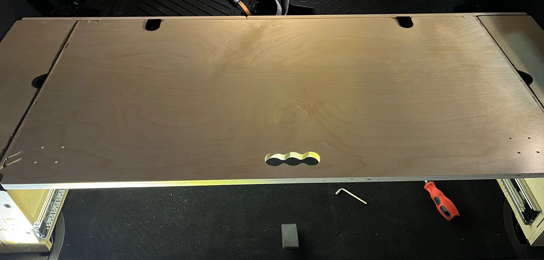

Next, Install the two hinges as shown with three of the small wood screws each - I also have placed the removable covers over each side.
Ford Bronco Wheels & Feels drawer storage system install on a 2024 2 Door IMG_4300
Attach the lid using three more wood screws per side as shown.

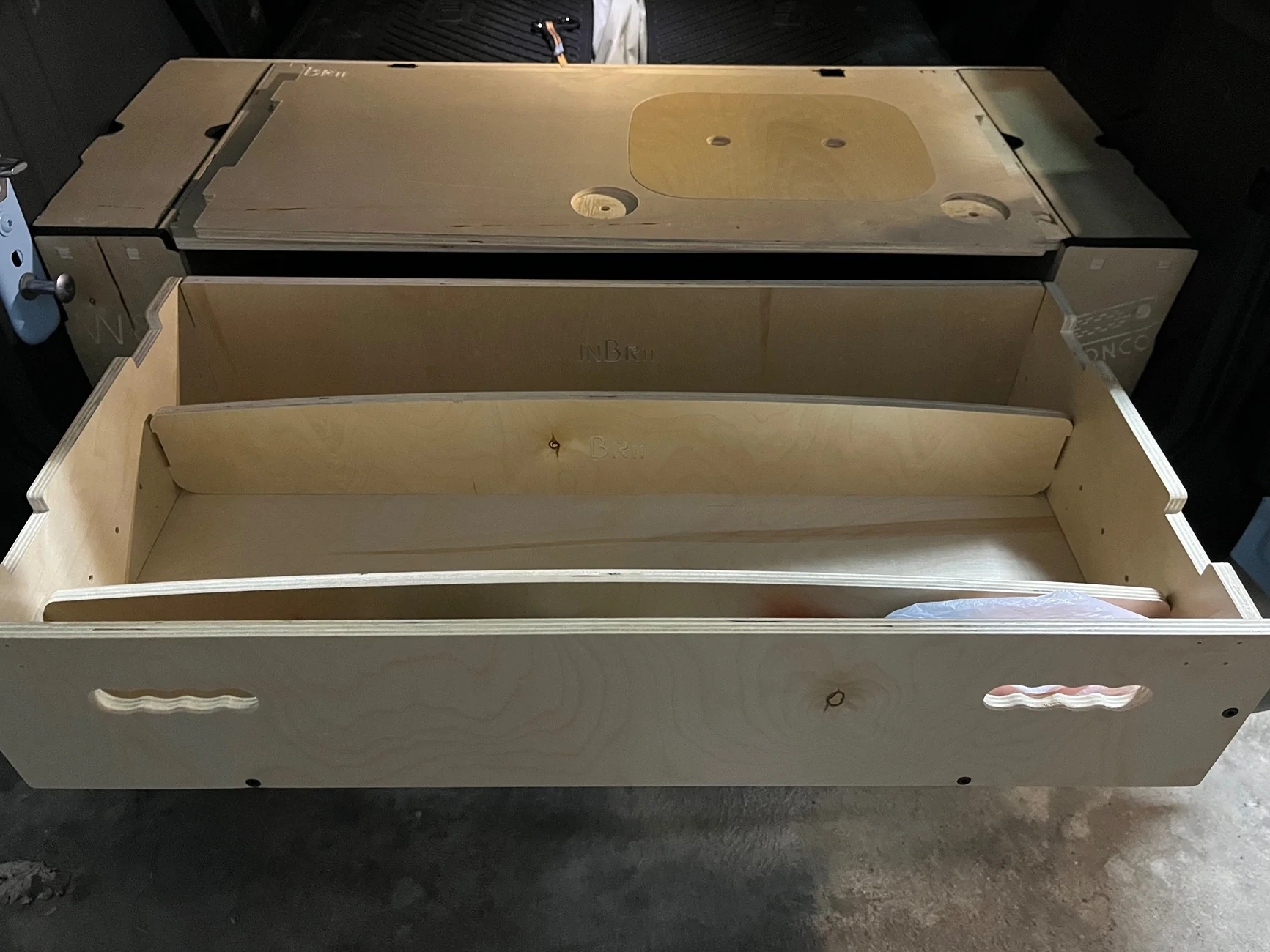

Finally, carefully install the drawer rails into the slides - this must be done straight and at the same time to prevent misalignment. Gently push the drawer all the way into its space.
Ford Bronco Wheels & Feels drawer storage system install on a 2024 2 Door IMG_4304
Ford Bronco Wheels & Feels drawer storage system install on a 2024 2 Door IMG_4303
Last you can install two or no dividers using one screw on each side. The optional table top fits nicely on top of the drawer as shown in the last photo.

Looks cool. I cant tell from the picture - is the top of the drawer system at the same height as the folded rear seats? Or is it taller?
It’s a couple inches taller- there is also a couple inch space between the back of the drawer and the seat mount covers. About the width of a folded compact umbrella.

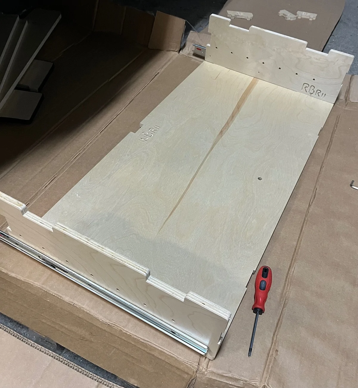

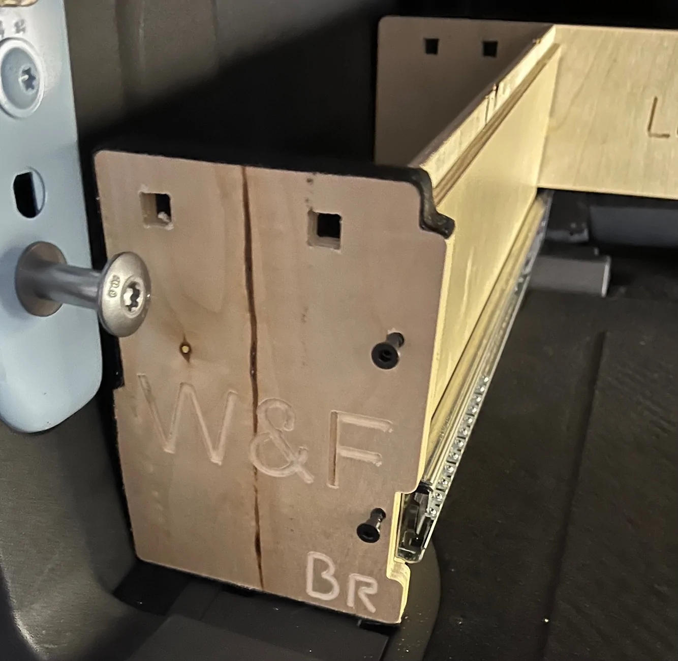

I looked into them for my 4 dr but based on your pics now I'm still on the fence. How can they send you a piece with a big brown line thru it (left side back piece). Just looks horrible. They should have redone that piece out of scraps at least.

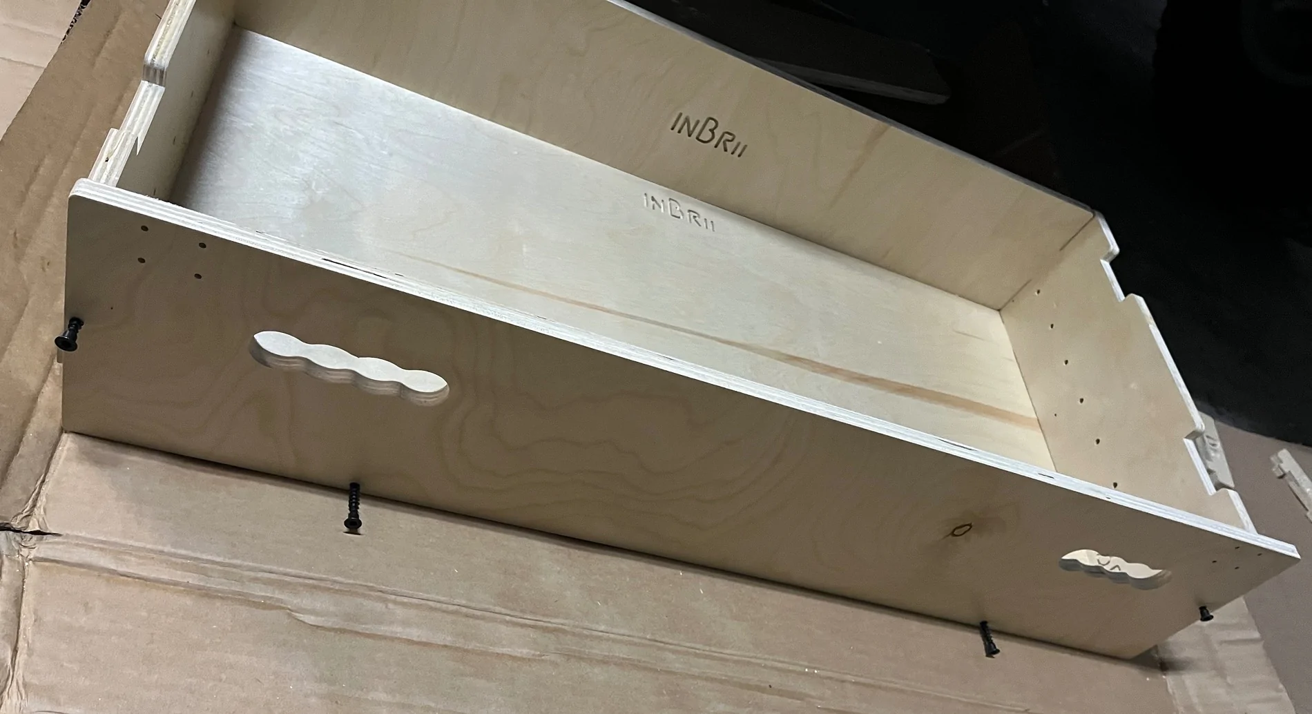

I have the 4 door kit. Generally I am happy with it however there were a few quality missies on the one I got. None of the issues were a big deal to me so I did not reach out to the manufacture and cannot comment on their customer service.
  • The center top panel has some small features near the edge that I believe are to hold the net if you get it. They are ~0.25" wide and were damaged when I opened the packaging.
  • The raised area in the Bronco drawing had broken off. This is cosmetic only but very visible. (on further inspection and looking at their website it looks like its intentional and perhaps the plywood had some internal voids?)
  • The piece labeled RBR was missing a spot where it was supposed to be predrilled. It was easy enough to drill but should have been done.

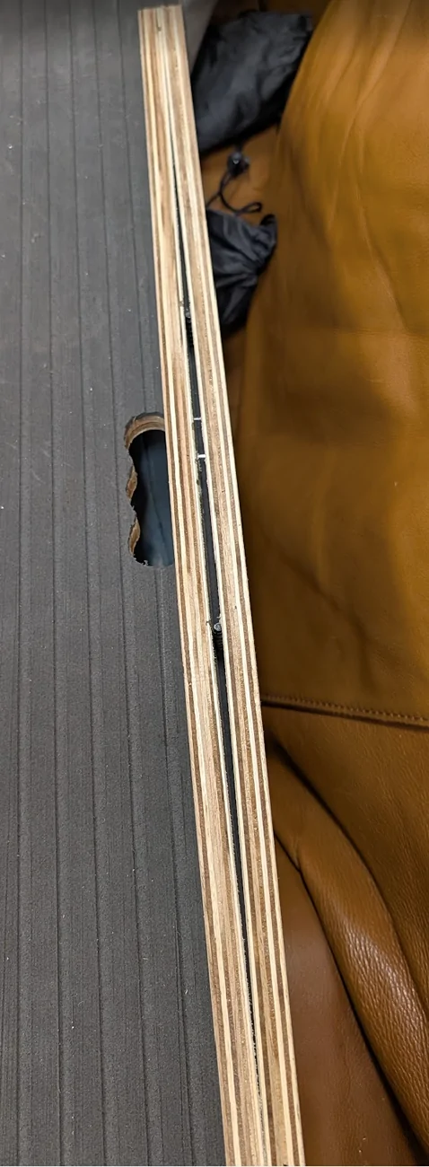

  • The piece that you can attach to the end of the top to create a lip that stops items from falling off the end is made out of two pieces of plywood. It immediately split as the screws are right on the glueline.
Overall I really like it, I used to have the Tuffy drawer and I find with the extra side and back space I can fit more into this one. I also like supporting US made and small business. I also think its a great value.

Considering that this product is produced on demand (and that it is not inexpensive), the lack of quality control is disgusting. They should be ashamed for shipping the product with those defects.
