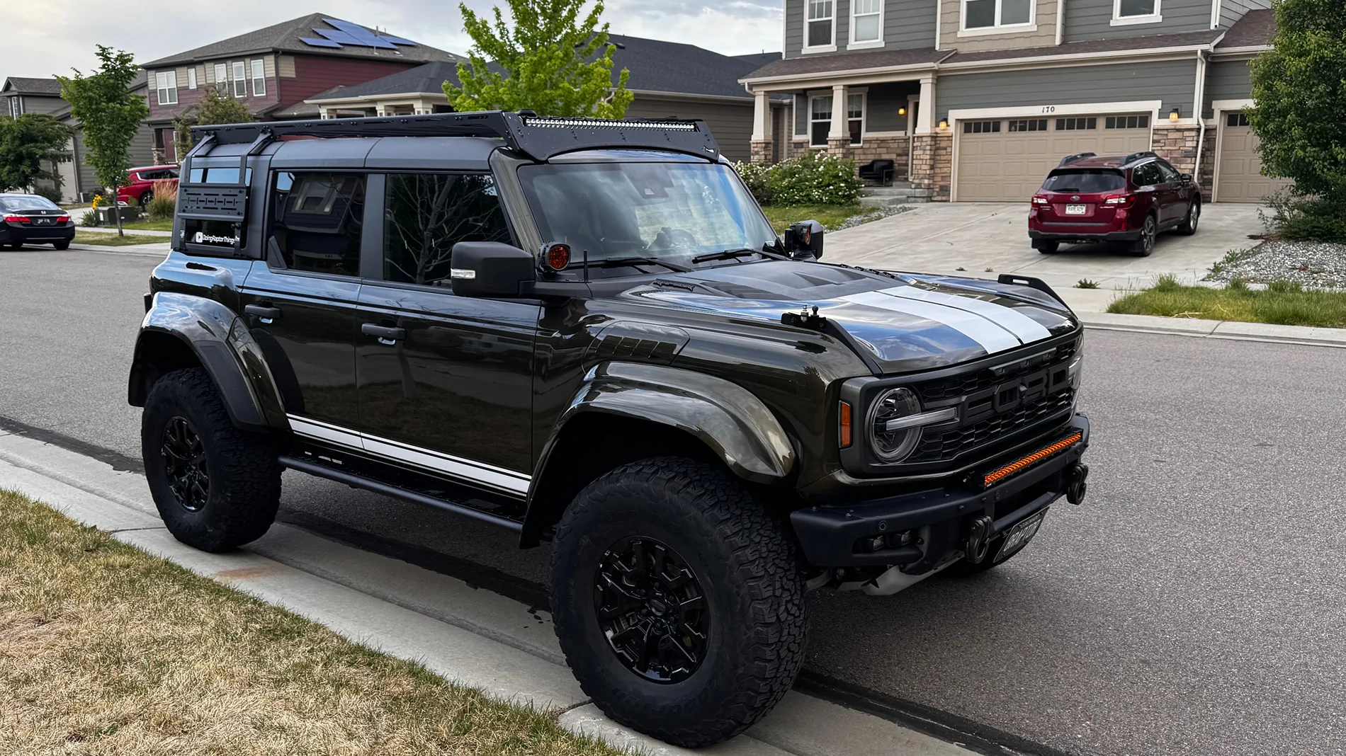

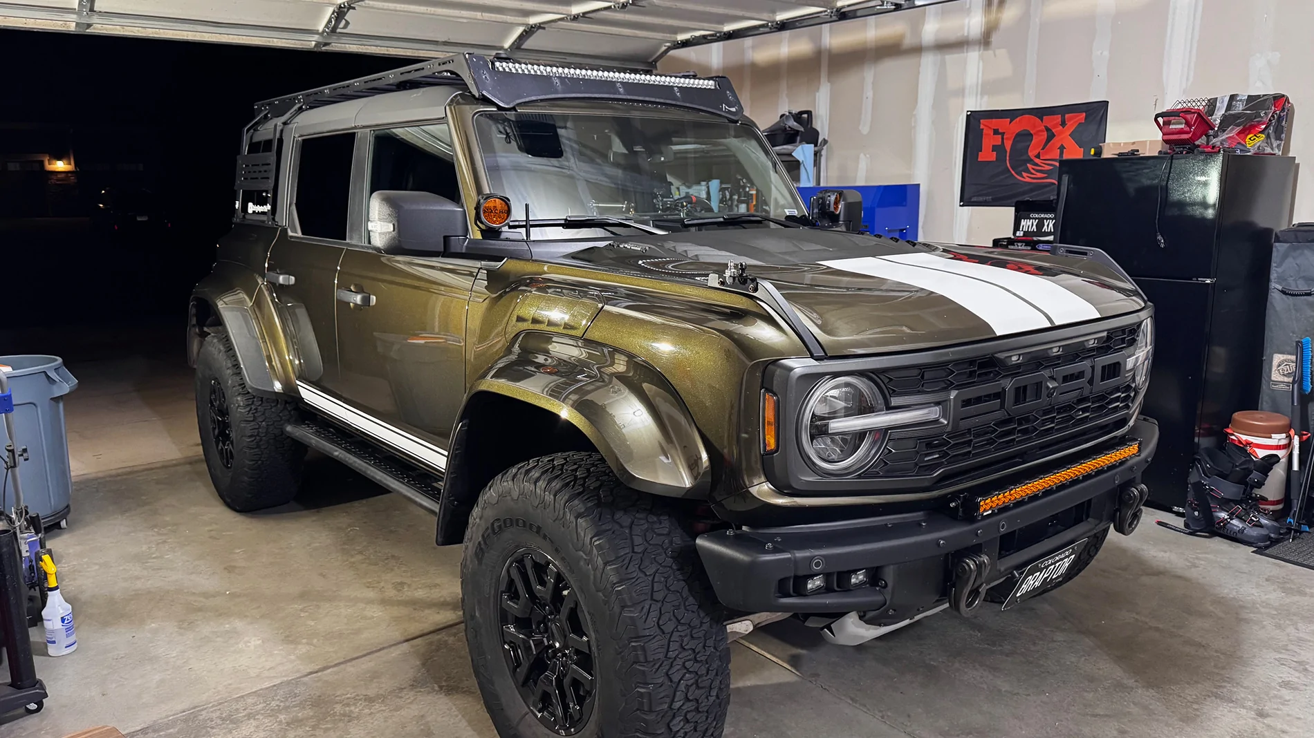

I'd been thinking on this for awhile and finally decided to pull the trigger on ordering custom vinyl stripes for my Bronco. I'd looked at all of the options online but wasn't seeing exactly what I had wanted, and I'll be honest, it's pretty crazy how much some precut vinyl can cost.

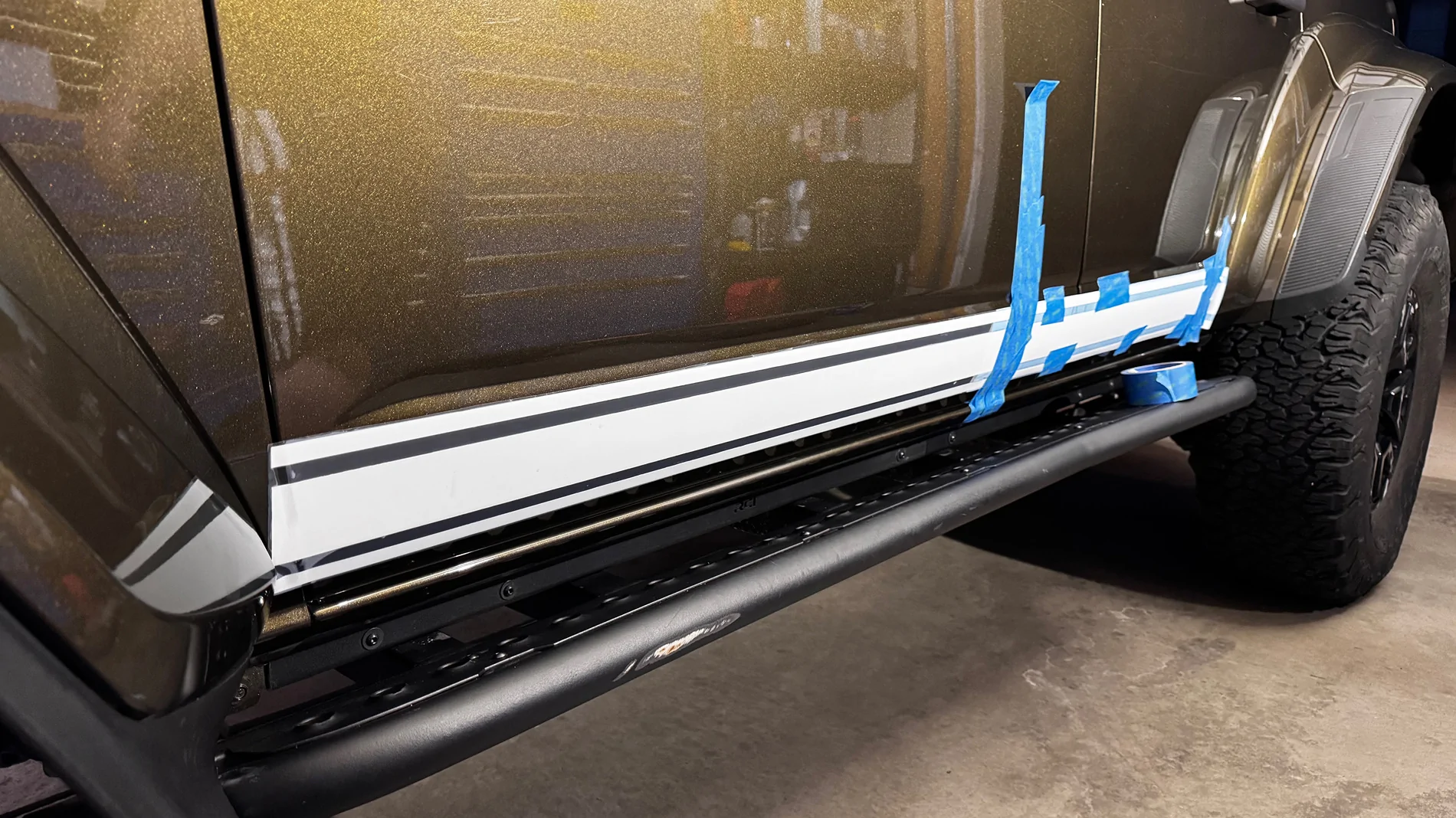

I searched around on Etsy and found someone offering custom-cut racing stripes. I was able to order a hood stripe and the two rocker stripes for a total cost of $67.
I asked for the following measurements to try matcing the Shelby look as closely as possible. I think it turned out pretty good.
- Rocker Stripes: 2.125" width in the middle section, with a half-inch gap on each side and a half-inch stripe on each side, 72" long
- Hood stripes: Double stripes 9" wide with a 1" gap between the two of them, 36" long

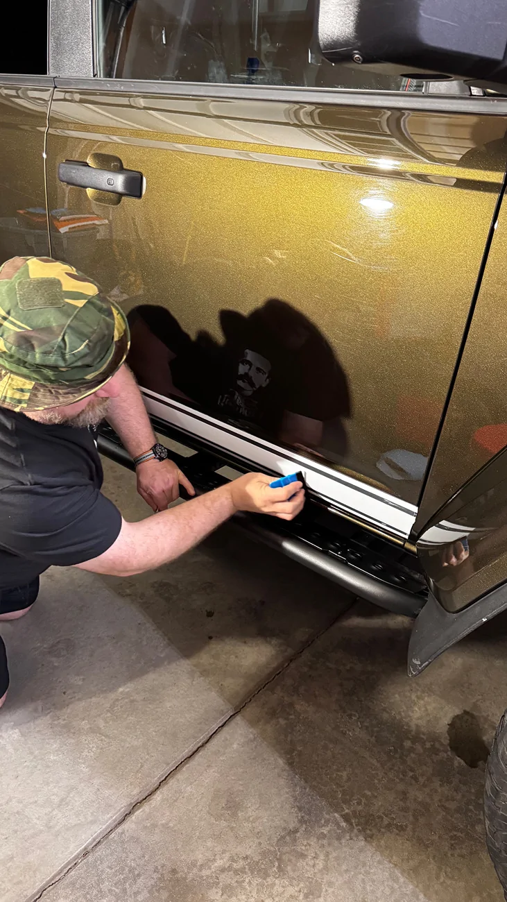

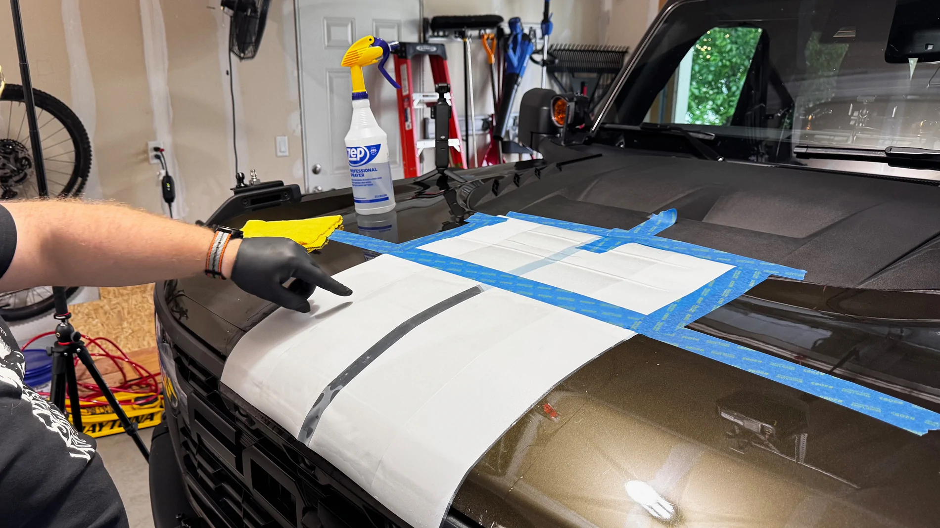

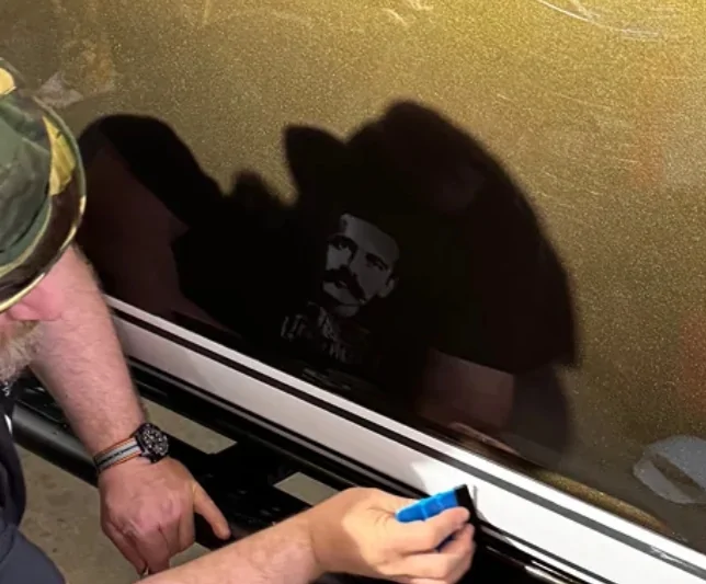

Prep work involved washing the car (without wax) and then spraying the dry area with alcohol before installation.
Installation wasn't too bad, I used the "hinge method" to tape the graphic in the middle and then worked one side at a time and used a squeegee to work out air bubbles. I've seen reports that vinyl like this should last around ten years. We'll see how it holds up, but I'm thrilled by how much of a difference it makes given the low cost.

That’s a hilarious find. My buddy was wearing a Doc Holliday shirt. I hadn’t even noticed the reflection

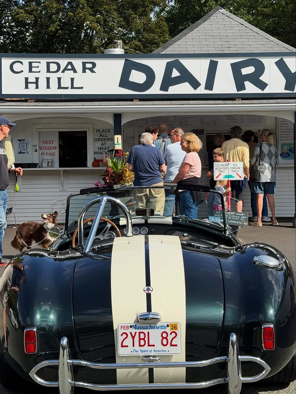

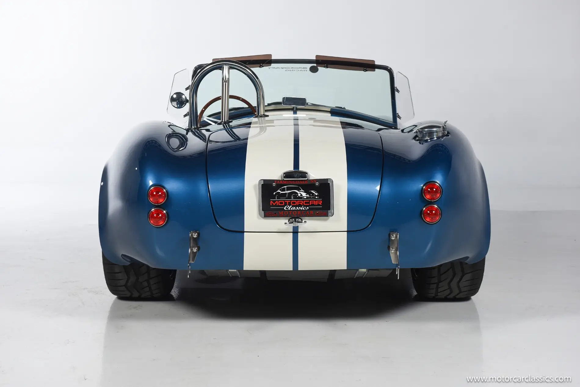

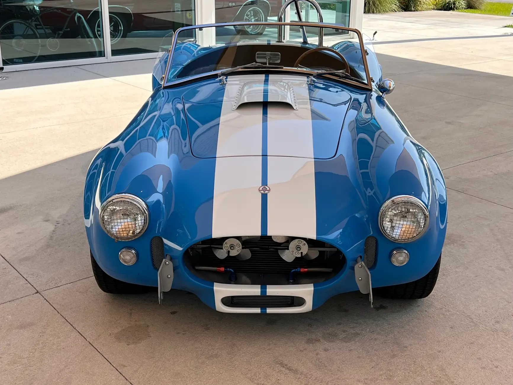

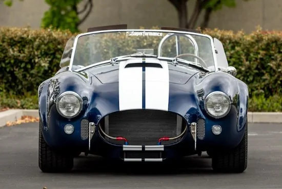

on a Shelby cobra, the stripes taper and get thinner towards the front and back of the car, which gives it a much better look (might not translate to a truck). It is subtle, but the top photo is done right and bottom photo is just straight stripes and not as well integrated into the shape of the car.
These are both replicas:
Correct Stripes (tapered):
Ford Bronco DIY Shelby-Style Racing Stripes 1782167488452-77
Incorrect stripes (straight):
Ford Bronco DIY Shelby-Style Racing Stripes 1782169709370-s9
And the back, with correct tapered stripes (this one is mine!):
Ford Bronco DIY Shelby-Style Racing Stripes IMG_2316
