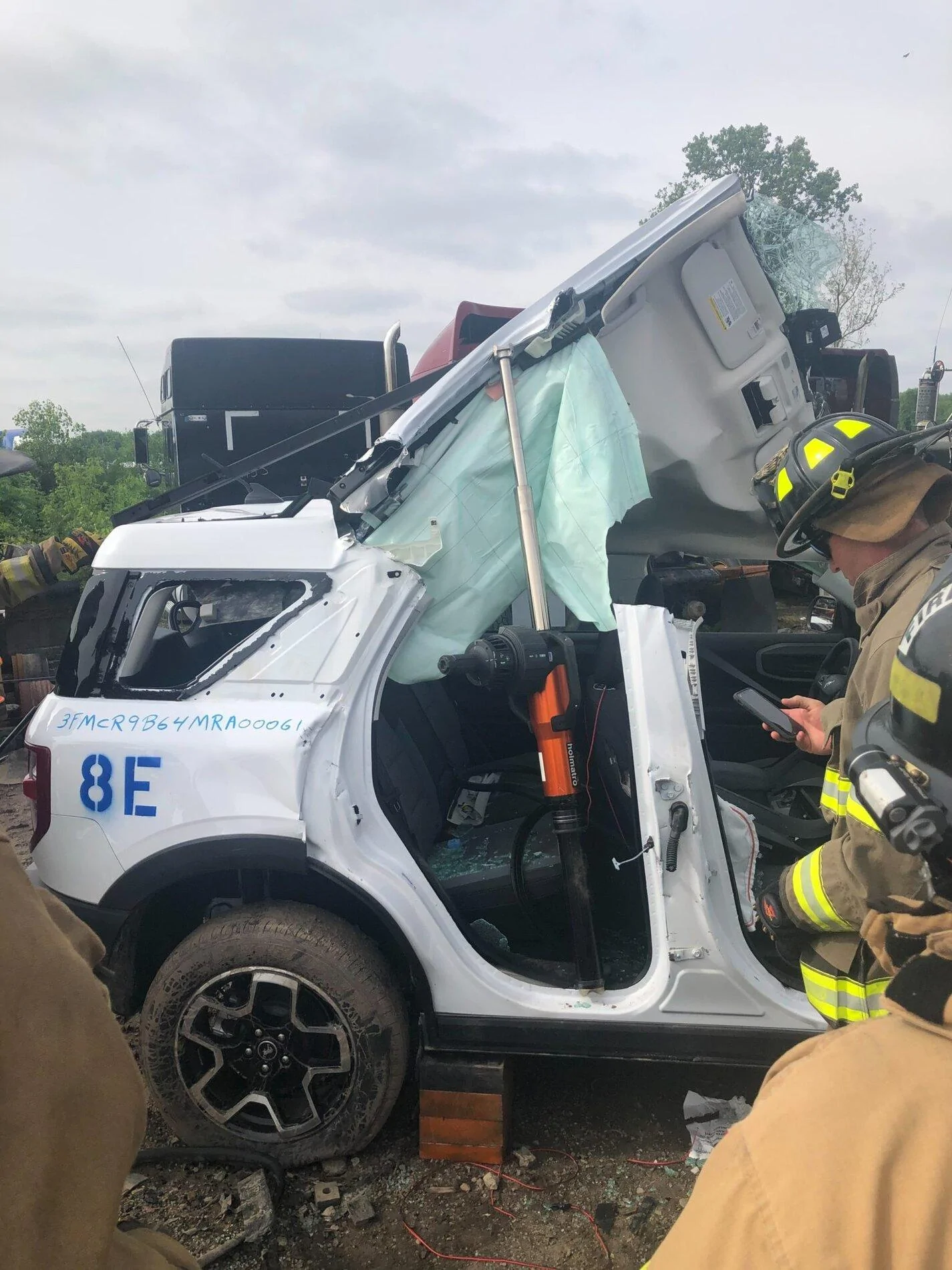

It’s been stated that big Bronco will include boron steel for strength in at least the roll bar.
Here is a link to its performance in the Bronco Sport under rescue extrication. The rigidity is impressive:
http://www.boronextrication.com/2021/05/30/2021-ford-bronco-sport-body-structure/

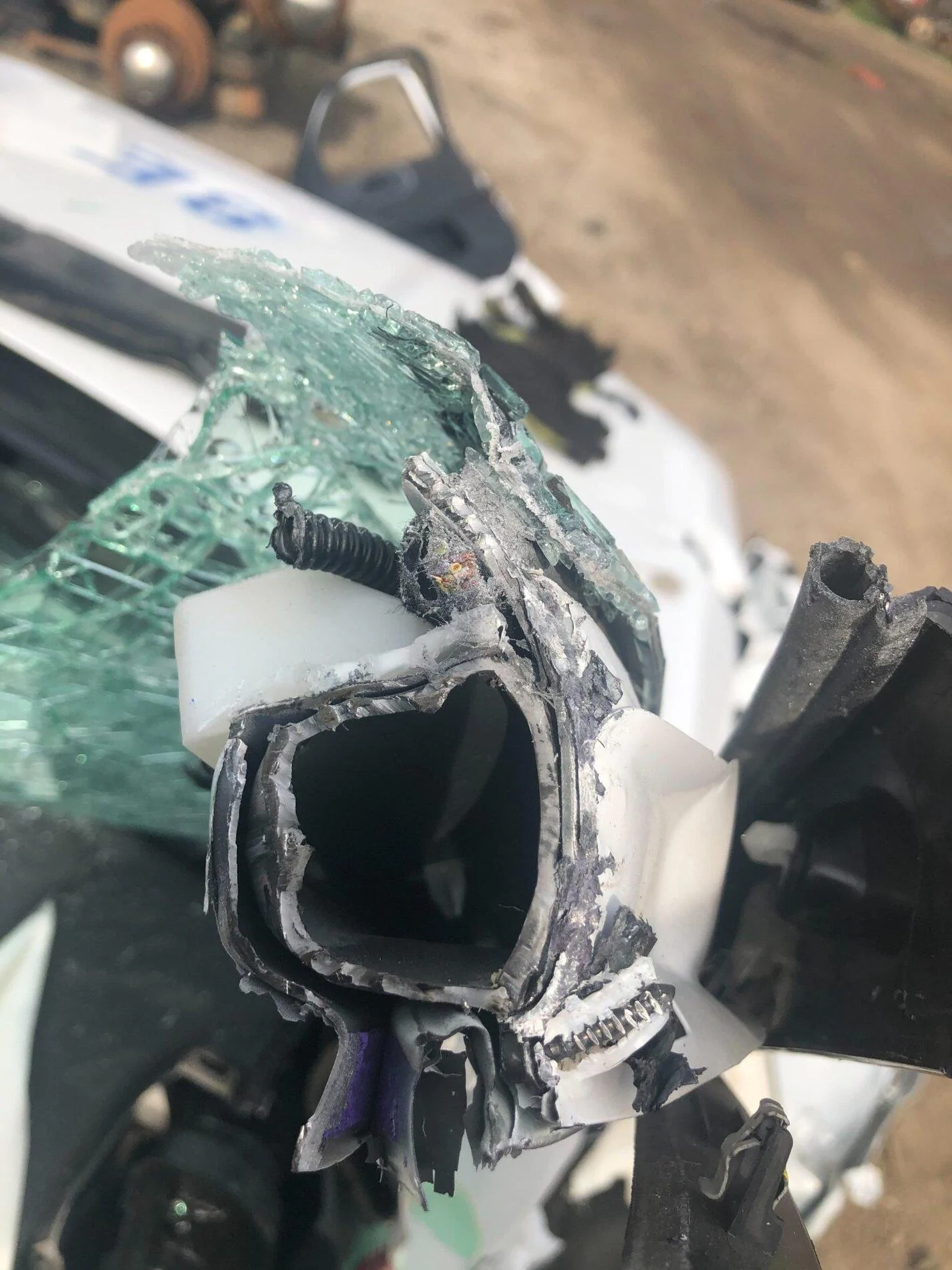

A-pillar did not deform or crush under the jaws… ultimately gave way while retaining its shape:
Ford Bronco Boron Steel Performance in Bronco Sport Under Jaws of Life 1622463382673
Rocker Panels also include boron steel, and they didn’t even deform or crease under the ram:
Ford Bronco Boron Steel Performance in Bronco Sport Under Jaws of Life 1622463445401

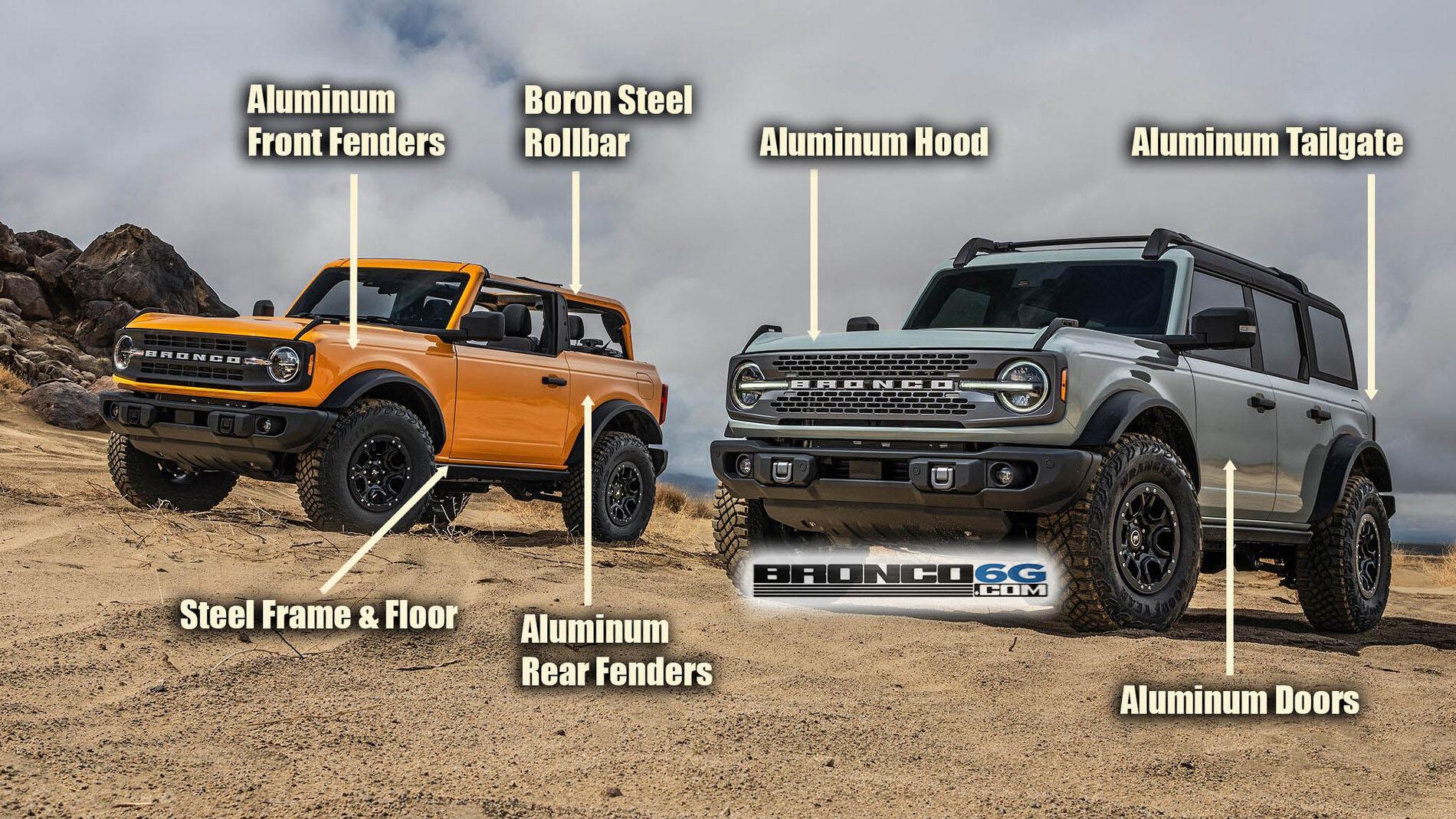

Admin updated with Bronco materials / construction info from:
https://www.bronco6g.com/forum/thre...erials-construction-on-2021-ford-bronco.3298/ (for anyone who hasn't seen it).
Ford Bronco Boron Steel Performance in Bronco Sport Under Jaws of Life onco-aluminum-steel-body-panels-parts-material-
Aluminum:
Aluminum Hood
Aluminum Front fenders
Aluminum Rear fenders
Aluminum Doors
Aluminum Tailgate
Steel:
Steel Frame
Steel Floor
Boron Steel sport tubes / cage

Fracturing before bending might mean failure or damage is more difficult to detect after an accident. And probably more expensive to repair if it is that resistant to reshaping.
Excellent point.
Conversely these parts might remain intact and hold their shape long past when another part would be damaged beyond repair…
I was thinking that if the rockers on the big bronco are also boron, and they are performing well, that might be why ford felt comfortable attaching the sliders to them.

Much the same can be said for the aluminum panels. More resistant to initial deformation but they'll probably fracture when they do fail, driving repairs toward replacement as the less expensive option.
If it didn’t bend it would fracture in an accident. The ability to bend and return to the original state is a function of the steel being able to transfer kinetic energy throughout the vehicles safety structure and absorb the energy into the vehicle and not transfer it into the passenger compartment. Cars in the 50s/60s/70s were designed so the vehicle would survive the accident. Vehicles today are designed so the passenger survives the accident.
Same principle applies to bridges. If they were rigid they would snap in 2 the moment they were out under load.
