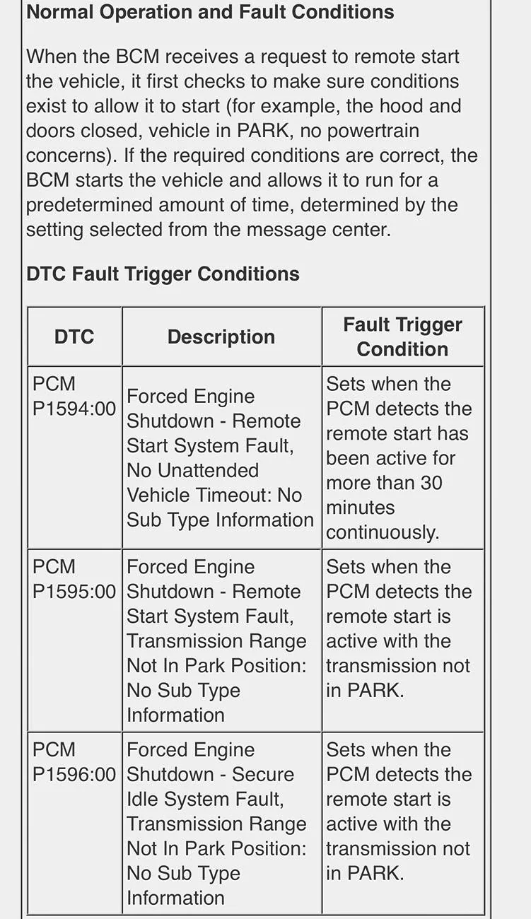

So, the short of it, I replaced the ABS/Master Cylinder/Electric Booster on my 2021 Badlands Bronco. Bleed is good, passing all tests. Module was successfully replaced and VIN updated. I'm not getting any other codes, except for P1595:00-6D. When I shift from Park, the engine shuts down with that code. The text of the code is 'Forced Engine Shutdown - Remote Start System Fault, Transmission Range Not In Park Position'.
I haven't found much of anything searching for this code for a Bronco or newer Ford. I found one reference stating a possible PATS programming for the new module.

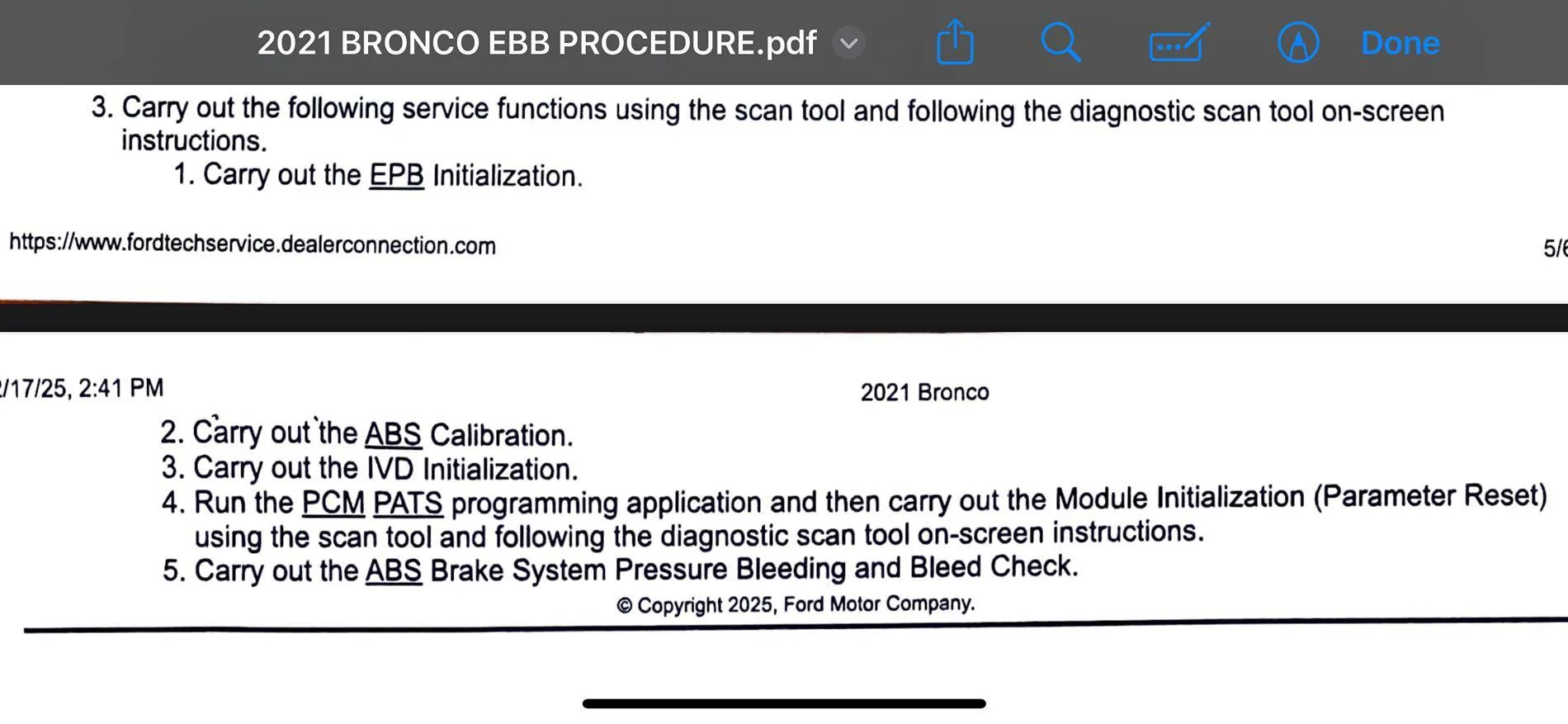

OK, the dealer shared the ABS replacement procedure with me. I was spot-on and had even figured out that I need to do a PATS initialization (need Incode from Outcode). The dealer is not willing to give or sell me the Incode. Does anyone know if patscode.com would support such a new vehicle (FAQ seems to indicate they do, but I'm leery)? My only other option at this point is the tow the Bronco to the dealer so they can hook up the computer and run the PATS Initialization. Any other thoughts here?

Step 4 from Ford’s procedure. When I use the scan tool to perform the ‘Module Initialization (Parameter Reset)’ per Ford’s procedure it pops up a dialog with a 40-byte Outcode and tells me to get the Incode from the dealer. The dealer refused unless I tow the car into them.
Yeah It probably can only be done with FDRS then. There is no incode or outcode supplied when using the factory diagnostic tool. All that stuff is outdated and how Ford used to do PATS programming.
Unless you want to buy a 2 day FDRS license and have a compatible J2534 device that will work with FDRS, the dealer is probably your only option.
