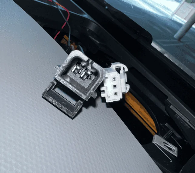

DaveInSA
Apr 29, 2022
773
1,028
Seguin, Texas
2021 Bronco Badlands 4DR, 2007 Saturn Sky
So far I’ve only swapped the front dash with kicker ks using the metra 72-5600 which worked well. Highs and voices are slightly improved. Still sounds a bit muddy in the midbass to me. I might add 150hz blockers. No plans to swap the 6.5’s.
Next up: kicker key 200.4. expecting a lot from it as I believe the head unit is putting out trash
Follow up: smaller sub like a hideaway or kicker down firing sub and enclosure
Your stock speakers must have had different connectors than mine?
72-5600 on left, stock connector on right. They don't fit.
