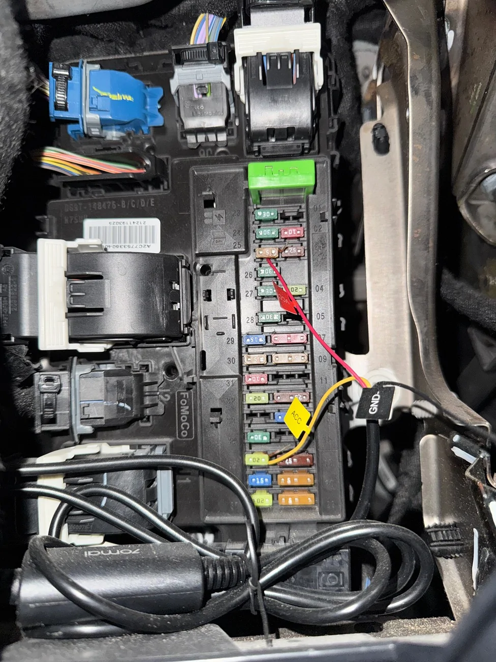

Hoping someone can help me out!
Re: fuse box under steering column —
I currently have (2) Micro2 fuse taps connected to #29 & #35 for my dash cam. I want to hardwire a fiber optic LED dash kit that would require a 5A or maybe 10A fuse. I don’t think I have an opening to do this on the left side of my fuse box, so tried using a Micro3 fuse tap on the right side…but the adapter didn’t fit (looked like the base of the fuse tap was too big & blocked the 3 prongs from being plugged in).
Is there a way to do this or do I have to choose between the 2 accessories?

Those pins look janky as fuck. Can you take an actual picture of the tap

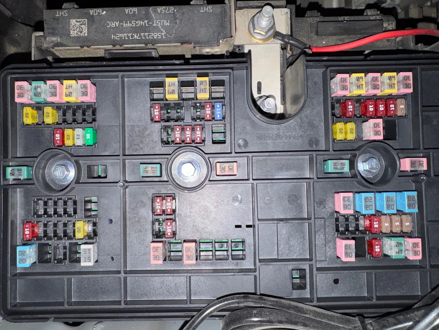

So, I recently bought a 2021 Badlands model and it didn’t take long for me to wonder what spare fuses I would need (critical circuits in case of an emergency in the deep desert rather than for general replacement). I accepted that I may need to ‘limp’ home.
1st step, identified which fuse types are used in each circuit (engine bay and interior).
2nd step, identified which circuits are ‘critical’ for on road and offroad use.
3rd step, identified non-critical circuits which could be sacrificed in case of emergency.
I believe you only need to buy the following two fuses for emergencies (2021 Badlands):
- 1x 25A Micro2 (critical circuit 6, PCM Power, which is required to start and power the ECU)
- 1x 30A Micro2 (critical circuit 7, PCM)
All other critical circuits have a corresponding fuse somewhere in a non-critical circuit which could be pulled and used (eg ‘borrowing’ the fuse from one of the many power outlets, heated seats, rear window defrost, passenger door power, USB)
Frustratingly,
- Ford gives us a spare 15A Micro3 (interior circuit 4/5) but nothing uses that fuse … useless. They should have made this as 10A Micro3 as a spare for circuit 6/7 (anti theft horn alarm). So you may want to buy a spare but not critical.
- Ford only used a 7.5A Micro2 for interior circuit 3 (mirrors and wireless charging). So you may also want to buy a spare but not critical.

The manual lists a wide variety but the two main fuse boxes (engine and interior) only have M Case Slotted, Micro 2 and a few Micro 3
I can summarise the number of each type and rating (in use). Will have to send later
[Edit: the below is for 2021 Bronco Badlands]
As I posted earlier, if you only need it for emergency then only buy the 25A Micro2 and 30A Micro2 but if you want a full backup including non critical then
M Case: 15A, 20A, 30A, 40A, 60A
Micro 2: 5A, 7.5A, 10A, 15A, 20A, 25A
Micro 3: 5A, 7.5A, 10A (there is a spare 15A but nothing uses it)

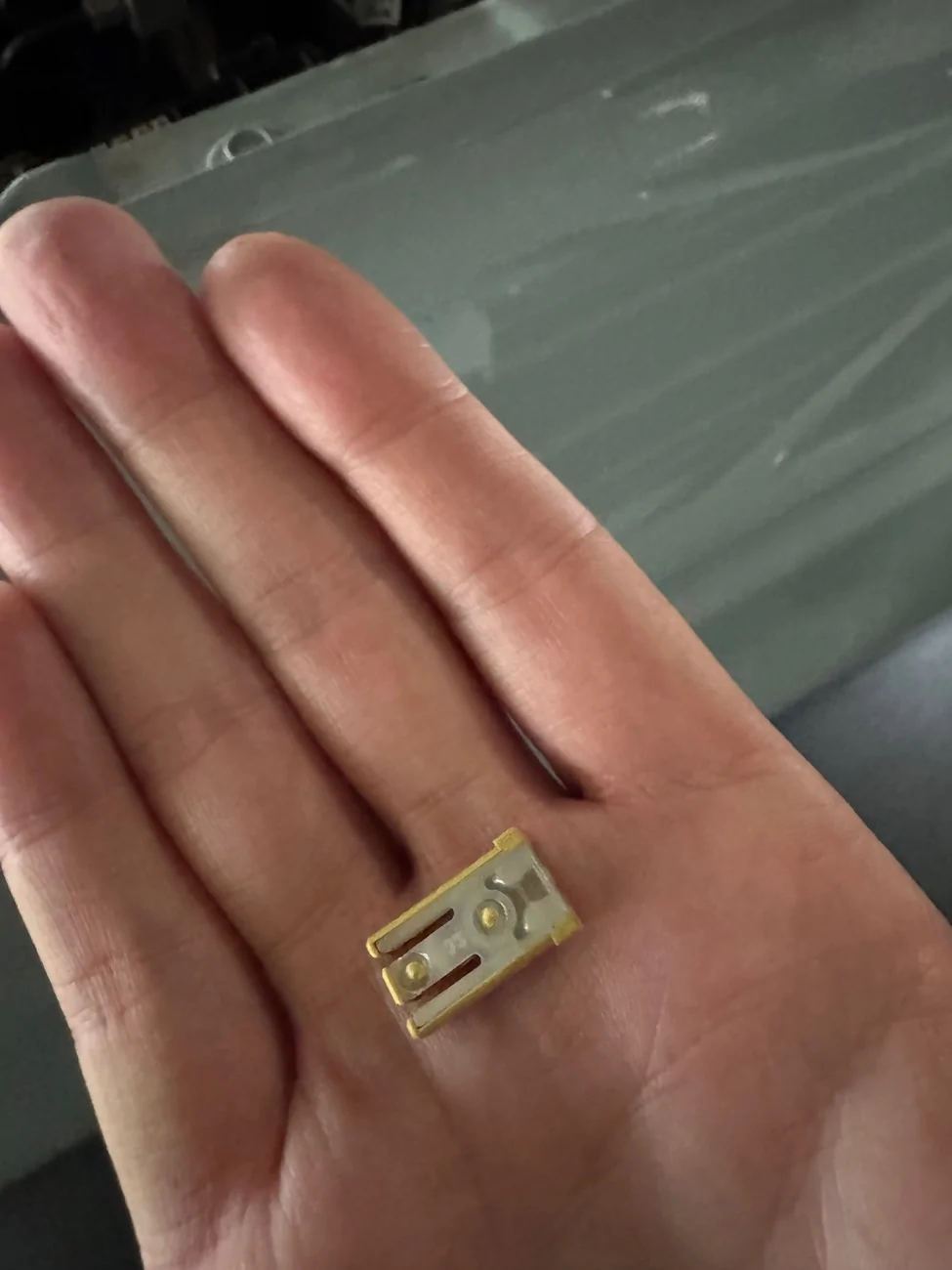

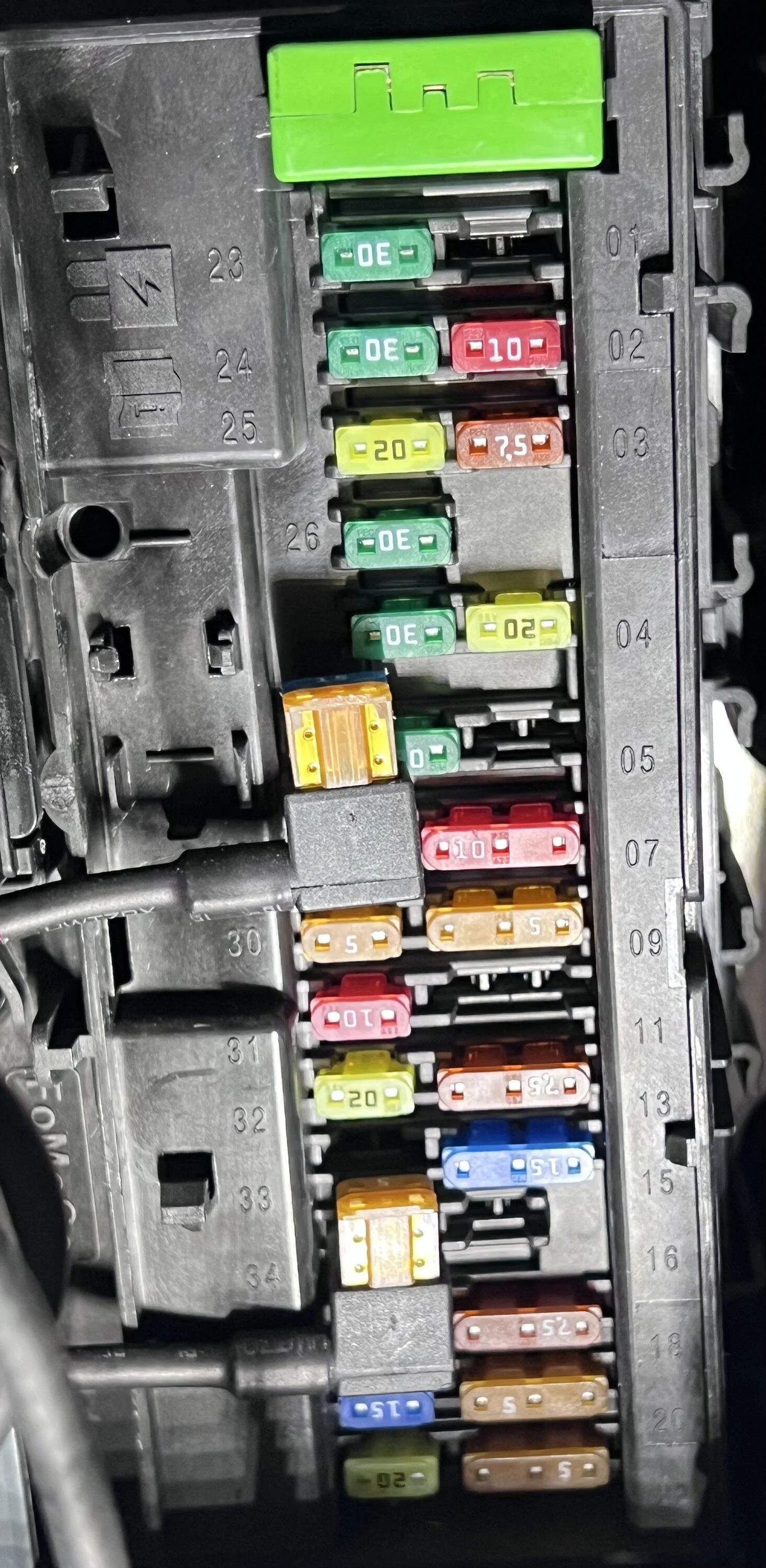

Hi Neps,
My response was for 2021 Badlands (I made an edit to make that clearer) but I believe there is only one size for “M Case Slotted” (either M Case slotted or M Case non-slotted; the J Case does have two lengths).
The M Case slotted in the 2021 Badlands is ~16mm length if that helps. (My manual also lists 8 fuse types but it seems only 3 are used + a Maxi that isn’t wired to anything)
