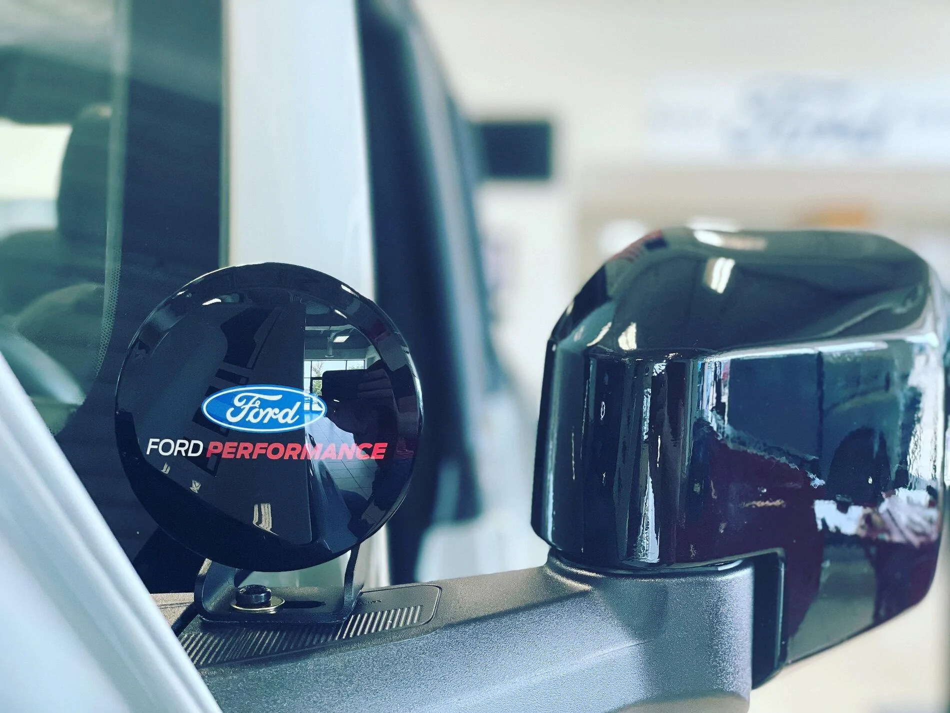

Thanks for the video.
As simple as it is, I love the addition of the felt tape. Won’t look like crap down the road if you ever remove them.

@flip are these the one on stop sale because of the mount was bad?

Nothing wrong with the light itself. They did a stop sale because the lights on the off-roadeo vehicles were working loose. The fix.....a line in the install instructions was added to indicate thread locker needed to be used on the mounting bolts.
I don't have the new packaging yet to see what loc-tite they are wanting. Might even be a small tube included, but don't know. This was a short conversation with my FAD rep 3 days ago.

These lights have a backlight and a drive light. I'd like to put the backlight on a separate switch when installed. I know it's possible, but I haven't seen that install on a Bronco yet. Looking forward to that so I can get mine wired up correctly.
