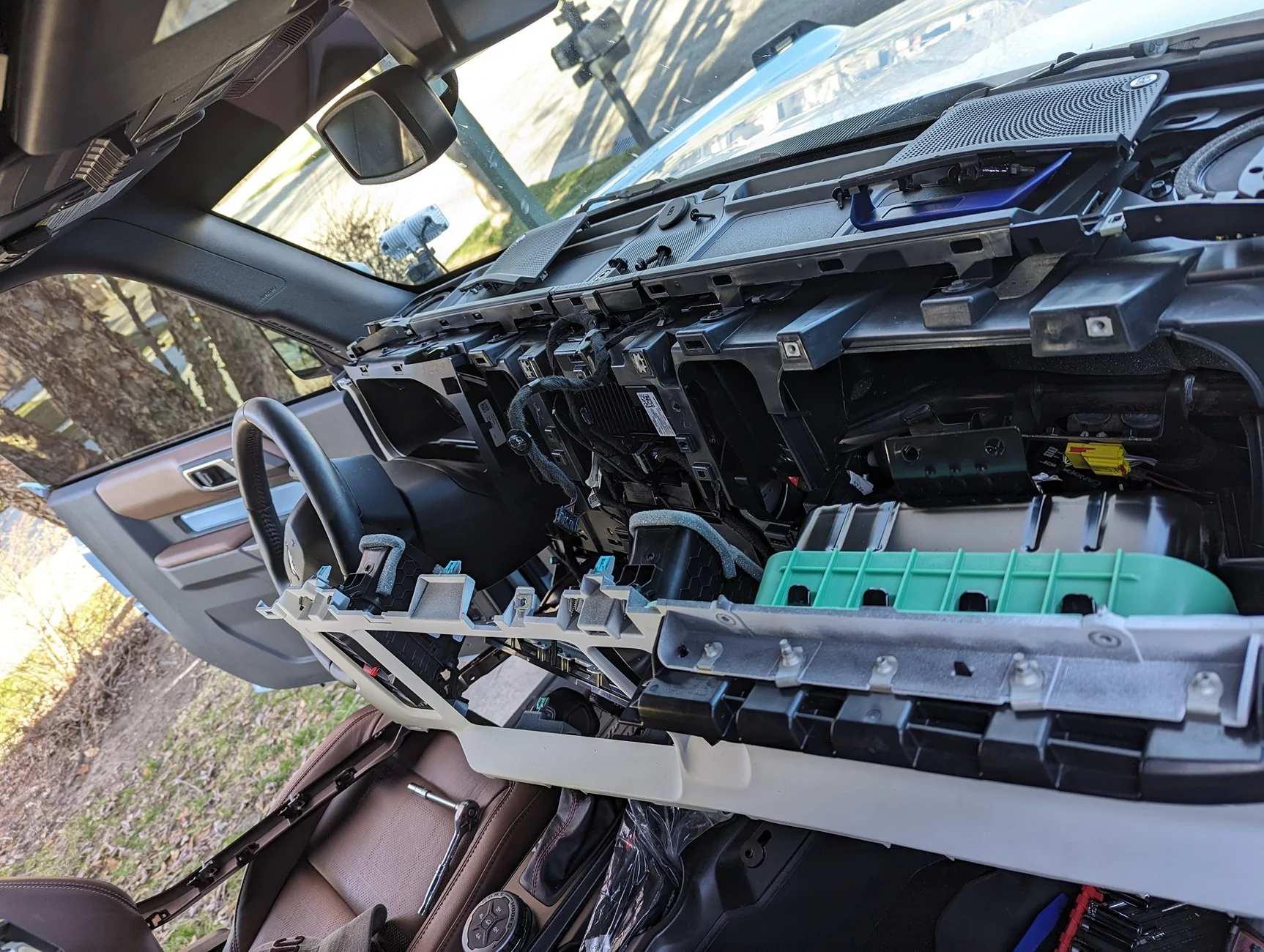

Well since it installs behind the infotainment screen.... So...No not really... I am getting used to taking the dash off though. That was the first time I had it apart. A little daunting the first time but by the second or third... Not so bad.
first time - Can Opener
second time - custom GRMS install
third time - custom audio install

I absolutely love it. It unlocks almost all the speed sensitive things with the infotainment system.... The 360 cameras operate at any speed. Hit the button, there they are. They stay there till I hit the button to turn them off. All the stuff you can not change like entering addresses and things like that... My passenger can enter as I drive...
Easy install other than removing the entire dash... LOL...

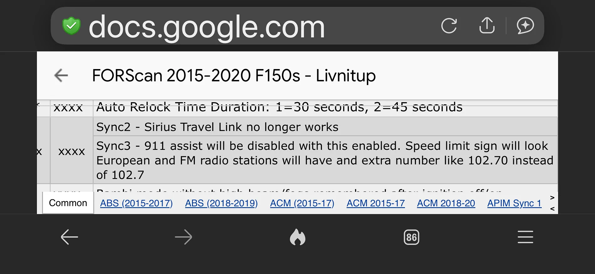

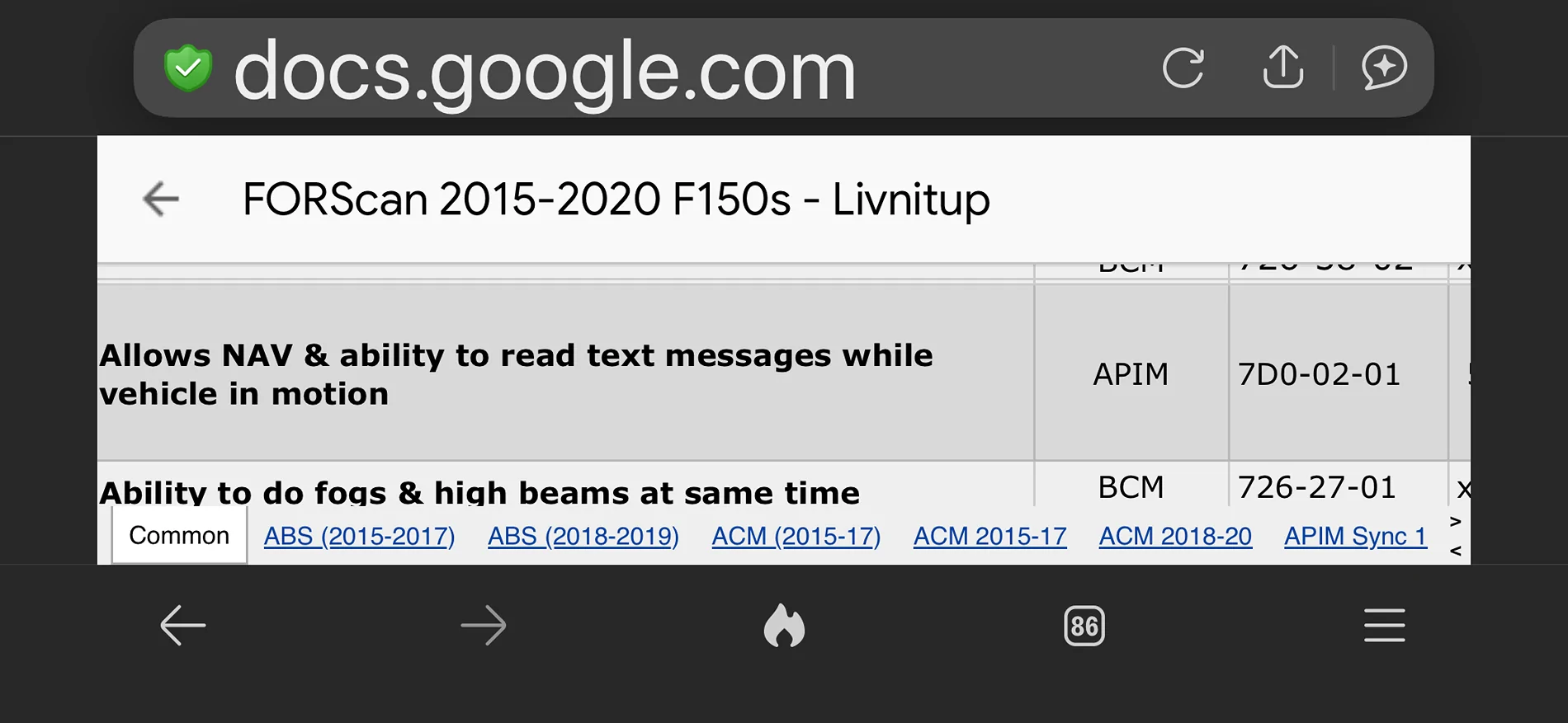

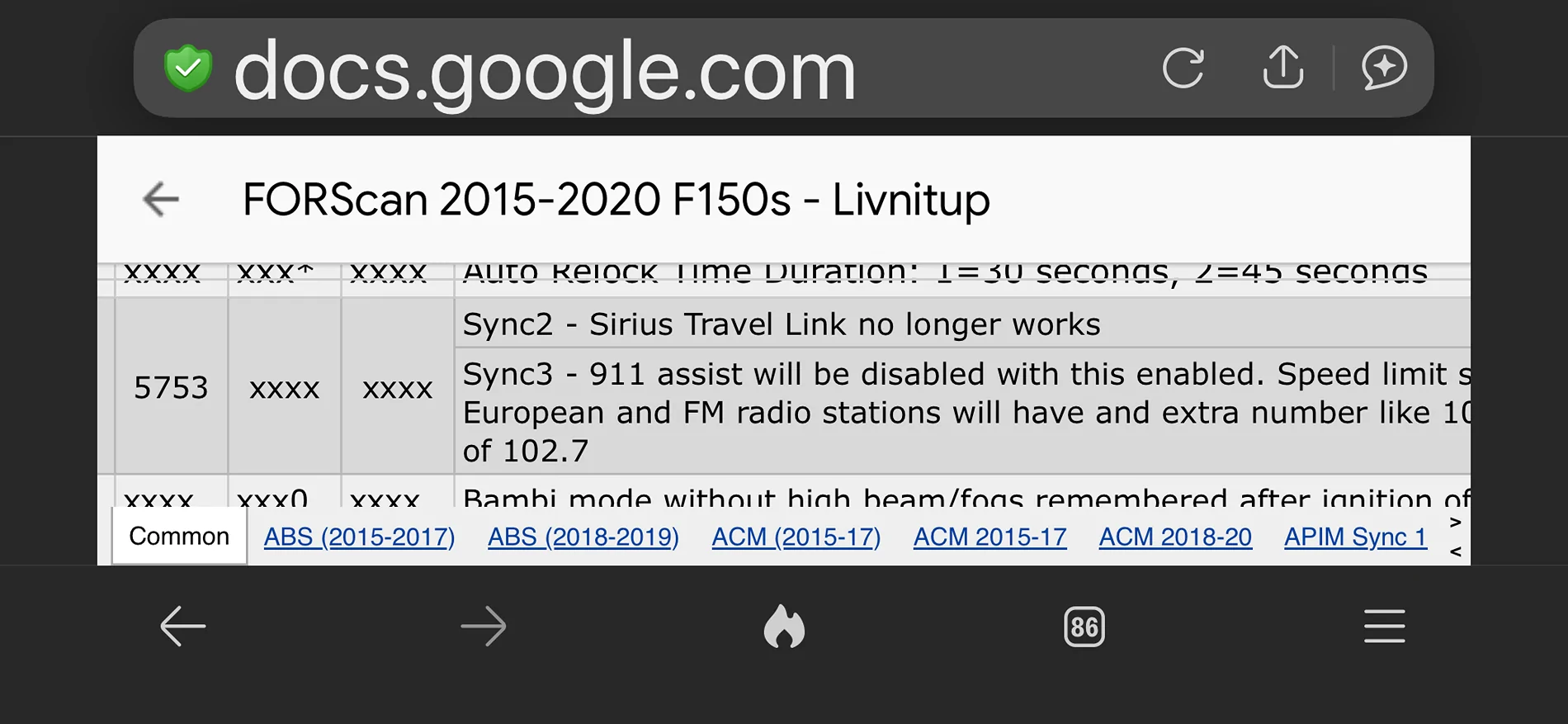

Got it off the spreadsheets from a link on the Forscan thread, here on the forum…
