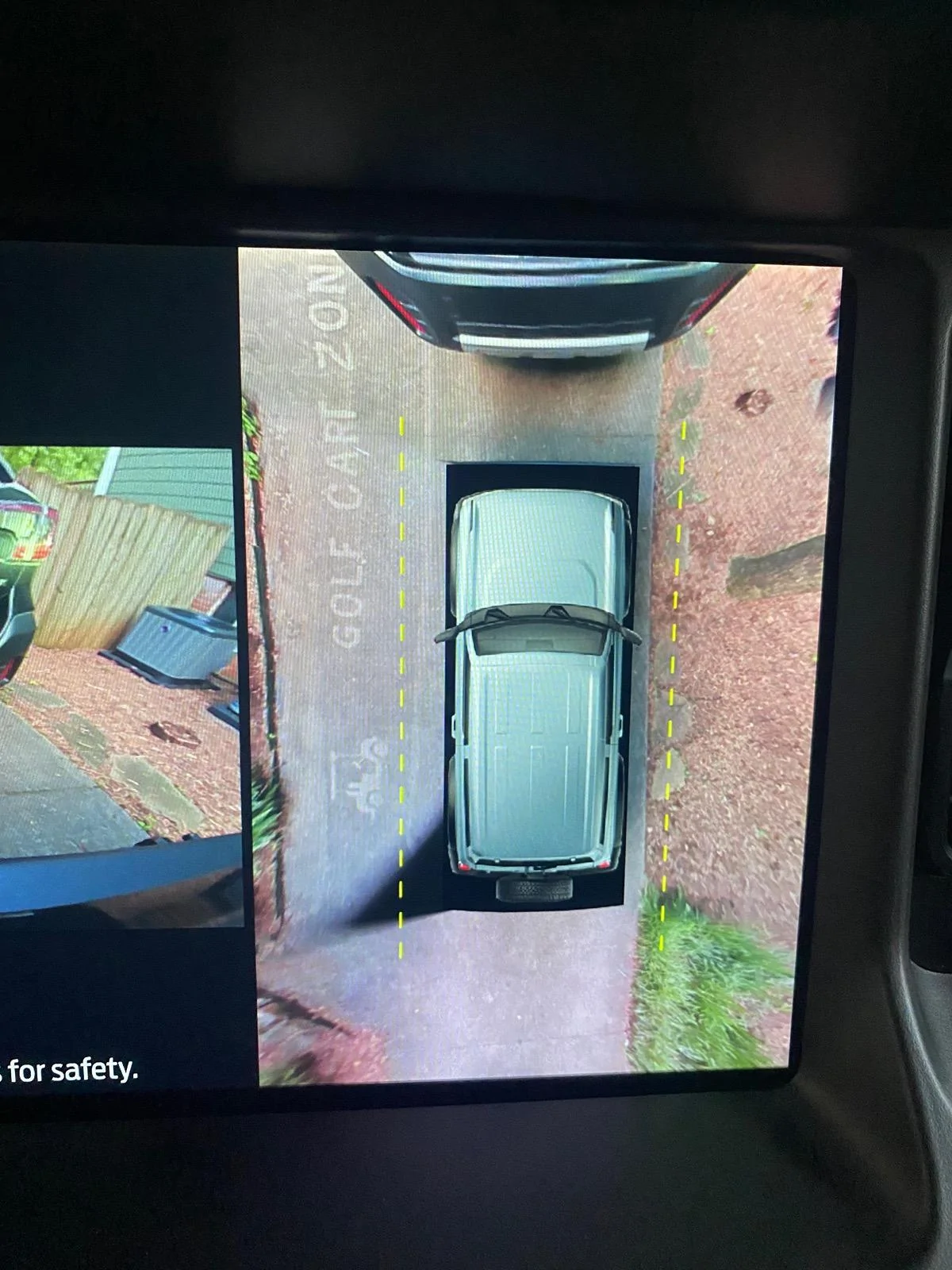

Just got my Bronco this week… noticed this weird black area in the 360 cam at the driver rear. Since it’s not the same in the other side I’m guessing this isn’t normal? Any one else seen this or have ideas of what could be wrong?

Have you inspected the camera on the driver side mirror yet? I would start by making sure there isn't any debris blocking the camera or that the mirror is partially folded in.

after further inspection… the cover on the front of the mirror was not fully “clicked” together with the back, so the hole for the camera was not quite lining up and was partially obscuring the view. Easy fix, just clicked the cover all the way into place and all is well!
