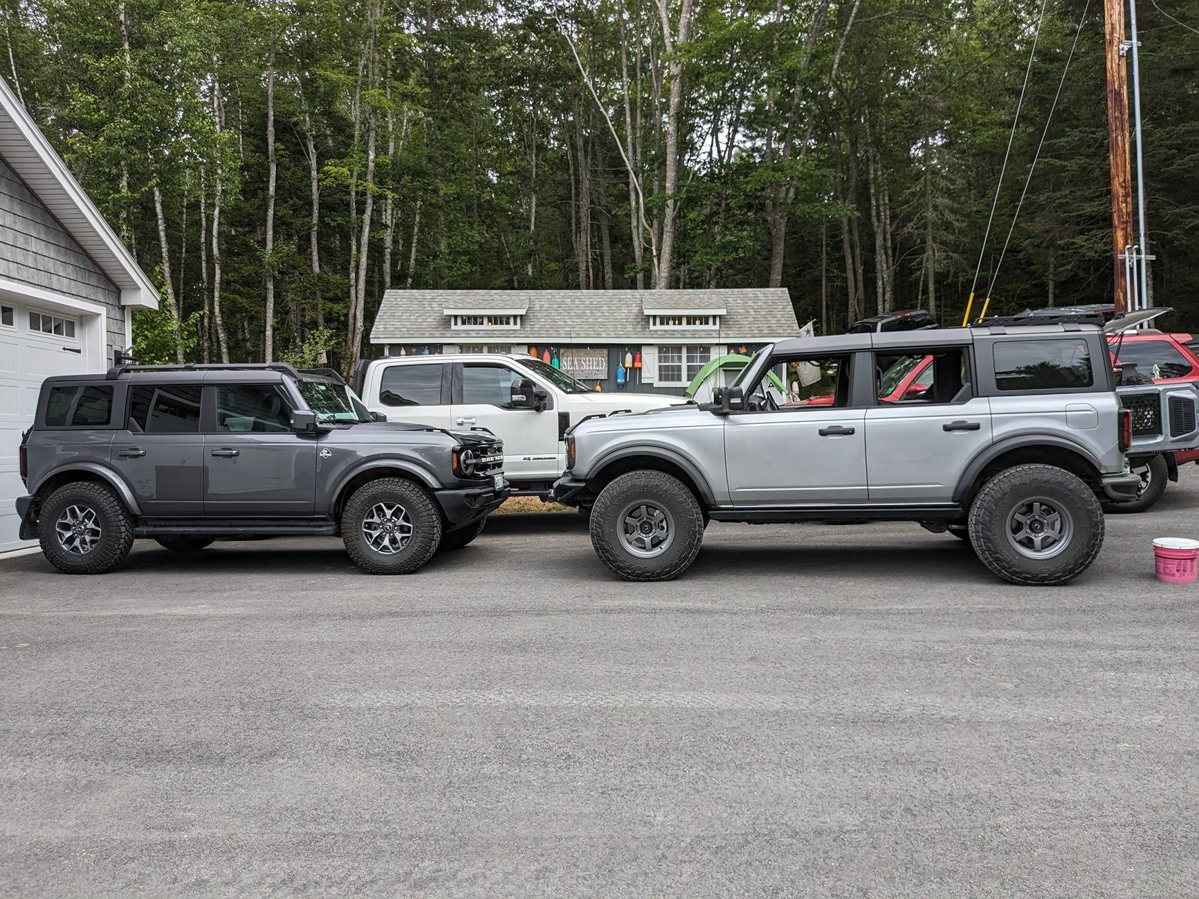

On the stock OBX +55mm offset wheels you can go up to a 35 x 10.5 w/o a lift and clear the UCAs. Some have gone to 35 x 12.5 but it is extremely close to rubbing the UCAs. Here's my friends OBX (Carb Gray) w/ my non-squatch +55mm wheels on 35 x 10.50s (no lift) next
Ford Bronco 37s or 35s? OBX n BL
to my BL on 37s w/ +2" lift.

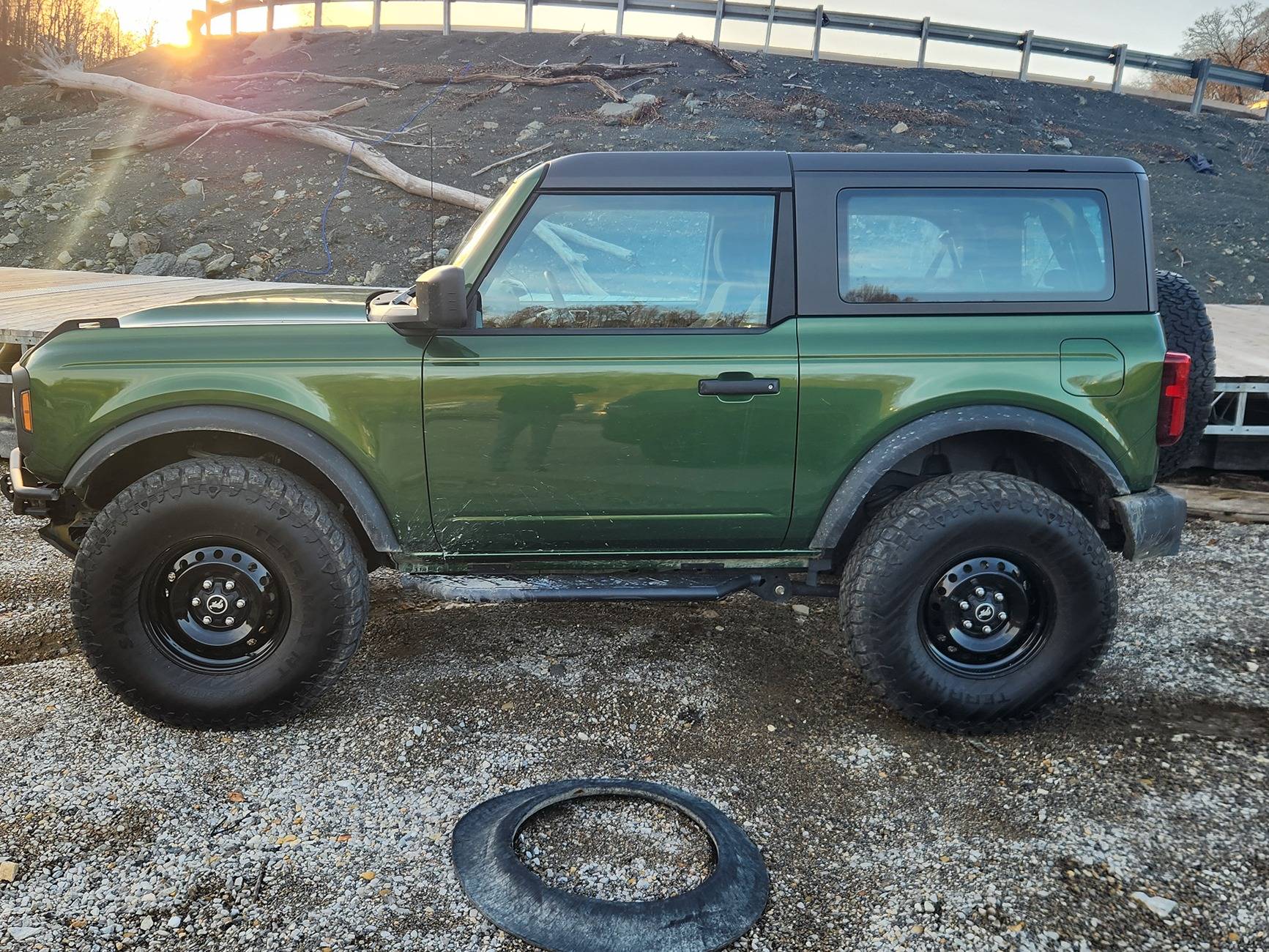

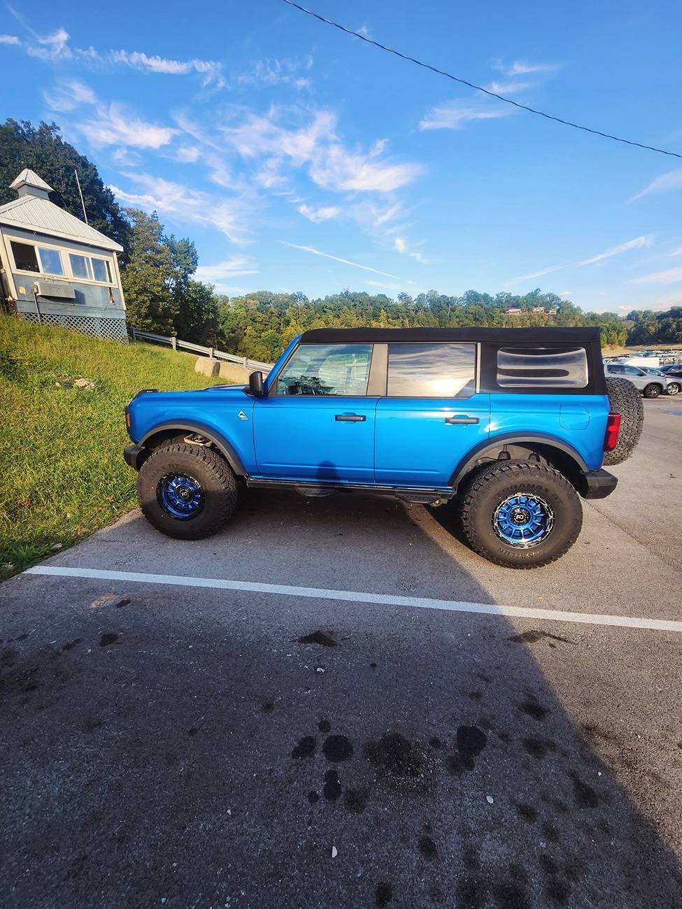

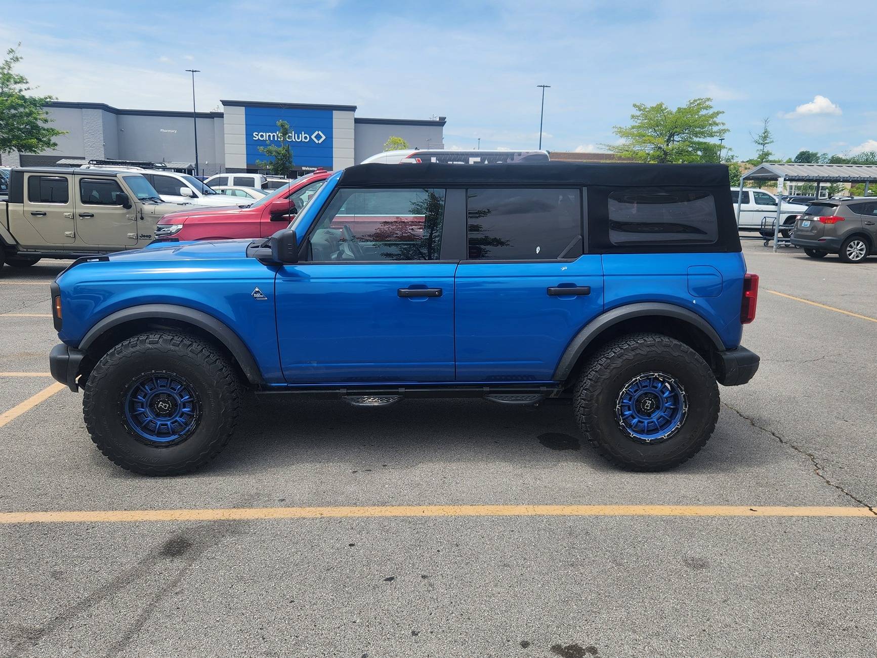

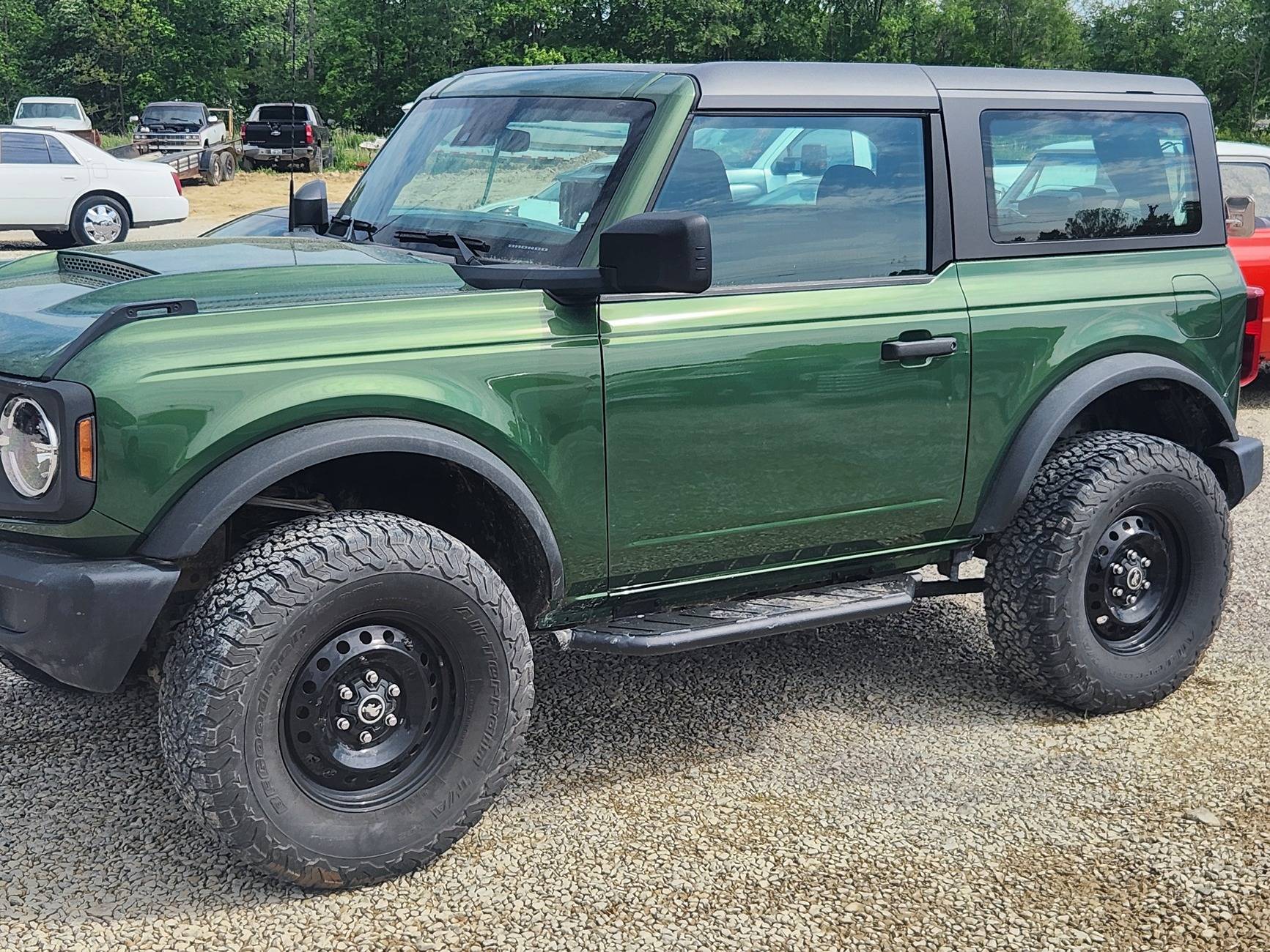

green one with a 2 in lift base on 37 also with 35s the blue on a 2.5 lift and 37 and no lift on 35. the 37 are a terramax rt d rate
