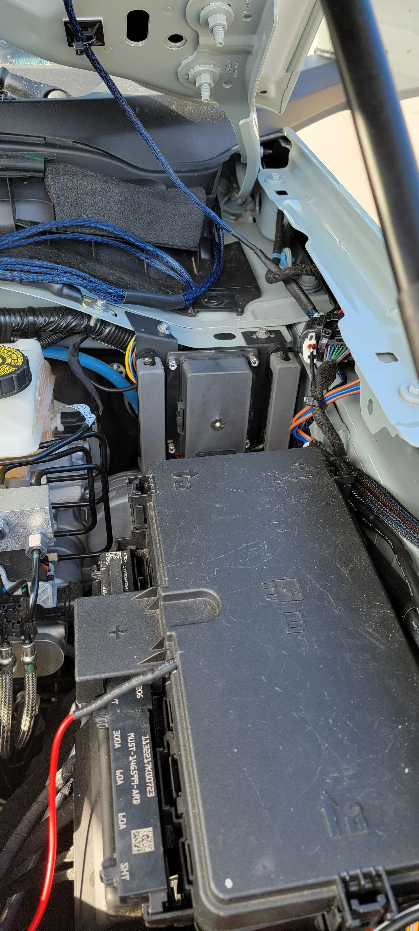

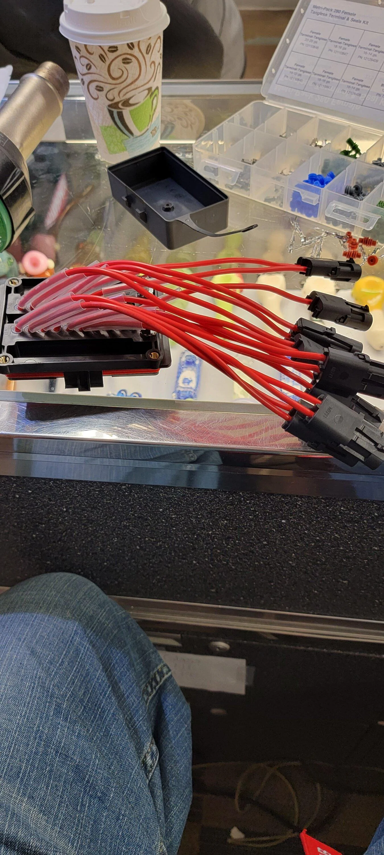

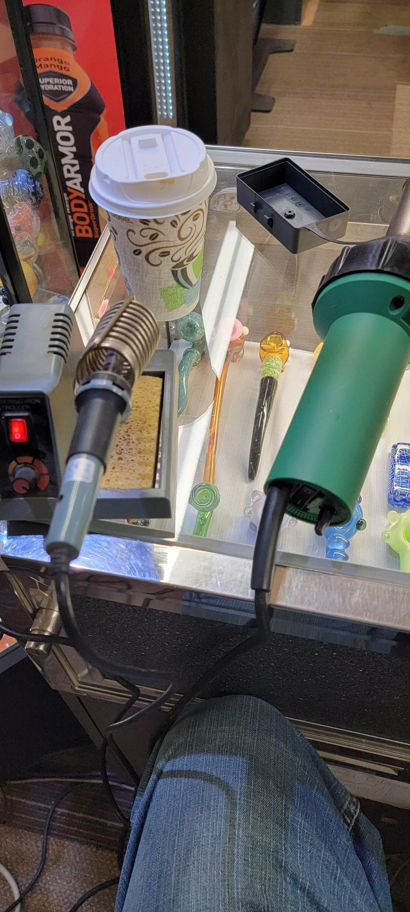

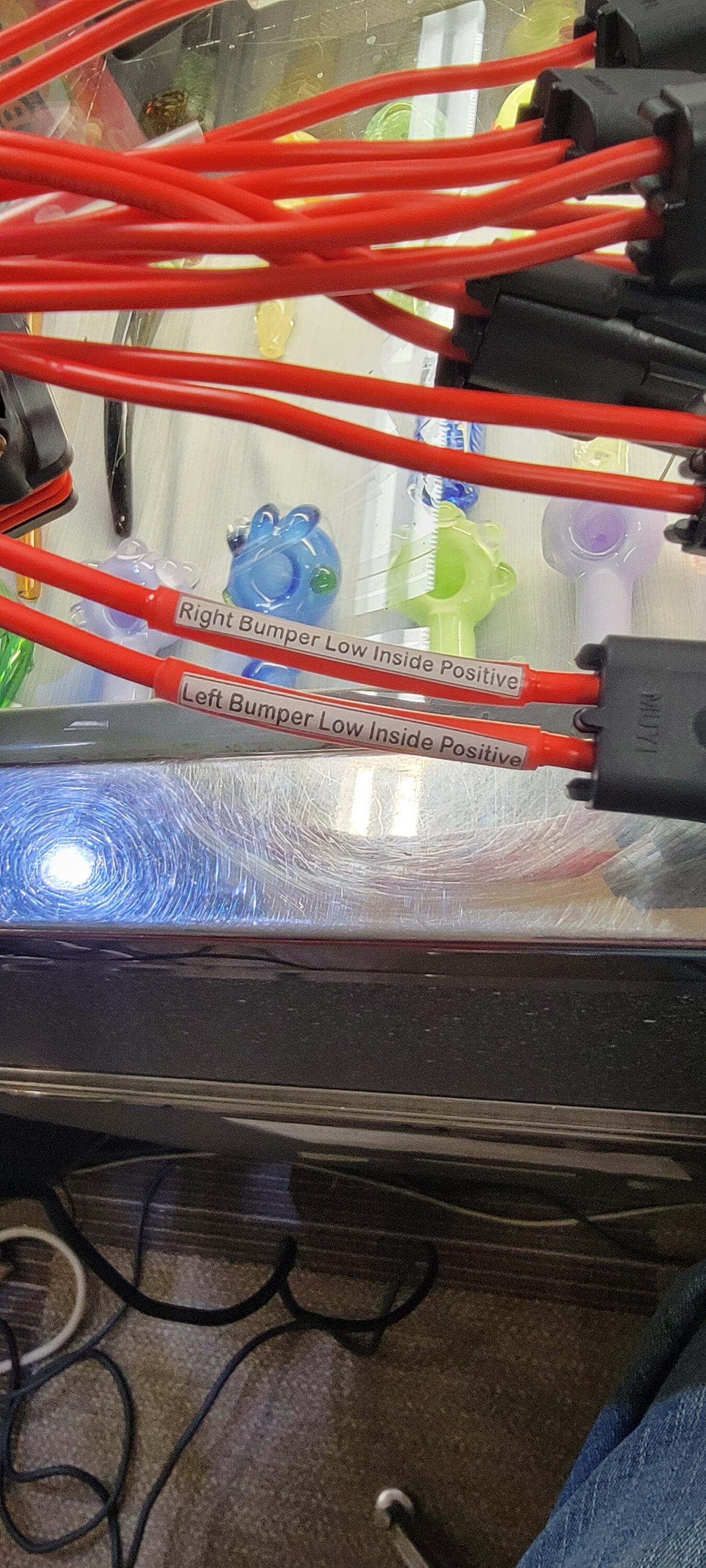

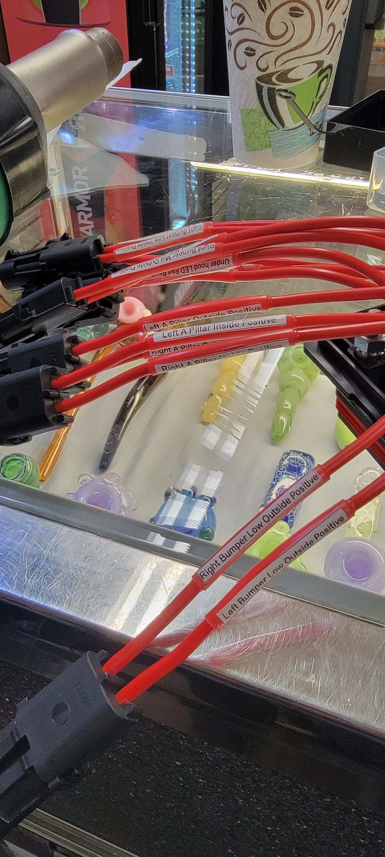

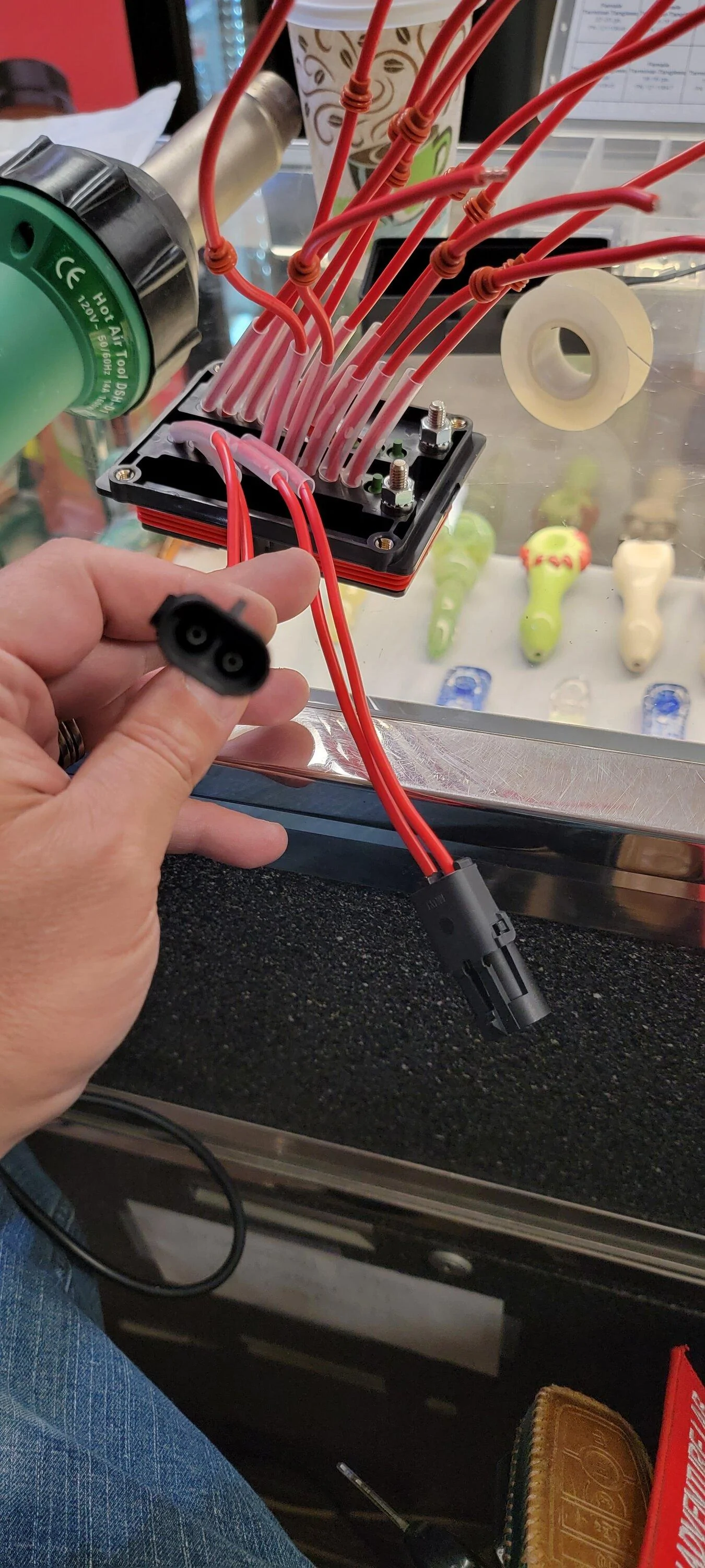

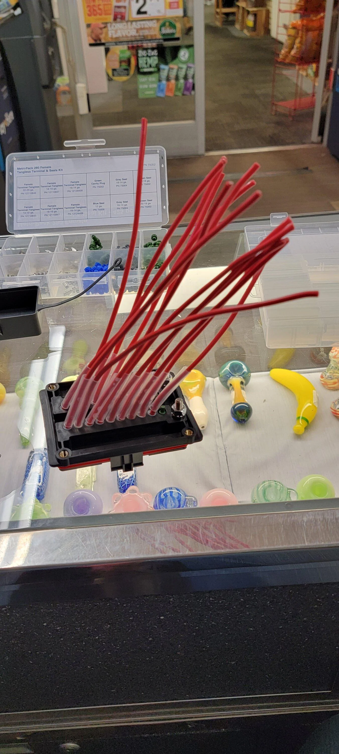

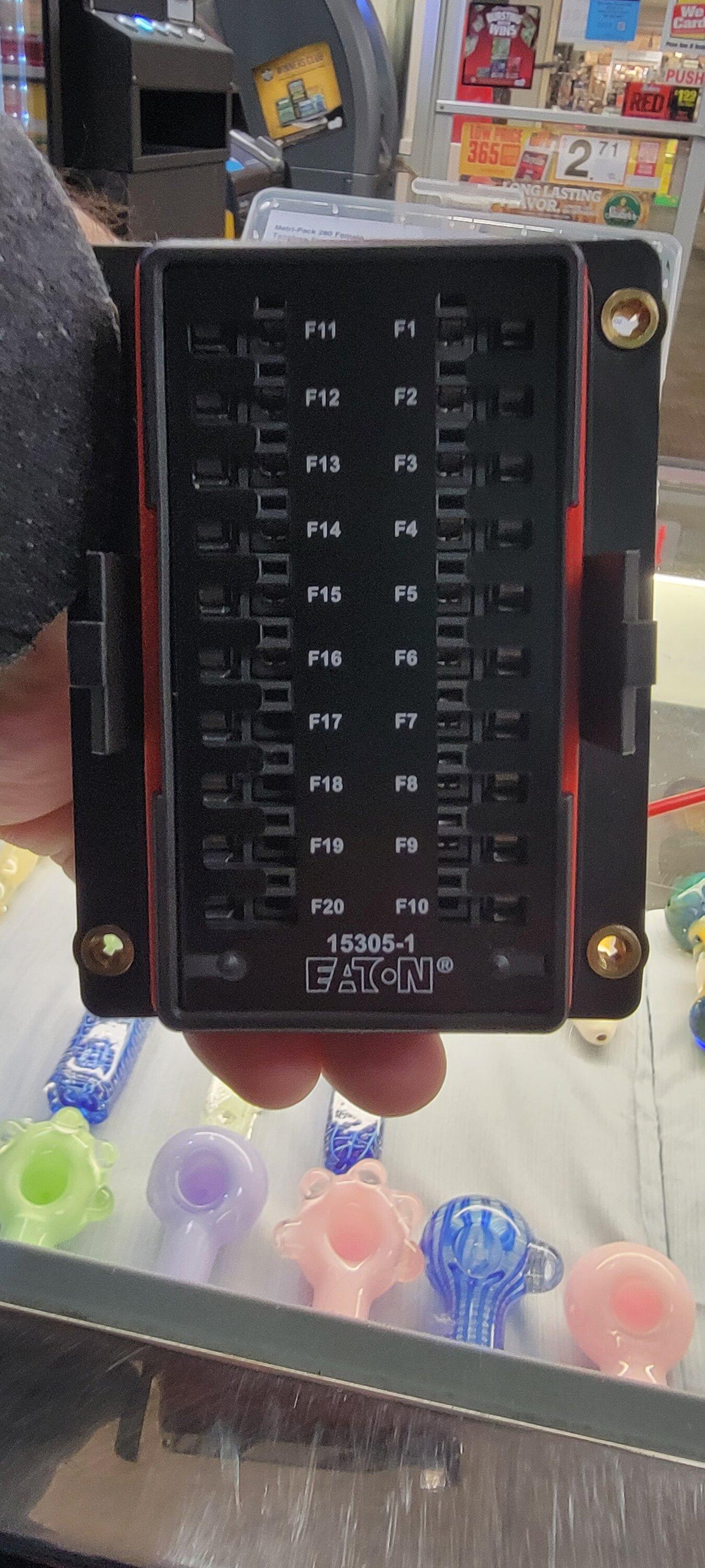

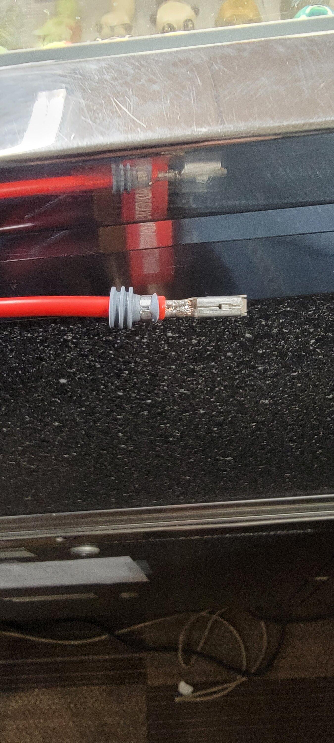

So some progress , all positives getting put I thought fuse block and some labeling. Negatives will go on the negative buss bar outside this waterproof box.

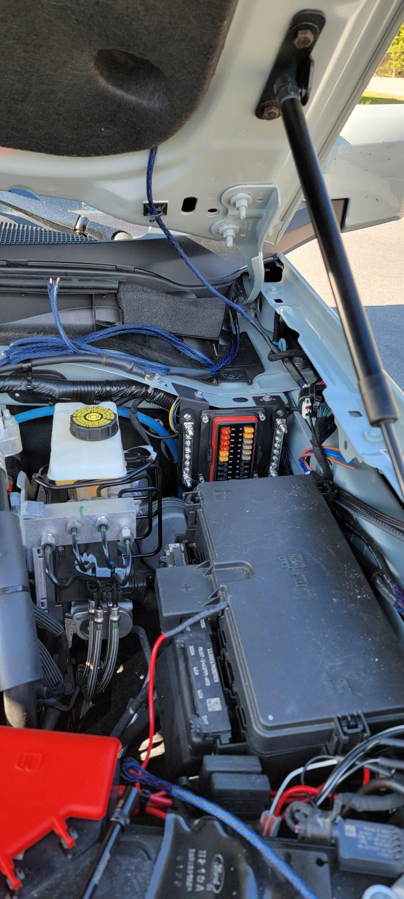

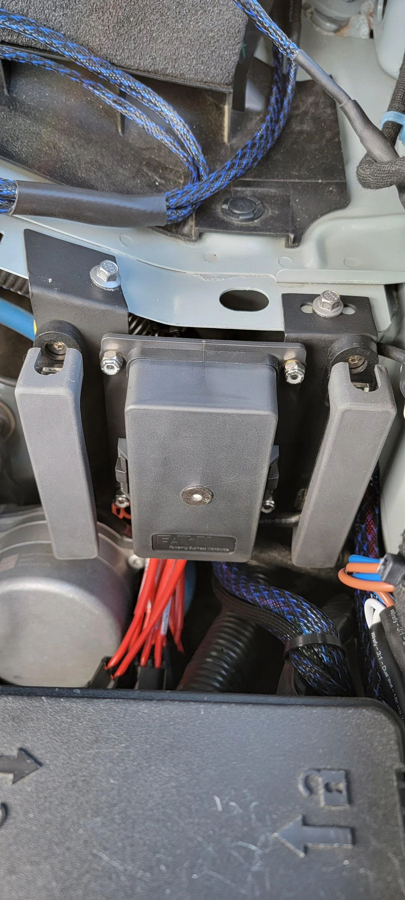

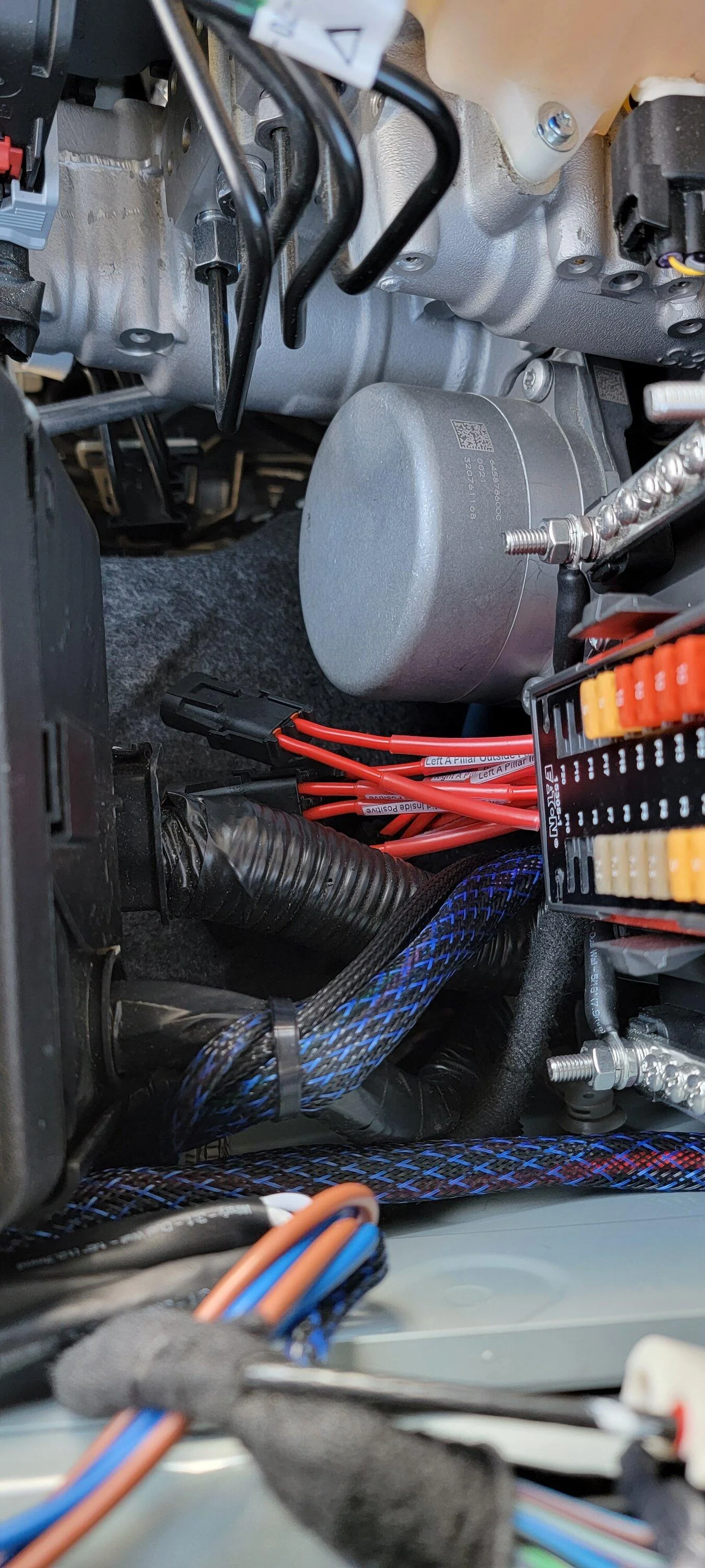

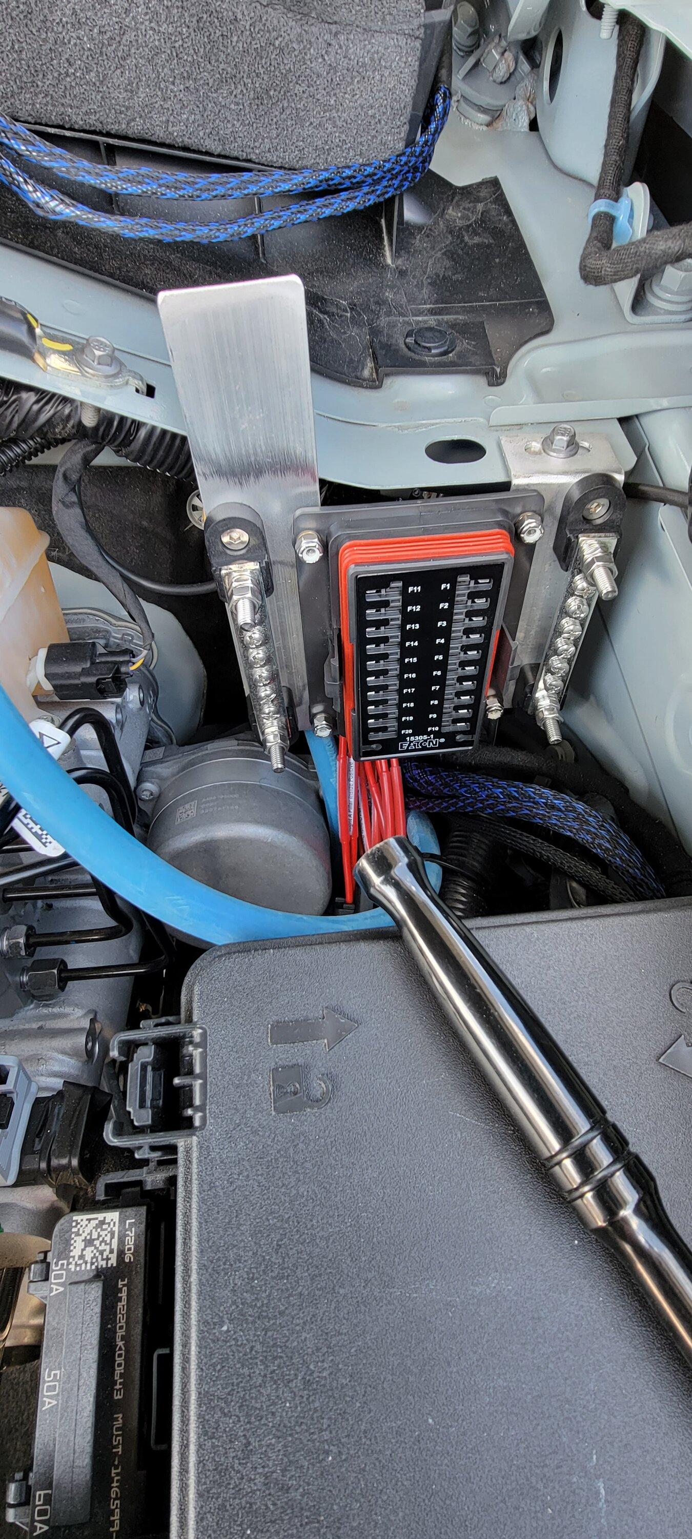

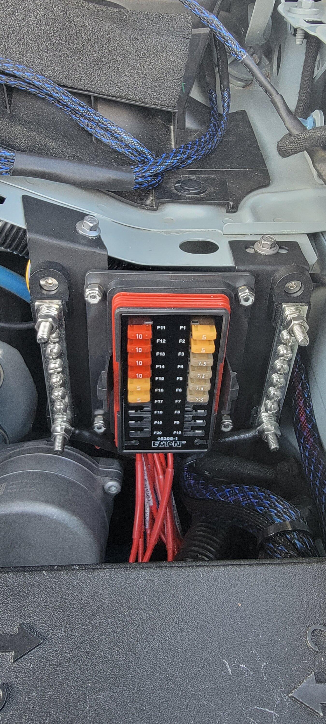

Finished the brackets today and mounted the waterproof fuse box. Also finished terminating the two 30 amp circuits running to each bussbar. Next up is wiring all the positives and negatives from the lights......to be continued

There is nothing more satisfying or inspiring that a nice wiring setup, love it!

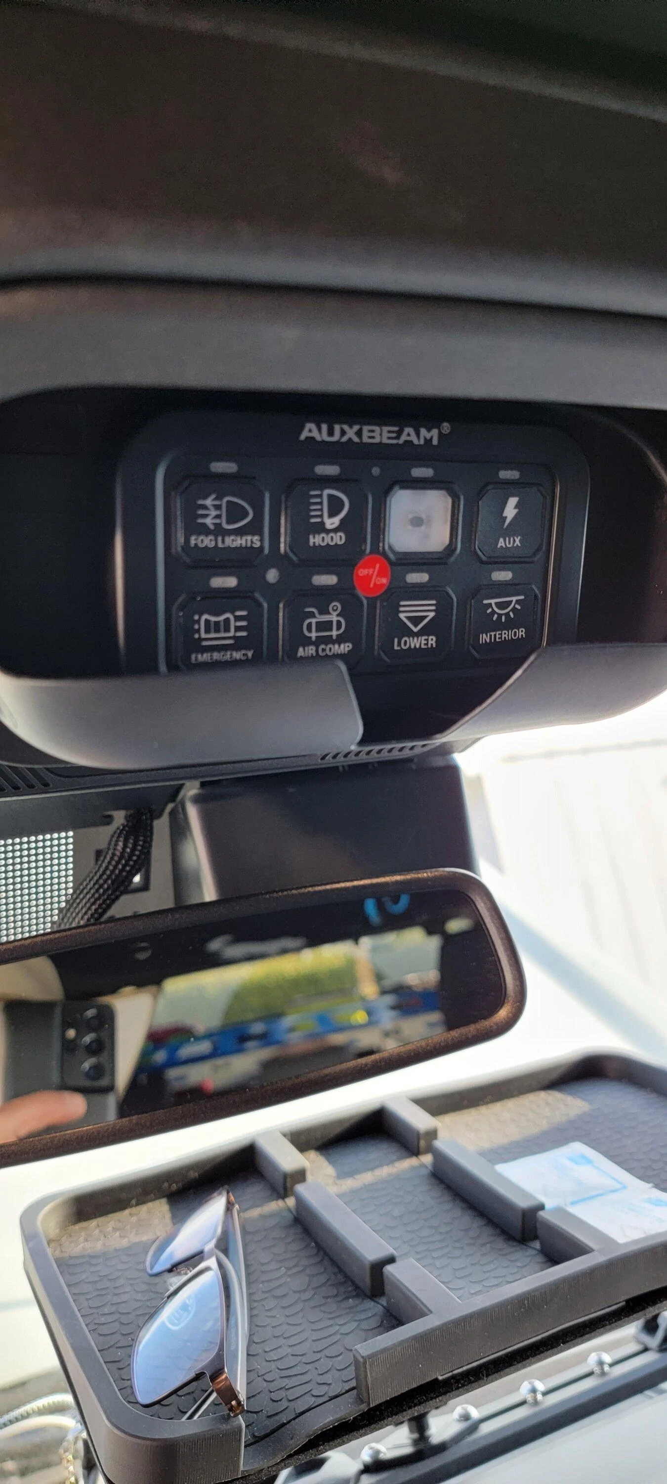

Where are you putting the relays? And how about switches? Just curious. Nice neat job BTW!

That’s is so cool.. Tuck the “switches” away and “open when needed”…. I throw my glasses on the dash away.. 😂🚗
