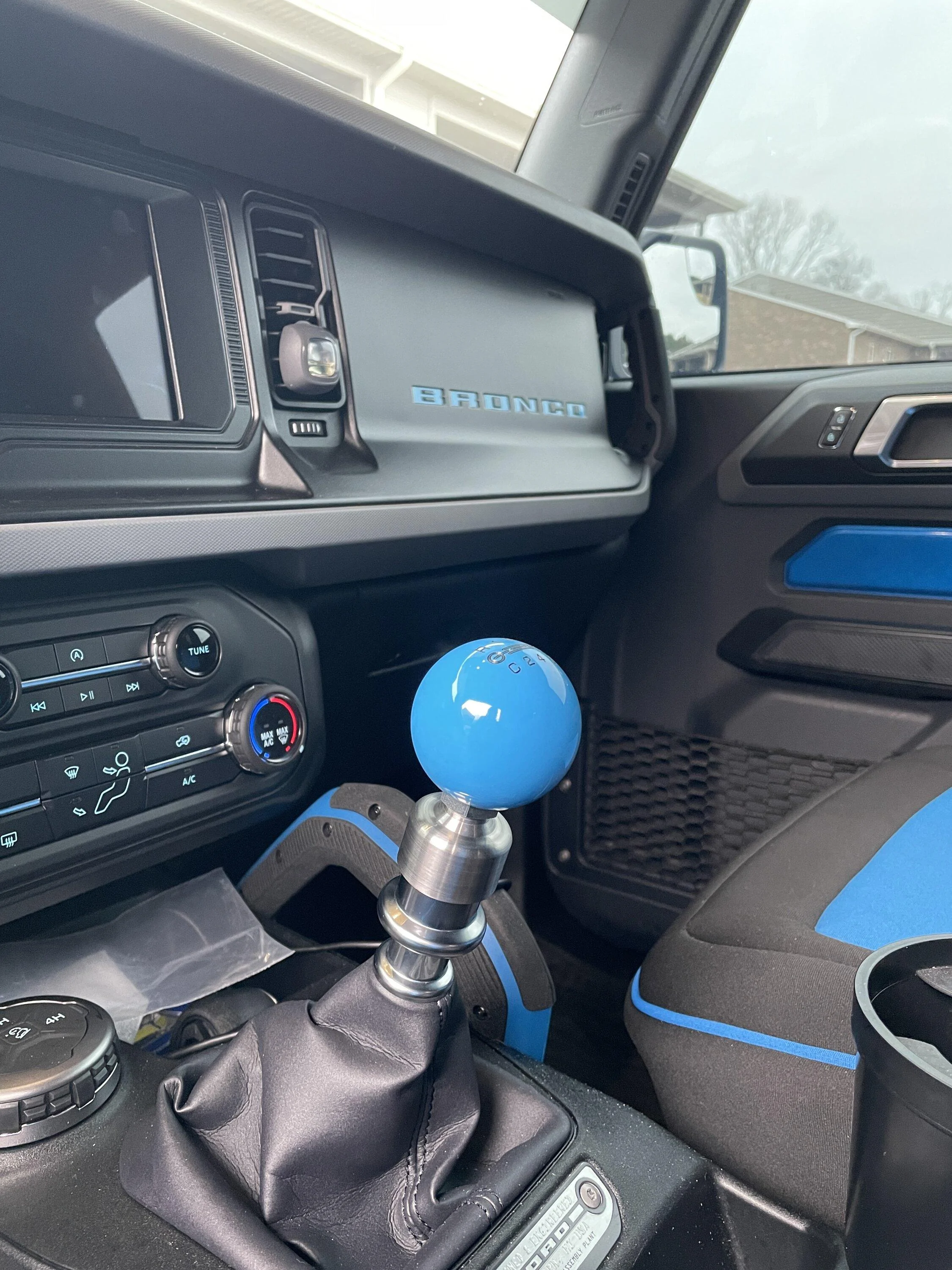

Honestly not bad, it blends very well giving an OEM look. There is a slight increase in overall height and with the reverse lockout but its not a bother to me. I don’t think it stands out much at all. Added another pic for reference

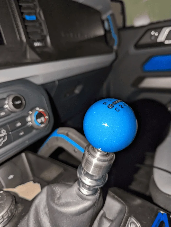

Love the shift knob, looks and feels great.
The adapter kit, not so much. Should take advantage of the geometry to prevent rotation, not just rely on a tiny set screw. Really had to tighten the crap out of things to prevent rotation.
I got Metallic Blue, works great with the blue Bronco interior.
Also, because the adapter adds a small bit very significant of amount of height I wanted to make the knob as low as possible, which means that my shift pattern is not lined up properly. Would have to rotate it back (higher) 3/4 of a turn to line it up properly.
Overall I love the look and feel, but the adapter issues (not taking advantage of geometry and additional height) hold it back.
Picture of the Metallic Blue knob (rotated so that the pattern is in the right position, but the knob was a bit higher).

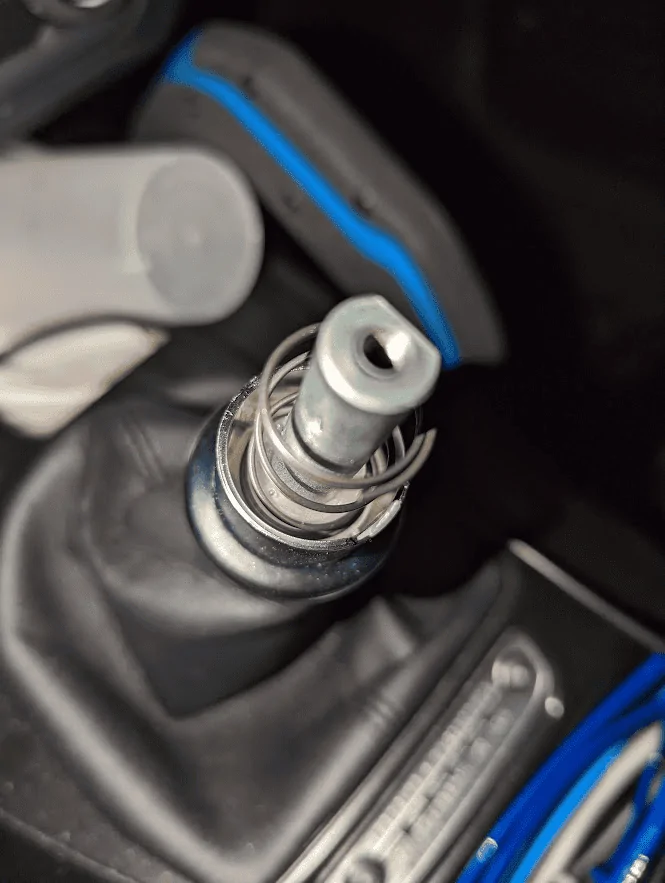

Picture of the shaft, with notch that the stock shift knob uses for alignment & preventing rotation. This is what the Twisted Shifterz Bronco adapter does *not* take advantage of.

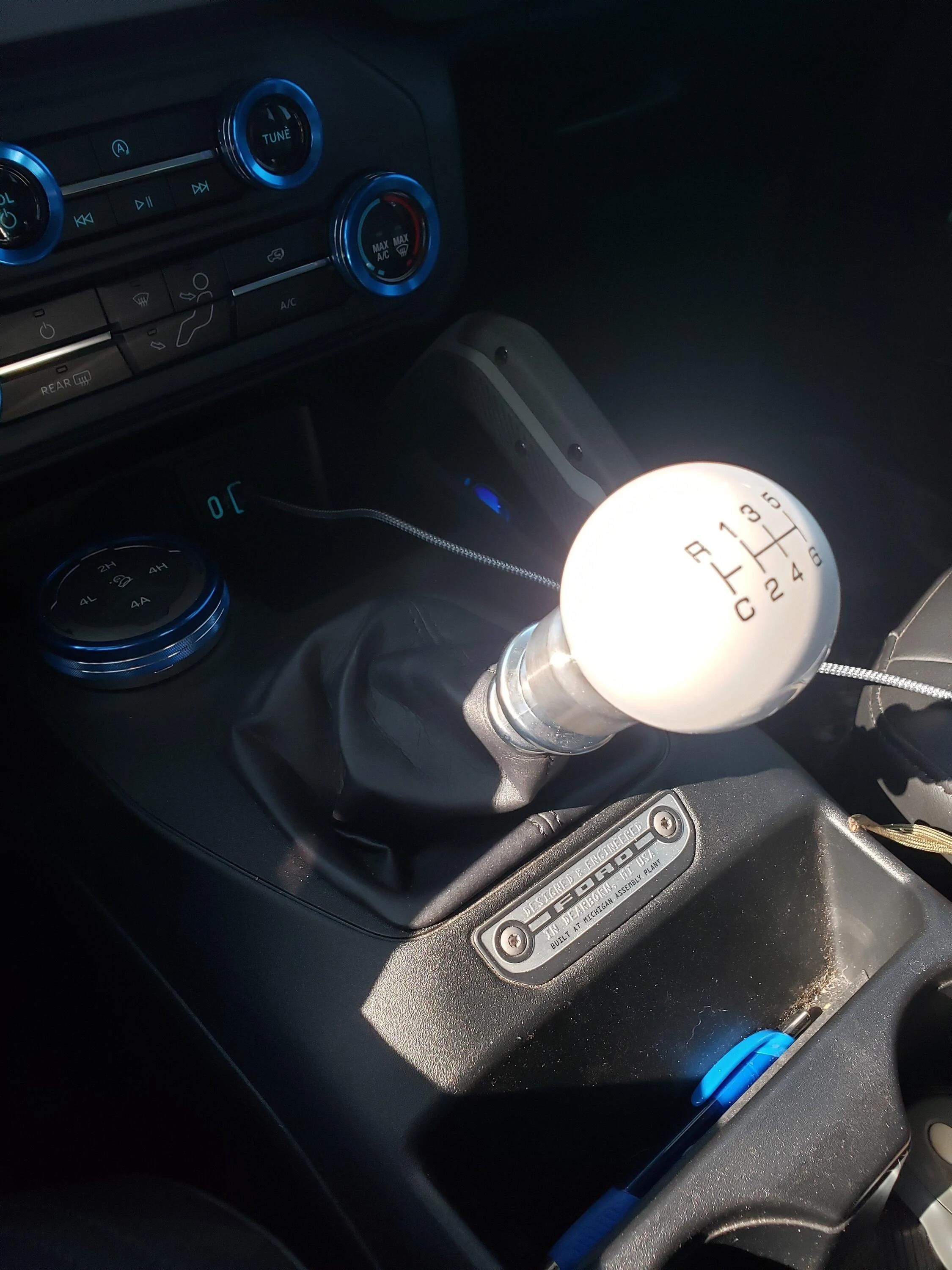

Love mine put it at perfect position
What orientation is your set screw at for the adapter? I can not get mine to tighten enough where it doesn't just pop off from the spring
TNBronc4344
JT
Aug 9, 2020
367
866
Kingsport
Did you put the top screw back in? The one that came with the original shifter? That has to be in and it holds the adaptor down in place to keep it from frying off the spring. The set screw is just to keep it from turning. I love mine.
