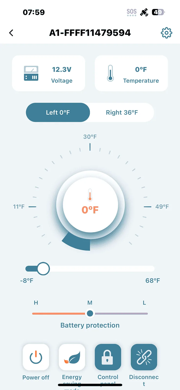

Wolfbox has an app that connects via Bluetooth to the fridge and lets you control just about every aspect of the fridge. You can control things like adjusting the dual zone temps, battery protection and energy saving mode. I had no problem using the app or the apps features.

As previously mentioned, the fridge is a dual zone and can be used as a fridge and freezer with separate compartments and temp settings for each side. Of course, you could use both areas as a fridge or both areas as a freezer if you wanted. I prefer having the large area as a fridge and the smaller area as a freezer.

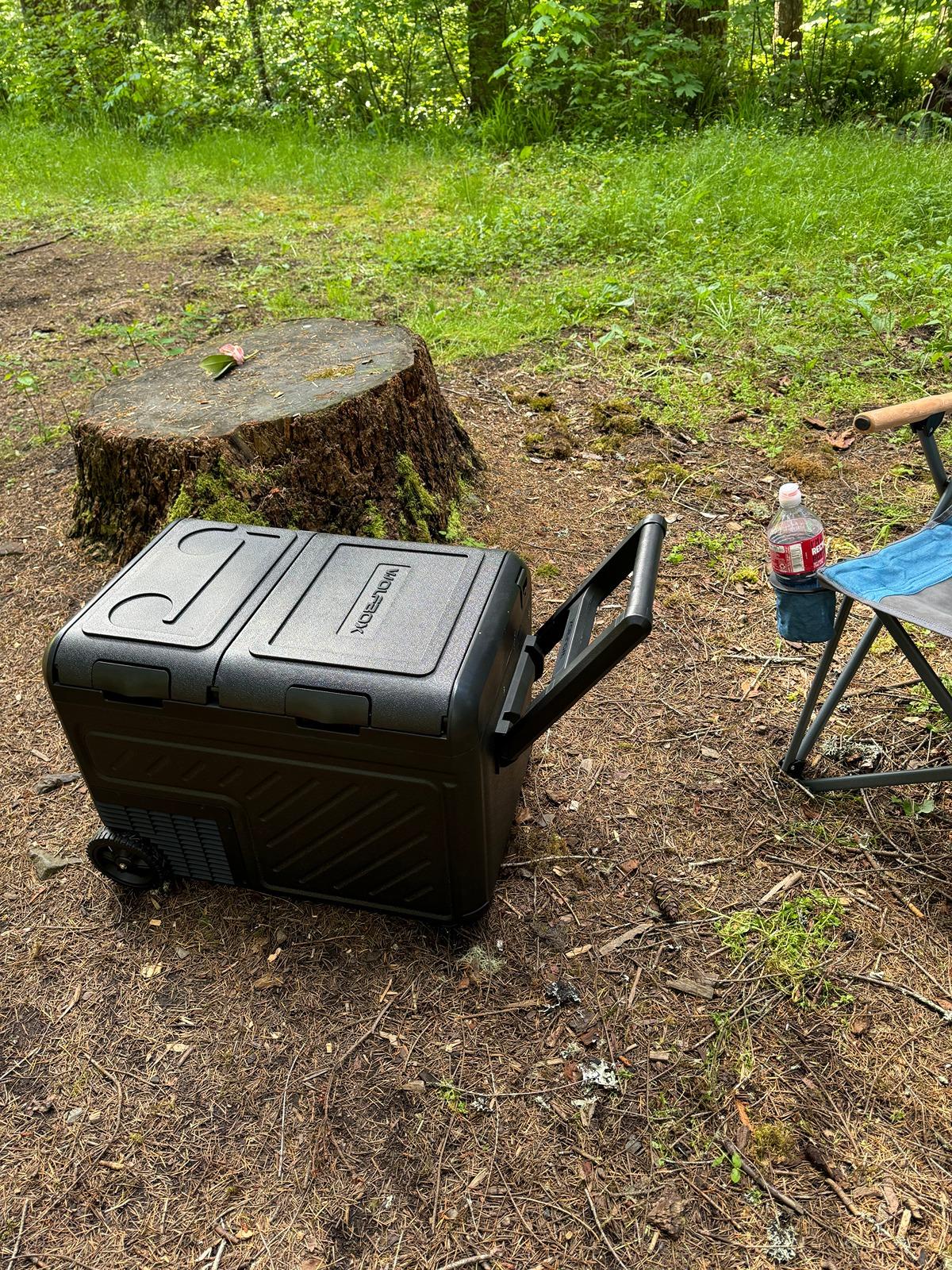

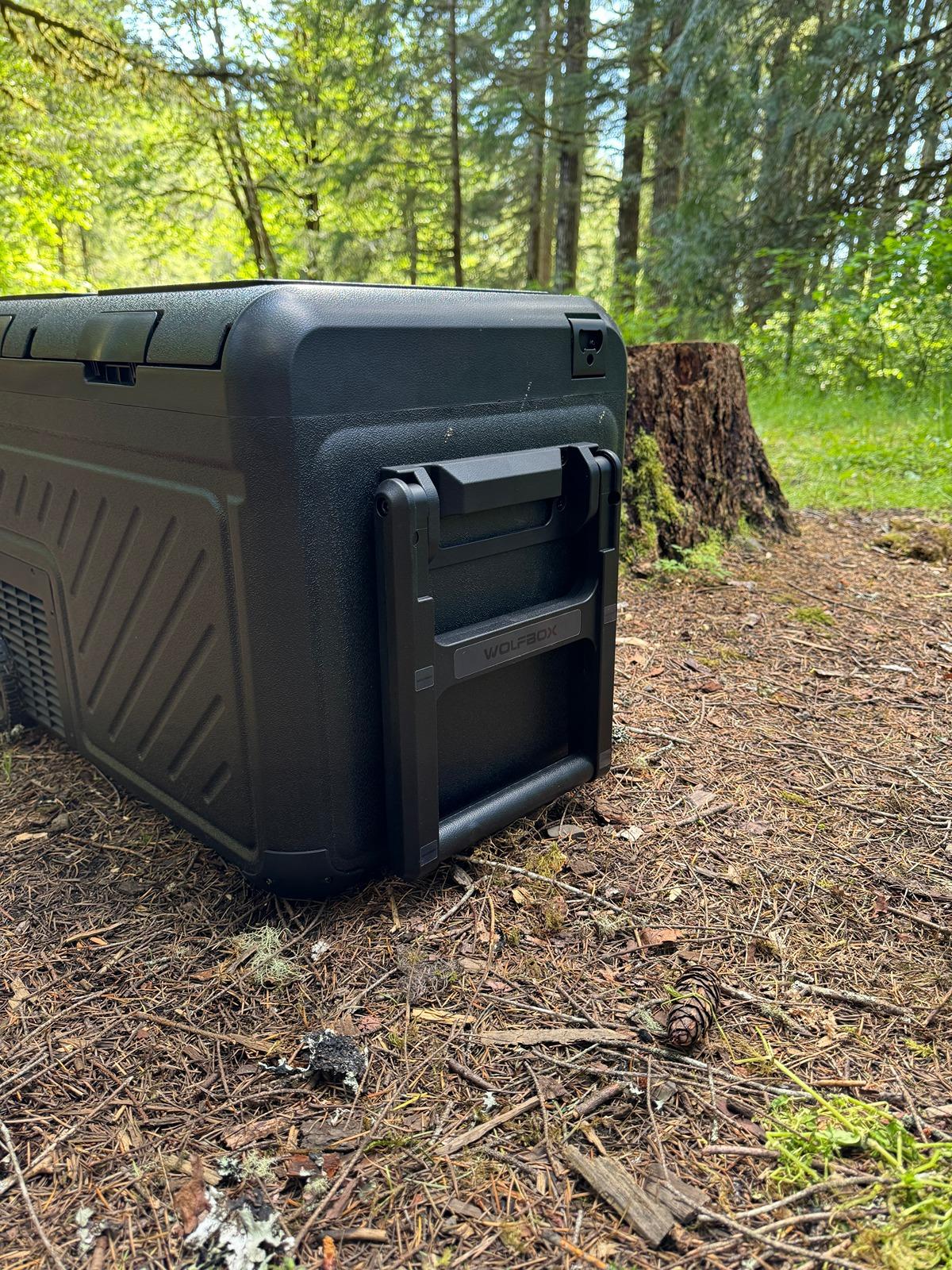

The fridge feels and looks very rugged and very well built. Time will tell how it holds up, but I am initially impressed with the build quality of the fridge. It has 2 wheels and a fold-out handle so you could wheel around it to different areas of your campsite. There are also carry handles if you’d prefer to move/carry it that way. The fridge also has a bottle opener which is a nice addition.

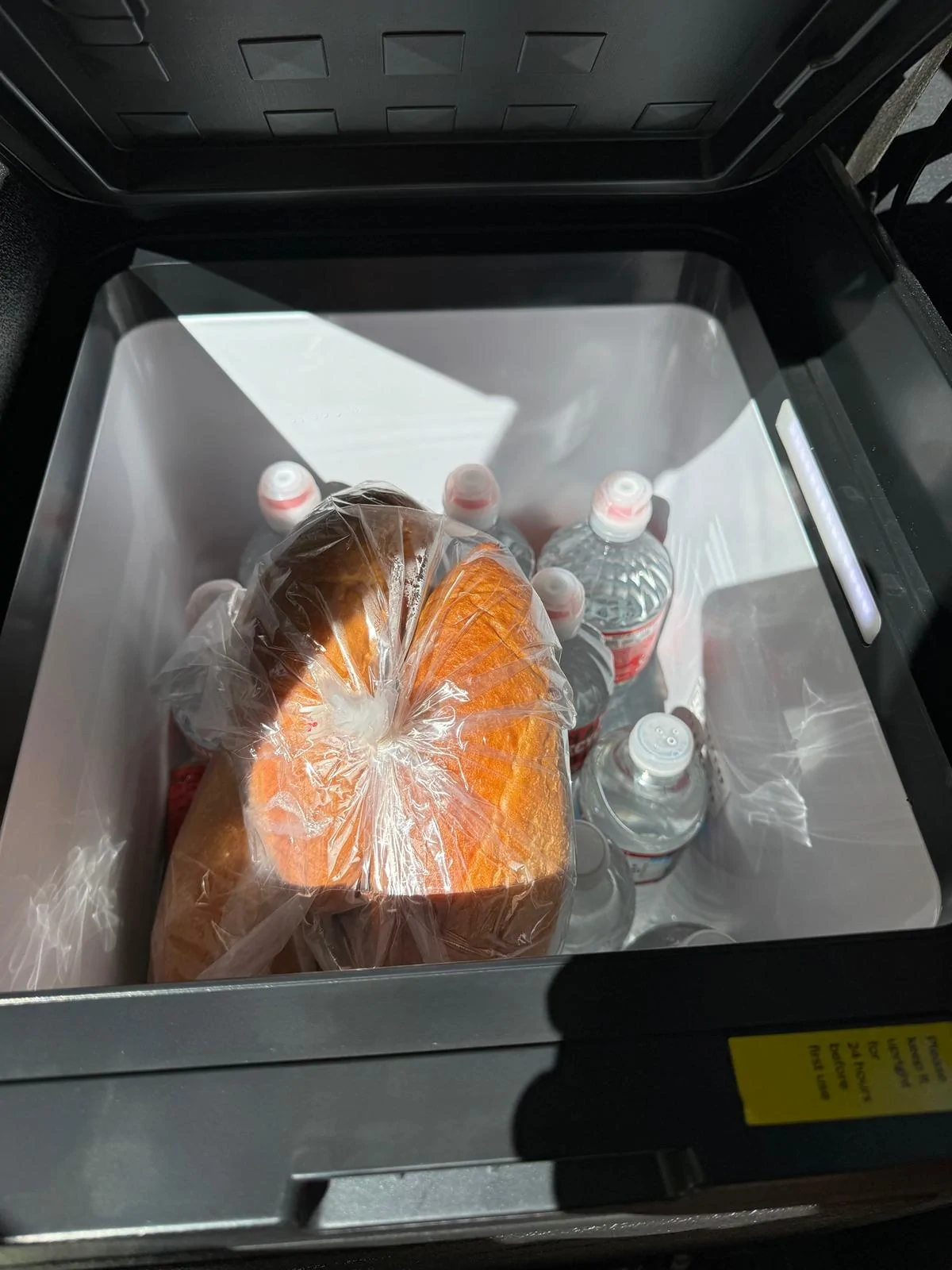

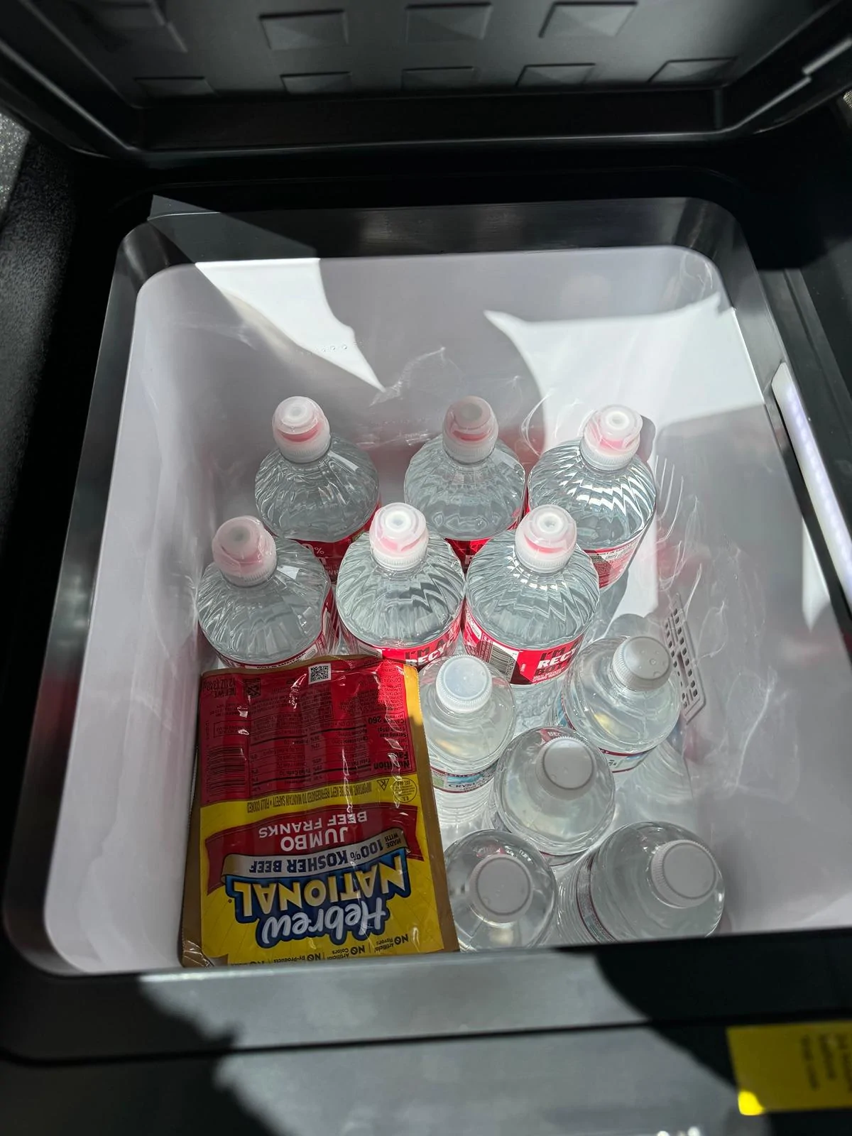

The fridge worked out great on my camping and off-road trip. The morning before leaving, I plugged it in at home and set the temps for each zone. I set the freezer side to 0 and the fridge side to 36. It took about 1 hour to go from room temp to the temps I set. Once the temps were reached, I loaded it up with drinks and food for the trip. Since it’s a dual zone, I also loaded up some ice cream into the freezer area.
Ford Bronco Wolfbox Car Fridge 2nd Gen - Review IMG_0003
Ford Bronco Wolfbox Car Fridge 2nd Gen - Review IMG_0005
Ford Bronco Wolfbox Car Fridge 2nd Gen - Review IMG_0004
I plugged it into the rear 12V port on the Bronco and headed out. After setting up camp, I left the fridge in the Bronco, secured with a tie down strap, and headed out for some off-roading. It was nice to be able to grab ice-cold water out of the fridge on stops. I even had a pre-made PBJ sandwich for lunch that was in the fridge.

After a day of fun off-roading, I made it back to camp and unloaded the fridge from the rear of the Bronco. I rolled it over to my tent area and plugged it into my Bluetti AC70 Portable Power Station that has a 768Wh capacity.

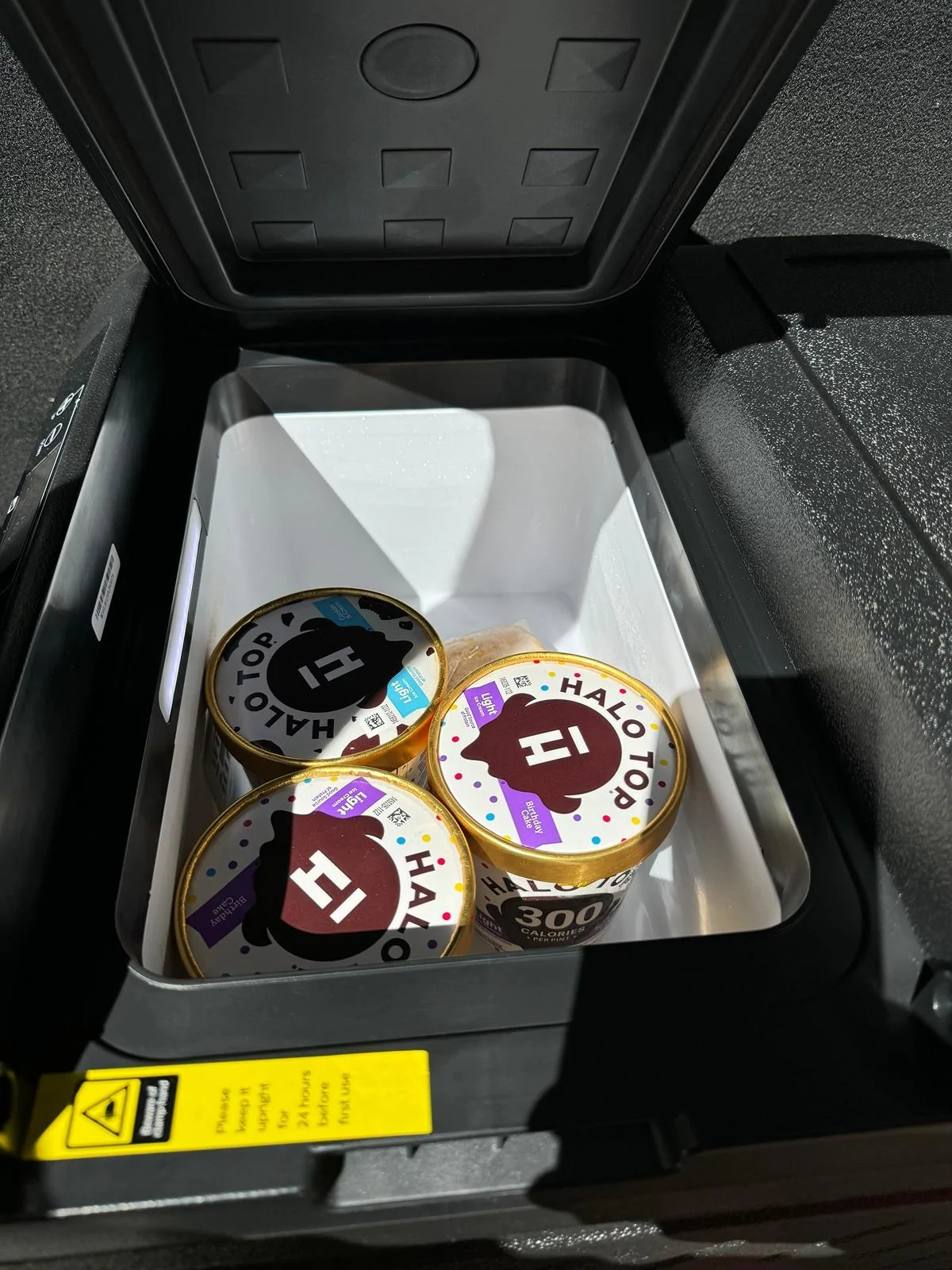

As the sun went down, I started up my firecan and decided it was Ice Cream time. Grabbed one of the flavors I had brought out of the freezer side of the fridge and wolfed it down.
