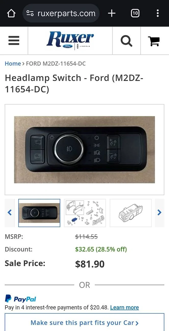

Damn I paid $77.28 years ago.
My part # was M2DZ-11654-DA though. That site you linked (Ruxer) sells the one I got for $81.90
So mine clearly has additional functions

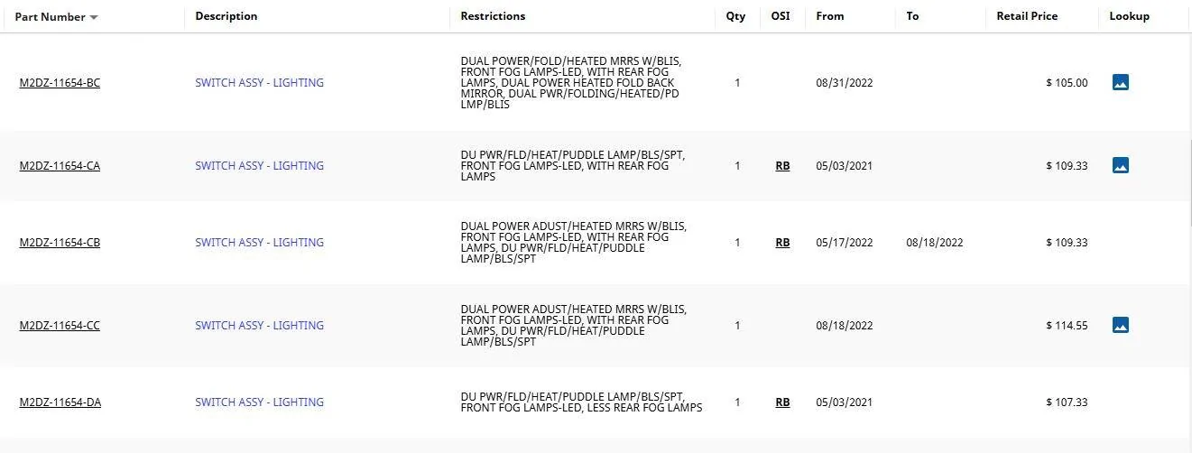

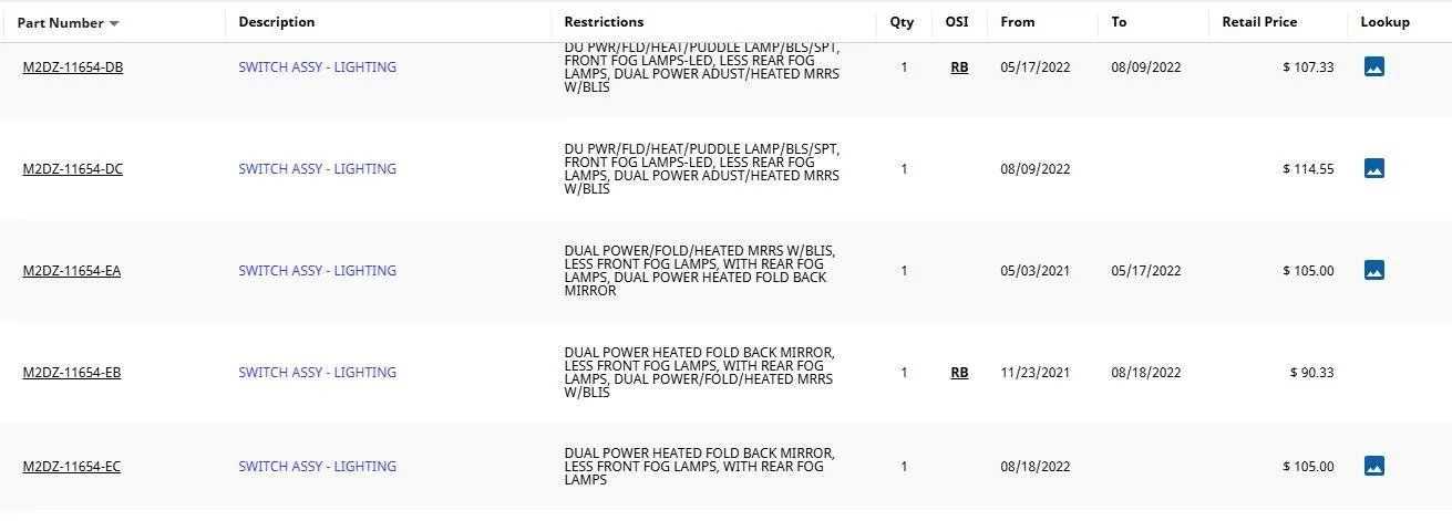

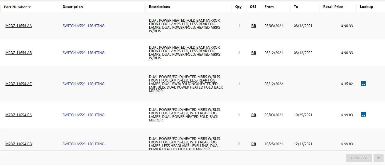

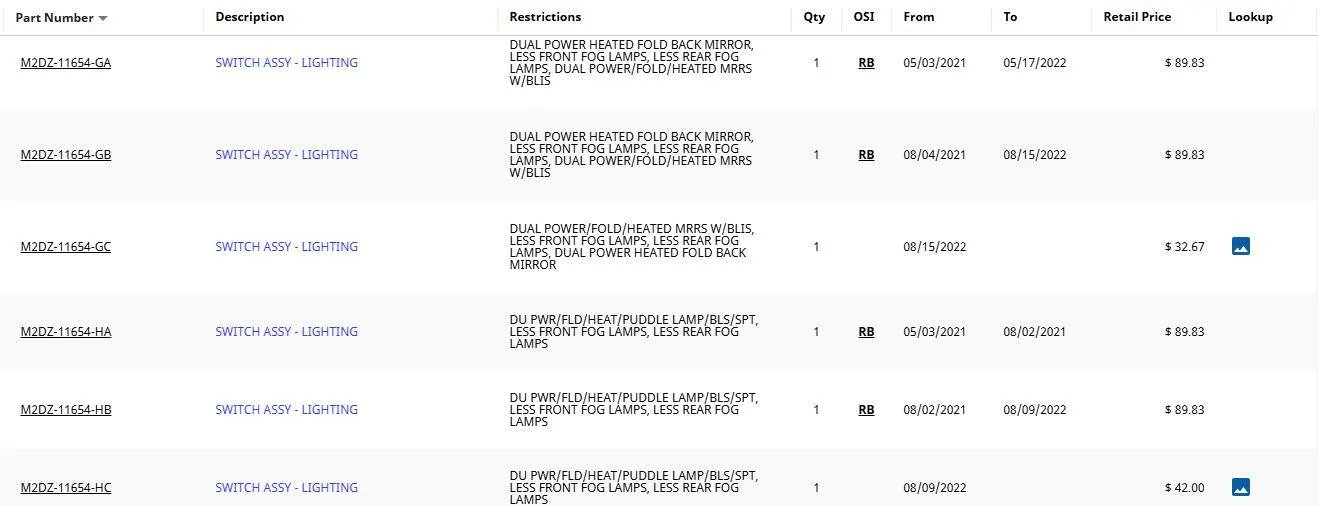

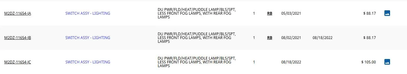

Here's a list of all the switch choices. Basically, you look up what is on the vehicle according to HVBOM or parts catalogue, then find the one with the same options and "front fog lamps". In 2021 there weren't nearly as many choices, supersessions and build date breaks.
If you've set up an account on our parts store, sent me a DM with the email addy you used, I put you in the 6G discount group so the price you see below from the catalogue is list, not what you will see on www.ruxerparts.com.

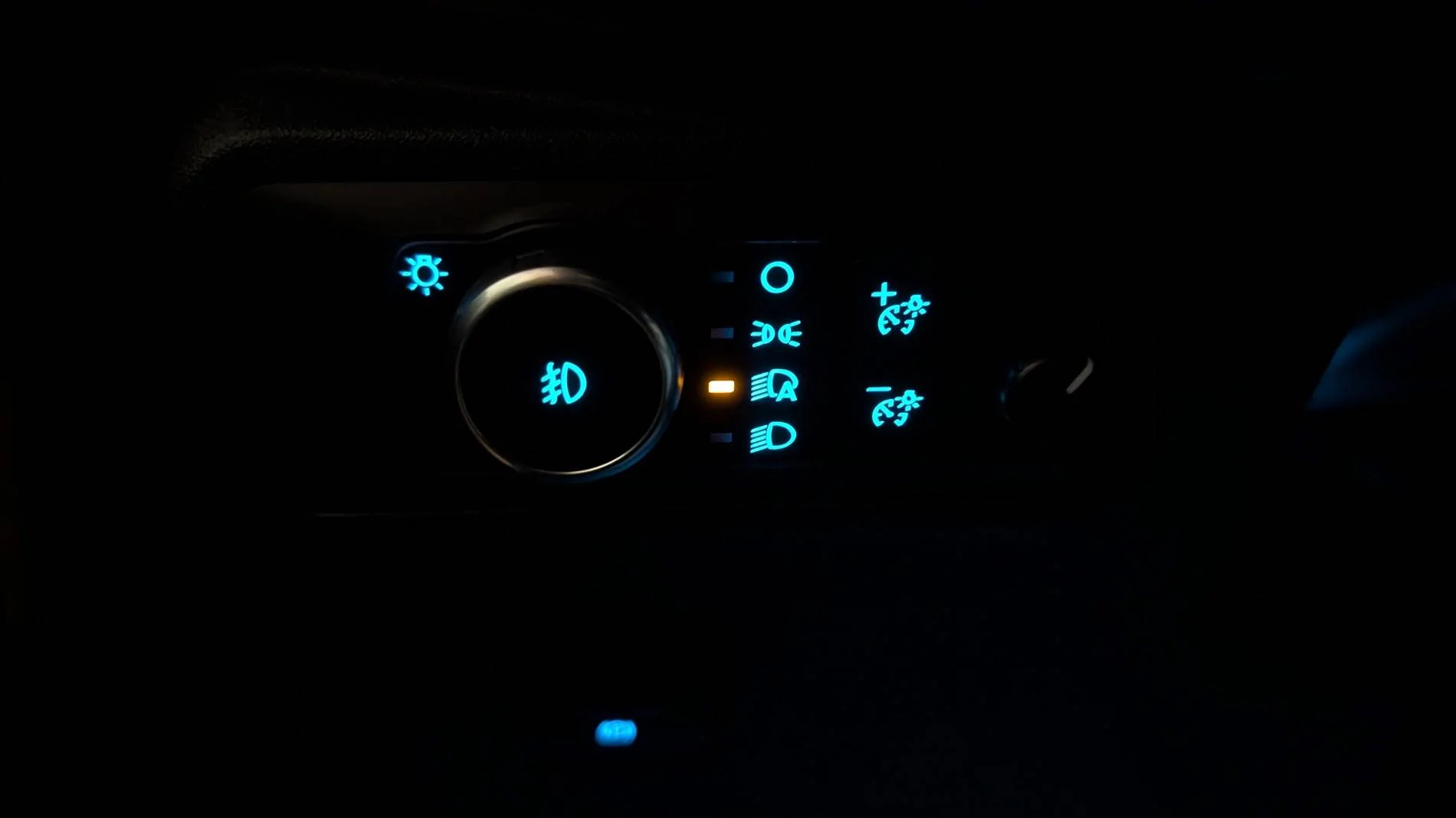

Don't mean to hijack but I have this switch, can I swap out in my Heritage and and use this for adding lights?
