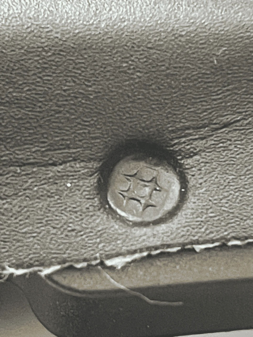

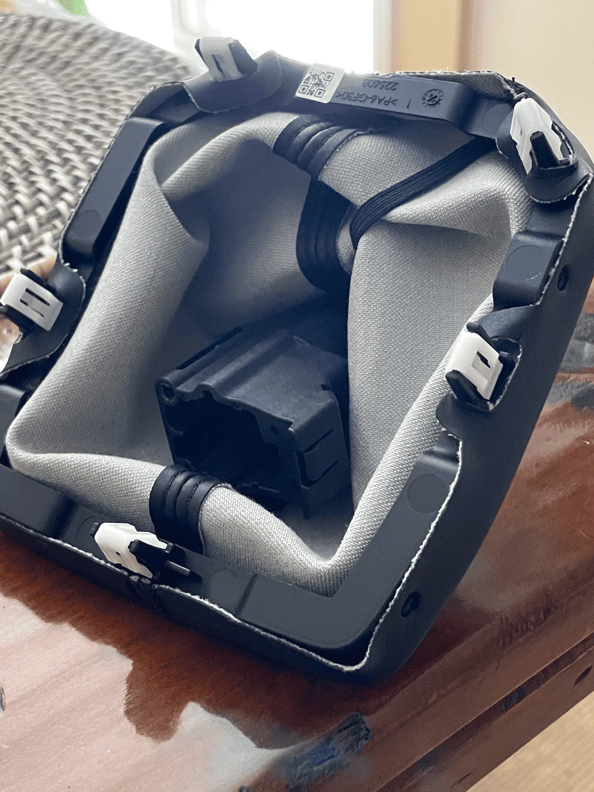

I ordered a manual transmission shift boot from Ford so I can take it apart and figure out how to remove the vinyl piece from the rest of the hardware. Getting to this state is very straightforward and self-explanatory (this is a view from the underside):
Ford Bronco Aftermarket Shift boot? IMG_0743

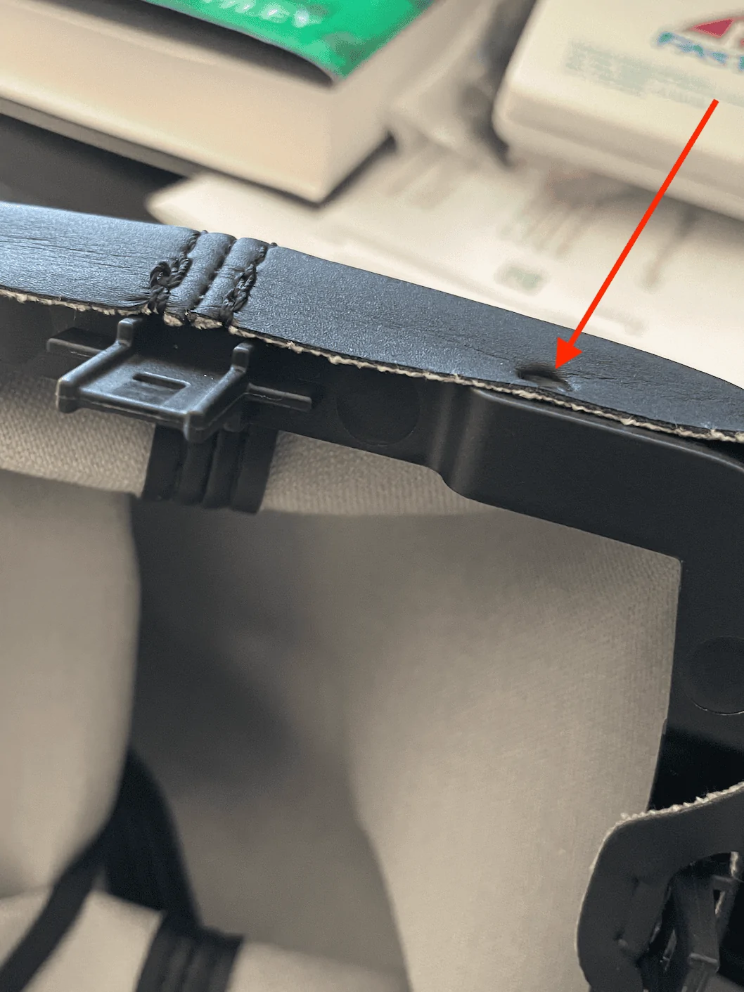

The white tabs hold the vinyl to a square plastic frame. After removing the white tabs (can remove with finger pressure) I see that the vinyl is further attached on the sides via little plastic pins/grommets. See the following pics:
Ford Bronco Aftermarket Shift boot? IMG_0753
Here is a closeup of the top of the pin/grommet:
Ford Bronco Aftermarket Shift boot? IMG_0754
Not sure how to remove these...there are 8 of them and they need to be removed in such a way that they can be reattached (with a new boot). They don't have a philips or metric head, what's on there is a raised (not indented) hash that looks like it's for decoration. They don't poke out on the inside of the frame so I can't push them out (i.e. they don't break the surface of the inside of the frame).
I'm reluctant to dig them out with a screwdriver as I'll most likely ruin them. I guess I could force one out, and find a replacements if I ruin it. Not my preference. Any other suggestions?
Is the frame hollow on the other side to pop them out from the back? If not then you're probably right and will have to dig at least one out to see how it attaches and then hope it can be reused. Seems like any screw/bolt or even a ziptie could be wrapped around since you won't see it anyway.
Did you remove the boot? Looks to me like those 8 things are just where the vinyl is melted to the frame to hold it for the instal. Possibly reattach to those places with glue or vhb tape
Those are connectors. Just unsnap the boot (once the spring from the shifter handle is removed). No glue or tape needed.
