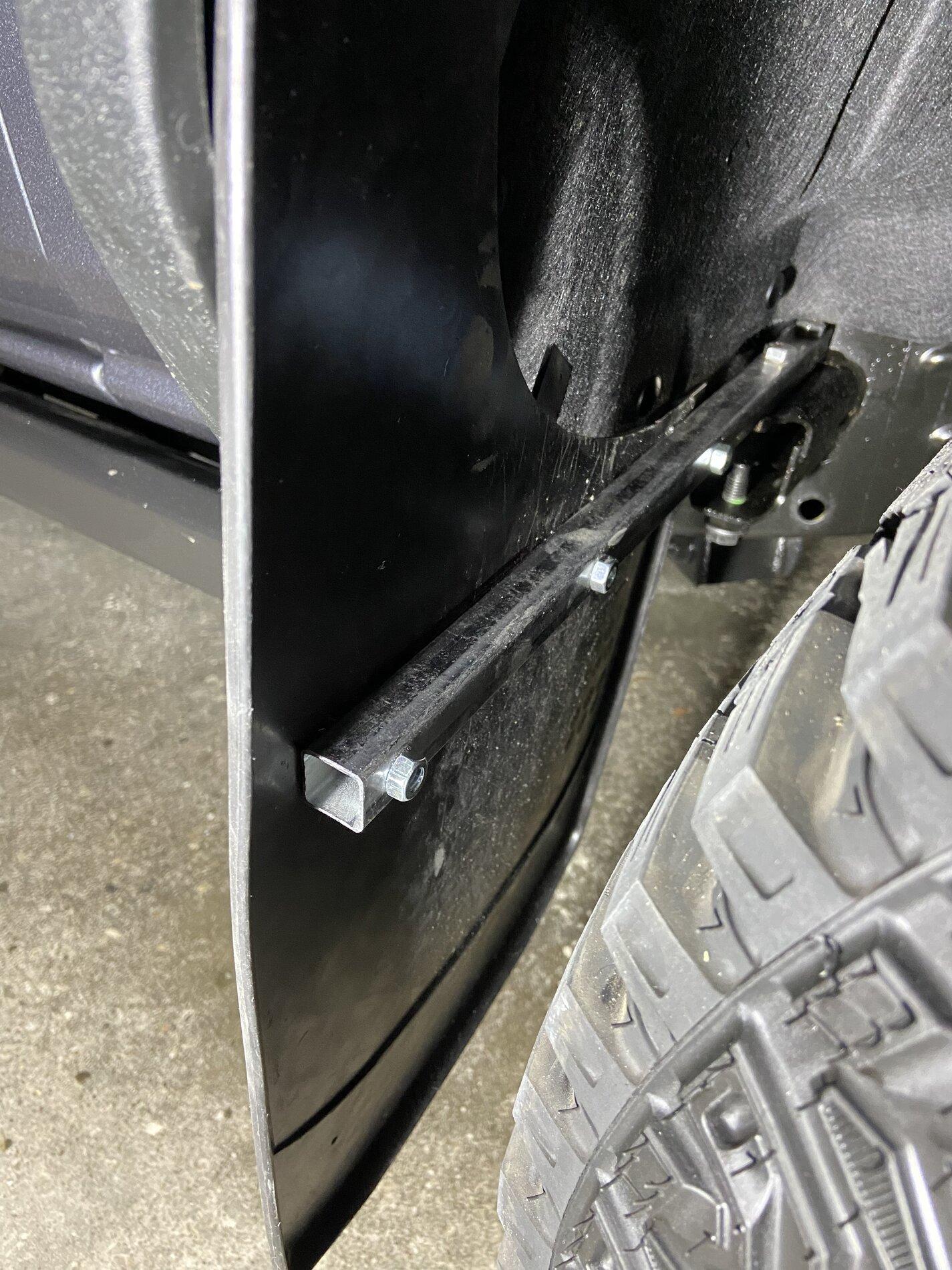

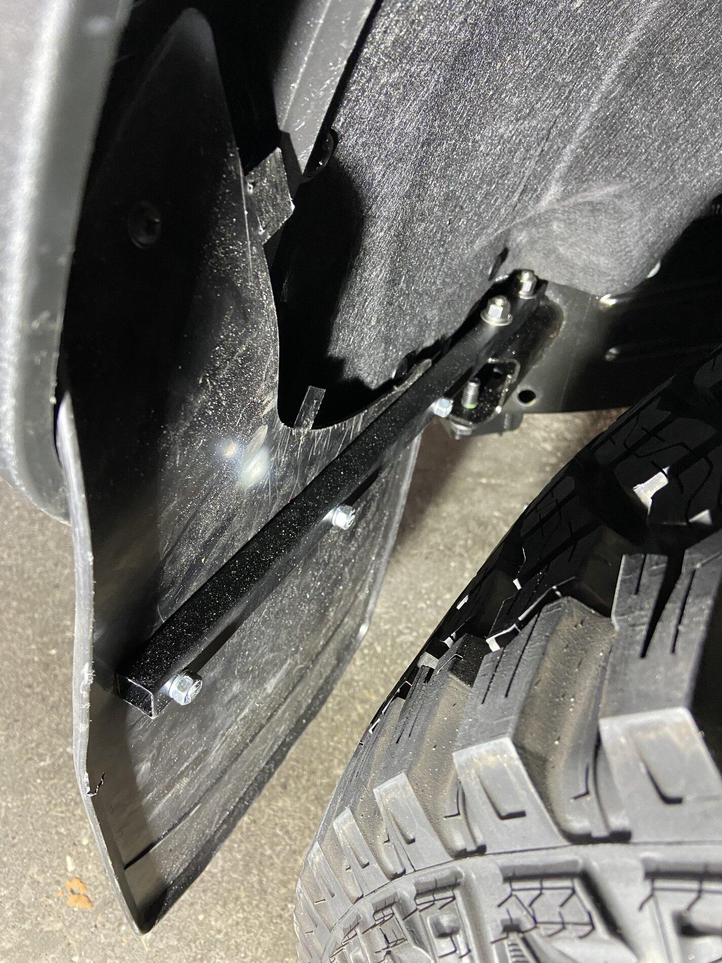

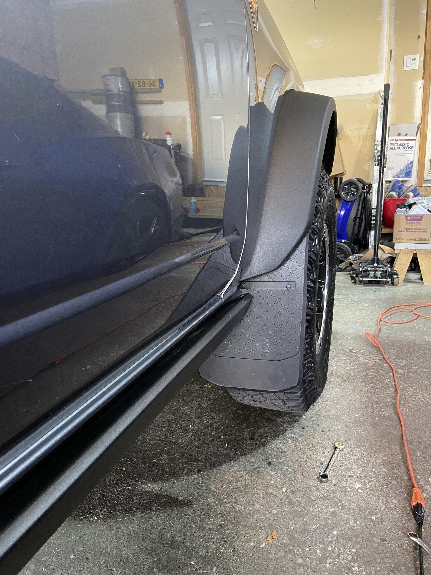

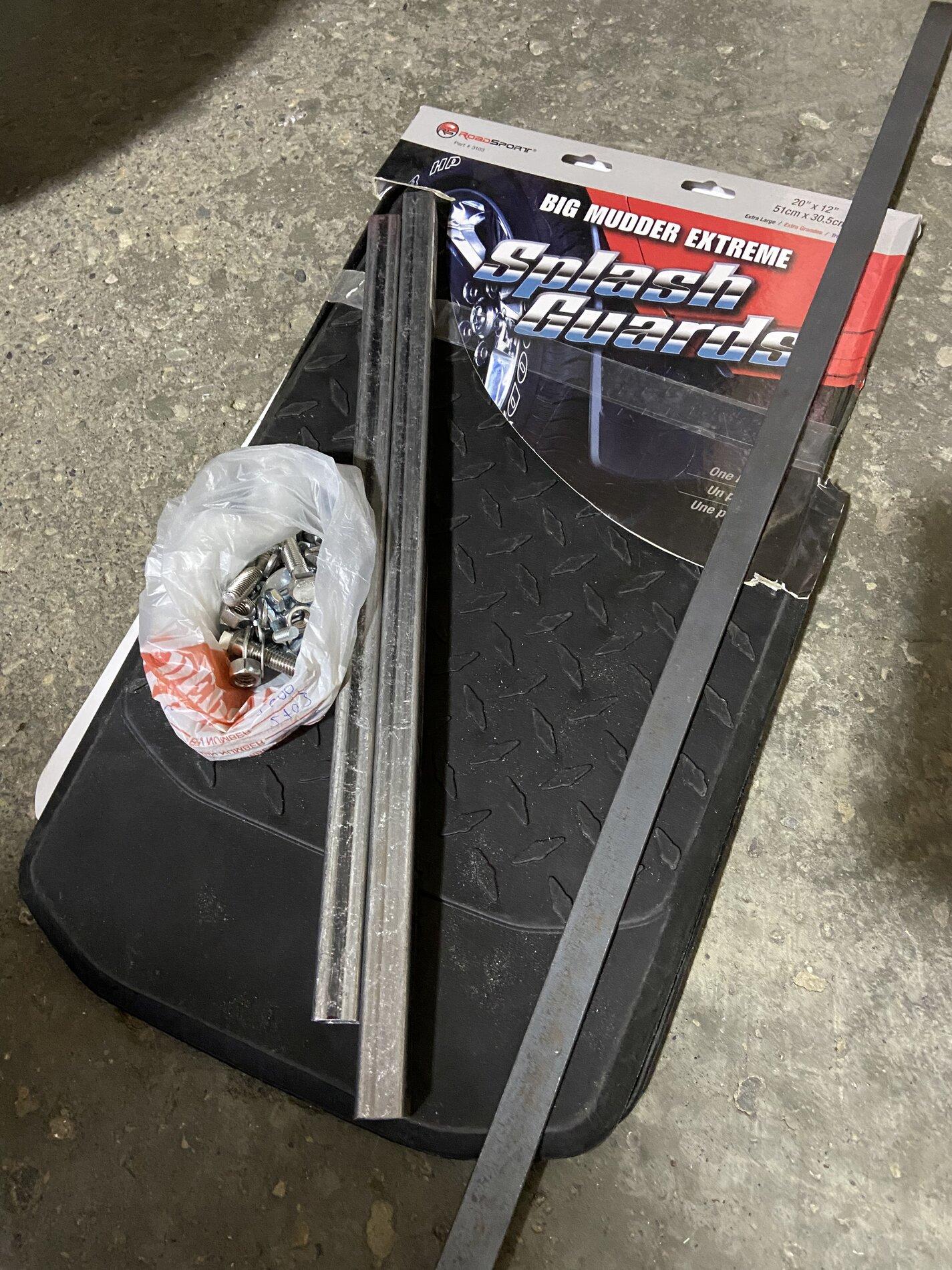

I made some very simple flap mounts kind of like a lot of bigger trucks have with mud flaps from Canadian tire and some hardware from home depot. Total cost is $80. I used the mounting brackets for the crash bars since I don't have crash bars. I still have to paint the hardware but I think it looks ok. Sharing in case anyone else get inspiration from it. Also this didn't require putting any screws into the body or cutting around the slider.

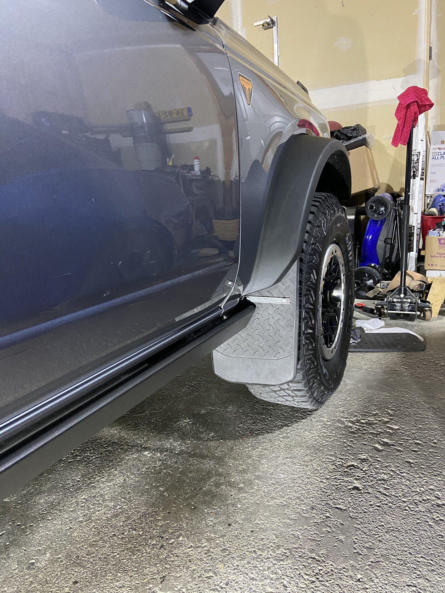

All painted and finished now
