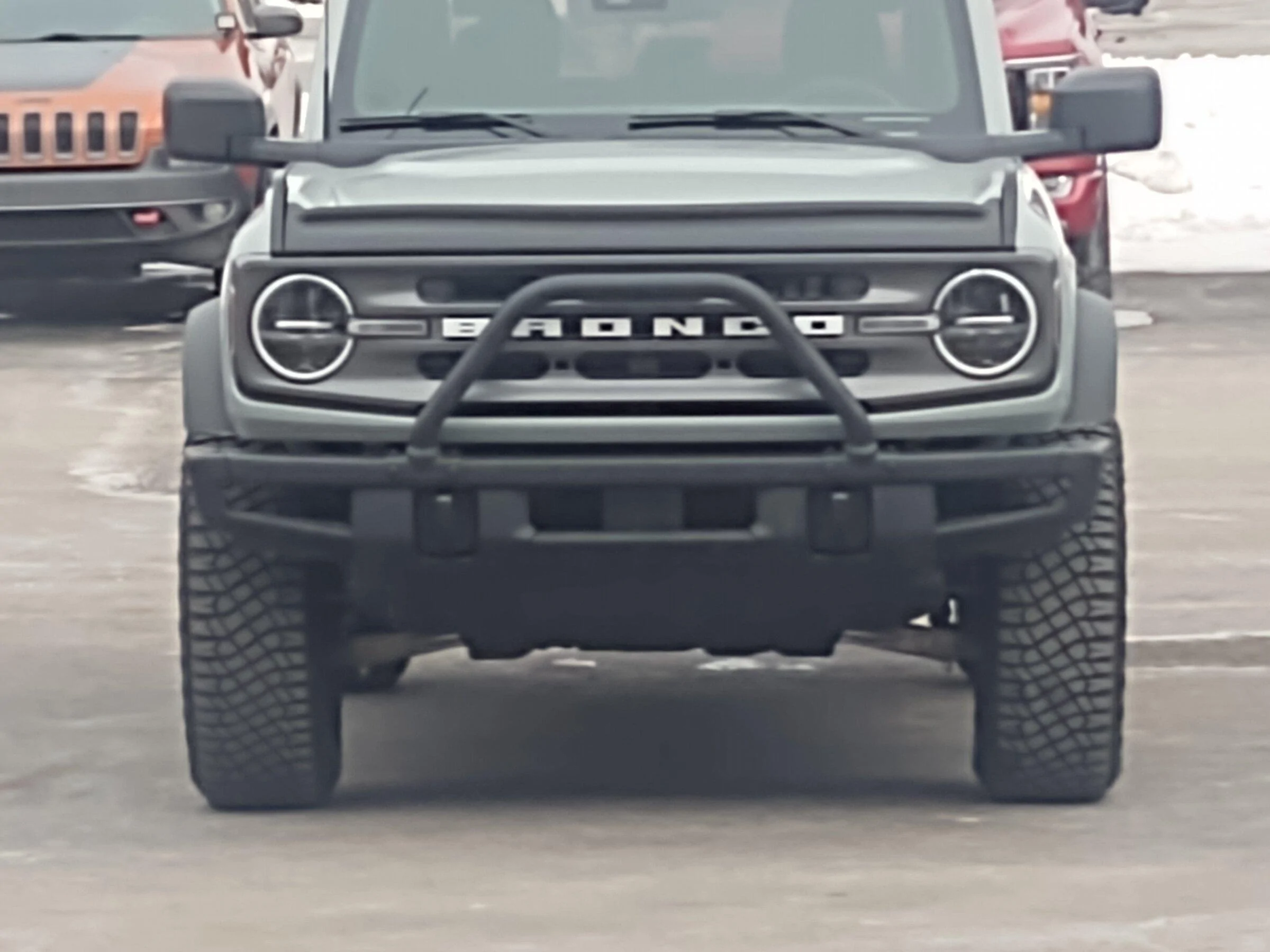

Got a BB and added a 2in level with 35's, have a alignment done 3 times now and looks good for a couple days and then the top of the front tires kick out about a inch . camber bolts are tight and not rubbing anywhere. any techs know what may be causing this?

2IN rough country installed at a shop, did not replace control arms. I work at dealership and watched the bolts get tightened to the max. feels fine driving but after a couple days i pick up a slight vibration and then i look and sure enough it out a little bit
Ford Bronco alignment issues after 2” level with 35's IMG_20220228_102519359[6456]

still drives straight , just pick up a slight vibration after a couple days

the alignment was done at the ford dealership i work for. one when the tires were swaaped out. ran it for a daay and noticed it off. did another, looked great and after a couple days it was back out. actully ordered new cam bolts thinking they may have been bad . replaced cam bolts friday and looked great agin. drove it this weekend (100 miles ) and noticed it again this morning we are going to paint pen the bolts and see if they are backing out for some reason.
