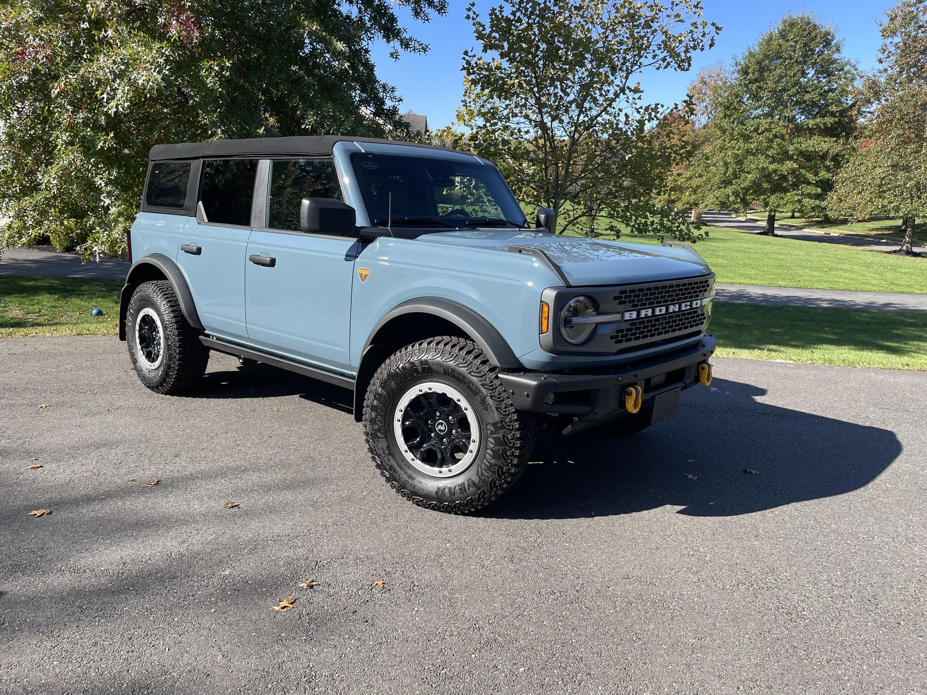

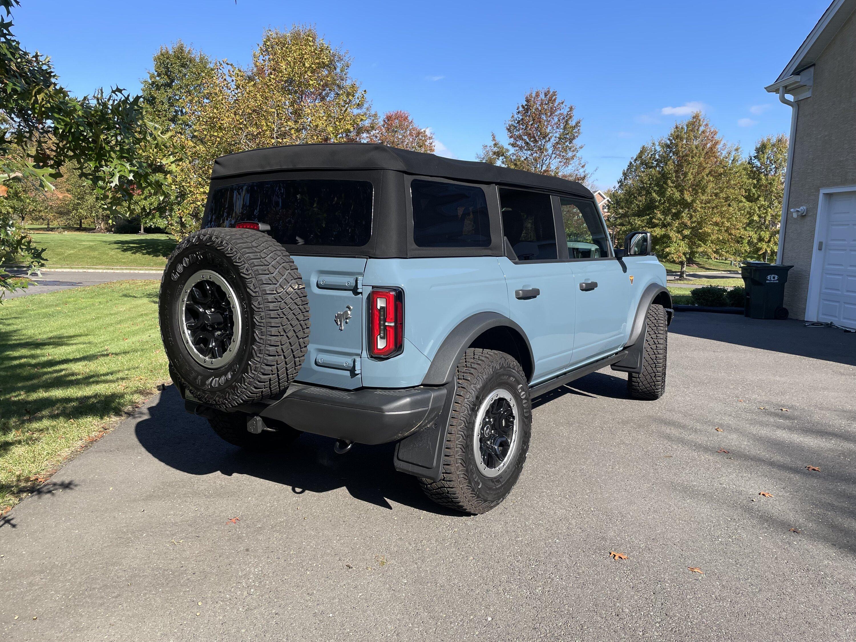

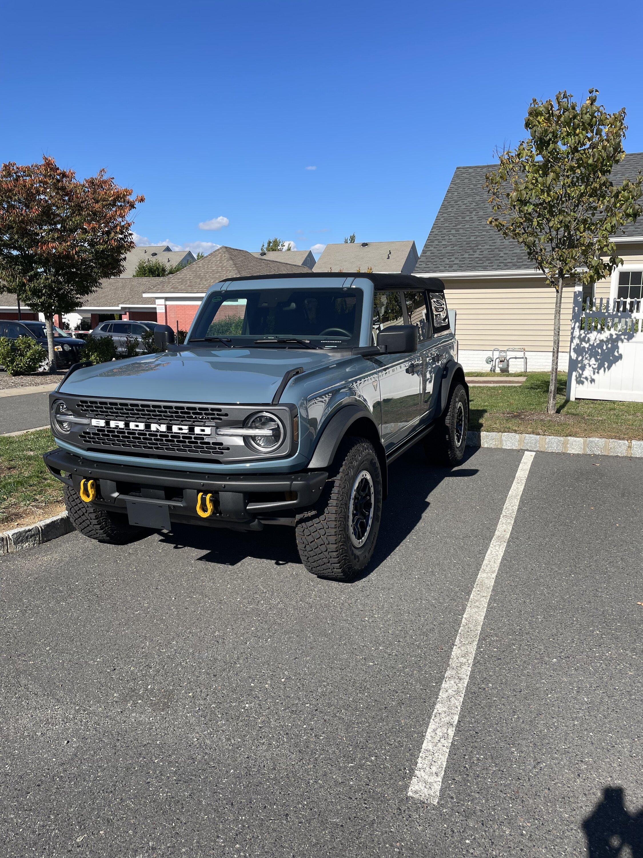

if going with a manual then I would skip the Sasquatch.
I have a manual BD and it already has 4.70 gears and the suspension is almost identical (0.3" shorter in the front and 0.5" shorter in the back). I threw sas wheels/tires on last night and only had to remove the crash bars.....looks awesome and I may or may not add sas flares for around $400.....saves a few thousand and you get an extra set of badland stock wheels that you can keep or sell. If going with an automatic then it depends on if you will be happy with the less aggressive gearing
