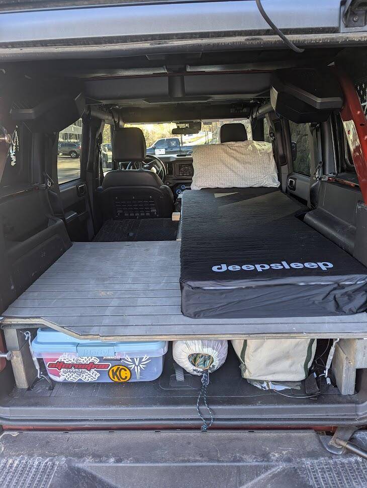

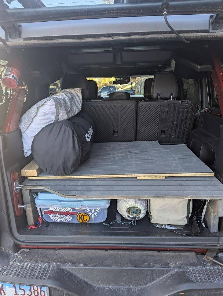

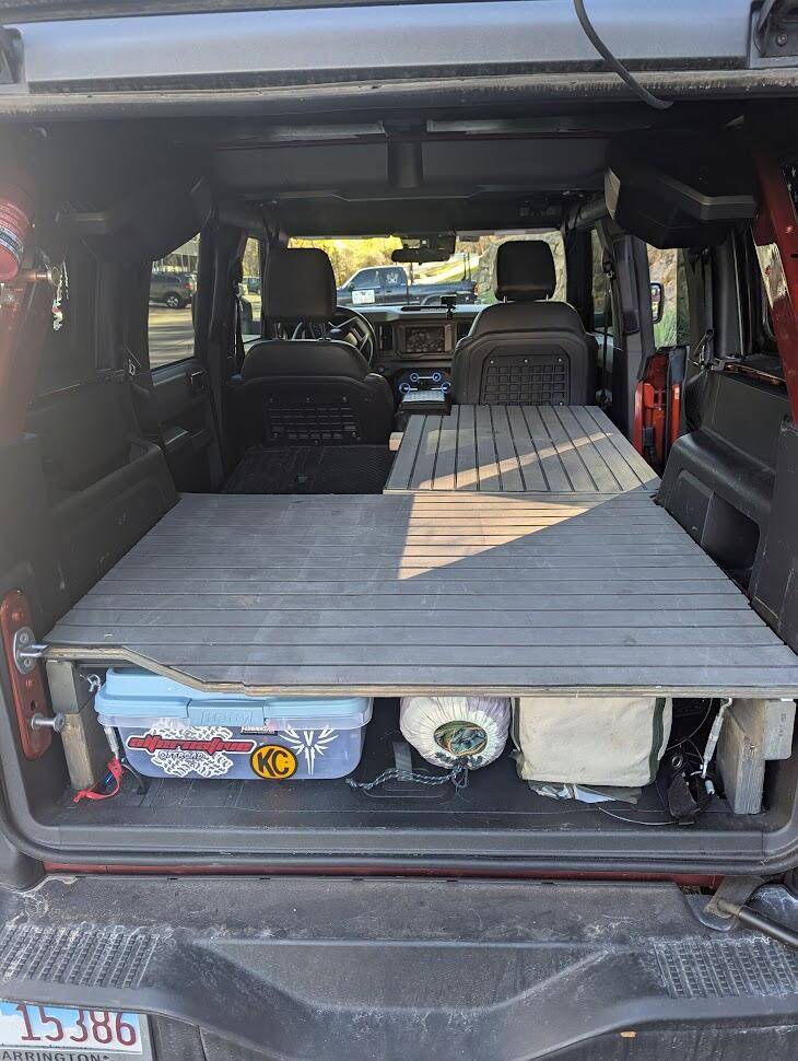

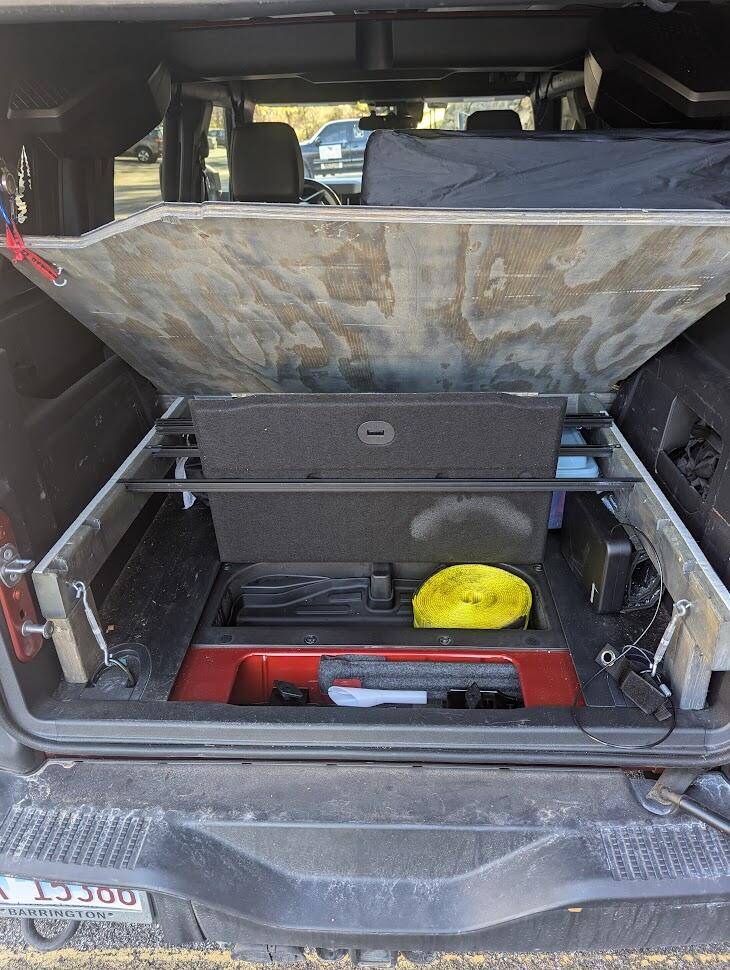

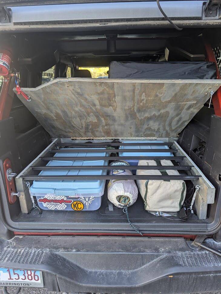

I figured I would share what I use to hide things with the top off and to level the back to sleep in my bronco. A scrap 2x6 fit perfect to level off the back with the seats folded down placed behind the rear seat. built a platform with some other wood and sheet of plywood. I bought some extruded aluminum off amazon for the removable cross braces and didn't even have to cut them. Throw in some EVA foam flooring, some hinges and small turnbuckles to hold it down. I did splurge on the deepsleep mattress for the bronco.
The bronco has been to Colorado 3 times, a couple Ozarks off road trips, and most recently Key West. I use the bed for road trips and camping in the vehicle once I get there.
