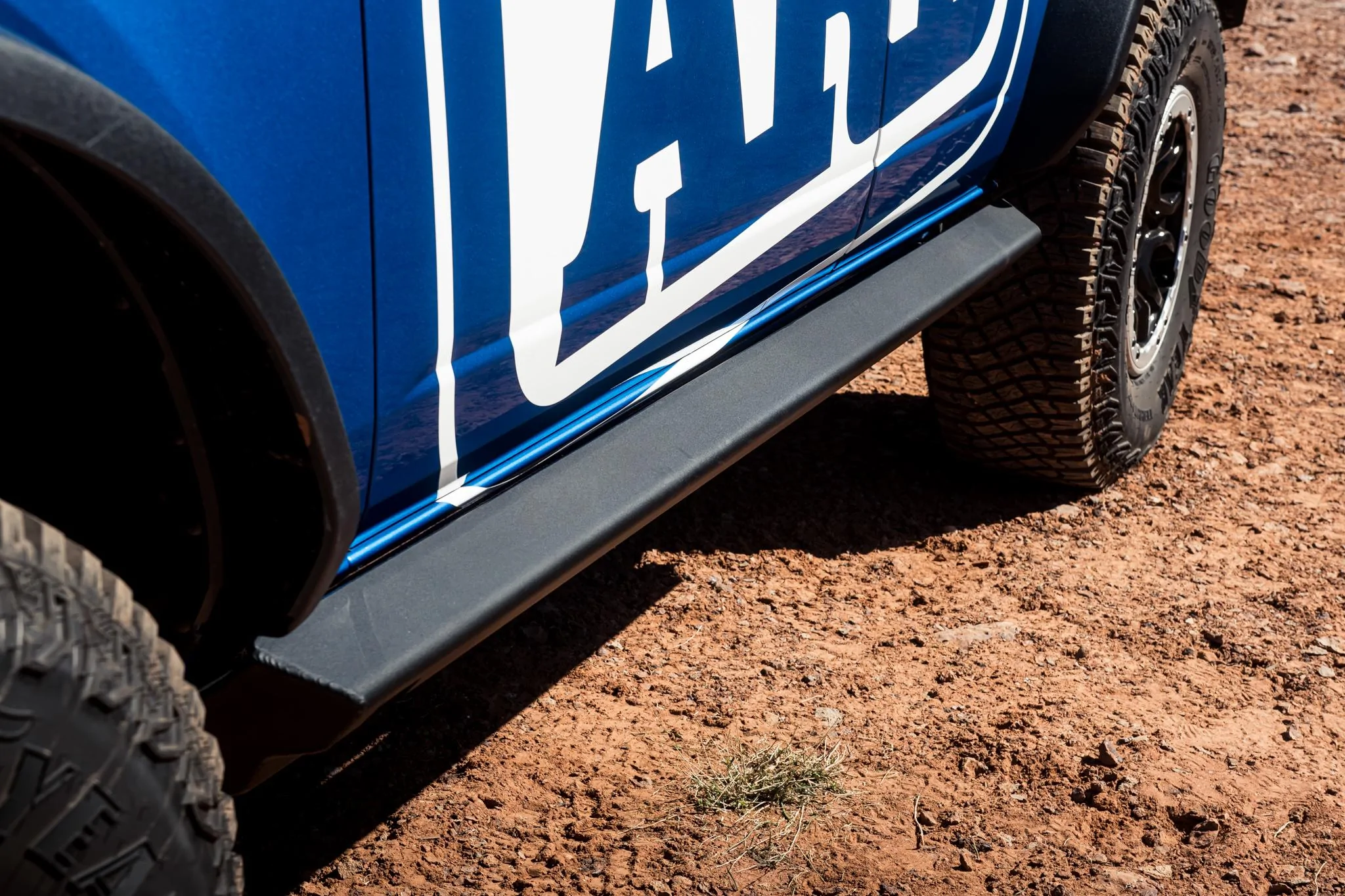

wondering what the actual cross section shape is because I'm seeing 2 different styles. One appears to have a reasonably flat/horizontal step surface and the other seems angled and would make a lousy step.

The one on the blue bronco was pre-production. The set on the red one is what we should expect to see.

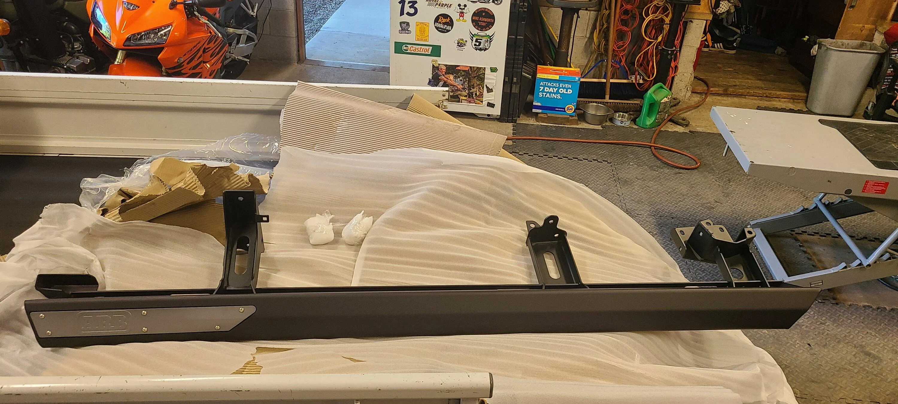

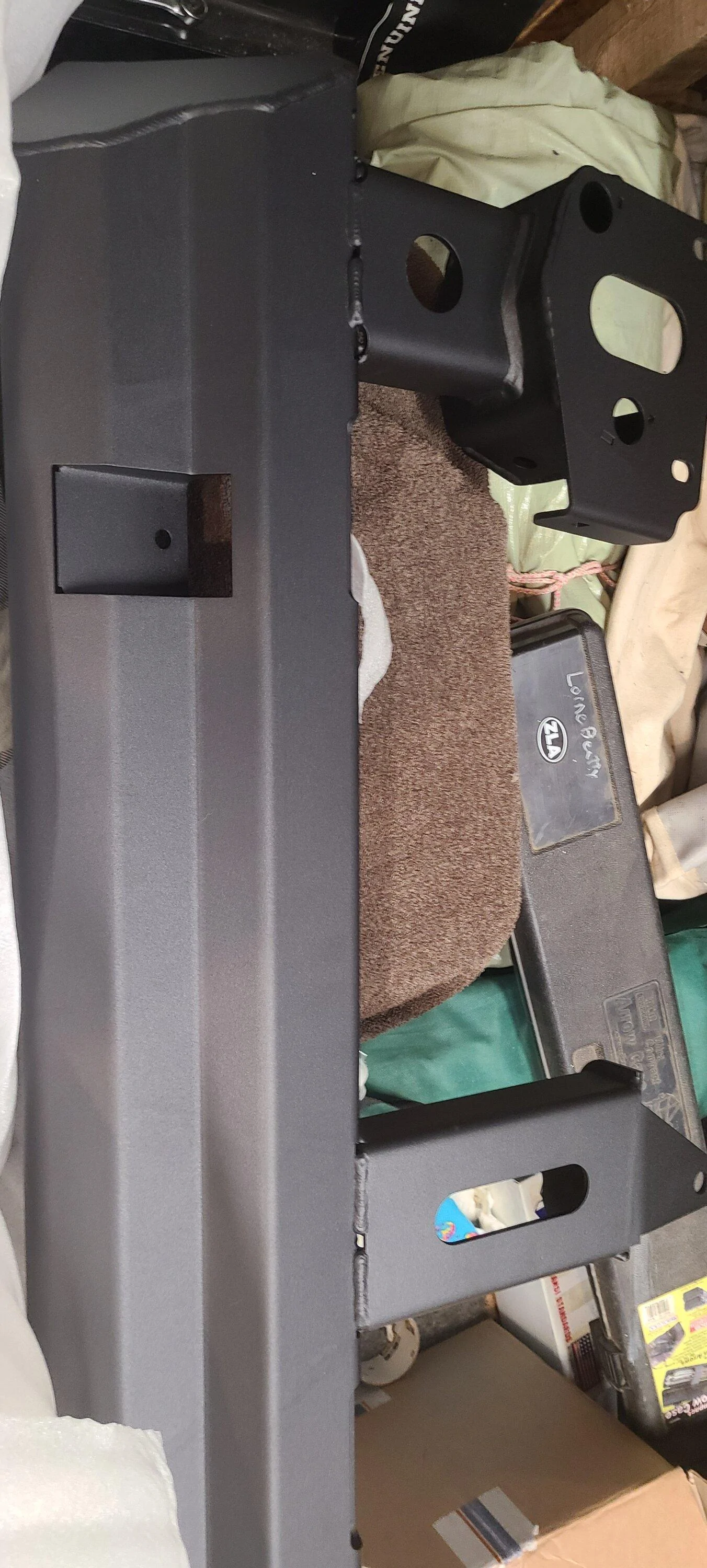

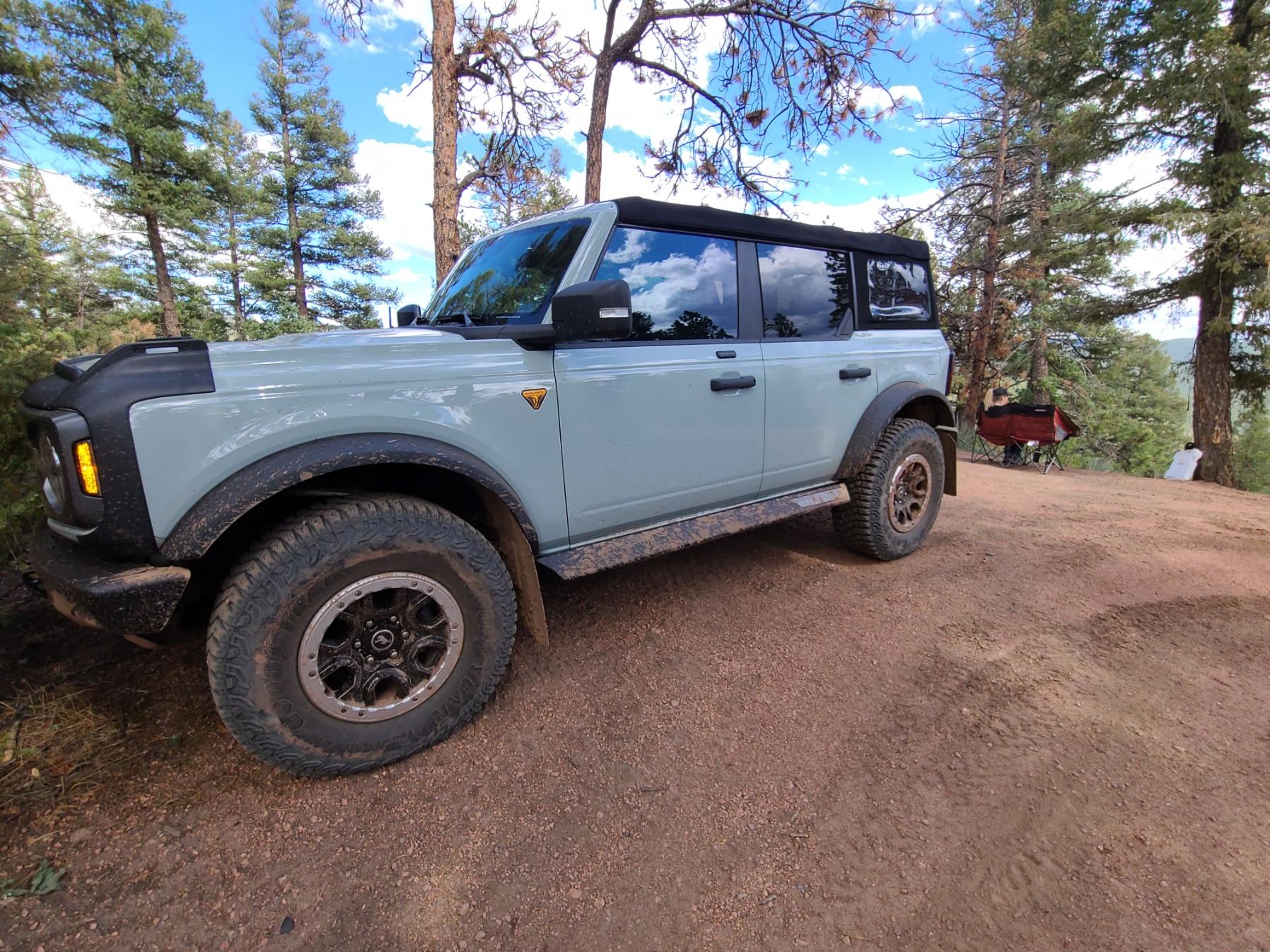

Install was time consuming. The passenger side requires cutting the OEM gas tank skid, both require fishing nuts through the frame and some minor griding around bolt holes. I had 4WP do the passenger side and they took 2 HRS at $350....
They drag much more than OEM skids since they are lower but they are probably 40 lbs heavier on each side. Frame mount vs body mount etc.
