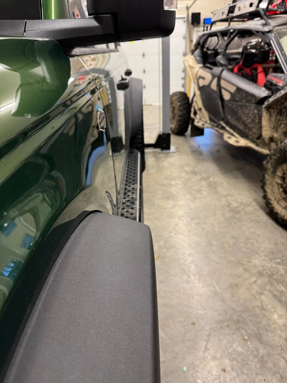

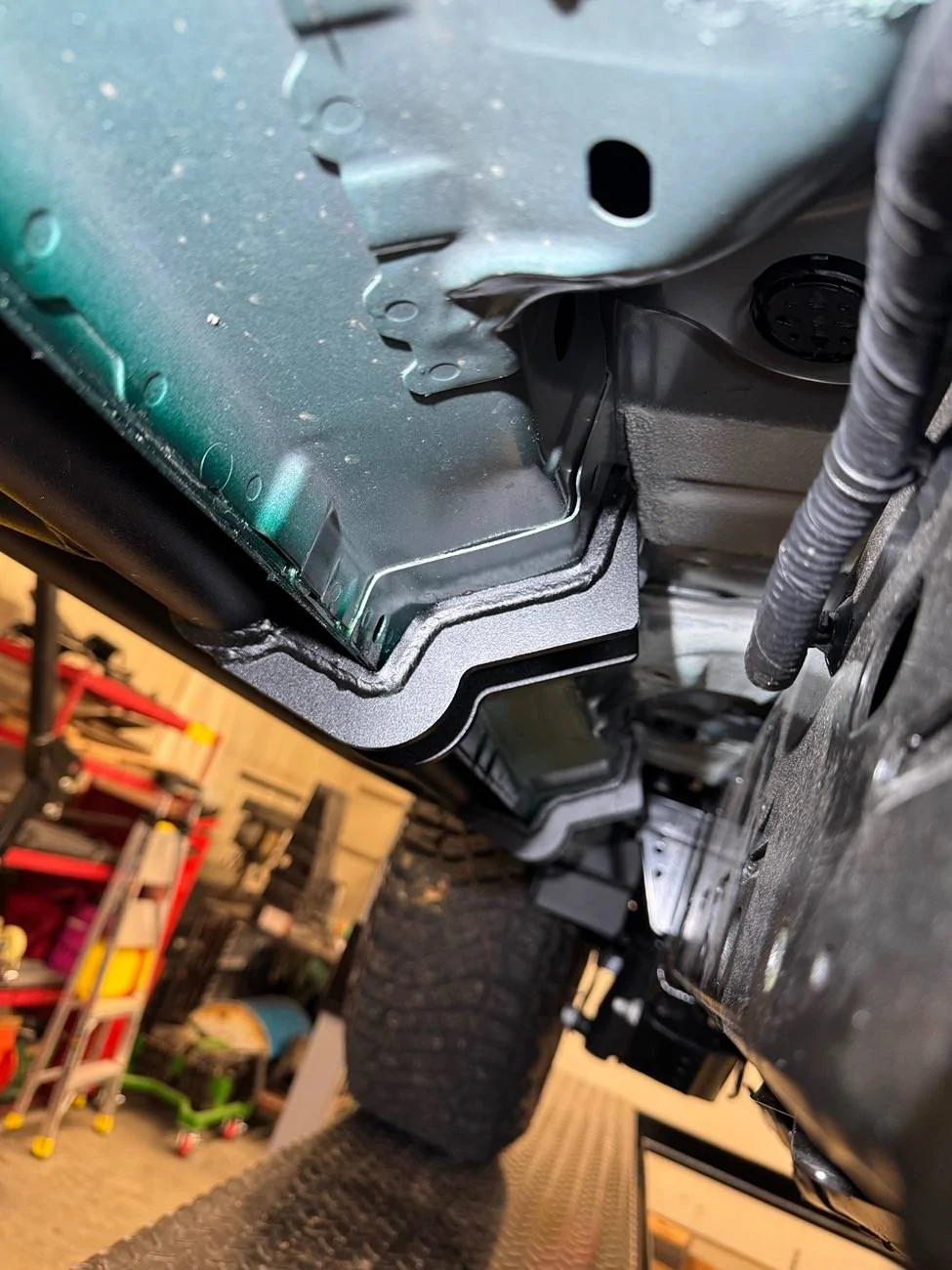

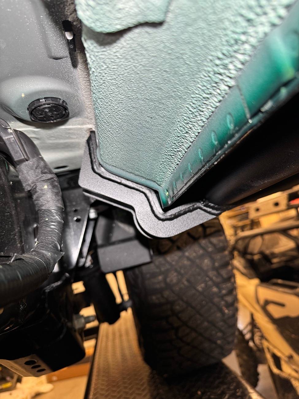

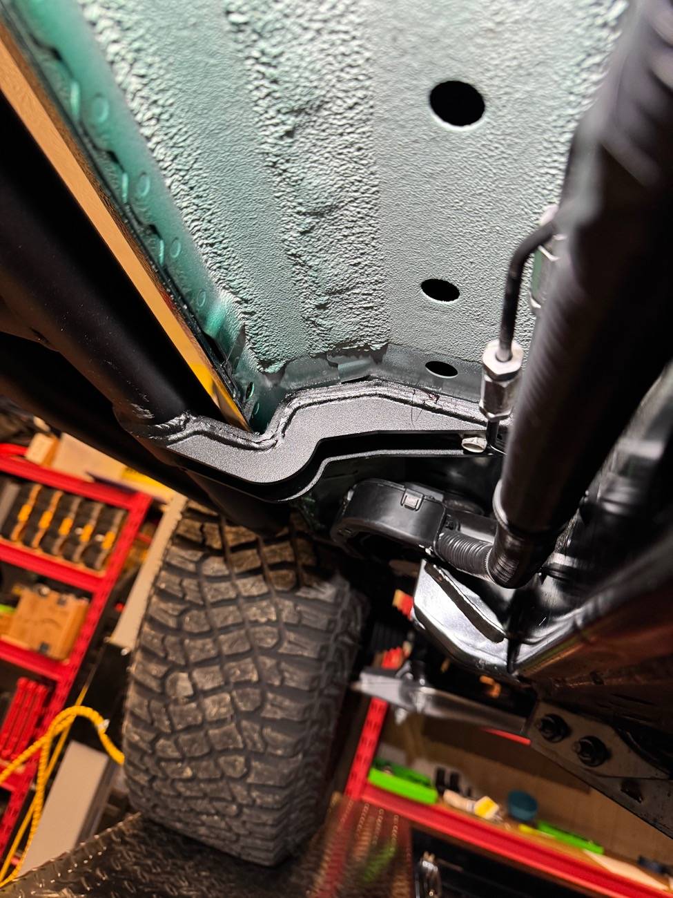

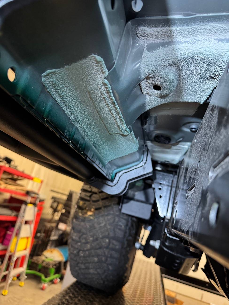

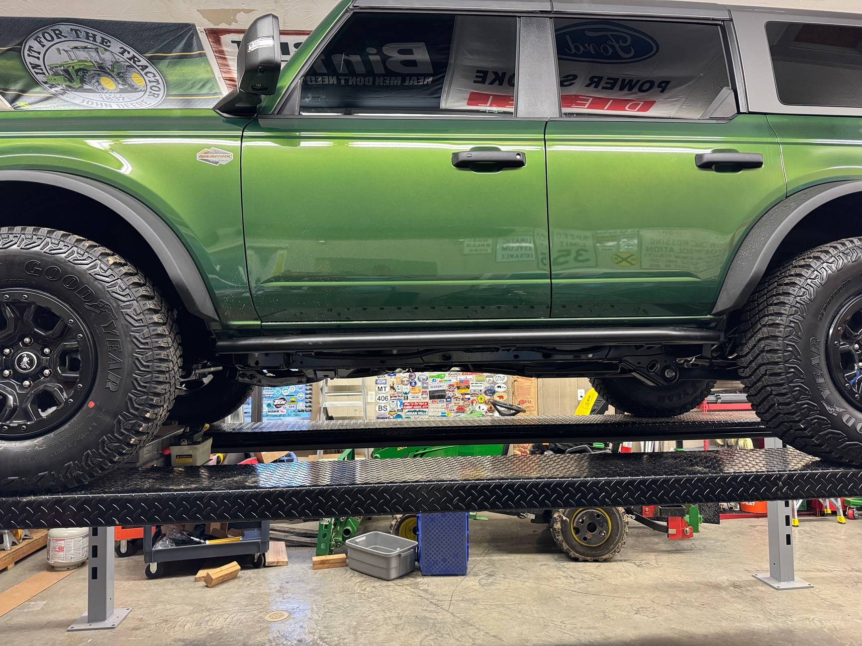

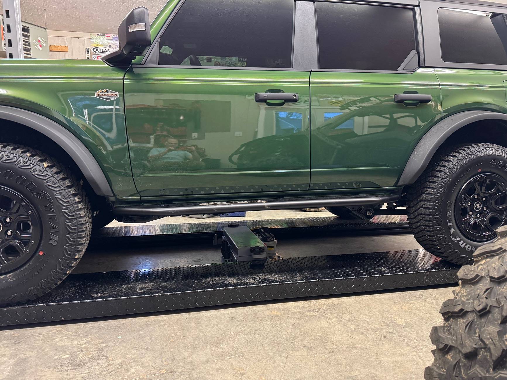

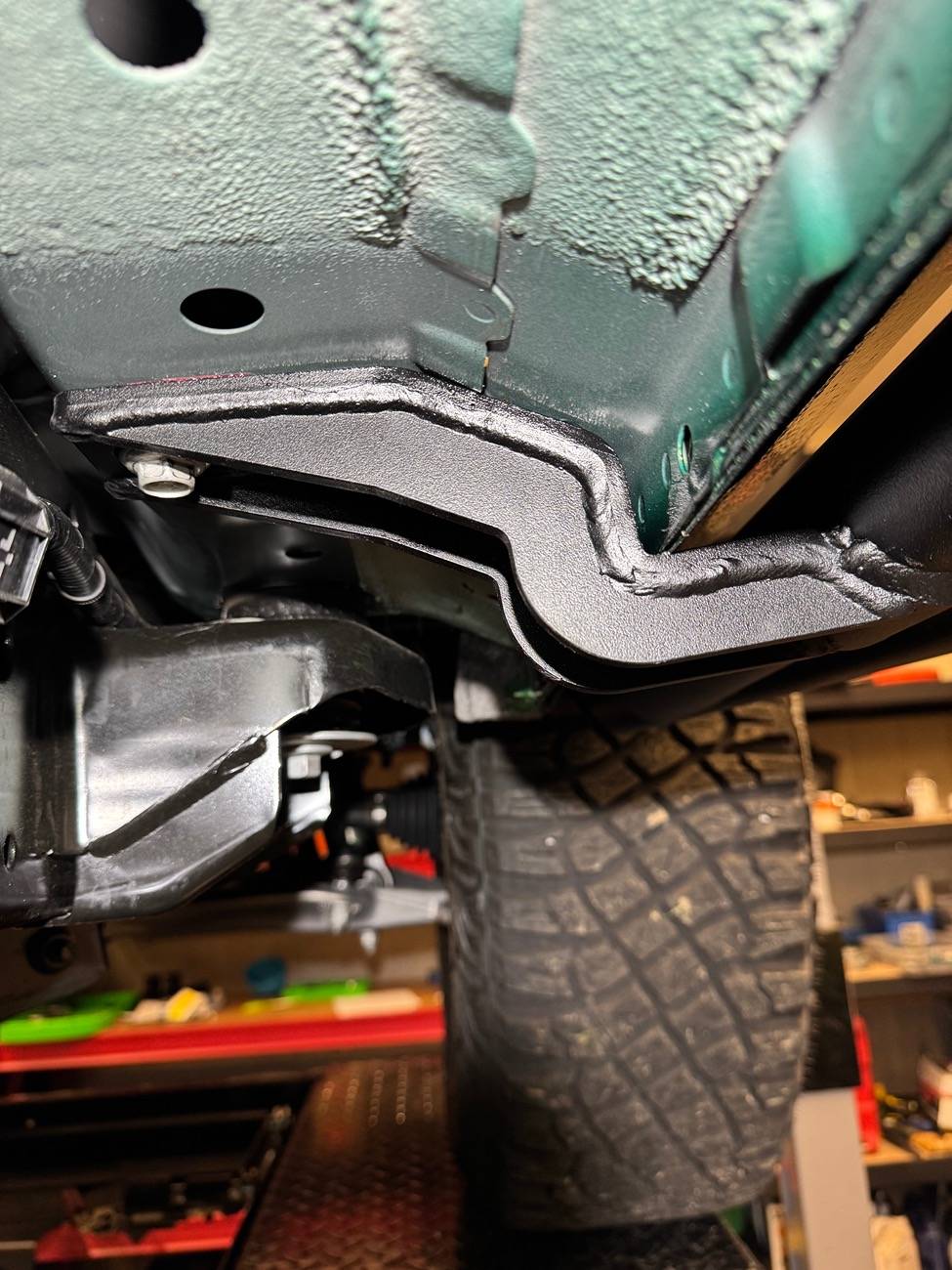

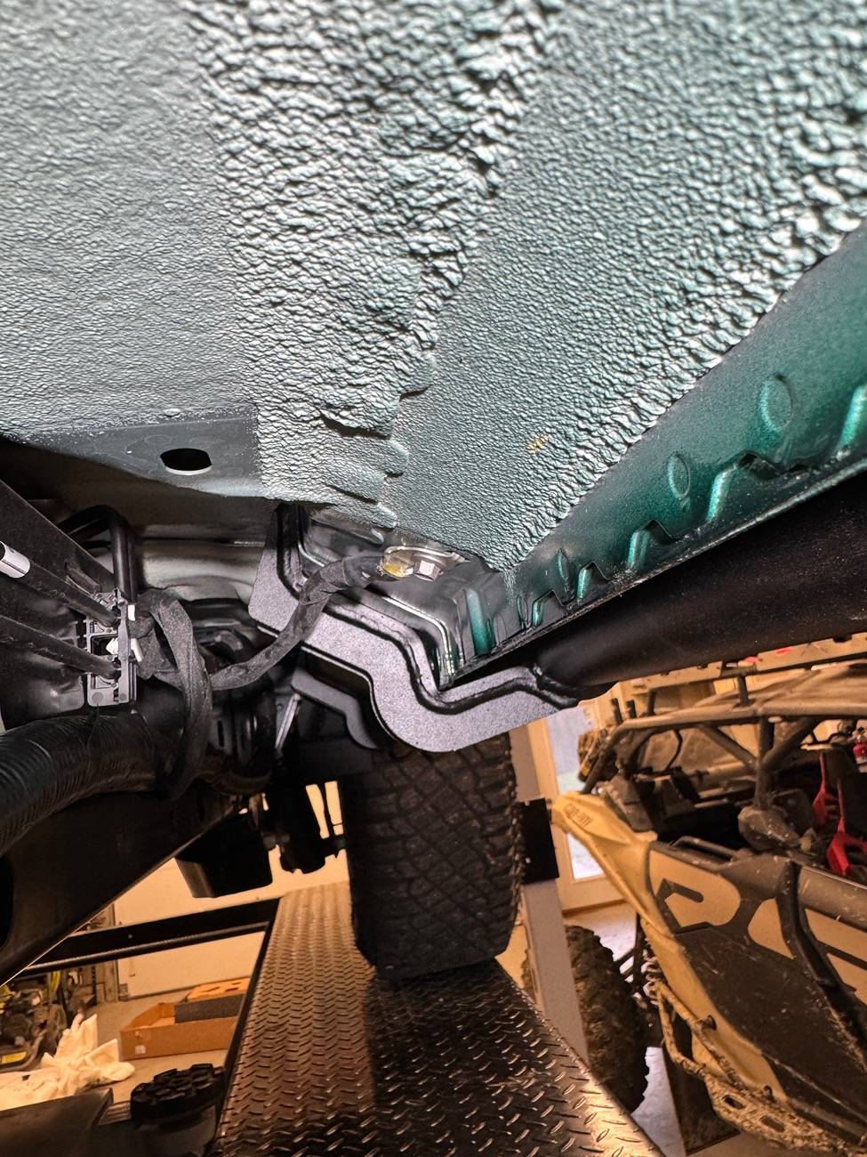

Put the Goat Fab sliders on this morning. Turned out great. I coated the faces that touch the body with fluid film then tightened them. Hopefully this will mitigate moisture becoming trapped between the metal. I didn’t order the pinch seam cover plates. I felt the slider hides it very well.

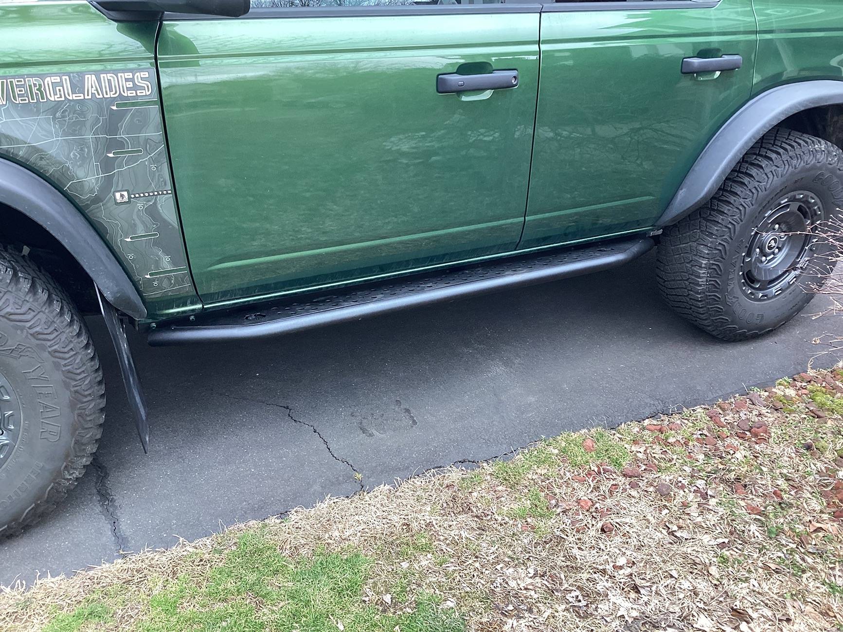

I just put the GOAT fab sliders on a few weeks ago. They mount to the same thing the factory rails do, so I’m not sure what the issue would be.

Goat Fab advertises that they will support the entire weight of the vehicle.. frame mounted or not, what more do you want your slider to do??

Yeah, that’s my question. I’m no structural engineer, but that looks like a pretty heavy duty slider with a pretty solid install. What’s the liability here, exactly?

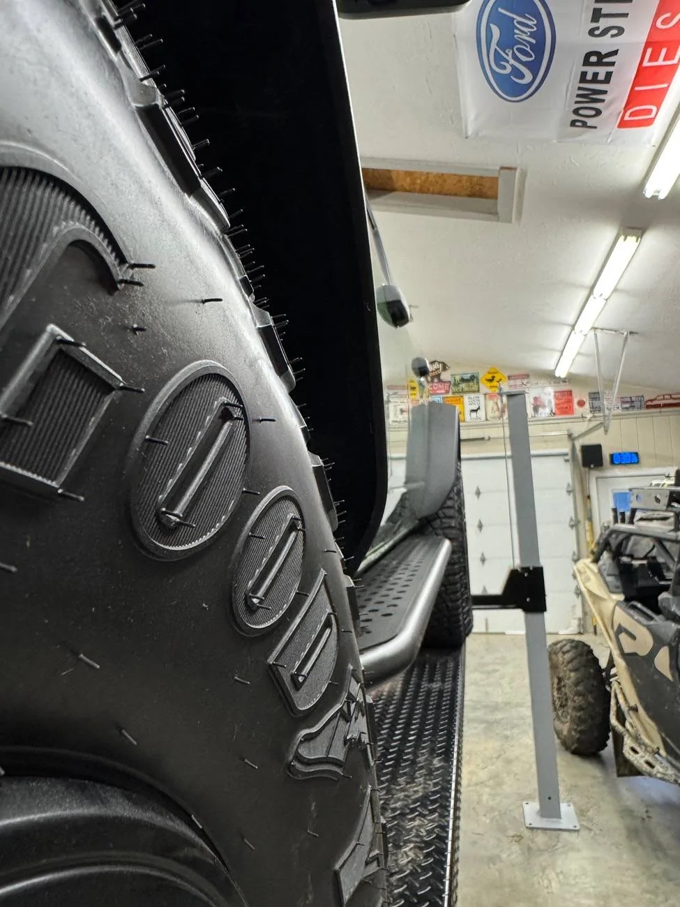

Those look great... Do you find they sit pretty flat for stepping in and out.. not sure i the 5 degrees they list is an issue?
I have the angled version for better clearance on trails. They also make them in a flat version.
My daughter and I generally don’t use them, I bought them primarily for my wife’s use.
