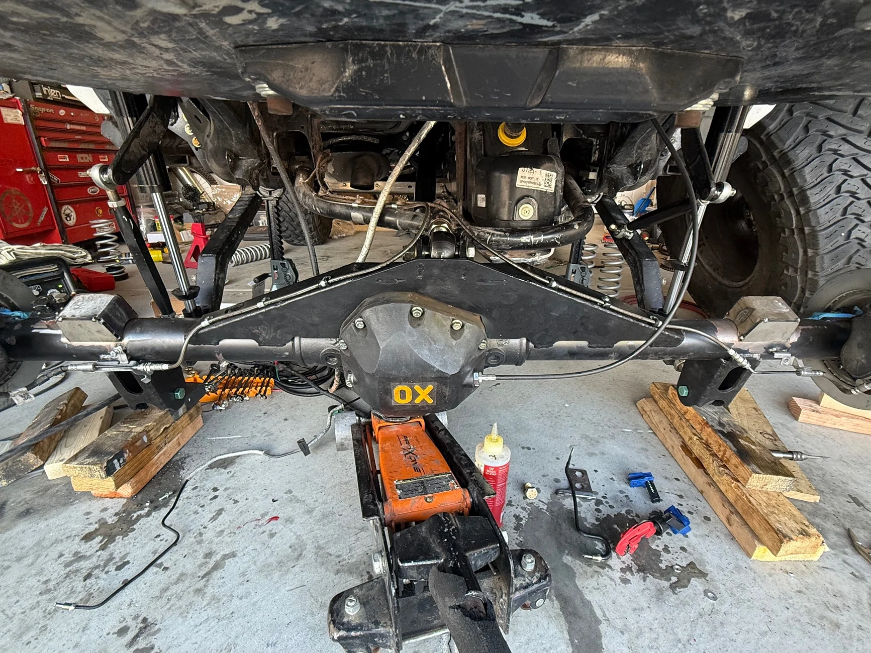

The electric assist seems to be pretty sensitive to volume changes, making larger calipers troublesome. When we eliminated a whole bunch of the factory lines by making our own and decreasing requisite volume to apply the brakes, it almost seemed like even that caused the computer to be slightly upset at first.
Or I just didn’t bleed the system thoroughly…
I wanted to say there was something about them not fitting too, but that's fuzzy. It's been a couple years since I saw those threads. That upfitter out of Houston seemed to have issues getting bigger ones to work, the one that made the racer-looking Broncos.
The 2.3L with vacuum assist doesn’t seem to have an issue with caliper changes, just the 2.7 with electric assist. Makes me wonder how much volume we cut out with our changes and if it would be enough to make up the difference for the bigger calipers that are working on the 2.3. It would be a tiny amount, but the system is sensitive enough to detect aur bubble…so…🤔🤔🤔🤔
