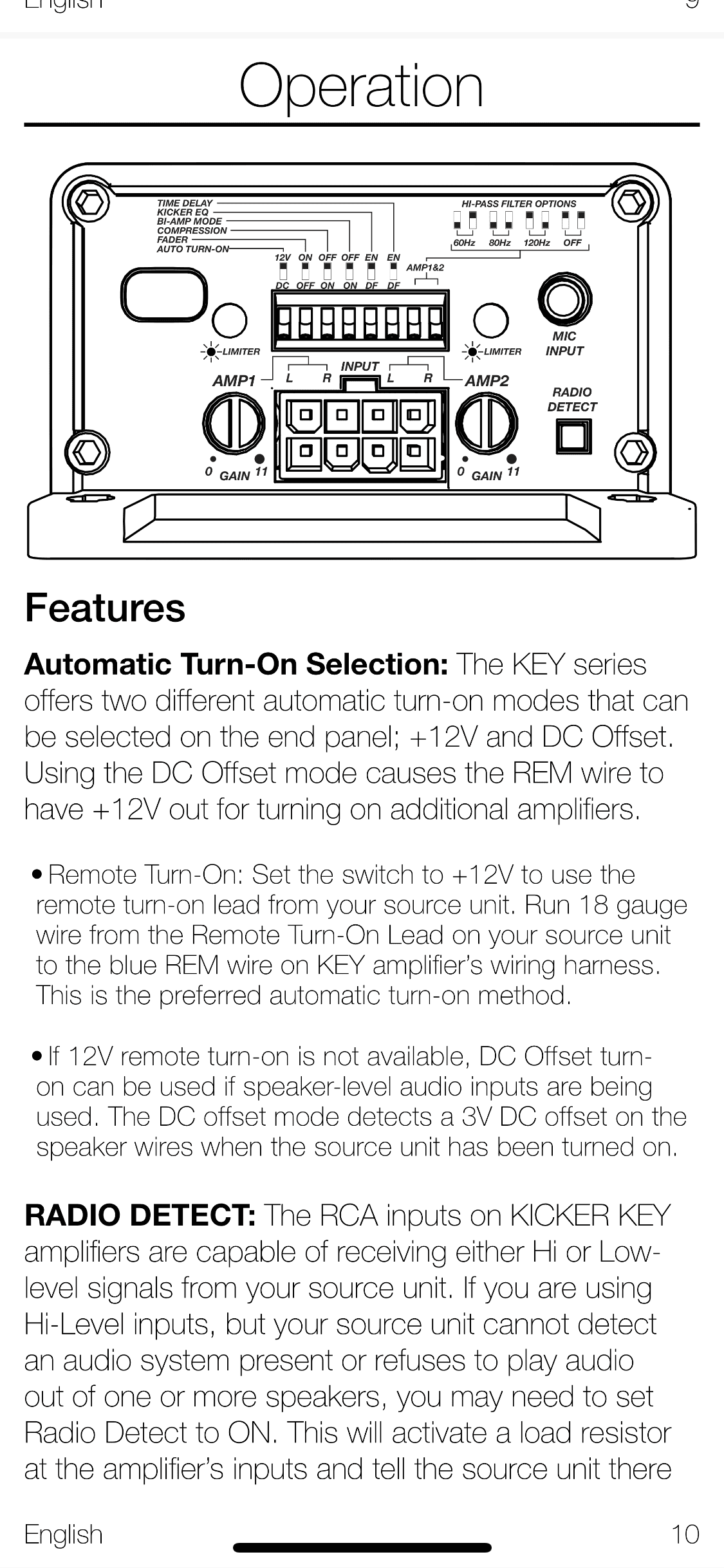

Make sure the radio detect button is pressed in. When in the “on” position it is flush with the amp case. It needs to be pushed in to be off.
