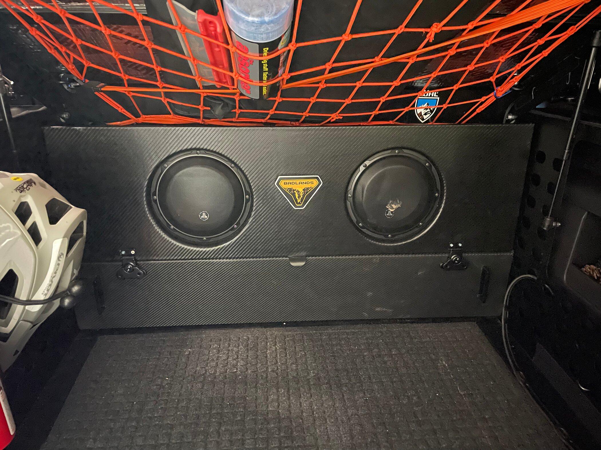

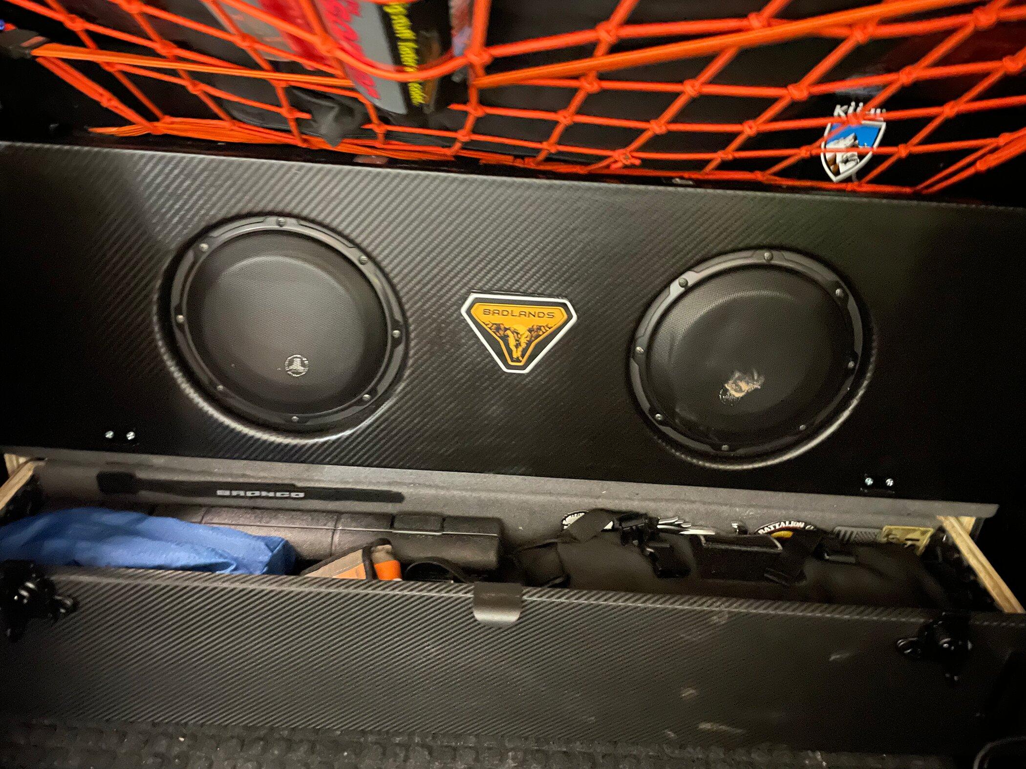

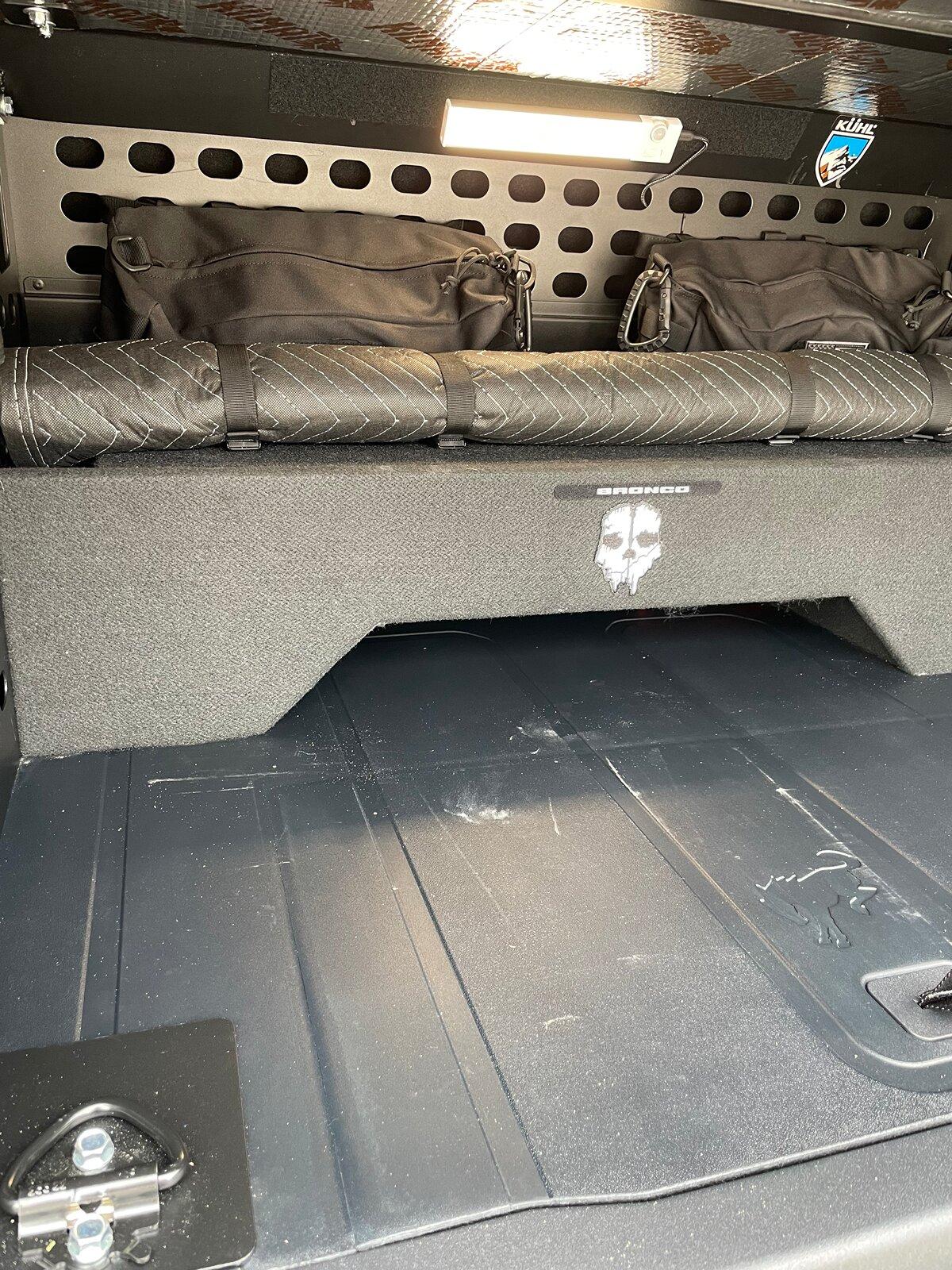

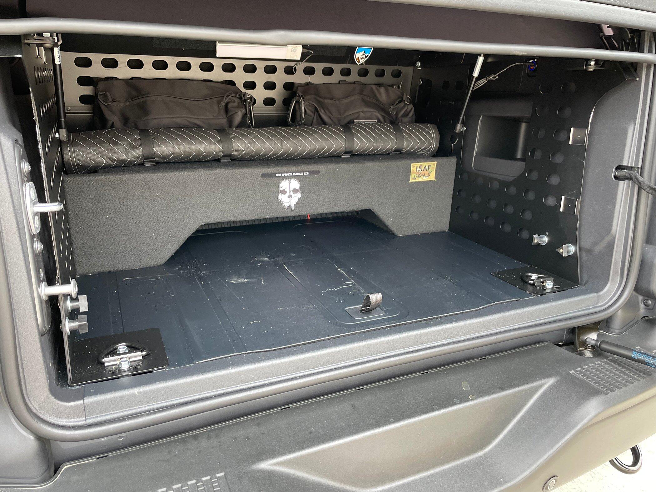

Here you go. The first 2 pics are the current set up. I used L brackets to mount it to the ford molle hinged cage (Very sturdy). I also added kilmat to the floorboard, underside of the lid, front of the cage and side panels to minimize rattle. It did its job and reduced a lot of the rattle expected on some very low frequencies.
In this configuration, the approximate dimensions of the trunk are 41" wide by 23.5" deep and 20-23" tall (the lid is not flat)enough for my needs. The drawer is about 4"X6"X35".
The last 2 pics are the down firing original set up. Changing the position of the box did not affected the perceived bass (at least to me) but gave me more linear room to store stuff. The subs are more protected in this configuration.
Hope this gives you an idea for your set up. I listen to all music and the bass is tight and punchy. I don't care much for SPL , they are 8" subs, but the sound is clean and crisp, top on or top less.
