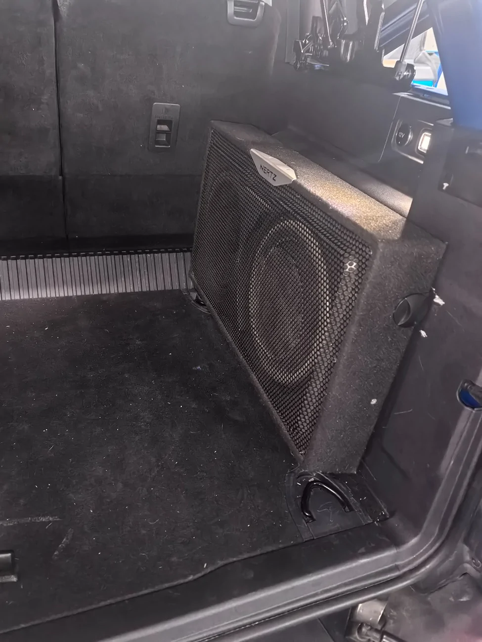

When looking around for a suitable box for my JL dropped into my favorite indy Hertz, Focal, Audison etc dealer to check some NOS loaded boxes I've seen there for a few years.
Prepped by removing sub connecting both positives and both negative speaker wires with extensions.
Tried 4 loaded boxes back to back incl one Audison 10" Prima and 3 Hertz; 12,10 and 8.
Was so impressed with NOS Hertz EBX F25.5 slim 10" w passive radiatior bought it for USD 170.
Comes with metal horizontal bracket that I 3M taped and 6 nuts / bolts attached to side panel with bottom wedge corner slotted into groove between floor panel and side panel.
Sounds amazing with perfext balance, no rattles anwhere except maybe pods, and sets me up for replacing OE en
Ford Bronco B/O subwoofer replacement issue IMG_20251027_185805
closure with amp rack and having sib capable now and working with my Kenwood XR 1000.1 when want to upgrade. The metal grill is very heavy duty works as down fire as well but side was best soind for me.

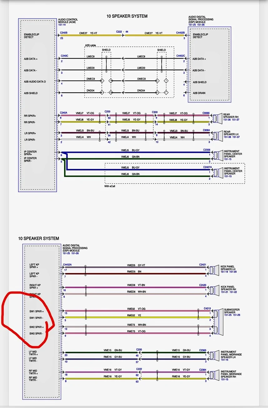

My stock B&O sub blew and in a pinch before searching the way i should have, i followed someone else's suggestion and installed the DS18. I didn't realize or even really understand the DVC portion of things. So, per the thread i read, i cut the connector off one set (purple and yellow i believe) and hooked up the new sub. It works and no more rattle from a blown sub but its lacking comparatively. I can't afford to go the Kicker DVC route, yet. Seeing that i can theoretically bridge the amp by utilizing the second pair that's just sitting in there, gives me hope for the time being. While it makes me nervous to do this, i'm willing to try in order to get more out of the sub.
  • Can someone tell me what color wires are positive and what wires are negative?
  • After bridging, is there any tuning that needs to be done and if so, how do i do it?
