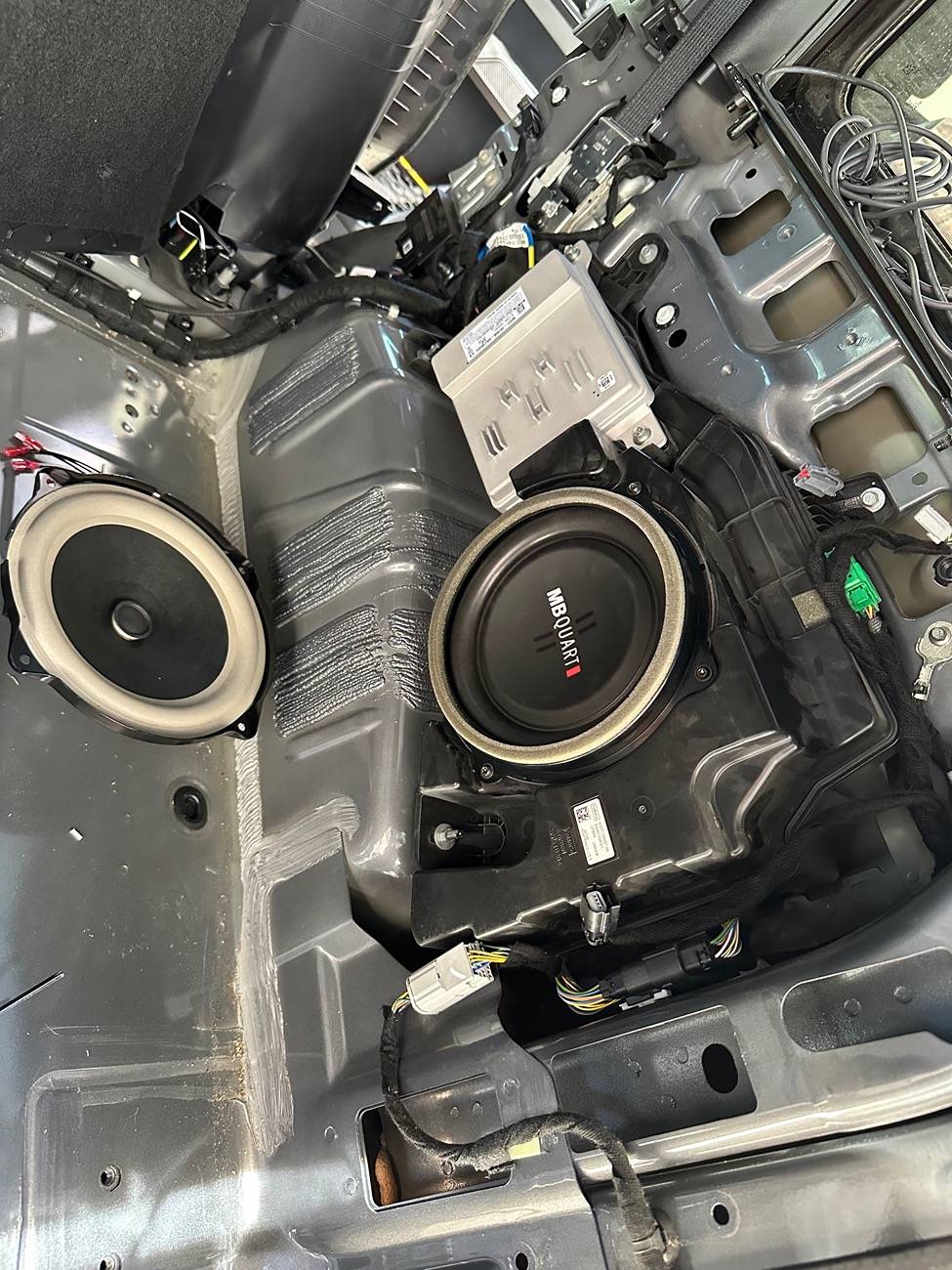

@Johnny Mo @RagnarKon @mjp2 @2022 base thanks a lot for all the info and the guidance. I finally pulled the trigger. I just changed the subwoofer maintaining the stock amp.
if there's some one thinking to do the same, it sounds better than the stock with the recommendation of the mb subwoofer (with no trimming, just the little tip of the bottom). the rattle went away, with more punch .
also did the Metra 72-6514 Speaker Harness adapter, so no original cable cutting.
great day to you all.
