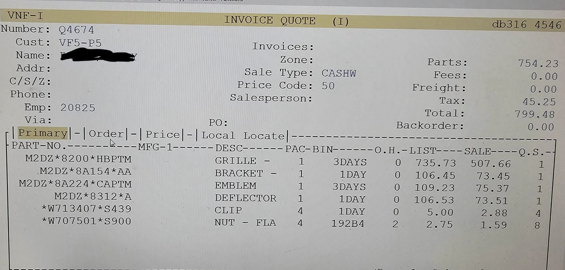

I liked the factory finish of the grill on my Black Diamond but I am also considering gloss black on the Cactus Gray. Keeping the original red letters. I work at a Ford dealer and it looks like all that comes out to 799 including tax

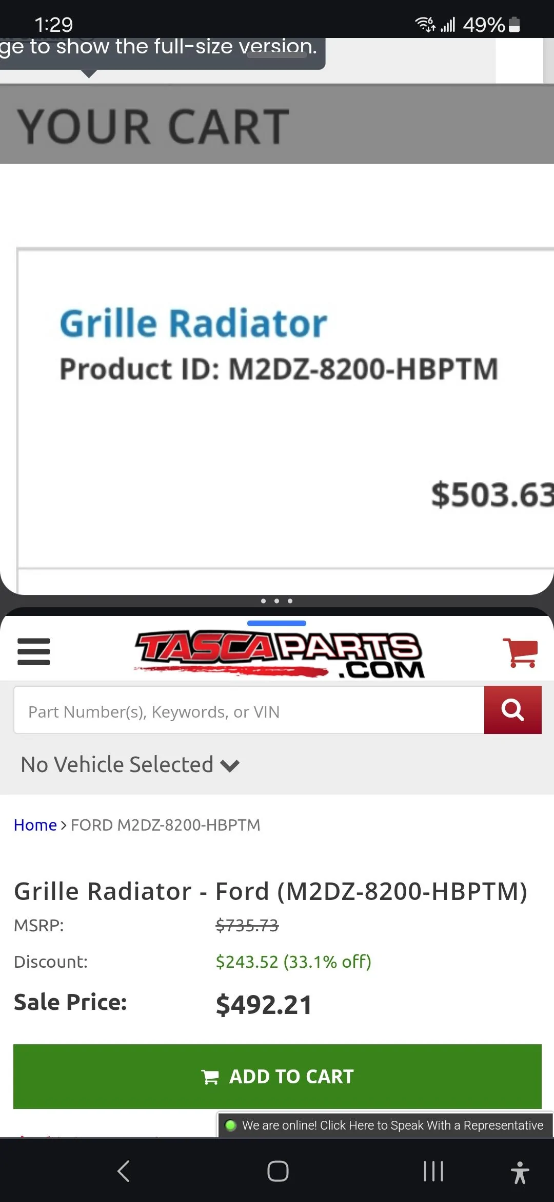

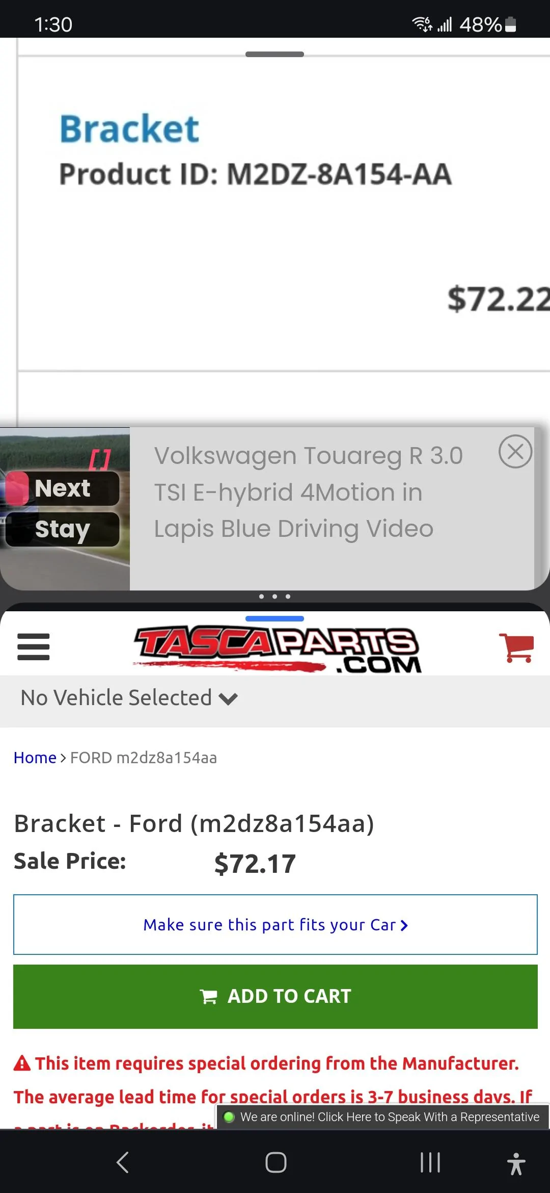

Youch...what kind of discount do you get? I have no affiliation with Ford but just typing in the part number yielded pretty decent prices for even non-employees:

That's a drag that you're an employee and they're charging you more than they are just the average person on the internet that just types in that part number and gets it from whatever site happens to be selling it at the lowest price...but if you don't have to pay for shipping then that leaves you coming out ahead!
