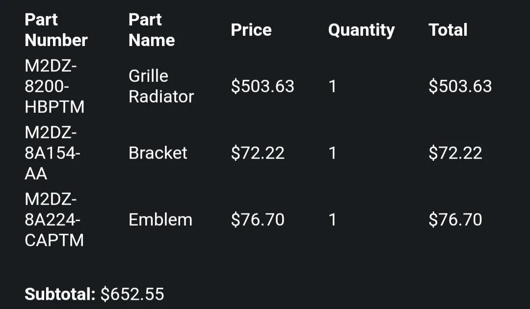

Now that the B&P is up for 2023 is the heritage grill going to be available from the parts department and if so does anyone have to item number?

What is the bracket required for?
If you have BL or WT and you convert to Heritage you need that bracket...if you have base or BD your bracket is the same. The BL/WT grille opening are shaped like egg crates and the Base/Heritage/BD are shaped like rectangles and the bracket matches the edges of the openings. If you have BL or WT you also need the deflector (rubber edged like a squeegee that directs airflow to shutter gates).

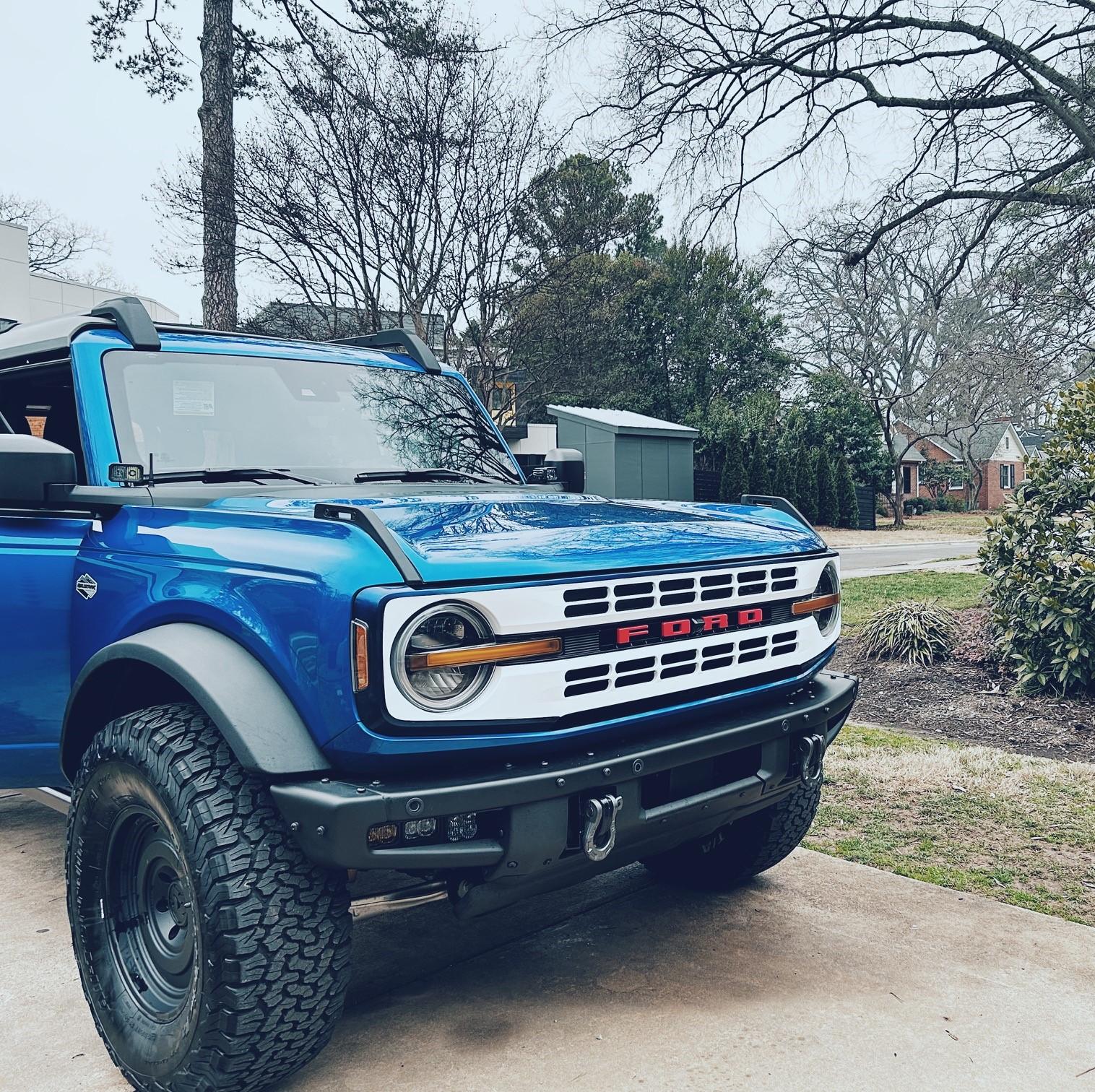

We installed the Heritage grill this week. We found that the bracket is exactly the same as the bracket included on my Wildtrack that is equipped with a front facing camera.

Will post better photos in the sunlight whenever it stops raining. Also in the progress of installing IAG's interior lighting mod, which is one the hardtop is popped up.

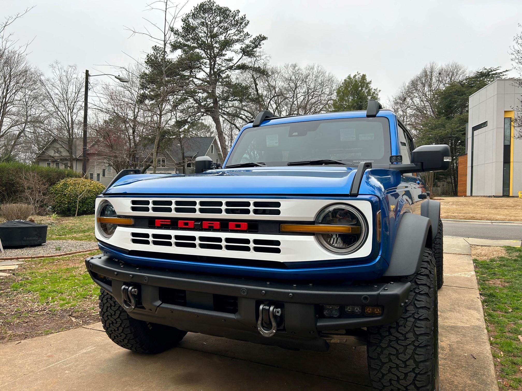

That looks awesome, do you have any other pictures of it?

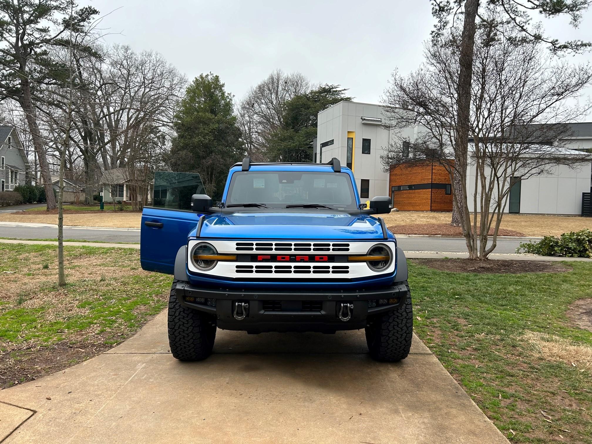

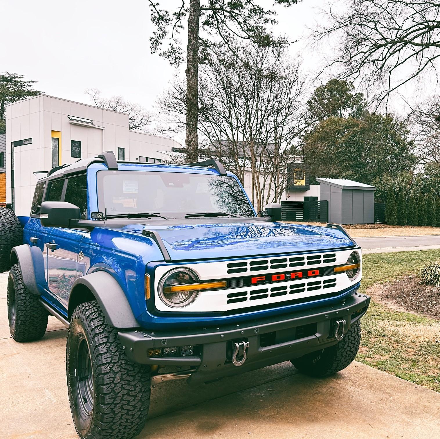

Amber turnsignal overlays are from @StickerFab (I've ordered a second set and am considering using two overlays to darken the amber a bit to match the sidemarkers better.)
Custom paint is by @Advanced Cerakote and looks amazing in person. I need to take better pictures when the sun comes out, could not be happier with his work and communication throughout the paint process.
@Jr87mustang Next up is white vinyl on the Bronco's doors, similar to yours. - Love that look and think it will tie in the grille's white colorway well.

Do you mind sharing what it cost to have the edge of the grill painted?
$1,350 for the OEM Ford grille painted in three colors, including the 'FORD' letters. Just FYI - The Heritage grill does not come painted white, its all black from Ford.
