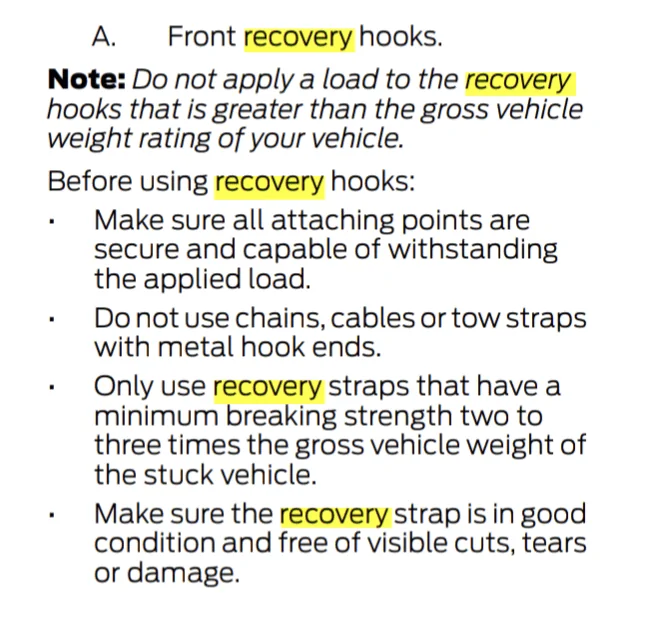

The 4 door badlands has steel front and rear bumpers with 4 tow hook locations. Anyone know where it states the capacity of these attachment points? Probably going to be using them to pull vehicles out of the snow this winter.

You should have no issues pulling out vehicles from snow or sand. That's what they are there for. Get a probably rated snatch strap and your good!
Edit: Found this in the manual.
Ford Bronco Badlands tow hooks capacity? Screenshot_20210919-112848
Perfect thank you. This is what I was looking for.

So that means a badlands with v6 has a higher tow hook rating, since it has higher GVWR ;)
