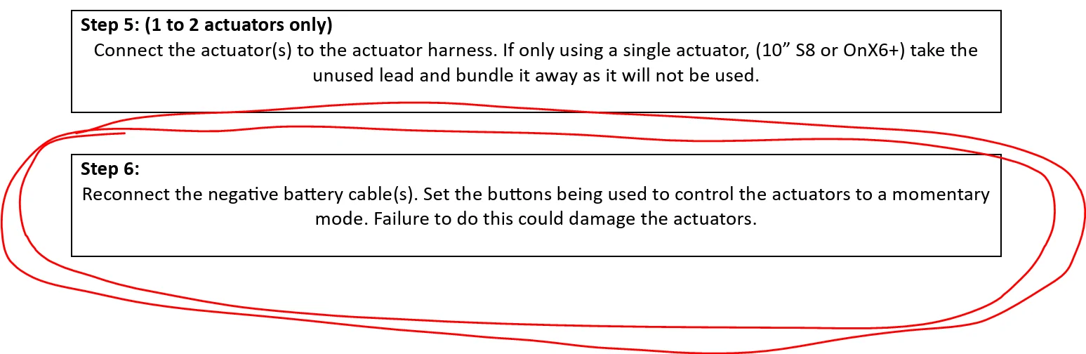

So looking at the instructions... Baja Designs has a wiring harness for upfitter use that has built in relays
https://www.4x4truckleds.com/baja-designs-reflex-light-actuator-harness-power-management-single/
"Power Management" is a fancy word for "Upfitters" or "OEM Switches"
Basically you get 3 leads. One ground and a positive lead for each function (up/down).
NOW. Im curious what would happen if you activate power to BOTH. I guess it would cancel each other out but will it TRY and power up and down at the same time and possibly mess up the motor?
Honestly, this actuator is probably best with a momentary switch over an upfitter so calling it a harness for "Power Management" actually makes better sense as you can program most switch panels for momentary control.
So if you wanted to use two upfitter switches, one for up and one for down you could make it work with OEM switches?
