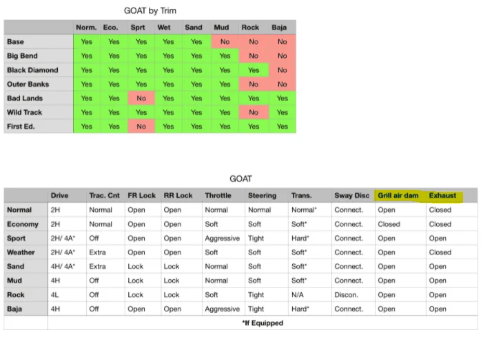

That chart is talking about exhaust modes, that isn't a thing, right?
Im not following you bro? That chart is the different "terrain management system" changes. The bronco will adjust how it performs mechanically and electronically based on the mode you select.
I was just highlighting what I saw that was totally odd. Nothing more-

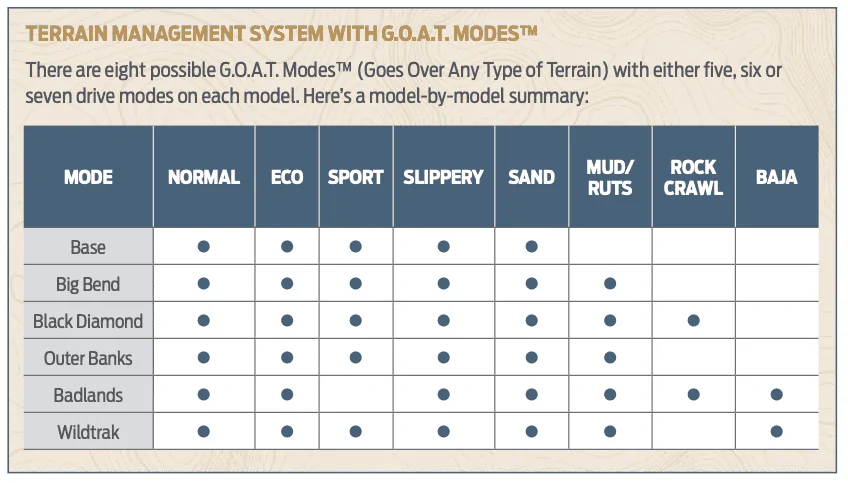

These charts were guesses based on other Ford products from before actual information about the Bronco was available... hence the columns for things that aren't actually included on the Bronco. We should stop using them.
Here is the actual chart provided by Ford:
Ford Bronco Base model Sport mode question Screen Shot 2021-11-19 at 12.29.23
