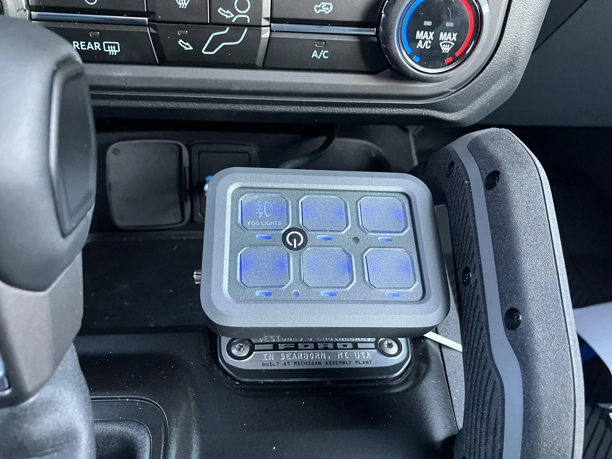

Received and installed the Bronco switch and Oracle fog lights. Couple thoughts for others considering the same purchase.
Bronco Switch
Pros:​
Housing frame of the switch is made of some type of alloy. It seems very tough. I was expecting a plastic frame.​
Bronco specific switch mount is sturdy​
Plenty of cable - maybe a little too much​
Good install how to video at F150LED.com​
Cons - NONE of which are deal breakers:​
Maybe a little too much cable. If you notice in the install video they glaze over cable management.​
Don't like their engine bay control box mounting suggestion. If they could decrease the height of the control box by using mini-fuses then it could be mounted to the top of the OEM fuse box. I mounted placed the control box between the OEM fuse box and fender where the hood release cable is holding it snug - for now.​
It seems the mapping of the fuse box numbers and switch are backwards. My fuse 1 is mapped to the lower passenger side switch button and fuse 6 is mapped to the upper driver side switch button. My heart skipped a beat when I click the top left button and no lights :cool:
Picture after install - I routed the cable in front of the fire-wall and behind the dash cluster. This allow me to run the wires from the switch on the passenger side.​

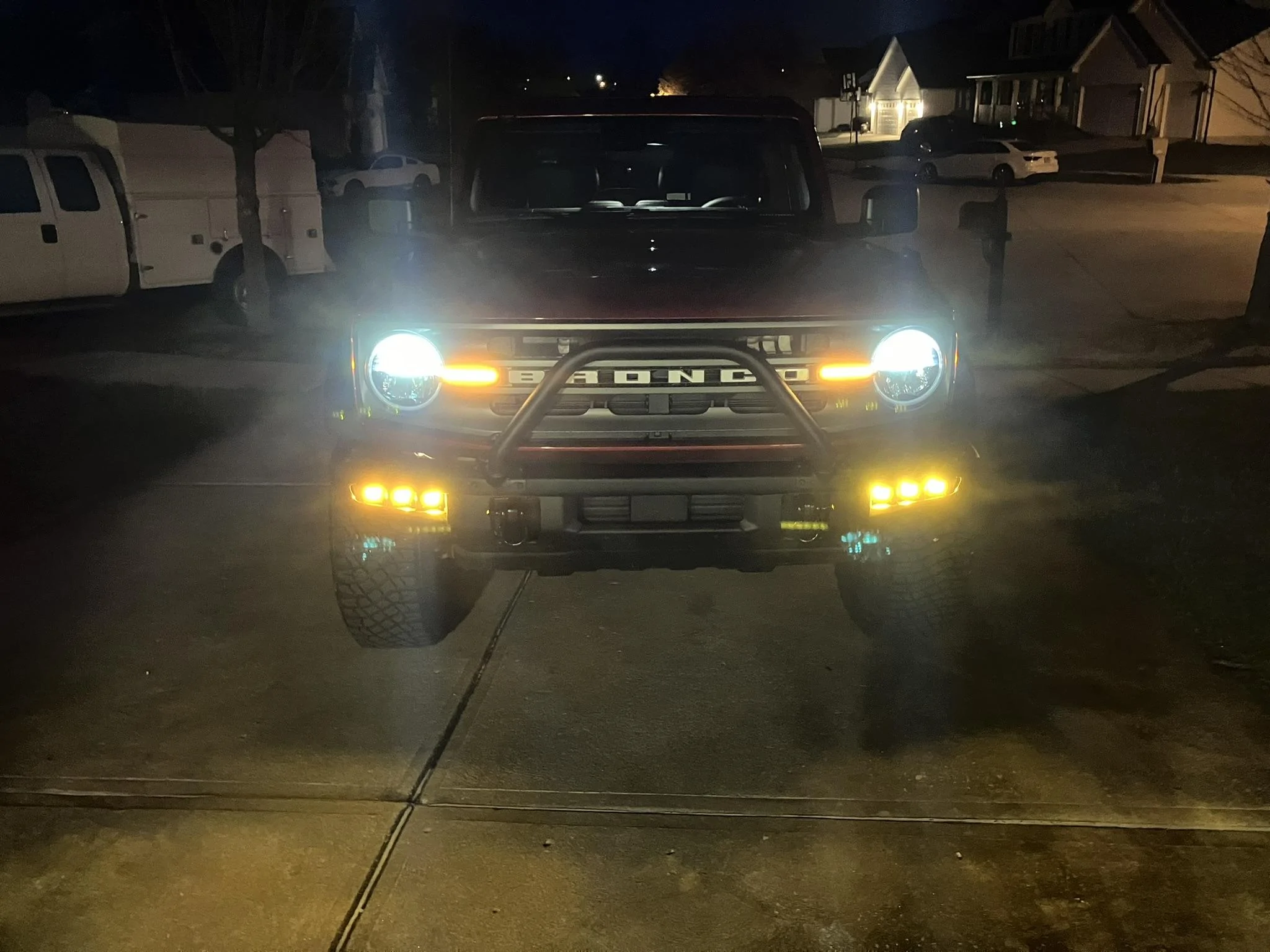

Oracle Fog Lights
I followed the instructions on this install video - thank you @CUPRA
Pros:​
Plenty bright and still street legal​
I like the design and styling​
Well constructed frame and wire harnesses​
Cable connected to the lights is a little too short. Just an extra 3 inches would bring the connector into the engine bay. This would allow for easy light replacement if necessary.​
Picture After Install​

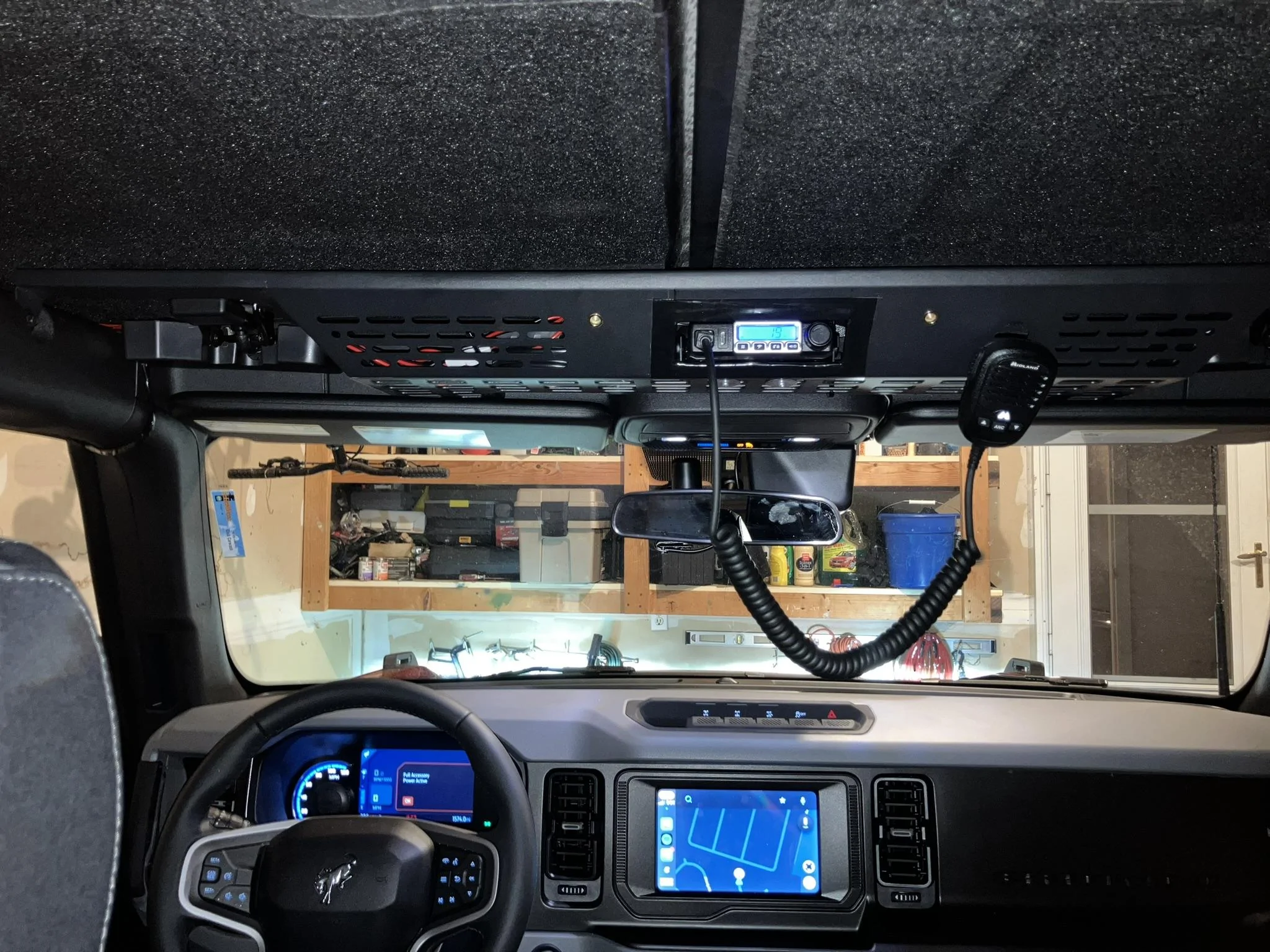

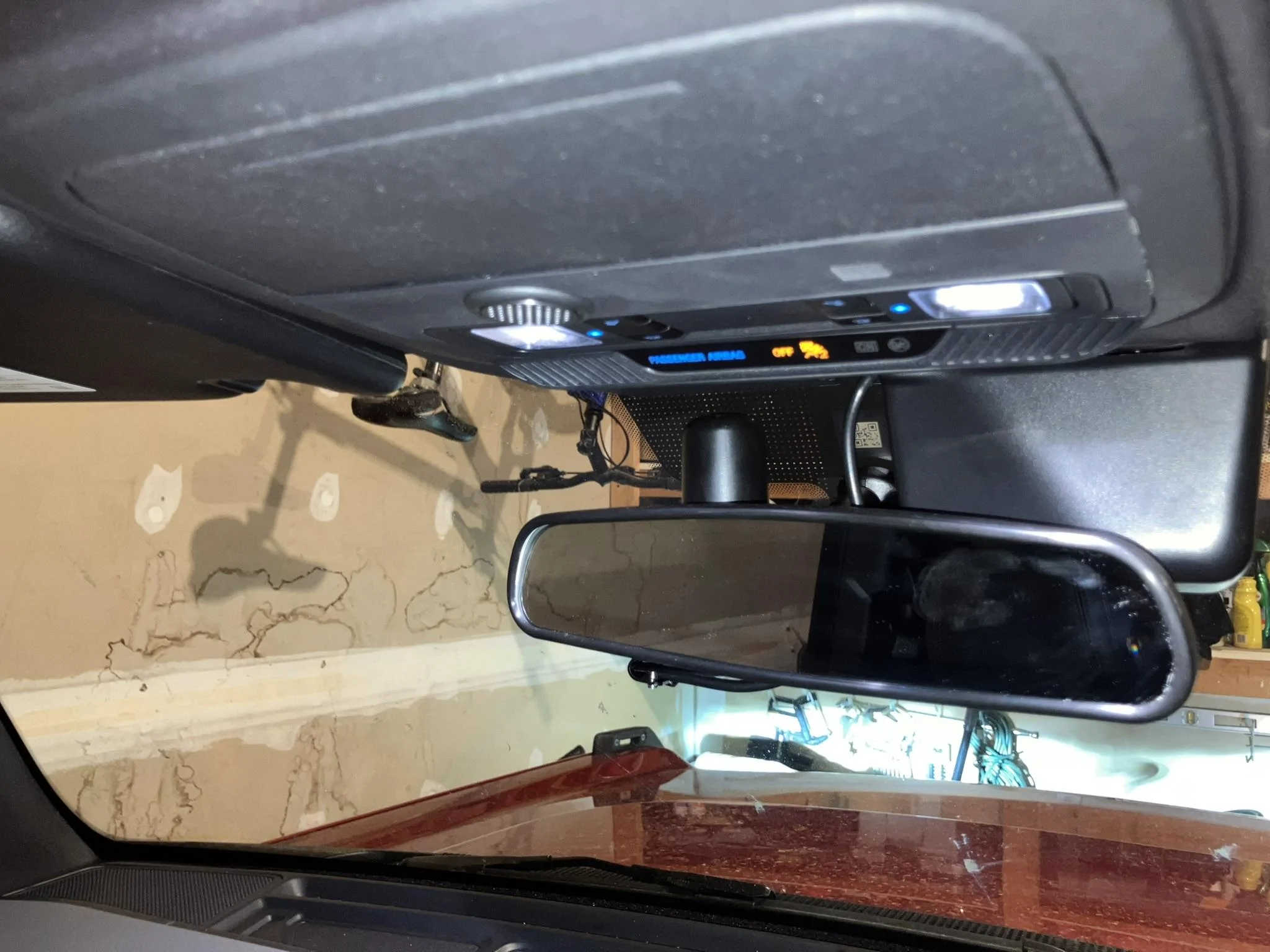

Installed Midland MTX115 with Ghost Antenna. Also purchased an over head molle panel from ebay. The molle panel also serves as a good cable tray :) I mounted the ghost antenna inside behind the rear view mirror by modifying an old GPS unit mount. I don't have a GMRS SWR but all weather channels come in clear.
