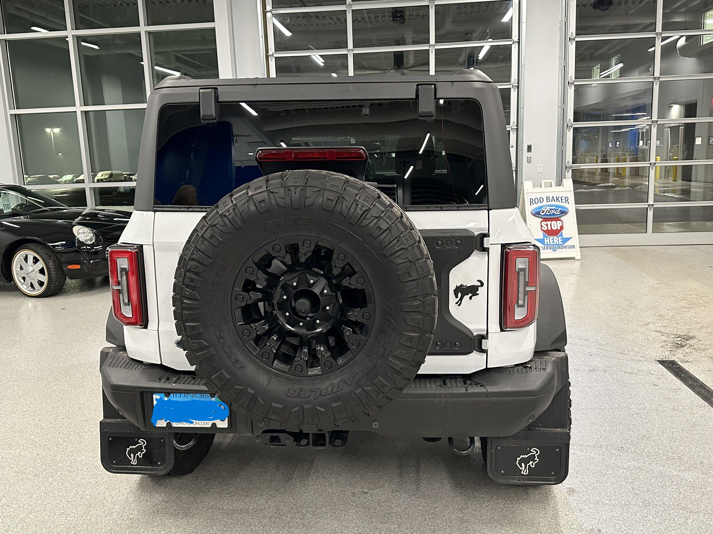

I finished up with the Braptor spare tire carrier, tail gate reinforcement and hinge install today on my BadSquatch. I worked with my local dealer (Rod Baker) and it came out looking good. It does feel very solid. I stayed with my 35s but have the ability to now go with 37s when I feel like it is needed.
The Braptor tire carrier includes the 3rd tail light and does have a different connector due to the addition of marker lights. We left the marker light circuit open and modified the harness with the original connector. I will probably go with a lighted wheel ring when the weather warms up :).

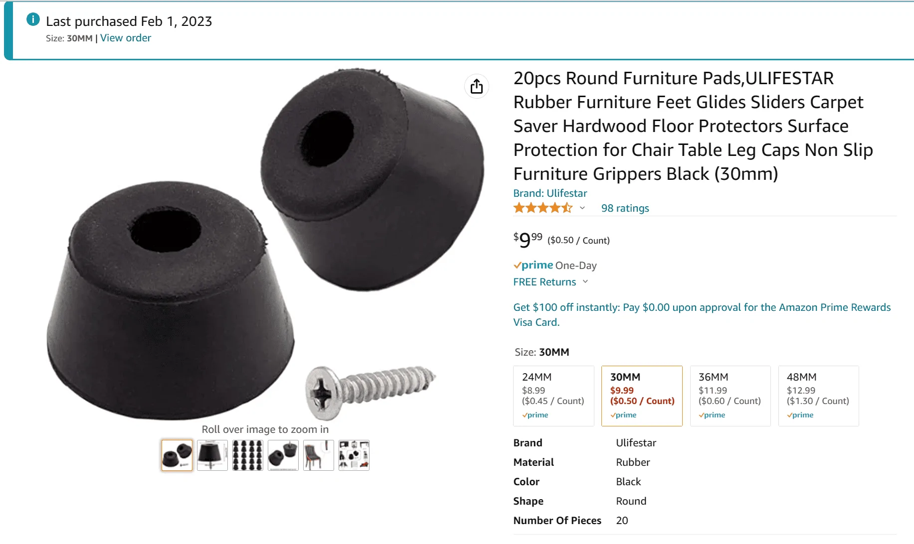

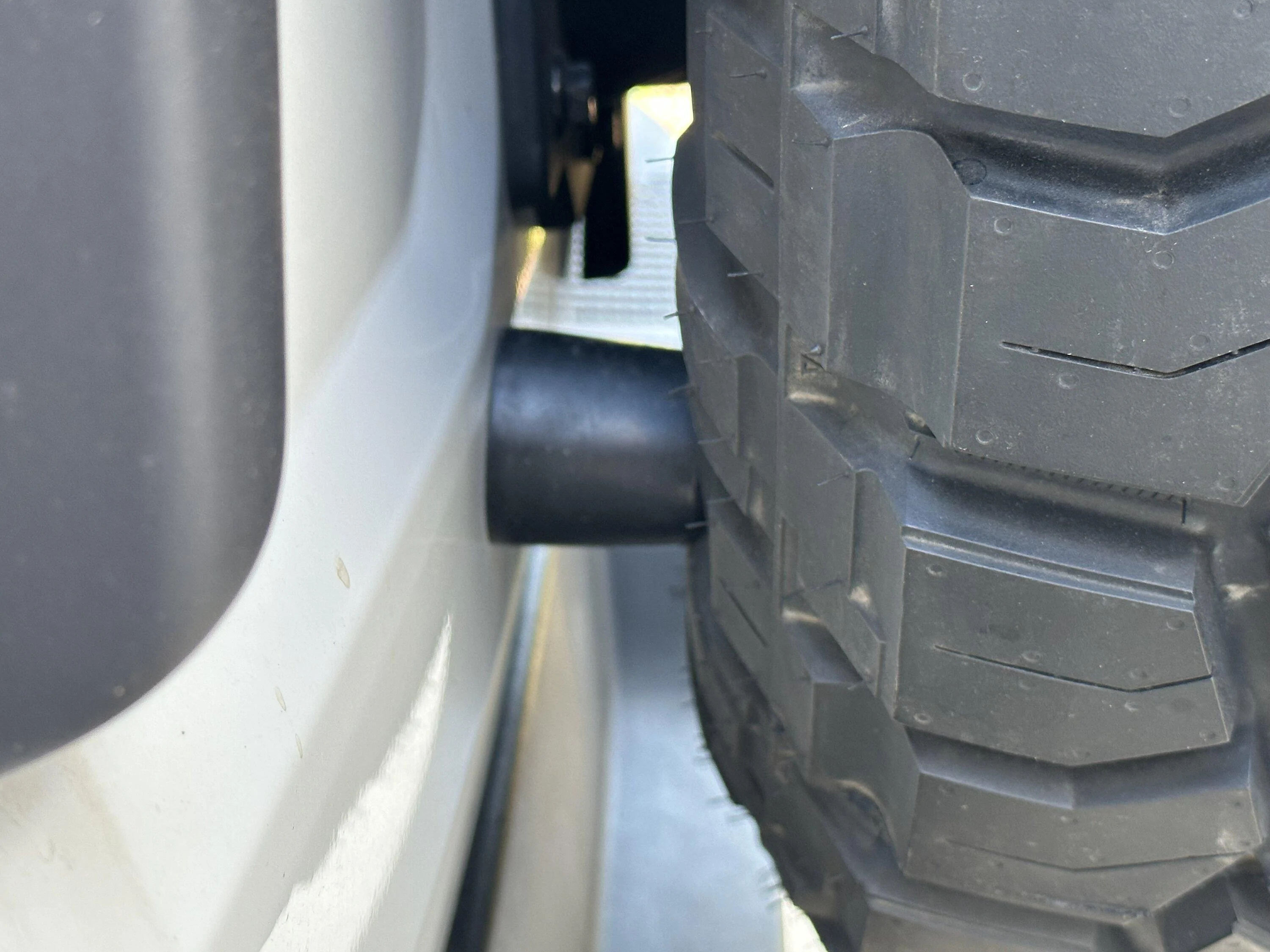

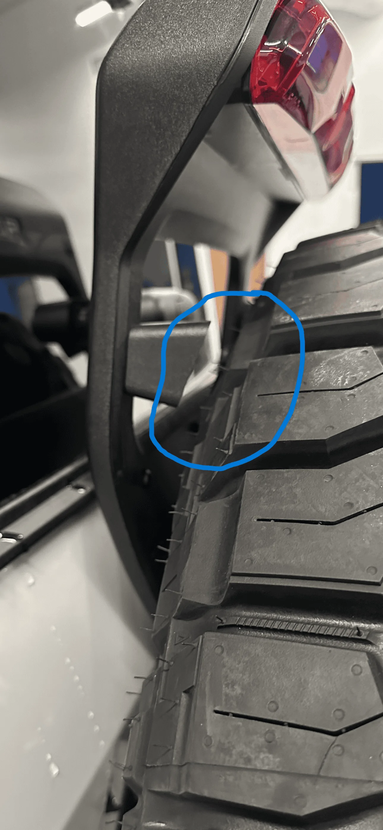

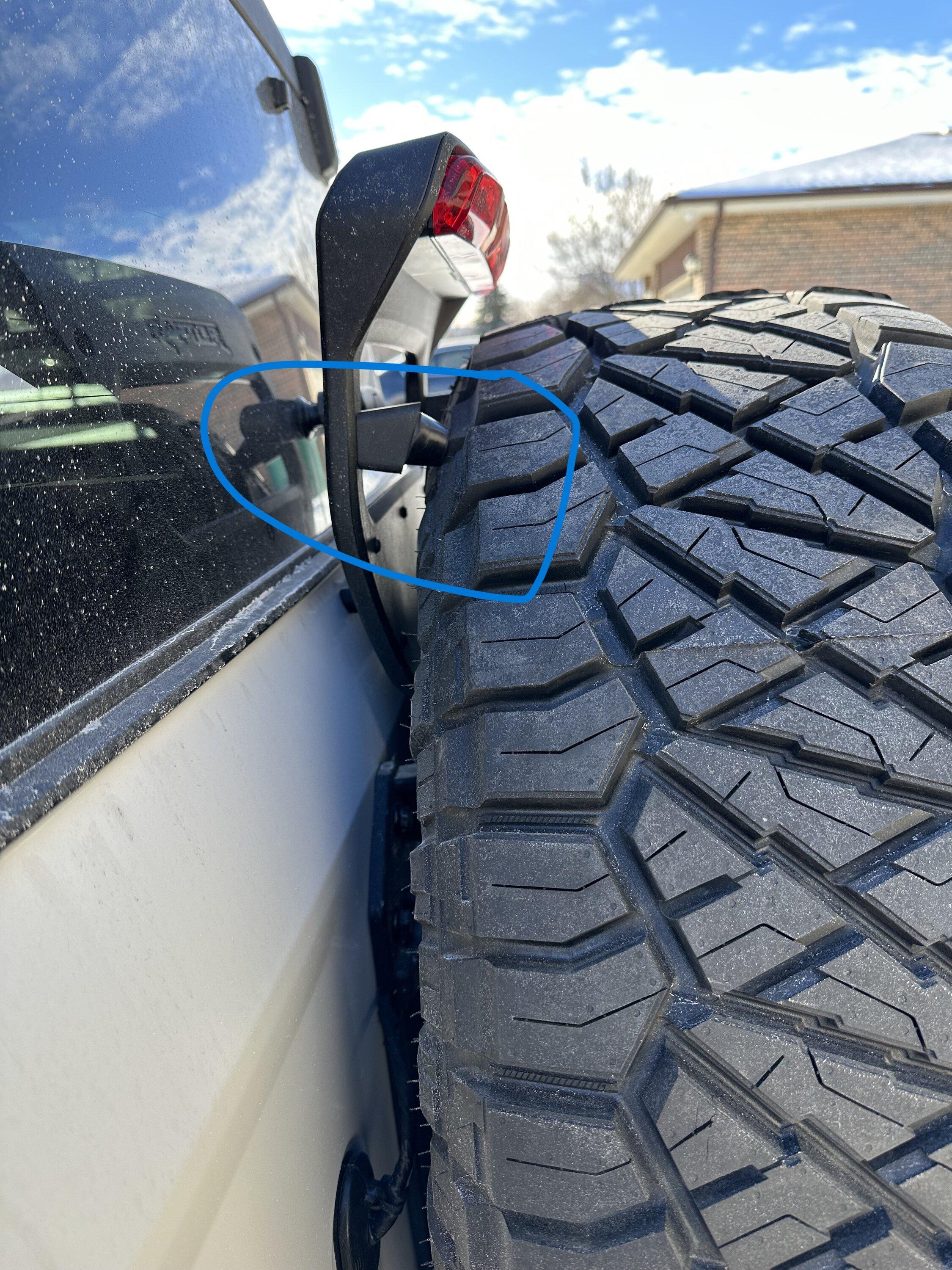

I also had to account for the spare tire isolator size differences. Both the stock top and bottom isolators had gaps with respect to the contact with tire due to the Raptor having larger tires. You can see the issue with attachment "Gap.PNG" below. I bought a set of furniture pads for the top (see "Stopper Information.PNG" below) and used gorilla glue to attach them to the brake light pad. Kind of crude but you can see the final product in "Rubber Pad Added.JPEG".
For the lower pad I used the Ford isolator/stopper part number M2DZ-1A401-A which is about 3/4 of an inch longer than the production one. It was designed for a smaller tire. I put the part number information and a photo of the final product below.
My apologies for mixing up the stopper/isolator terminologies but I hope this helps.
