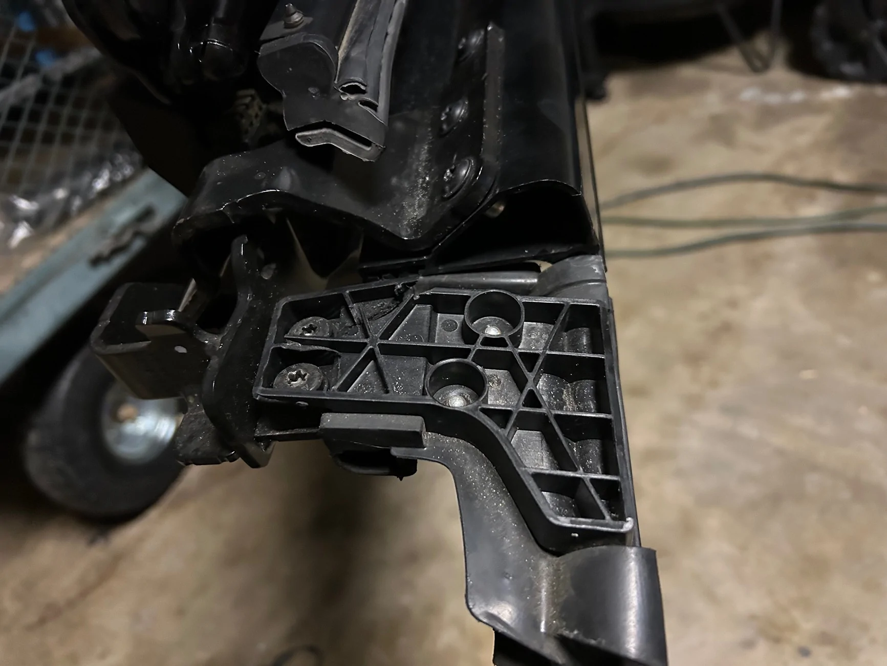

First time removing the top and this happened. Ordered replacement part but it will not be delivered until who knows when tomorrow. Question is can I reinstall the top? Will my window panels still go back in? And can I drive it? Rain and cold here….

They will go back in. That holds the bottom just in front of where window folds when raising back for access. Windows may be a little loose but the front, back, long back section track and 3 clips will be more than adequate to hold window
