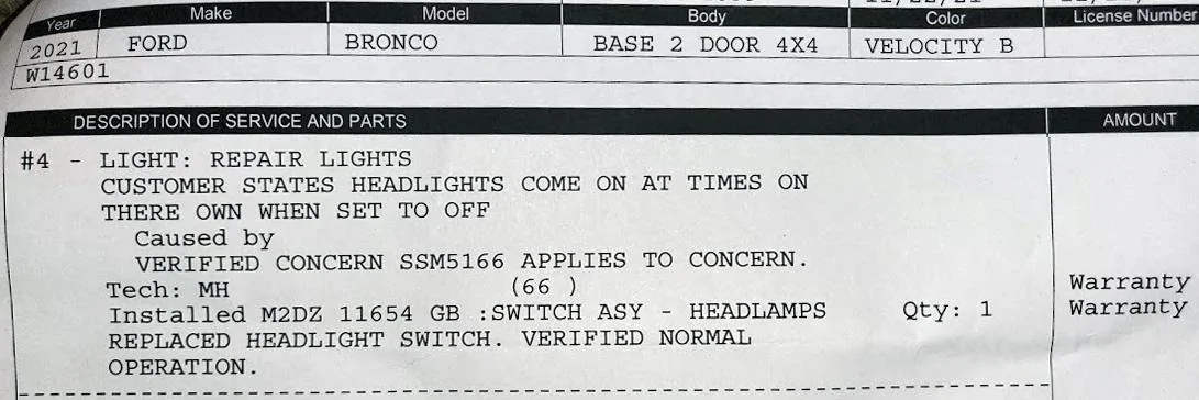

2021 Base - We started having this issue in the spring at about 6,000 miles, the lights would turn on randomly - in a parking lot after dinner, in the garage even if no one has driven the Bronco in two days, no rhyme or reason to it. We just got used to double checking it, but I've been bugging the dealership to get a replacement as soon as it was available.
We just got the switch replaced yesterday. The tech said they weren't sure if what Ford sent them was an upgraded switch or just a replacement one (which may have the same issue) because the part number is the same. He said he would have to take out the old one and compare the engineering number on each switch to see if this new one is a newer version. They think this new switch should be the fix, but time will tell. I will update here if this switch fails, no news is good news.
Ford Bronco Bronco faulty head light selector switch Light Switch replacement
