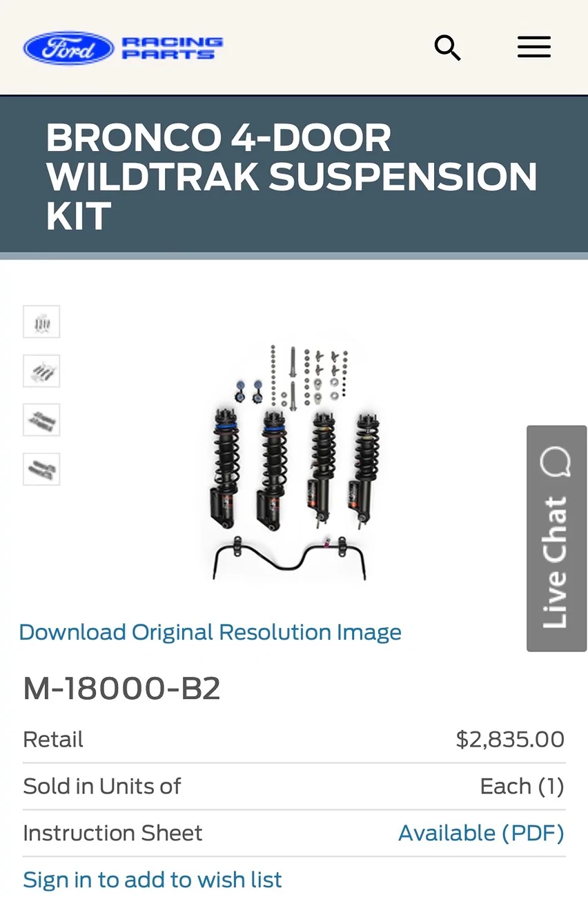

Ford performance Fox hoss 3 coilovers, wheels of your choice (just not negative offset), and 35s. Greet ride quality and will give the look you are probably after. Comes with rear sway bar also.

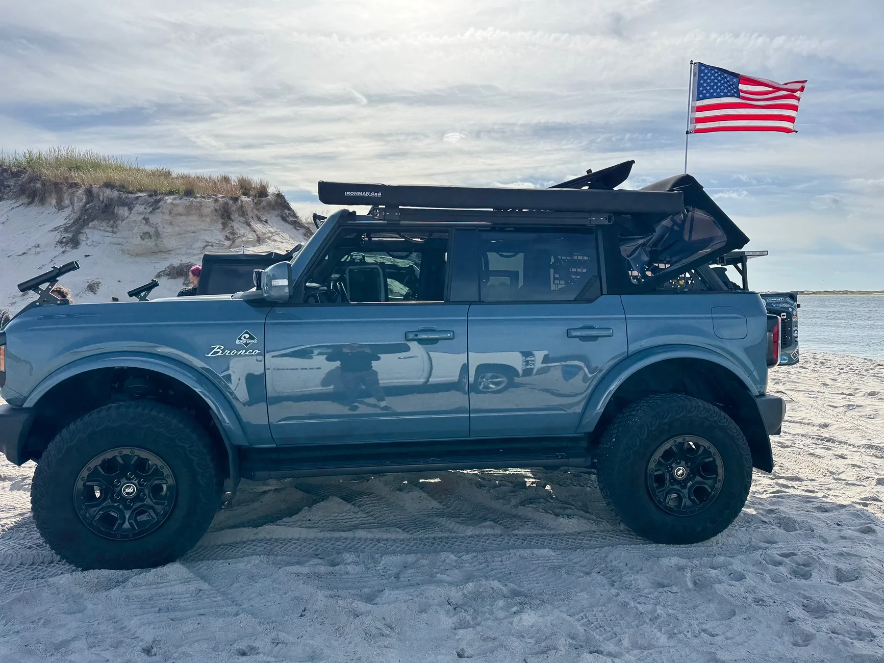

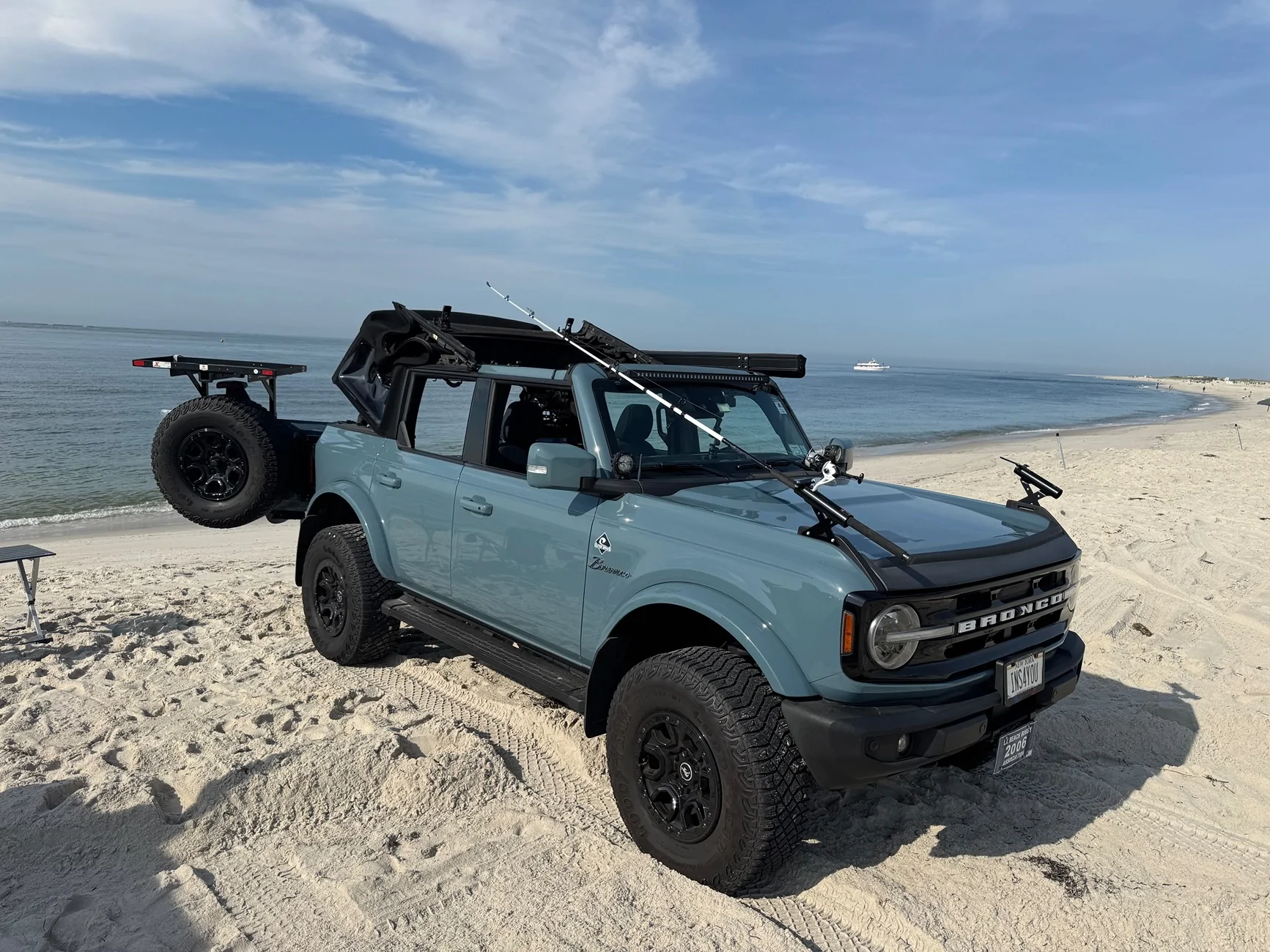

4” Readylift on 35’s from a wildtrak. 2021 OBW w/o sas
