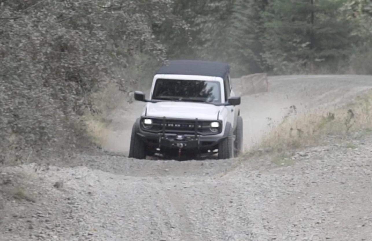

In this video, we install a set of TeraFlex Nomad wheels with a 0mm offset on my Base Bronco:
With the 0mm offset and the 35" Patagonia X/T tires, it is definitely showing some poke.
Ford Bronco Help a dummy - offset/backspace for Base Bronco with 2" lift? Poke-35s-Bronco

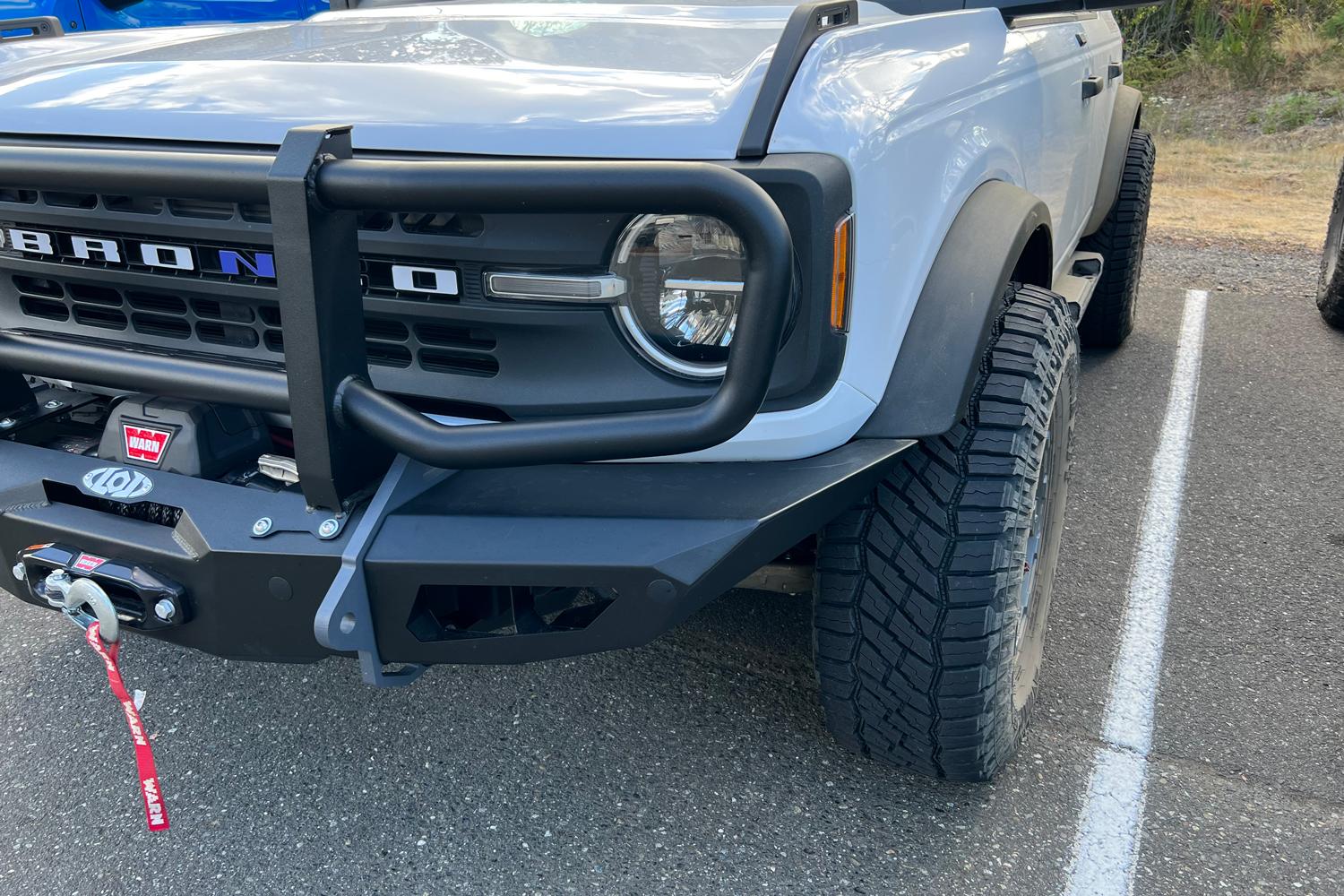

Do you have a lift?
We have a 3/4" spacer in the front and a 1/4" spacer in the rear and I can get the fronts to rub the flares at full compression. No rubbing steering L to R.
Ford Bronco Help a dummy - offset/backspace for Base Bronco with 2" lift? Bottoming-out

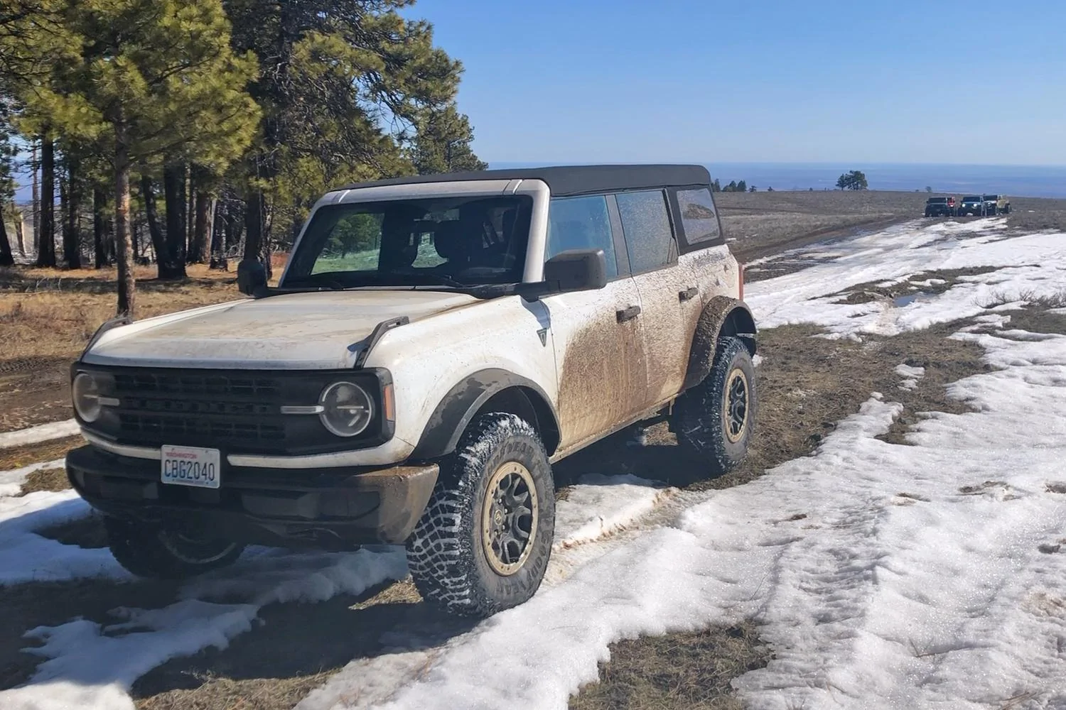

The OE Sasquatch wheel, like in the pic below, has a +30mm offset, so that 25mm Icon Rebound will have 5mm more poke than a Sasquatch.
Ford Bronco Help a dummy - offset/backspace for Base Bronco with 2" lift? DebSquatch-EBur

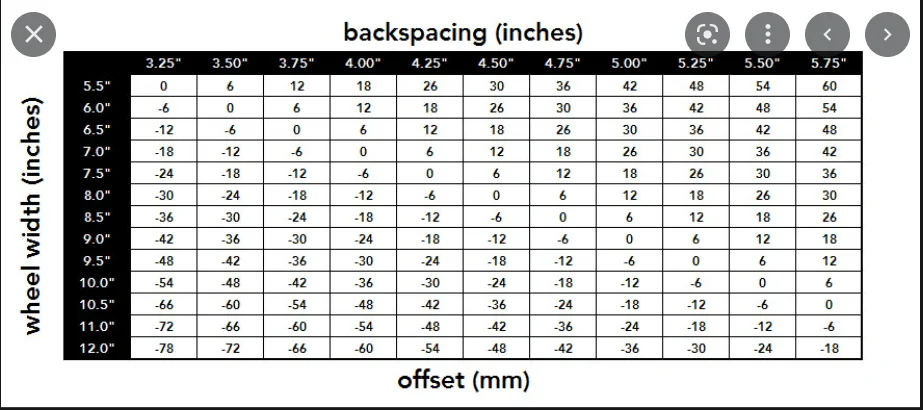

Funny they would say that....Backspacing and offset are just different ways to say the exact same thing. Here is a conversion chart:
Ford Bronco Help a dummy - offset/backspace for Base Bronco with 2" lift? Backspacing-to-Offset

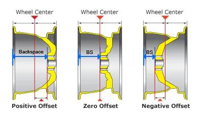

Backspace is measured from the back of the wheel, at the wheel mounting face to the outside edge of the wheel.
Offset is measured from the centerline of the wheel to the wheel mounting face.
  • If the wheel mounting face is out past the centerline, closer to the front side of the wheel, you have a positive offset.
  • If the wheel mounting face is closer to the backside of the wheel, you have a negative offset.
Ford Bronco Help a dummy - offset/backspace for Base Bronco with 2" lift? offset-backspace-diagram
