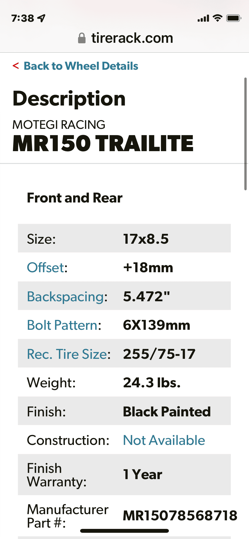

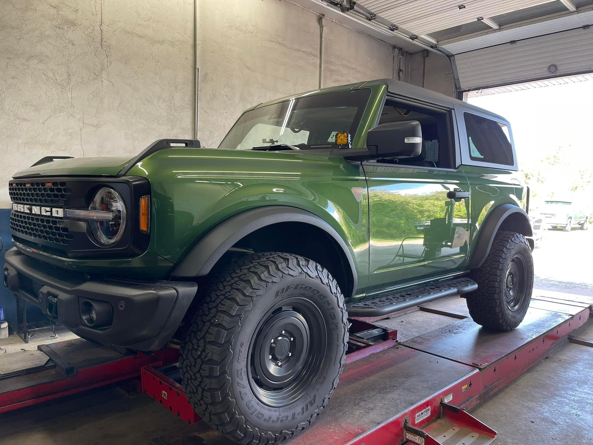

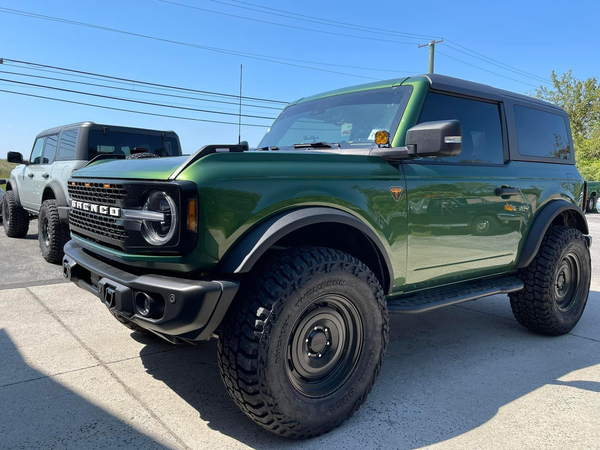

17x8.5 +18 w/ OE 33” (285/70r17) KO2
Ford Bronco Help  with badlands new wheel offset. 9DF1D4F3-B9CD-40BA-A505-EB7E58A1A5BE
Same wheel. 35x12.5r17 non-SAS. No lift or level.
Ford Bronco Help  with badlands new wheel offset. F9C6EC1B-E719-4D83-8D17-21D9FE022CDA

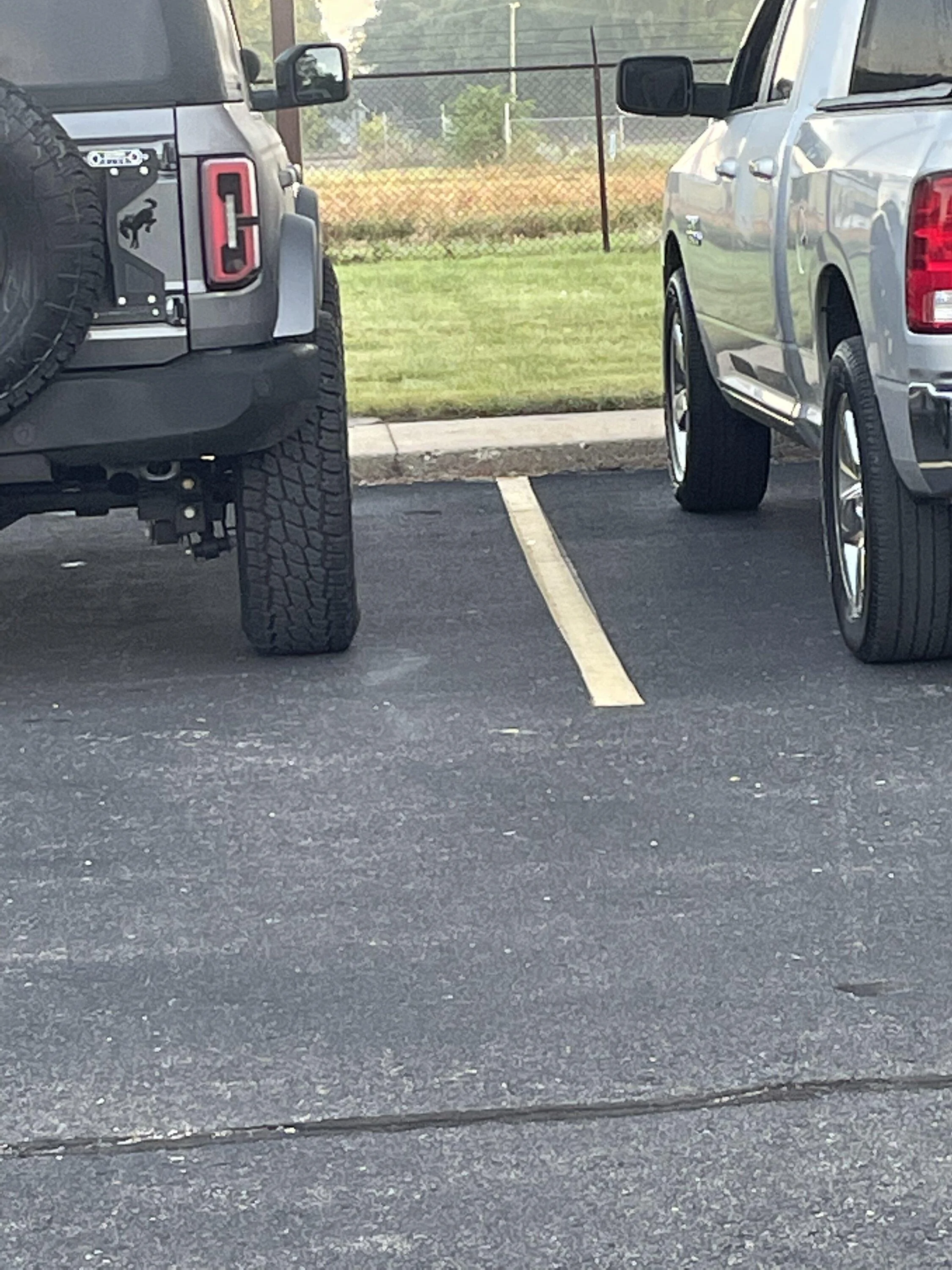

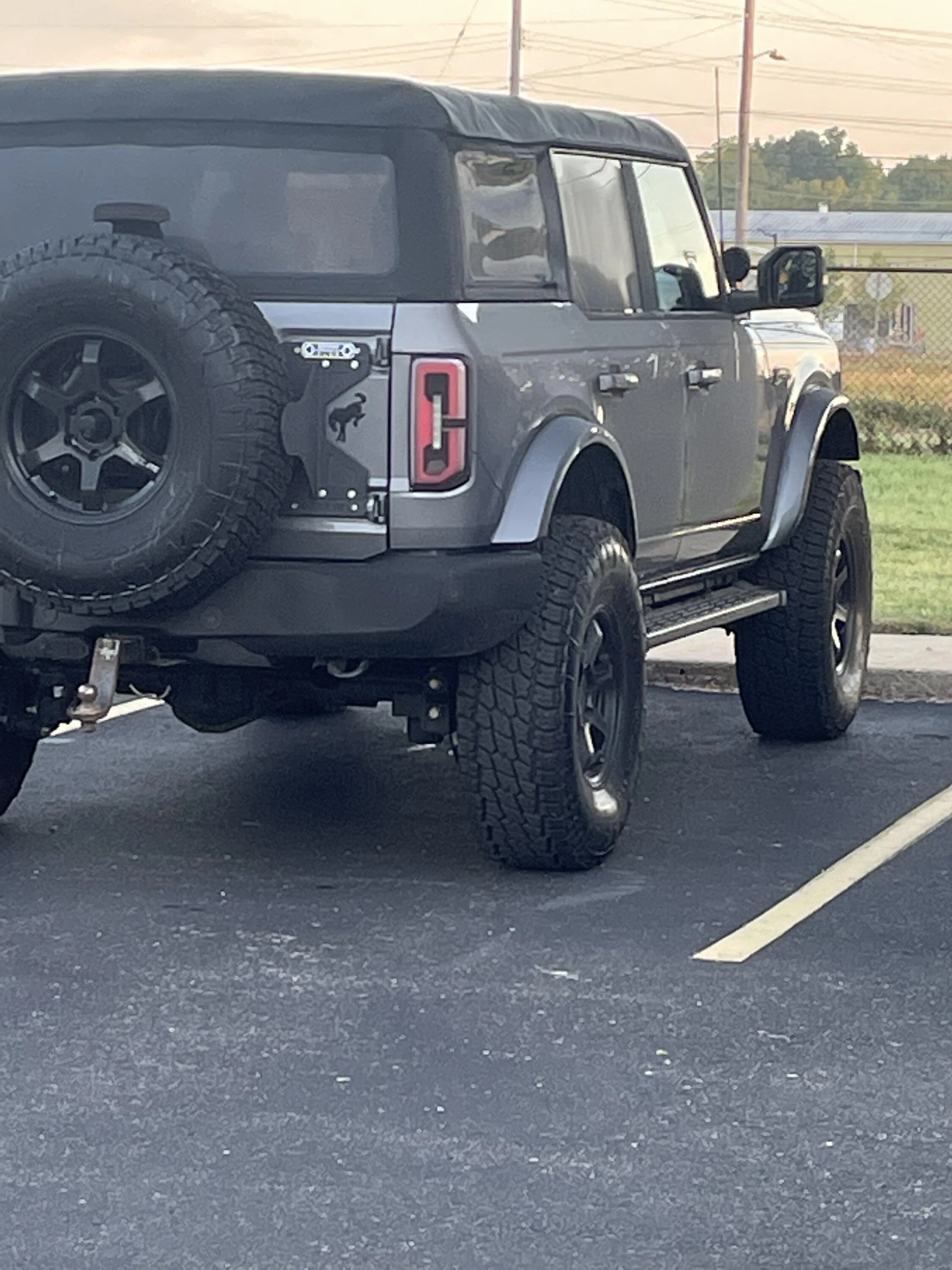

These are the wheels I went with a nd pics these are 37”x12.50/17 nitto Terrell grappler G2. These are +18 8.5” wide
