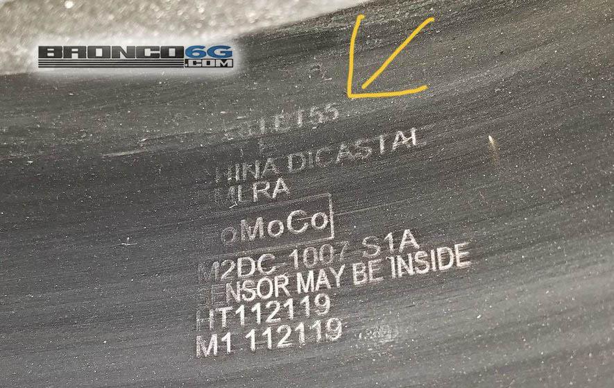

Huge props to @RedDawg who crawled under the 2 door Badlands Bronco on the Sanderson, AZ showroom floor to take a pic of the stamp inside the optional Badlands wheel. He or she is the man/woman!
Hopefully some of you experts can comfirm my math but since this pic shows “ET55“ stamped on the wheel, that ET55 means a positive offset of 55mm (which when converted to inches is 2.16”). So, since this is a 17 x 8” wheel then the centerline of the wheel is at 4.0” and if you add 2.16” to that it means this that the backspacing is 6.16”. But then you have to add.5” for the outside bead measurement. So, to sum it up, we now should have the specs on this wheel. Again, someone check me here but below should be the specs for the optional Badlands wheel:
The Optional Badlands wheel is a 17 x 8” wheel, with 6 x 5.5” (or 6 x 139mm) with a 55mm offset and 6.66” of backspacing.
Next logical question is can you fit a 35 x12.5 or 315/70 on this wheel and not have it rub on the front upper control arms or the crash members in the front wheel well?
@jaruss01 - Can you share math and graphics showing us if this wheel will fit a 35 or 315 without rubbing?
Ford Bronco Wheel offset confirmed for optional Badlands wheel (+55 offset) Optional Badlands Wheel Inside Offset

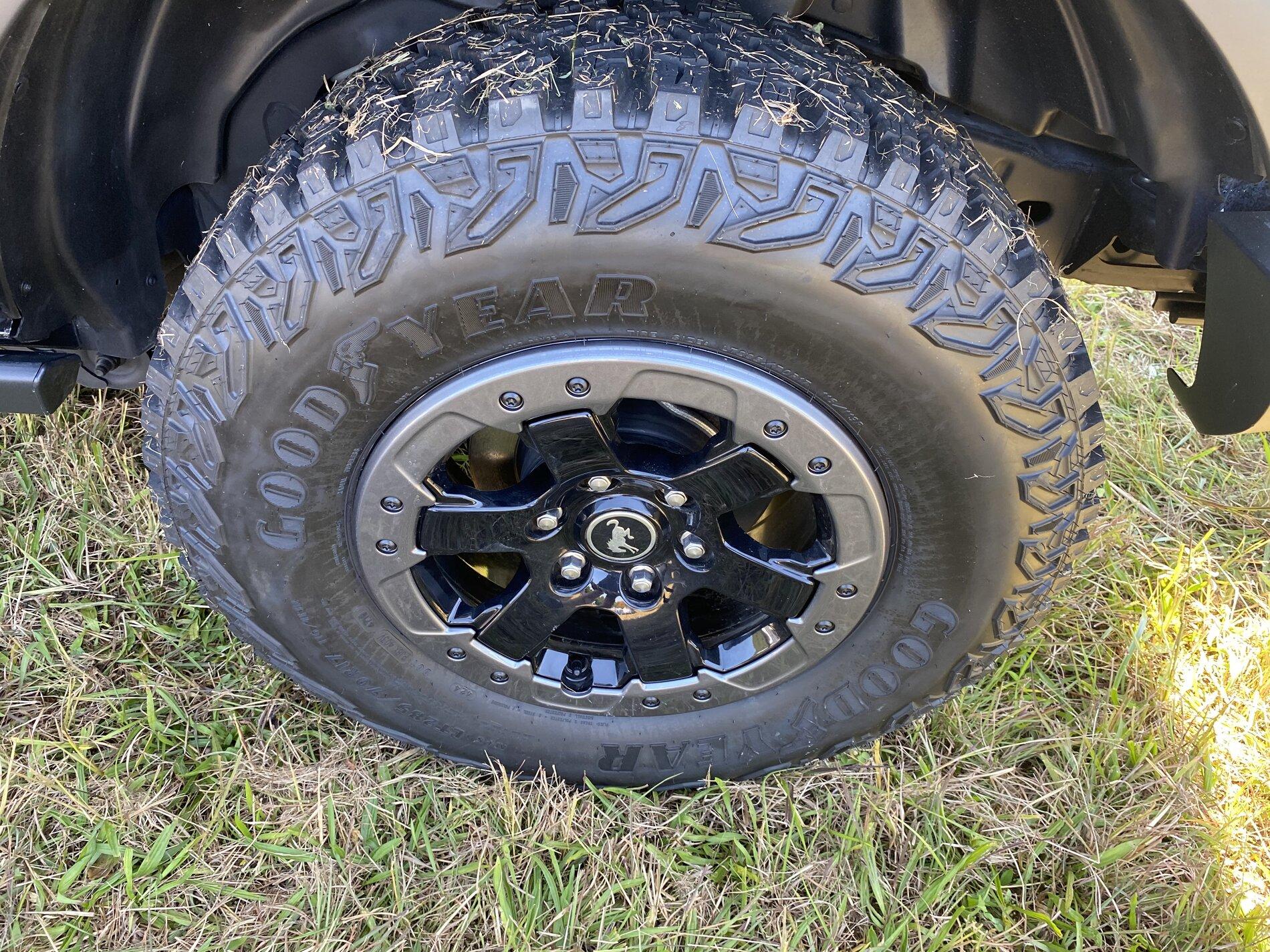

This is the wheel I am referencing.
Tire size: 285/70R17, 33" tire
Ford Bronco Wheel offset confirmed for optional Badlands wheel (+55 offset) 8CBF252B-AA00-4FA9-80EF-84CC58848D48

What is the tire size on this rim? And you will need to know how much room you have between the oem tire setup the Suspension before you can determine how much tire you can run.
315 is a lot of tire on an 8” rim. I doubt you will clear with a 55 offset.
Hopefully some of you experts can comfirm my math but since this pic shows “ET55“ stamped on the wheel, that ET55 means a positive offset of 55mm (which when converted to inches is 2.16”). So, since this is a 17 x 8” wheel then the centerline of the wheel is at 4” and if you add 2.16” to that it means this that the backspacing is 6.16”. So, to sum it up, we now should have the specs on this wheel. Again, someone check me here but below should be the specs for the optional Badlands wheel:
The Optional Badlands wheel is a 17 x 8” wheel, with 6 x 5.5” (or 6 x 139mm) with a 55mm offset and 6.17” of backspacing.
This s the wheel we I am referencing:
I already came to the conclusion that non sas wheels are +55. In short, the answer is no. Although with a BL lift you may be able to squeeze a slightly larger diameter but that’s mostly because BL is 32.7 not 33.0”. Anything beyond maybe 33.5” on BL is too tight to predict without testing in person. ...Unless you want to cut into or remove the crash bars....the OBX has 0.7 less lift than a BL and the absolutely tightest I’m seeing on paper is is slightly narrower tire (11.0 vs BL 11.2) at 33.2 dia. That’s a 275/70/r18. I haven’t toggled through upsizing 17s but don’t think you could go beyond 33.5 dia while keeping a 11.2 depth on a BL suspension.
If you get this wheel with your Badlands, it’s coming with a 285/70r17 tire (measuring 32.7” high and 11.2” wide).
Zooming in on the pic you can see it is a 285/70R17, 33" tire.
